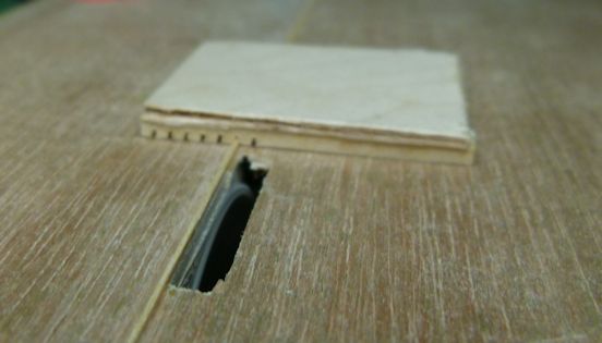

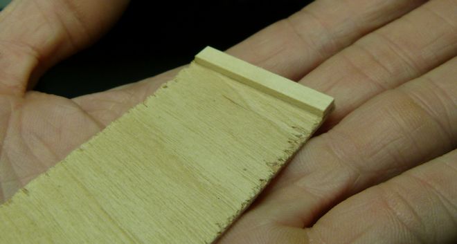

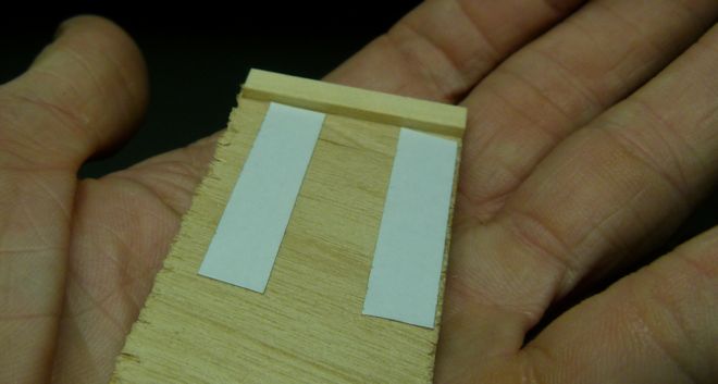

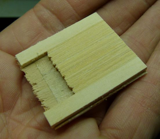

Had some 1.5 mm ply so I used this for my jig, first I super glued a 2 mm thick strip on the top edge of the jig, this strip is 2 mm thick to marry up to the 2 mm width of my gratings

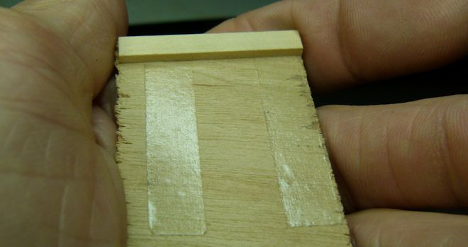

Next I stuck two strips of double sided tape on the jig, this will help to keep the grating strips in place.

Place the strips in the jig and then super glue another 2 mm thick strip to sandwich them in place, I ran the super glue down the back edge whilst holding the 2 mm strip tight against the grating pieces, then leave to dry for about 10 mins

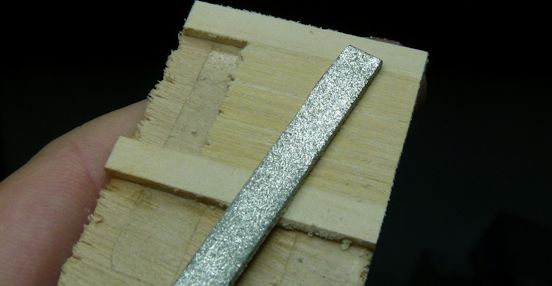

Before I ran them down the saw I filed all the grating strips in the jig just to make sure they are all the same width, any rouge thick pieces sticking up will prevent the saw blade going to the correct depth

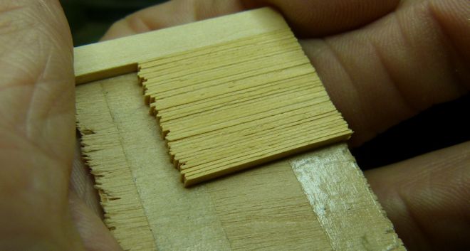

After cutting the grooves in the pieces gently remove them from the jig

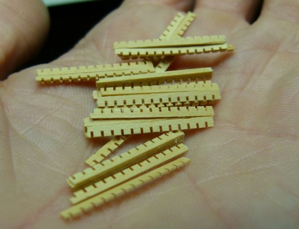

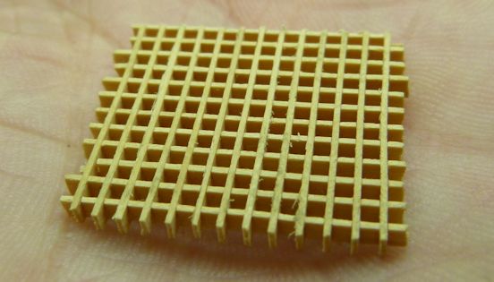

All we have to do now is assemble them (sounds easy doesn't it), I assembled them dry, no glue whatsoever, gently slotting them together till the square was complete.
Next mixed pva 1 part glue to 1 part water and brushed both sides, at this point I selected the best side and with a brush with just water on brushed away all signs of glue (this will not remove the glue thats soaked into the joints it will just clean up the appearance). Then left to dry overnight

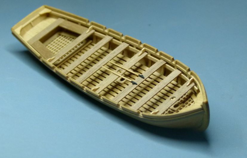

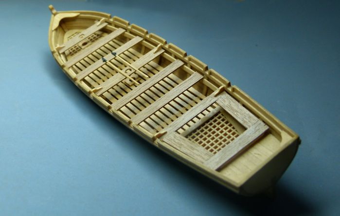

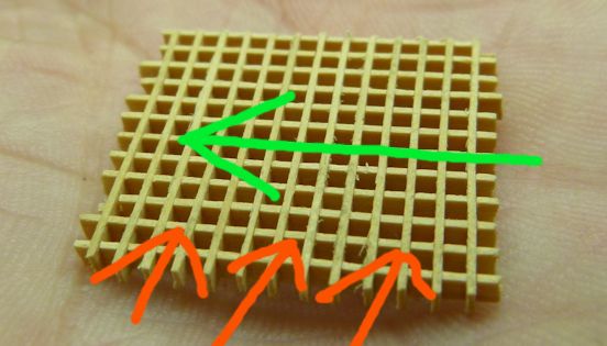

Lastly when dry I filed the gratings to make them flush, this was done after these photos were taken and the result can be seen in the the boat itself, a word of warning !!! you have to file against the top row of gratings to stop the bottom row breaking, see photo below you must file where the green arrow shows and not the red arrow, if you file in the direction of the red arrow the bottom gratings can break.
Thats about it lads and lasses, its not easy to do and I had a few failures but got there in the end.

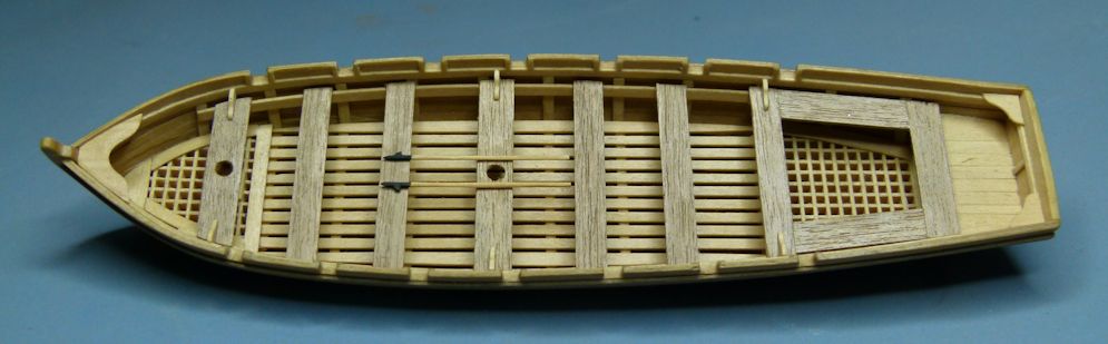

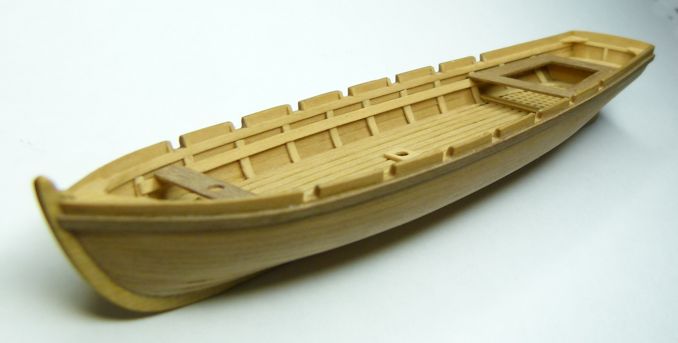

not much done, started on the thwarts and finished all double planking

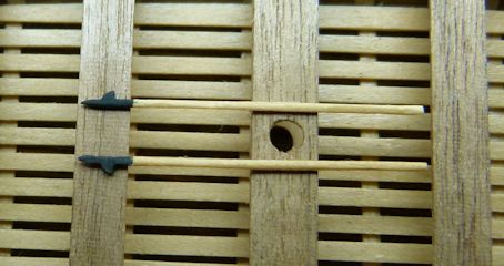

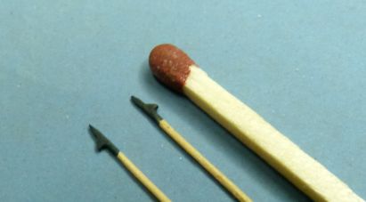

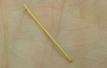

next, hooky thingy`s

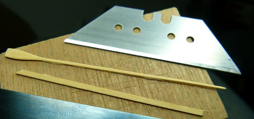

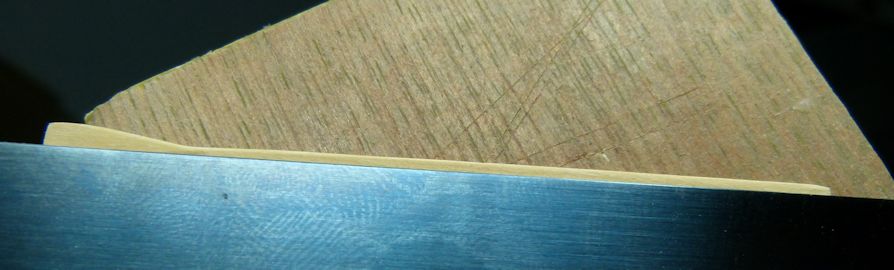

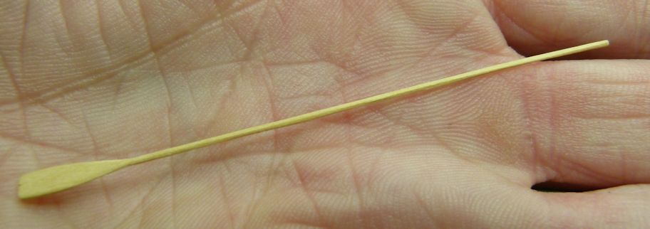

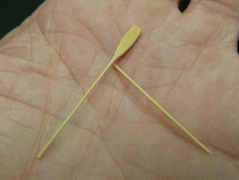

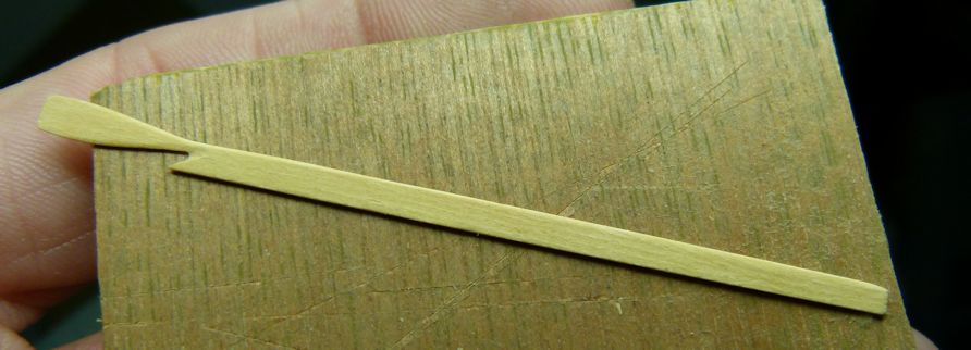

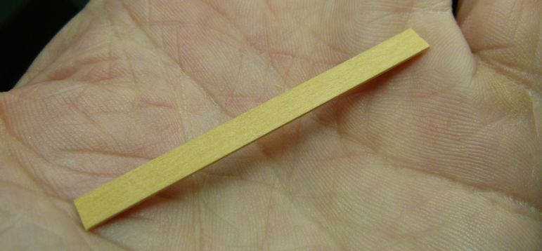

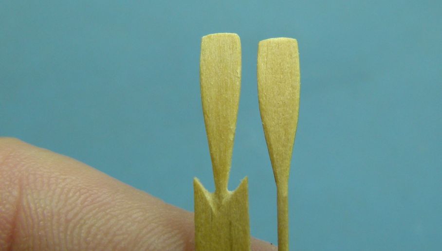

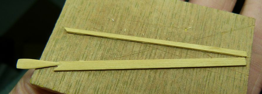

Now for the oars,
First I just filed one out of a piece of strip boxwood
Then this one was used as a template for all the others, below is a set of photos showing basically how I made them
willz
#357 Posted : 17 August 2013 20:11:17
Joined: 23/03/2010
Posts: 507
Points: 1,571
I did break one or two Cursing

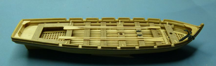

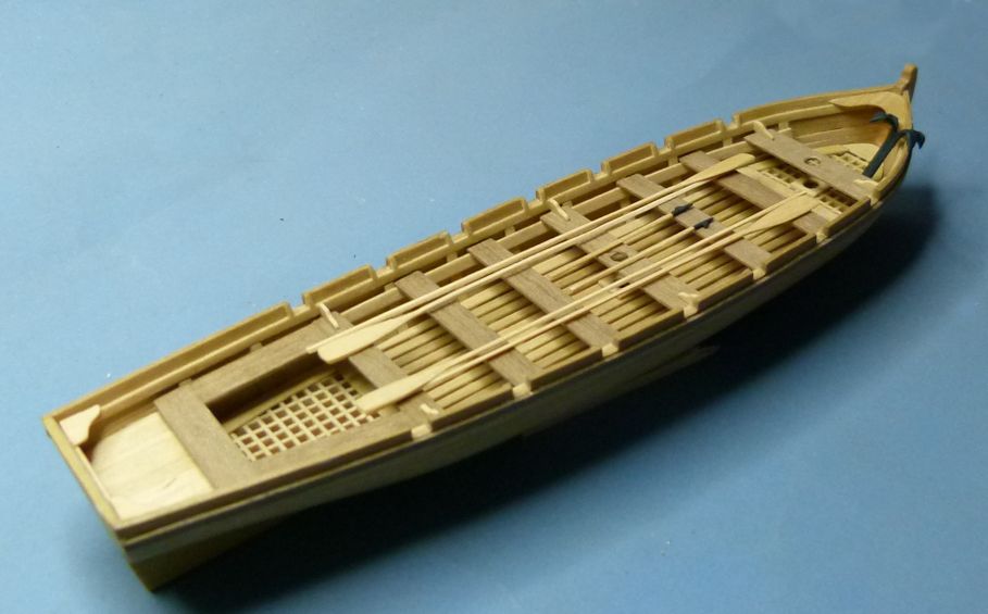

And lastly just a few in the barge, not sure how many to make without going overboard (sorry for the pun) I made the grapnel anchor a while back out of brass wire and plasticard.
Only the rudder left to do

My what big hands you've got LOL LOL LOL
Stunning work I am very impressed its quite a skill you have Cool
