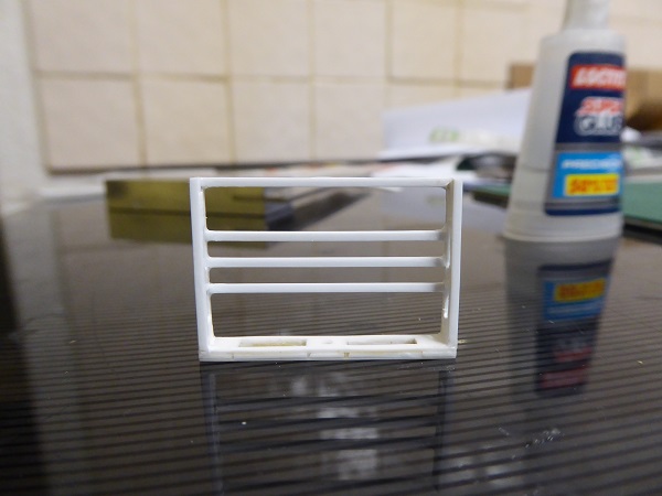

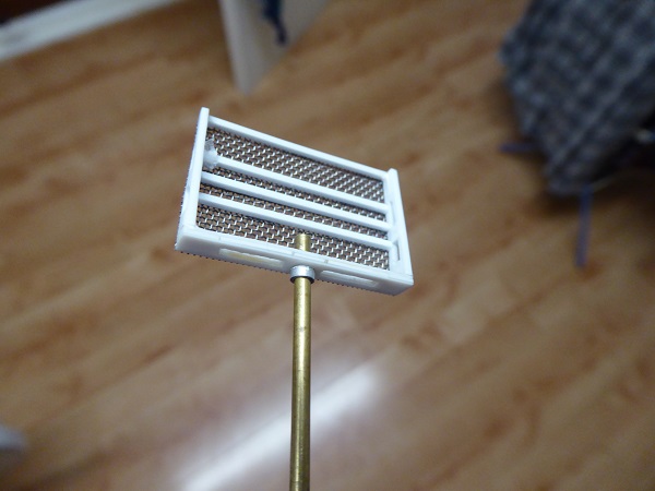

Third bar fitted.
#342 Posted : 18 October 2018 08:41:30
From another angle.

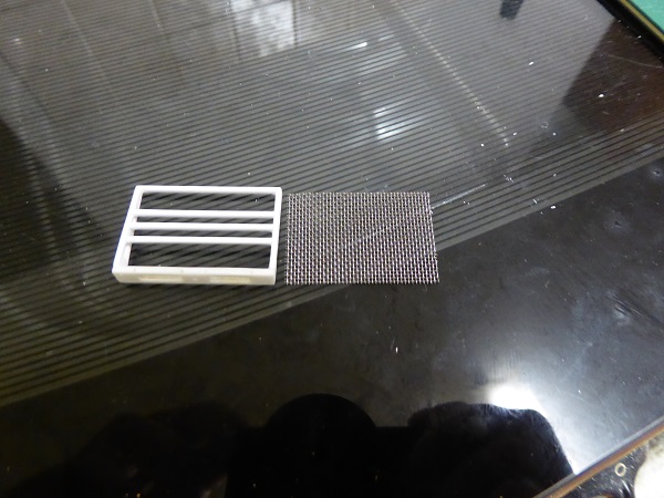

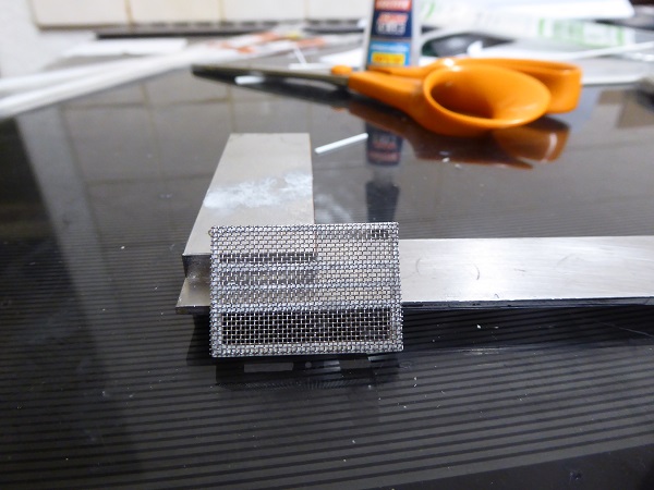

I used the same size wire mesh for the air intakes, to make the 'mesh antennae'.
The attached photo shows the mesh cut to shape.

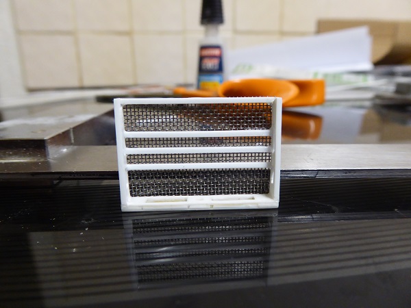

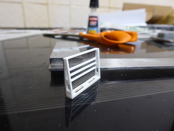

#344 Posted : 18 October 2018 08:44:08
Wire mesh fitted.

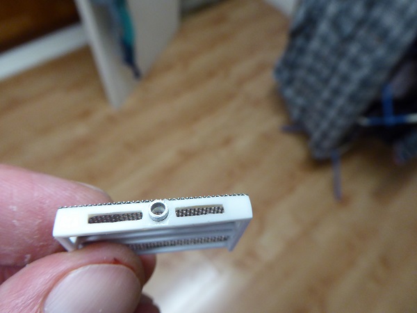

#345 Posted : 18 October 2018 08:44:52
Looking from the other side.
#346 Posted : 18 October 2018 08:45:29
From another angle.

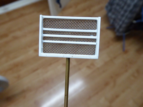

#347 Posted : 18 October 2018 08:47:22
I then drilled out the 1.0mm diameter centre hole in the base with a 2.0mm drill to except the brass rod which will form the mast.
#348 Posted : 18 October 2018 08:48:22
The 2.0mm diameter brass rod being checked for fit.
#349 Posted : 18 October 2018 08:49:19
From one angle.
#350 Posted : 18 October 2018 08:51:16
From another angle.

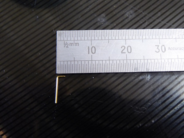

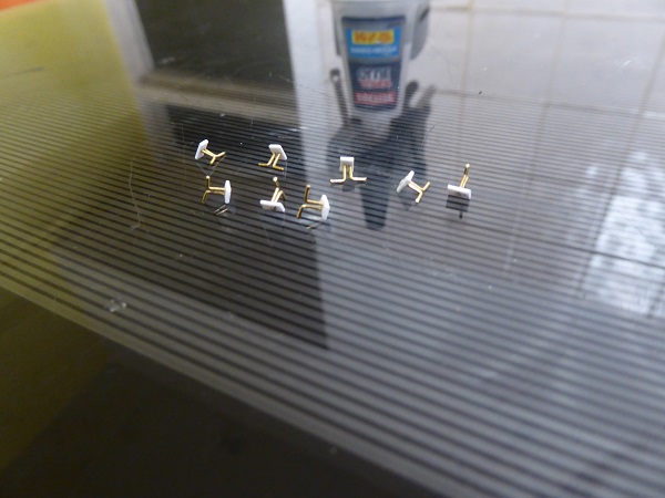

The next very fiddly stage was to make the 16 dipoles that are fitted to the wire mesh. I used 0.5mm diameter brass rod for this job.
The attached photo shows the first one bent to shape. Another 15 to make!Blink

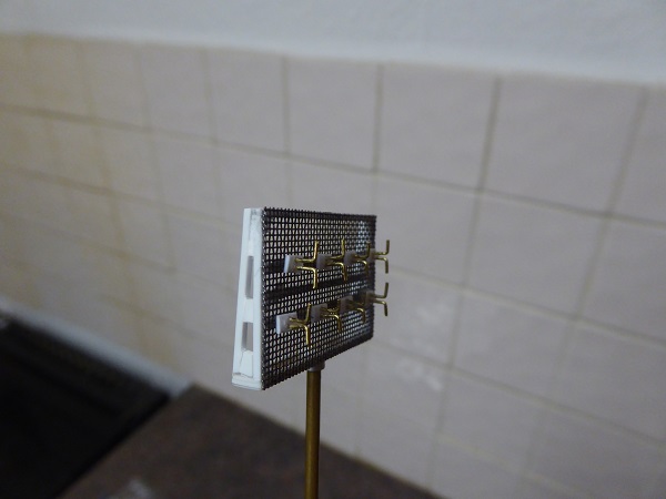

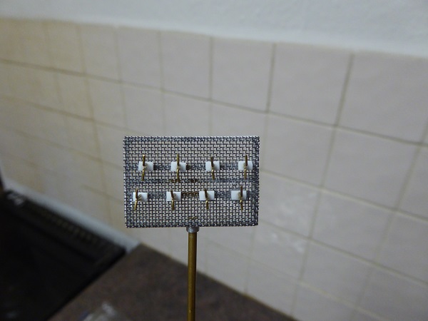

#359 Posted : 18 October 2018 09:07:44
Brackets and dipoles fitted to the FuMO-30 wire mesh radar antennae. The top row is off set to the bottom row as per U995.

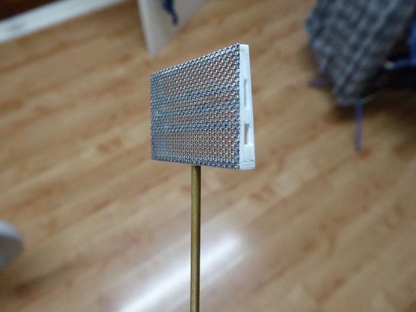

#360 Posted : 18 October 2018 09:08:28
Rotated round.
