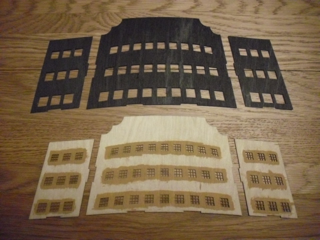

FITTING THE GALLERY ENHANCEMENT
PAINTING AND FINISHING
Thats the first coat of black painted on the outward piece of ply.
Now I am going to paint all the windows on the inward piece of ply,this will only display the windows through the outward piece of ply (and your painting does not have to be perfect on this piece because it will not be seen), giving a 3 dimensional effect when fitted with the brass etch.
Here are all the pieces with one coat of paint:-

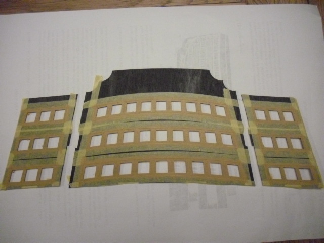

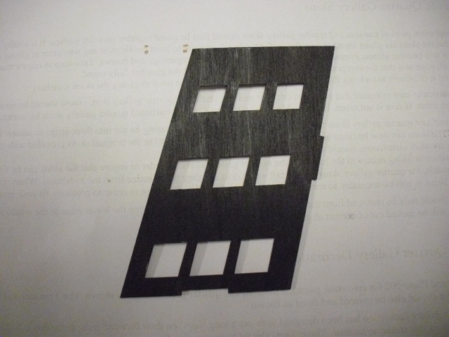

#342 Posted : 14 November 2012 22:58:17

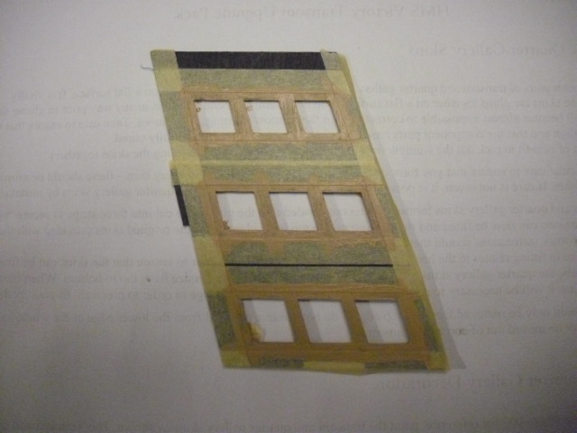

Now is the time to mask the outward pieces of ply ( both Stern and side parts), for we are going to paint yellow ochre around the windows. (as per the PDF instructions supplied)
I am using Tamiya masking tape, this is the first stage:-
#343 Posted : 14 November 2012 23:02:01
Next job is to apply the paint, what you see now is one coat of paint added:-

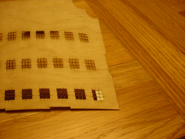

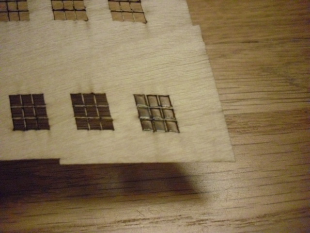

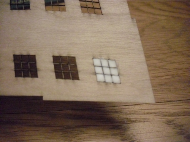

To finish off this session, I would like to introduce you to a product which is a PVA based product but it dries clear it is called MICRO KRISTAL KLEAR. I have decided not to fit the clear acetate to form the windows, but to use MKK to make the windows.
All you need is the product a coctail stick and you are all set, when you first apply it, it is white just like PVA then when it dries it is clear and seamless.
Have a look:-
#345 Posted : 14 November 2012 23:19:01
Well that is all for this session ( I will be doing more painting in between now and the next session)BigGrin Dont forget Questions and NICE comments welcomeLove I will leave you with the MKK totally clear and producing great windows. Kind regards Mike

#351 Posted : 15 November 2012 09:33:55
Joined: 05/09/2012
Posts: 1,400
Points: 4,690
Location: Beaminster, Dorset
Brilliant idea for replicating the old leaded window panes, Mike ThumpUp ThumpUp ThumpUp. £5 on eBay with free postage.

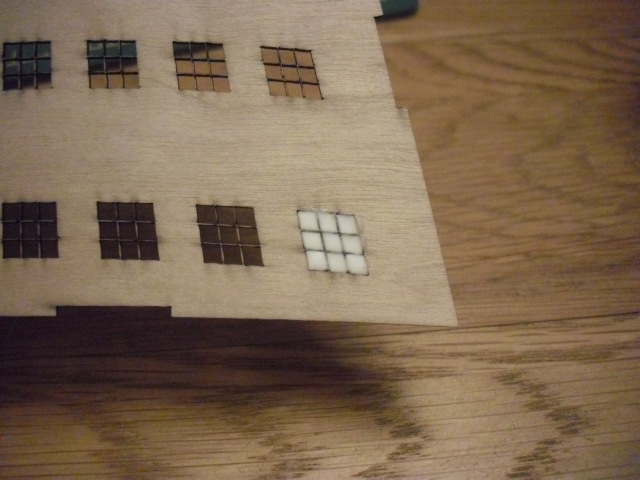

Now regarding the making of the Gallery Enhancement windows, there are 2 products that I have used to test the production of windows, clearfix by Humbrol (you already have that on order) it works well but my wife has a breathing disorder, and as this product is solvent based I voted against it, if you remember when we were kids making model aircraft it gives off vapours like dope.
The product I prefere because it is a more natural product is:-
MICROSCALE MICRO KRISTAL KLEAR, it is made in the USA, you can buy it on Ebay.
The drying time depends on the thickness applied (from 15mins)
As regards the life of the product, difficult to say but PVA adhesive lasts along time, all I can say if it ever needs touching up it is accessableBigGrin I have included some photos:-
Kind regards Mike
PS Thanks Mark2,Bam,DJS and Andy for your nice commentsBigGrin
saintsman123
#353 Posted : 15 November 2012 10:27:42
Joined: 30/01/2011
Posts: 865
Points: 2,410
Location: Cambs
a+ for the windows mikeBigGrin

#356 Posted : 15 November 2012 12:28:35
Joined: 08/07/2010
Posts: 1,036
Points: 3,086
Hi everyone
Mike recommended that 'Kristal Clear' to me soon after I purchased the gallery enhancement and I can truly endorse the stuff. It really is quite magic, both in the way its applied, where it starts out looking just like glue, but as it cures it becomes exactly what it says on the bottle. When its dry, then the magic shows, the windows look just as though they really have had panes of glass inserted and even have the look of the old glass, you know, the sort with the uneven thickness and bubbles in it - just like it would have been.
So yes you could say I'm well and truly sold on this one.
Happy building and thanks again MikeBigGrin
David
P.S: Got mine on E Bay!
