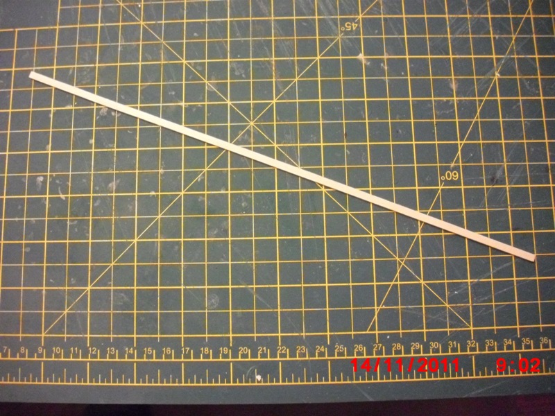

I decided to fit the two waist beams, I selected a piece of 4 mm x 2 mm timber from a previous issue:-

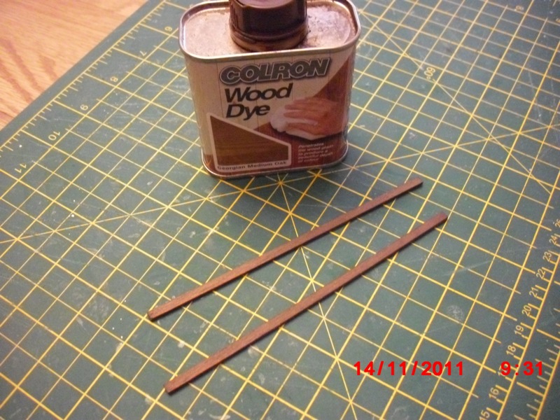

#345 Posted : 14 November 2011 10:09:10
ISSUE 40
I then measured the pieces I required for the forecastle deck and afterdeck, stained them with the Colron dye shown in the photo,( I used this dye to colour the deck) I gave 3 coats (6 hours drying time between each coat)to achieve the depth of stain I required.:-

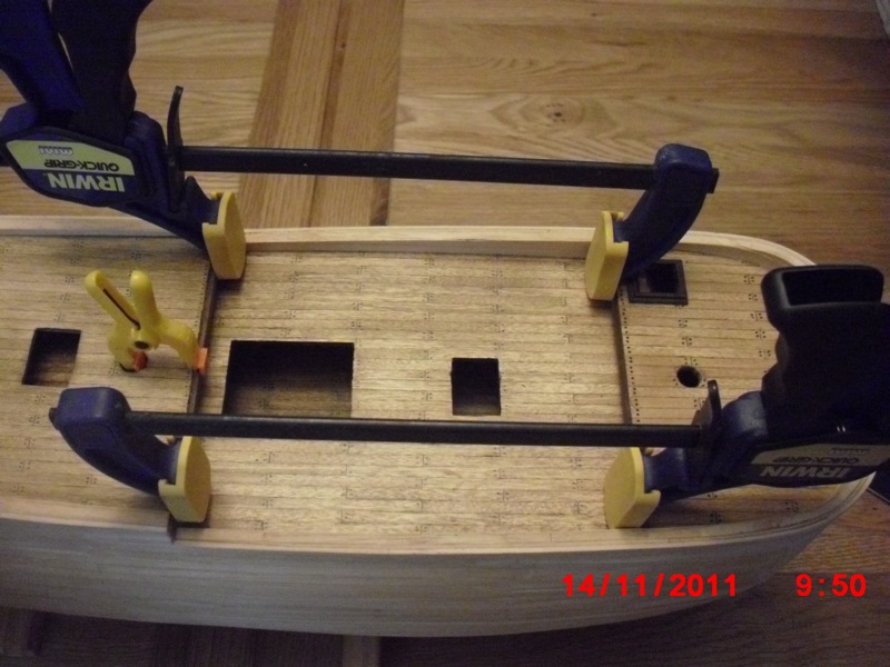

#346 Posted : 14 November 2011 10:20:16
ISSUE 40
I then clamped the pieces in place using my long bars, you can use them to push as well as clamp in the traditional way.
Taking time over the small jobs during the build, can make all the difference to the finished model.:-

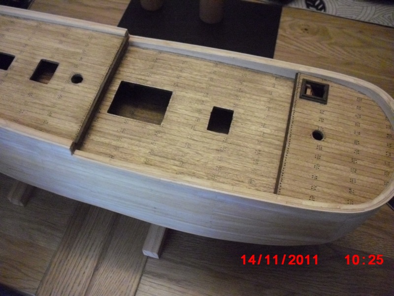

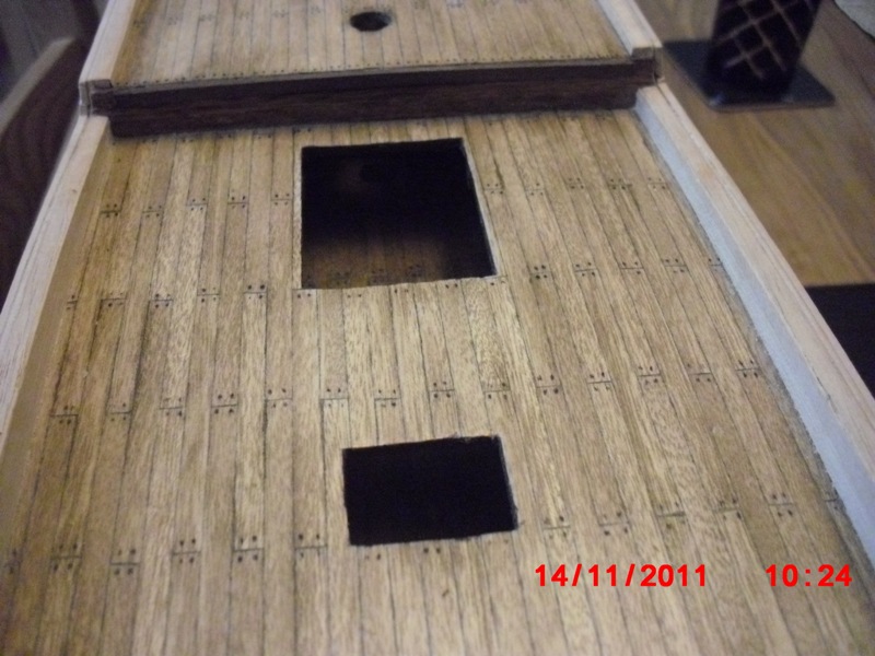

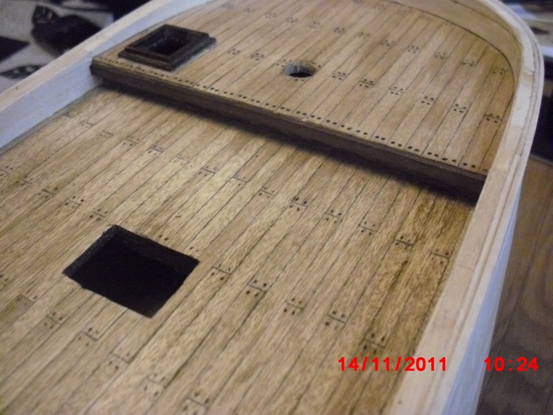

ISSUE 40
Now the parts are fitted, the ship looks like this:-
comments welcomeBigGrin Cool

looking at your long clamps i wonder if they do the same as mine unscrew the fixed end pice screw it on the other end then the clamp workes in reverse
#351 Posted : 14 November 2011 12:42:58
Mine do not unscrew Willie, but work in reverse, your clamps are probablyBigGrin Cool more upto date than mine

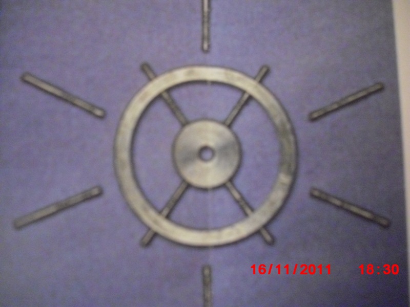

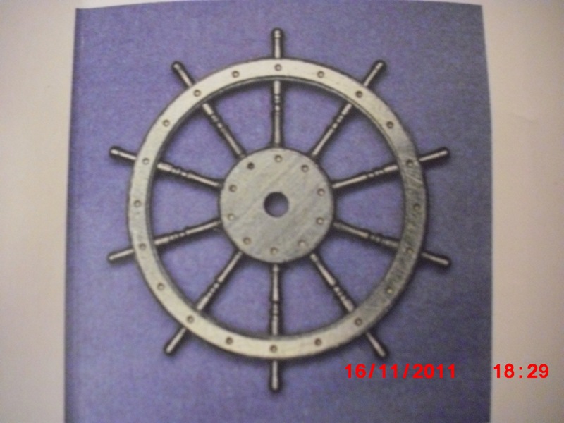

SHIPS WHEEL
I was very fortunate to purchase a super quality ships wheel yesterday, it is in brass particularly the spokes which are in beautiful turned brass 0.5mm in diameter, the outer rims are in etched brass 0.3mm thick here are a few photos:-
#359 Posted : 16 November 2011 19:13:01

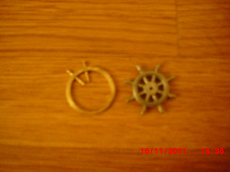

This last photo is of part of the wheel and along side it is the ships wheel from our De Ag Victory, I am going to use 2 wheels together on my Victory the scale is about right, because the wheel in real life would have been approx 6 feet in diameter, all these little finds go to make our ships more accurate, comments welcomeBigGrin Cool
