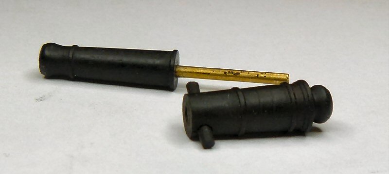

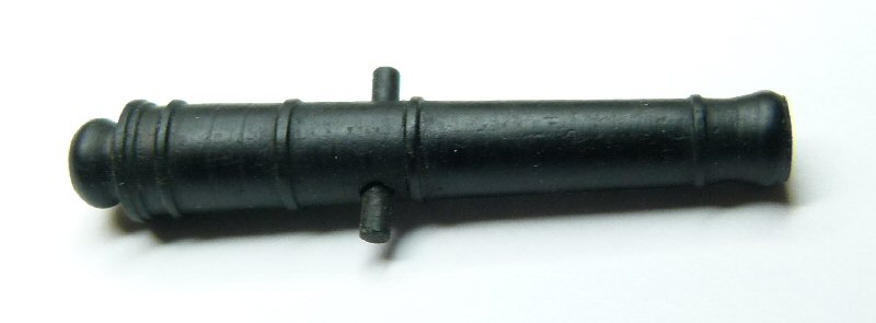

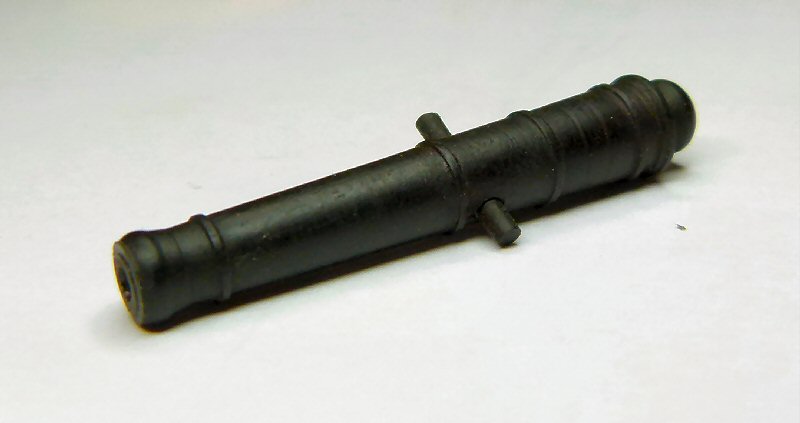

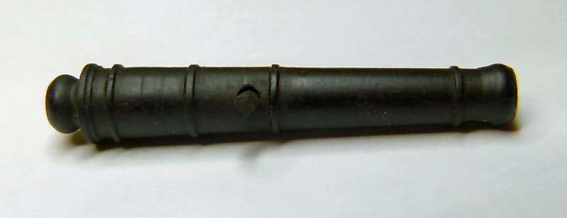

Just like to point out the dummy cannon I made was for the tutorial, so I thought I`d show you my original dummy 1/72 32 pounder cannon barrel, as you can see by the pics you cant see the split, its hidden behind one of the cannons rings,

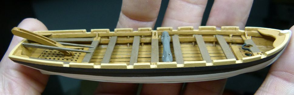

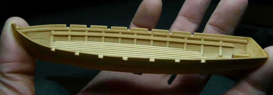

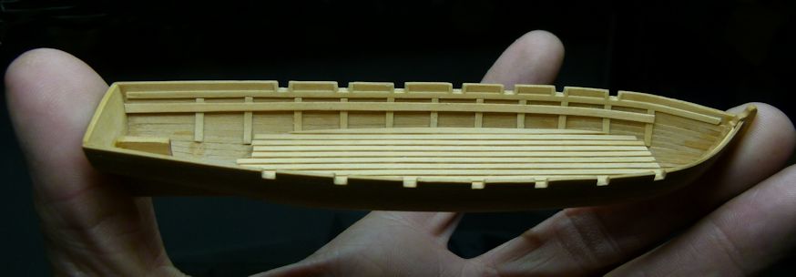

been a bit too warm for me haven`t done much, just a small update on the barge, couple of pics of where I`m at, been trying to figure out how to do the tiny gratings, all efforts up till now failed. oh well, keep trying

These details are really amazing and without comparison to everything I've seen so far (well, with the exception of your own work). Do you still use deAgo's parts as a basis (or at least for taking measurements) or is it completely built from scratch?
hi Bernd, its completely scratch, all drawings taken from john McKay`s book.
Still have all the mags from the deag Victory, the idea was to build the deag out of the box painted at the same time as building a 1/72 scratch natural finish. mmmmmmm seemed a good idea at the time.
cheers

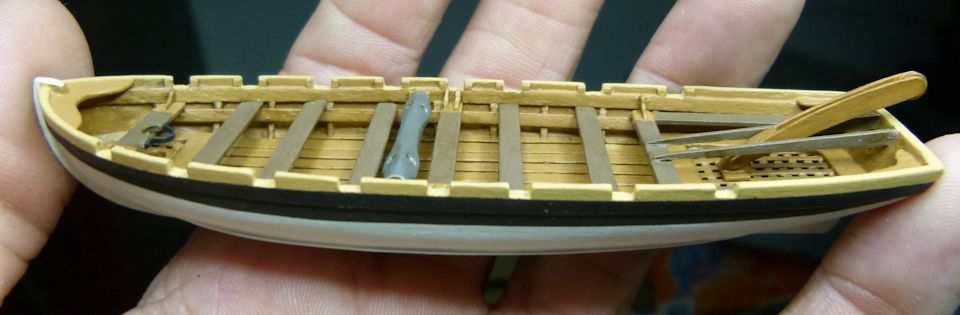

hi Alan
managed to do the gratings, bit tricky but got there in the end.
the picture of the boat in my hand is a 1/72 barge and not the de ag launch, so below is a pic of my de ag launch just for comparison

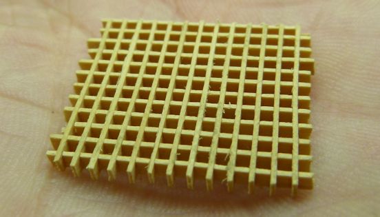

Managed to fit the gratings to the barge, quite pleased with the outcome, must admit I had a hard time making the gratings, the problem was the fact that I wanted thin stock about .5 mm and to cut a steady .5 mm on the saw after grooving the material didn't work so I ended up making them out of strips (tricky) anyhow I will show a complete tutorial of how I made them later this week. Cheers

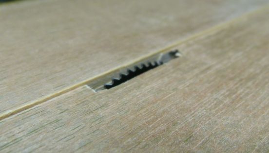

OK on with the gratings, I put a saw blade in my circular saw .5 thick, then ran a groove down a piece of 6 mm ply and glued a . 5 mm strip in the groove, then next to the strip I cut out a hole to take my circular saw blade, the hole is wider than the saw as to adjust from the strip (fence) for larger or smaller holes in the gratings. Fixed the ply to my saw and adjusted for a 1.3 mm hole.

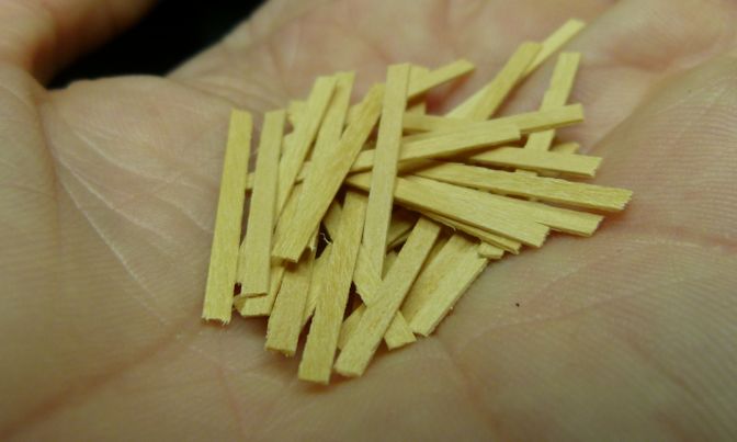

Next cut some .5 mm X 2 mm strips to about 20 mm in length, these are the pieces I will use to make the gratings
