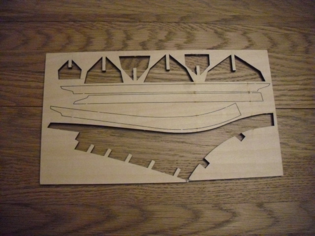

#328 Posted : 08 November 2012 20:34:17

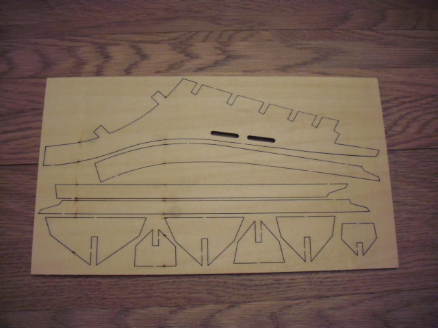

ISSUE 10 BUILD
And the parts are for assembling the ornate stem, and the Keel parts:-

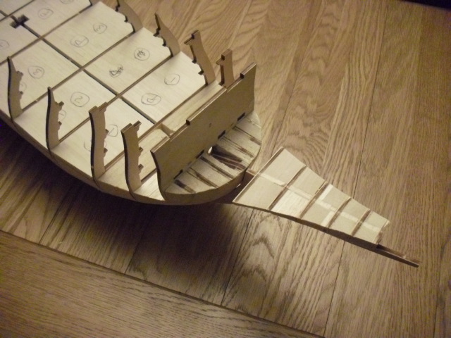

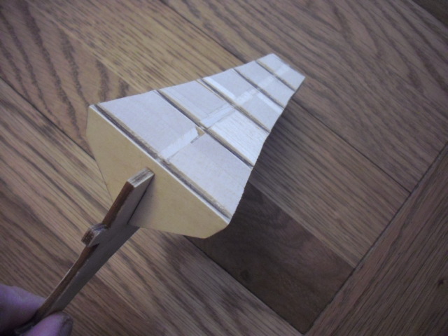

#330 Posted : 08 November 2012 20:41:54

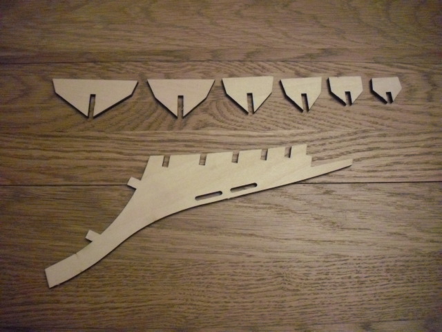

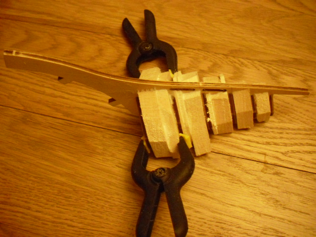

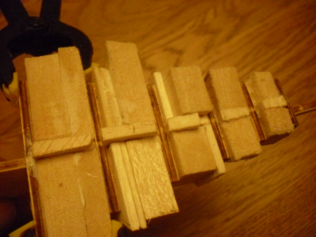

ISSUE 10 BUILD

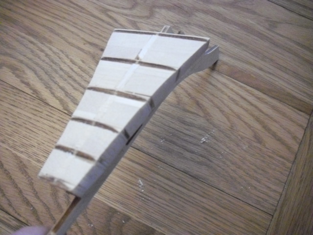

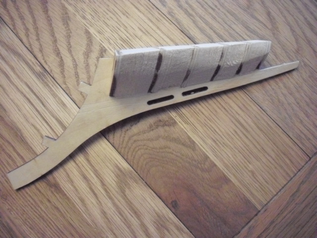

What comes next is the building of the parts together with the Balsa infill which (surprise surprise I prefer to do) and gives a very rigid stem piece:-

#332 Posted : 08 November 2012 20:53:32
ISSUE 10 BUILD

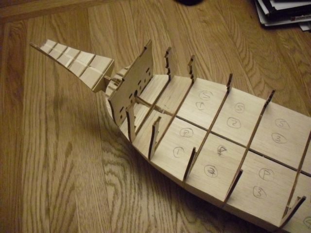

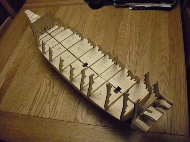

I will report on the build of the Launch later in my build.
Thats all for this session, Questions and comments welcomeBigGrin I will leave you with how the ship looks now, she is very solid with all the Balsa infills and planking will be so much easier Kind Regards Mike:-

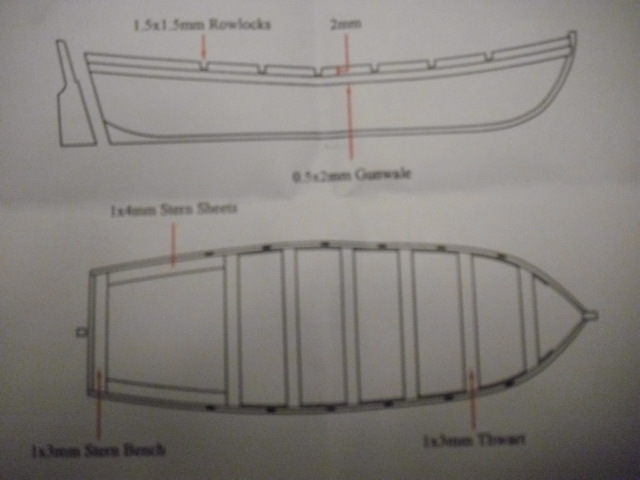

#339 Posted : 10 November 2012 10:14:29

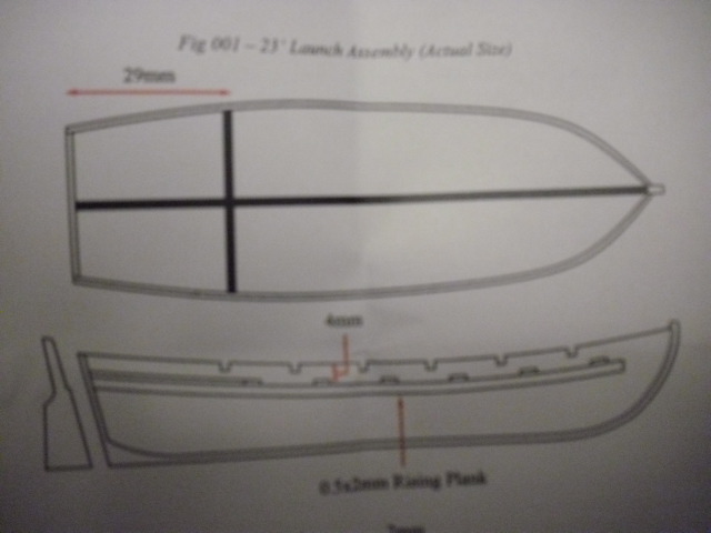

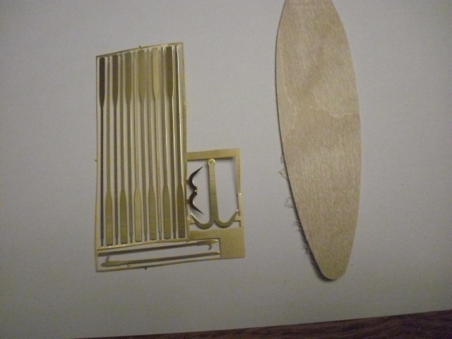

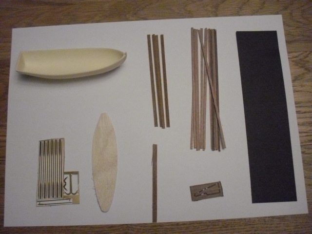

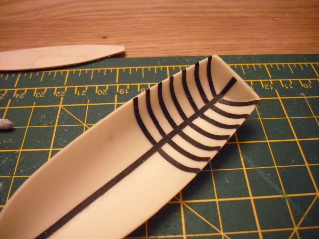

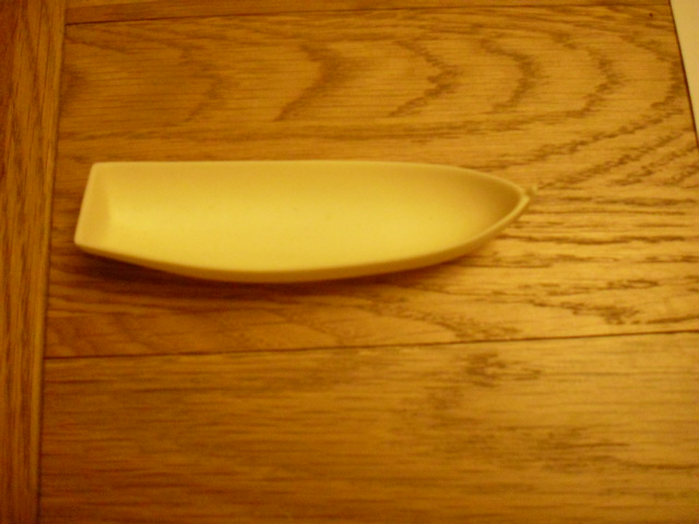

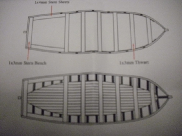

SOTS LAUNCH BUILD
Hi Team, here is the start of my Lauch build, I have sourced an alternative to the Ships Boat that is supplied by Deag in the kit.
I prefer the fact it has a resin hull, and the way the ribs are fitted, gives a better scale rib.
This is my preferance and I believe it enhances the SOTS, here is the launch kit:-
#340 Posted : 10 November 2012 10:18:06

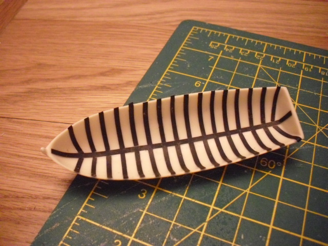

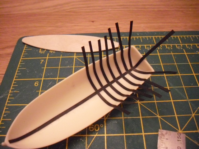

SOTS LAUNCH BUILD

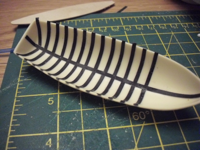

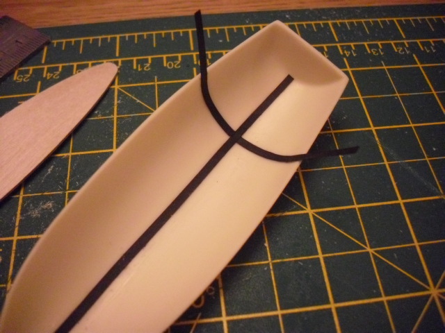

Using the computor paper (black) I cut strips 1.5mm wide and stuck them in the hull as per the instructions 5mm apart:-
