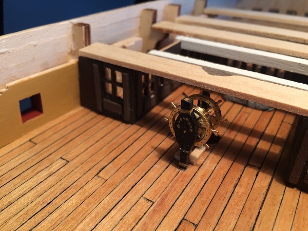

Thanks again! So here`s what i`ve done this Weekend.

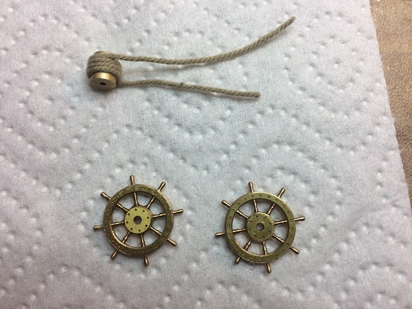

First up was the ships`s wheel. I purchased Mike`s enhancement quite some time ago and i must say this one really makes a difference! Each wheel consists of 14 small parts.
As i was sure not to achieve a matching colour on the metal i decided to leave the wheels in bare metal, which gives a good contrast to the surrounding wood.

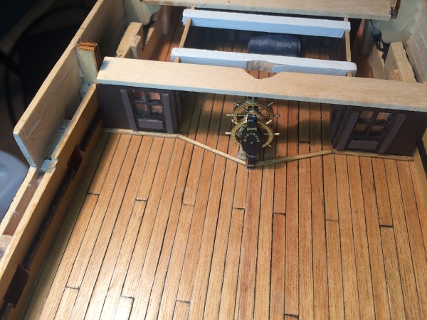

Also i corrected the backward wheel-support, added the steering-rope and the blocks through which they are guided as well as some painted details.
I added the decorations of the bulwarks and prepared the plastic sheet for the poop deck:
Finally i added the ledge (?) which runs from the cabin walls to the wheels (i guess that`s where the splinter guard was hooked in (?)) and scratch-built a mast-collar for the mizzen-mast:

#330 Posted : 23 May 2017 14:23:55
Thanks guys!
@Neil
For once the plastic sheet gives the whole deck more stability (e.g. with the poop deck there`s a gap of several inches between the last deck-beam and the transom).
But the main purpose is that is use 4mm deck planks which i lay in a particular butting pattern (you can see this with my main deck). This is hard to do without a continous surface. Otherwise you could only butt two planks where there is a deck beam.

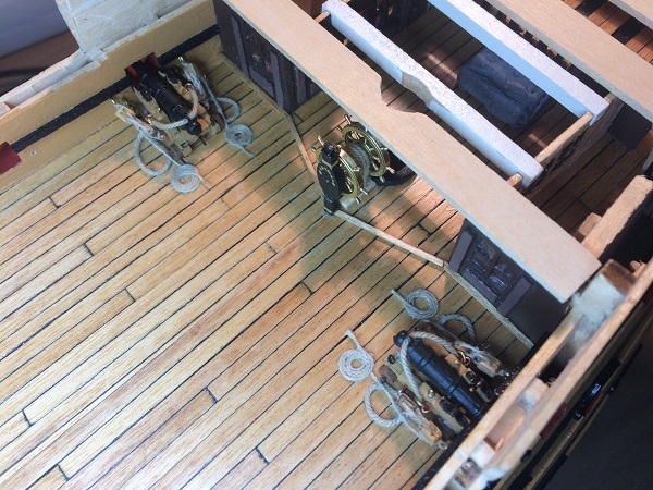

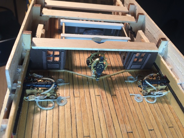

This is some minor update.
I prepared the guns for the main deck, installed the first two guns - as the area won`t be easily accessible once the poop deck is installed - and glued the plastic base for the poop.
Next step will be planking the poop-deck.
