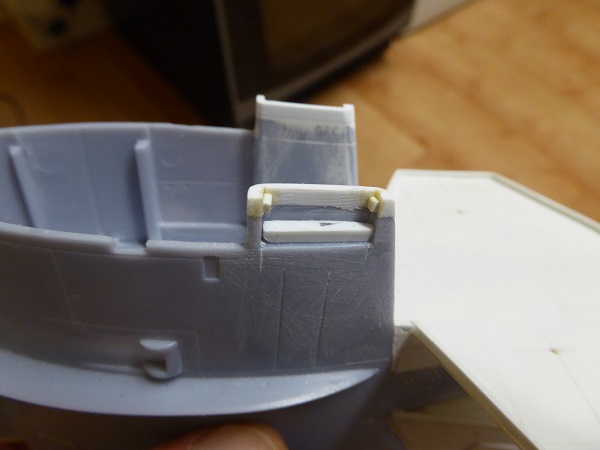

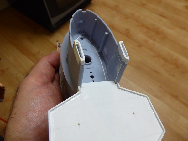

I then glued in two tiny blocks of 1.0mm square plastic strip to support the mesh grille.
#322 Posted : 18 October 2018 08:02:04
Using PVA glue I could position these small blocks so that the mesh grille sits flush with the top of the intake.
#323 Posted : 18 October 2018 08:05:24

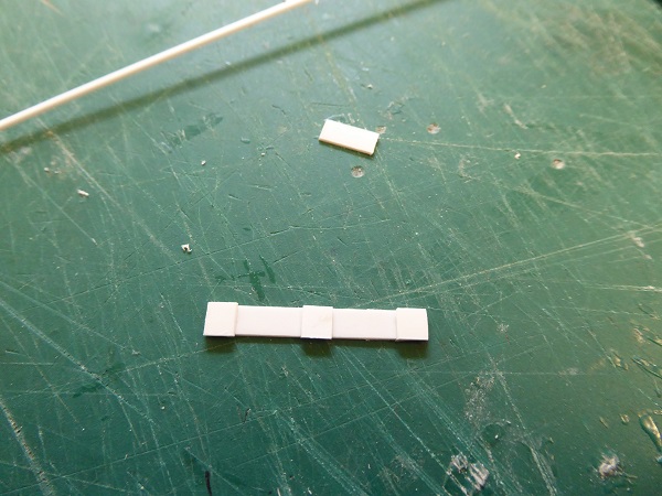

I then removed the mesh grille once I was happy it aligned correctly. I then glued in the place the small, support piece I mentioned before for the box section.
#324 Posted : 18 October 2018 08:06:31
The profiled box section piece mentioned at the start of this post was then glued in place.

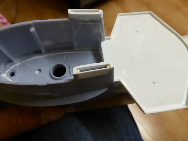

#325 Posted : 18 October 2018 08:08:00
Completed diesel engine intake box section completed on the port side.
#326 Posted : 18 October 2018 08:08:41
Starboard diesel engine air intake box section completed.

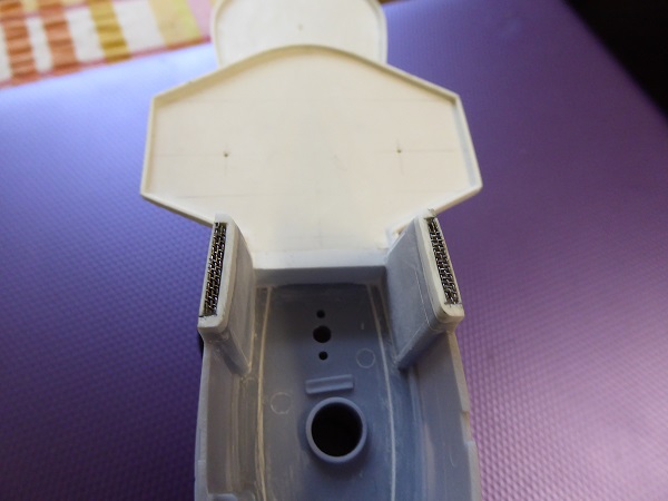

#327 Posted : 18 October 2018 08:10:36
Mesh grilles fitted to both engine intakes, completing this stage.

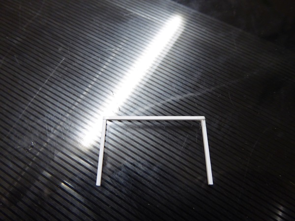

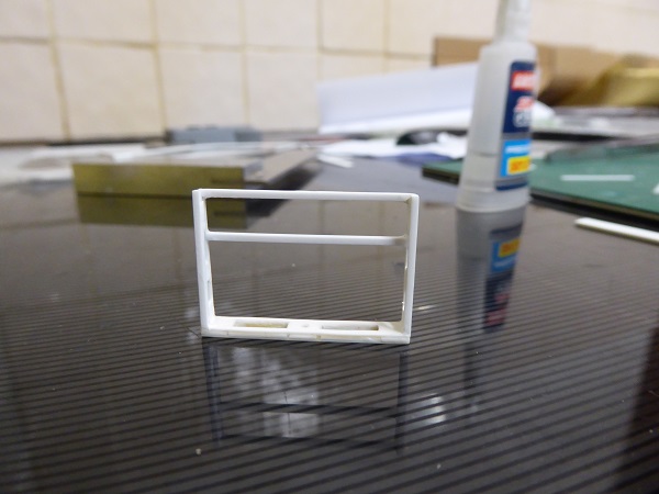

#329 Posted : 18 October 2018 08:21:16
Next job was to make the outer frame work using 1.0mm square strip. Very fiddly work I have to say.

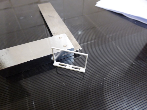

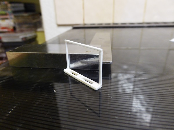

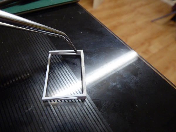

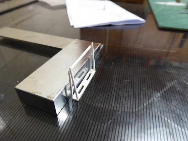

#330 Posted : 18 October 2018 08:23:35
Frame work completed and checked for alignment against an engineers square, or could it be goal posts for the crew!LOL

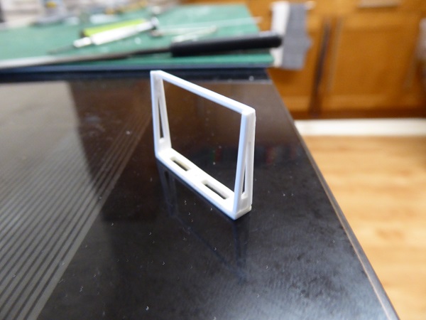

#334 Posted : 18 October 2018 08:29:48
Both angled supports fixed in place.

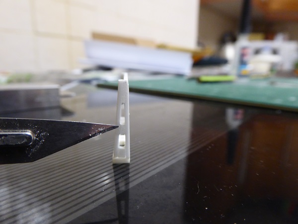

#335 Posted : 18 October 2018 08:31:59
I then trimmed the tops and added small sections, as indicated by the tweezers in this photo, to add strength to whole structure.
#336 Posted : 18 October 2018 08:33:51
The attached photo shows both of these small supports in place. They provide rigidity to the angular and vertical sections.
