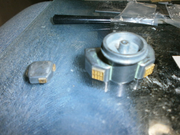

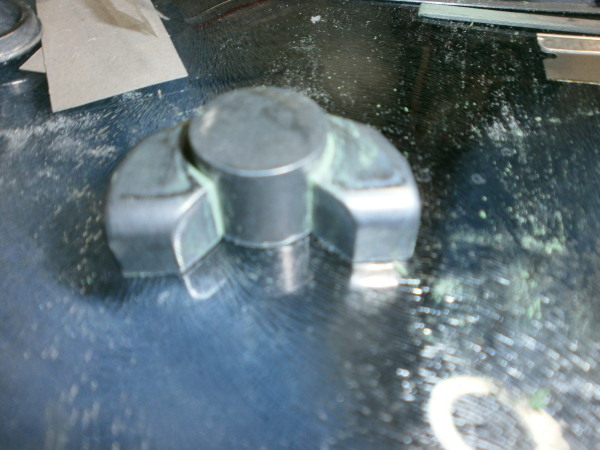

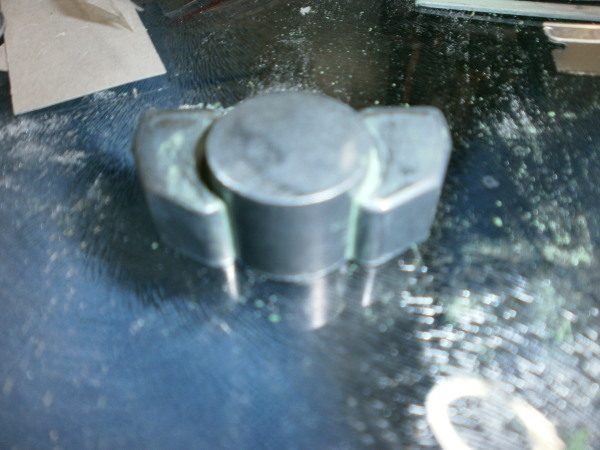

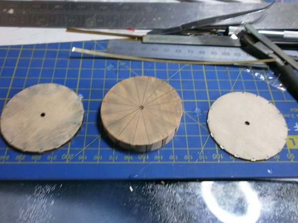

BigGrin Hi All

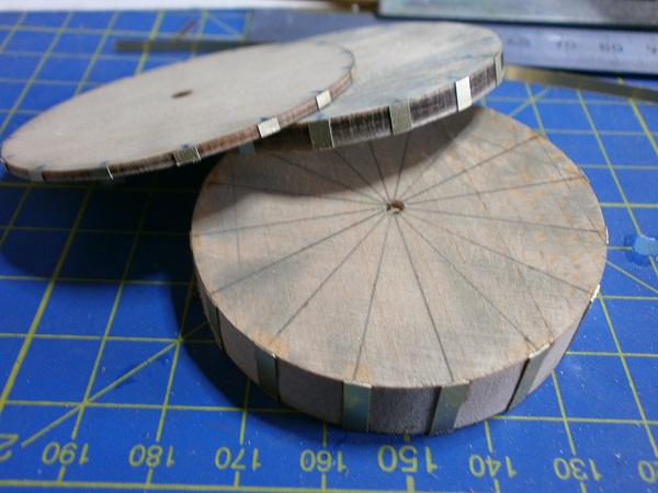

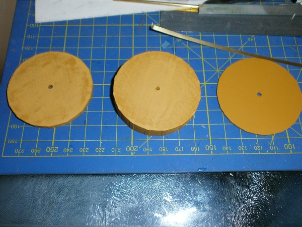

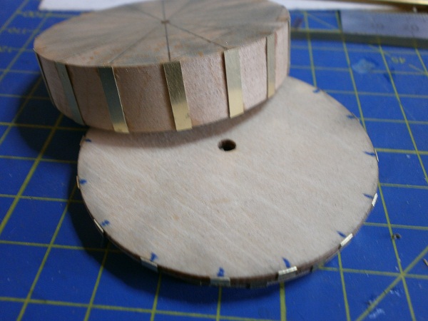

iv now finished the enhancments to the main gun barbetts by adding the outer plates cut from some brass sheet i had handy.Now its a bit of measuring to find the centre,s before final fitting.As always all comment/questions are welcome

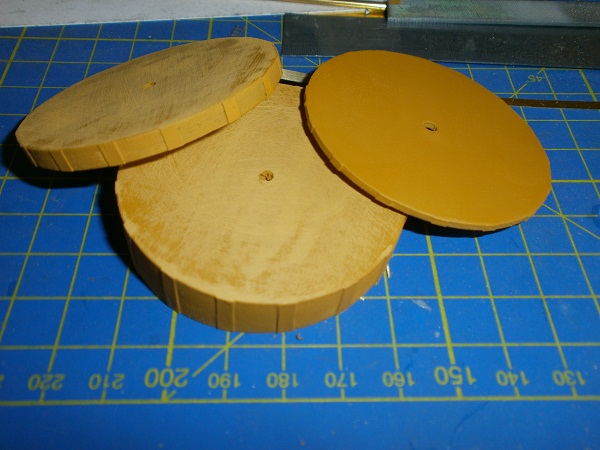

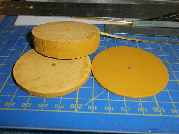

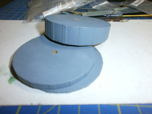

BigGrin Hi All

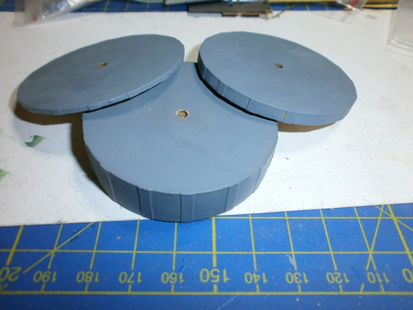

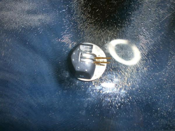

just a few more pics of the barbetts after given a coat of undercoat putty and the 1st coat of grey.Thats about it for this month as always all comments /questions are welcome

Hi there Andy, your build is looking the business, yeh gettin there mate. Just one thing I gotta say and hope you dont mind but it is a good detailed ship and I think you are on the verge of masking some of this detail by painting with a brush. Brushwork tends to be a bit thick in application,specially on really fine stuff and I think you would greatly benefit with applying an air brush to this one. I reckon you would see a marked difference in the finish and then you would be sucked into the world of the airbrush for everLaugh Cool . Good luck mate and keep it upBigGrin .
#330 Posted : 15 October 2012 17:15:53
BigGrin Hi Saintsman and Harty
Saintsman the 3 round objects are the 18 inch gun basesLOL Harty point taken and without offence but some parts of the ship would have had rougher finishes than other parts also im trying to represent/model a working ship not a perfectly renditioned clone.I did say that was the 1st coat of grey and this will be taken back to the finish i want before airbrushing,thanks again for the input

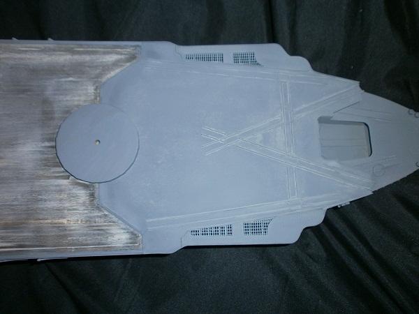

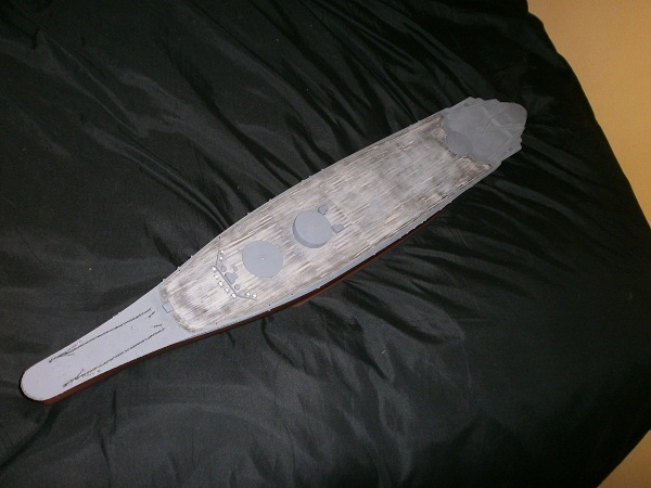

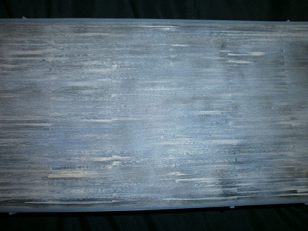

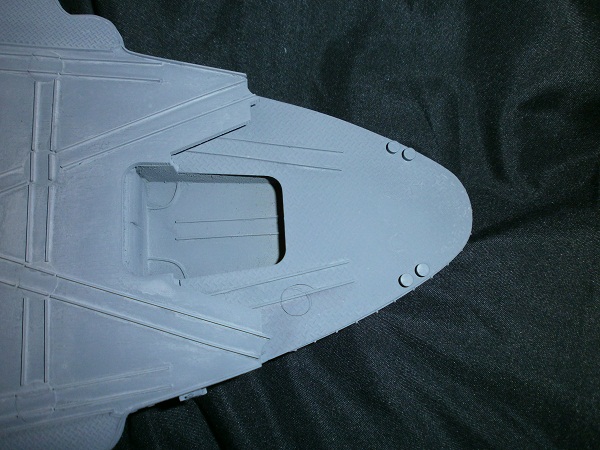

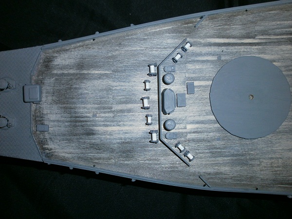

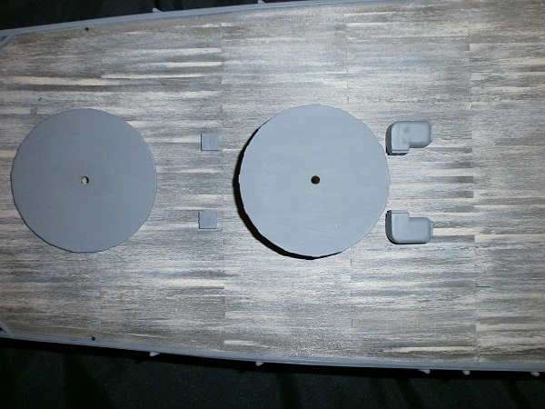

BigGrin Hi All
Im a little late with this months issues but i had some busy days lately.The 1st thing you will notice is the deck colour this is representing the Hinoki cypress used as the deck wood which over time weathers from an almost yellowy pine colour to a grey ashen type colour,of course not all wood is the same so some will darken quicker than other pieces hence the lights and darks of varying degrees.This was achieved by a 1st coat of light grey using rowneys acrylic inks 'cool grey' and after a spray coat of Tamiyas 'smoke',after fully dry this was sanded back to get the required finish,i think it turned out quite well.
After the deck was finished i started adding some of this months parts the Anchor chain was replaced with a slightly thicker type i had and the supplied chain used as the retaining chains,then it was add all the break water and reels to the deck and the supplied fittings. i deviated alittle here as 1 of the round air intakes was missing but after looking at my refrences there not that scale anyway so i used a couple of grommets [suitibly refubished] to make these parts as they gave the right profile unlike the supplied versions.There are also several hatch and deck covers that have been added but are not showed on the plans from the etch i have.As ussual all comments and questions are welcome

Yutaro HONMA
#335 Posted : 03 December 2012 02:14:46
Joined: 21/04/2012
Posts: 747
Points: 2,233
Location: Tokyo, Japan
Hi Andy!
Your Yamato seems also going well as the Shinano. Black wood deck is fantastic. I guess the bridge block will be attached in the near future. I am waiting for the next photos.
Best Regards,
Yutaro
#336 Posted : 03 December 2012 06:56:35
BigGrin Hi Yaturo
Thank you for your comments,the deck i think turned out quite well and with it being painted black for her previous night operation it looksabout right i think.As for the bridge assembly i have 4 months to go till i get all the parts

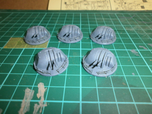

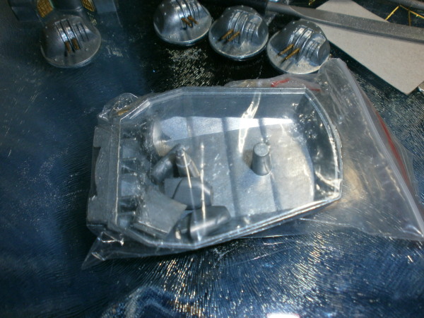

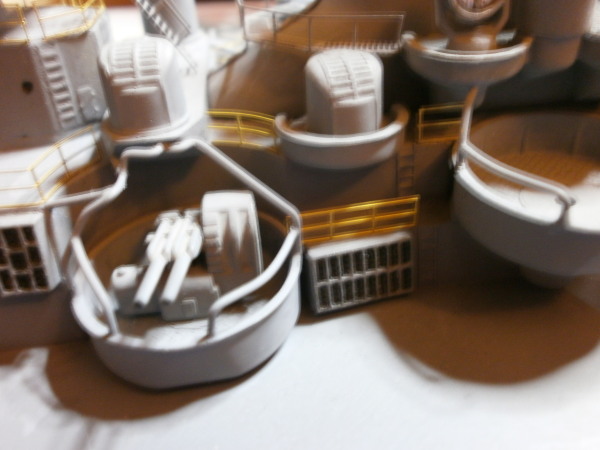

BigGrin Hi All

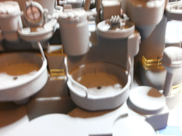

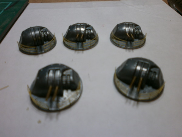

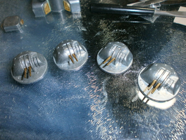

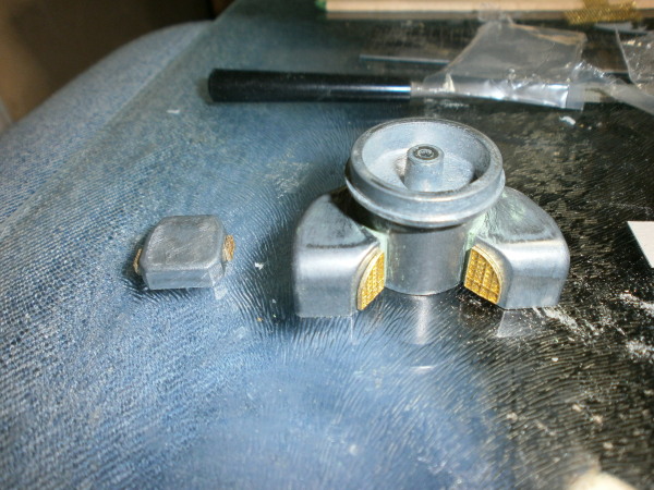

this month its mostly metal bashing on parts of the bridge guns and the rear 15 inch gun mount.The bridge guns haven't been painted yet as I have railings to add here,its the same for the main guns as I received the second one aswell but plan to make them all in one go and add the railings.There was also a rear vent box to add to the aircraft deck this will be added after painting and a pic will show its position.As always all comments/questions are welcome

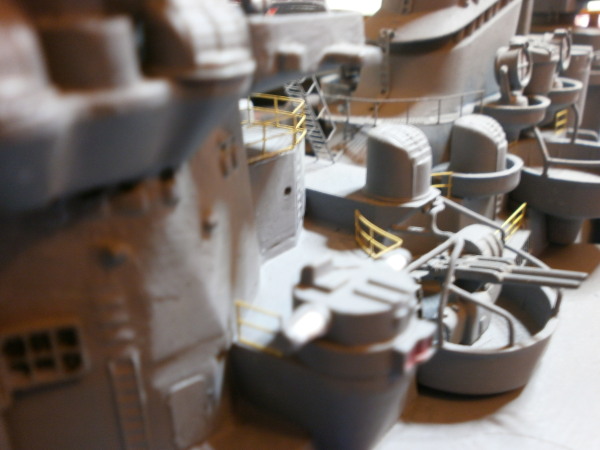

#338 Posted : 24 December 2012 20:19:16

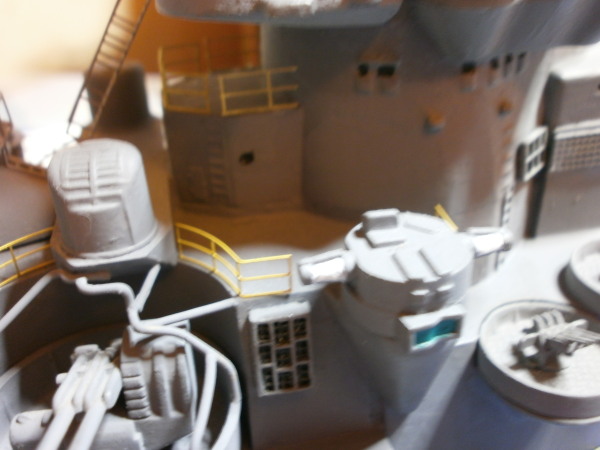

BigGrin Hi All
just a couple of pics to show the armoured anti aircraft guns with the railings fitted and the 1st coat of undercoat

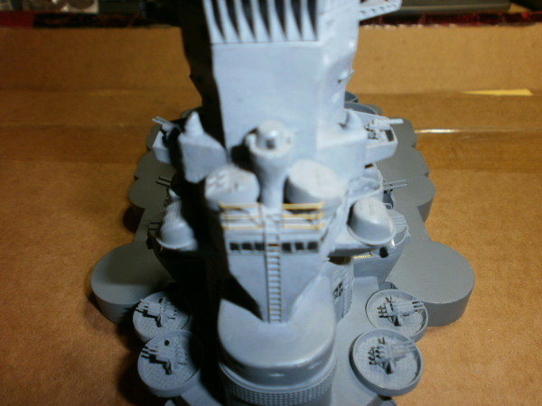

#339 Posted : 25 December 2012 21:56:08

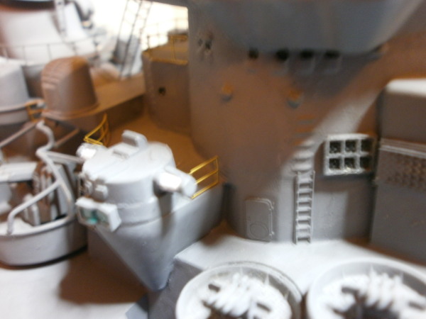

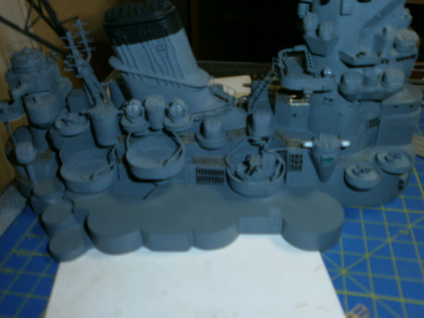

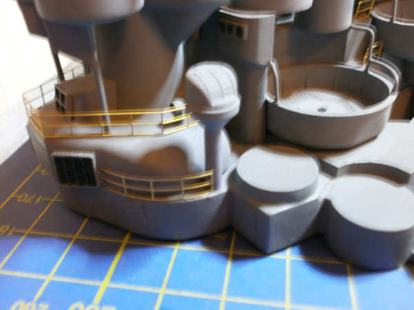

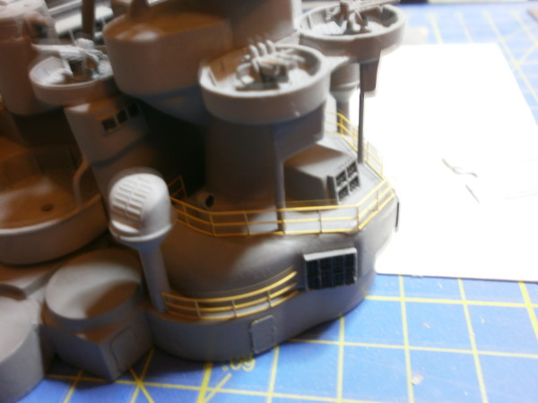

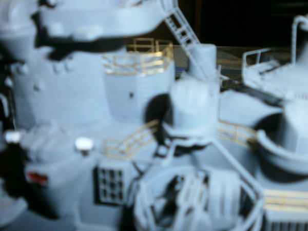

BigGrin Hi All

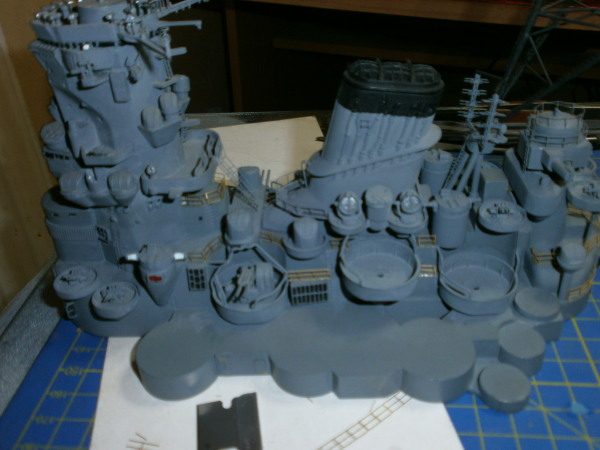

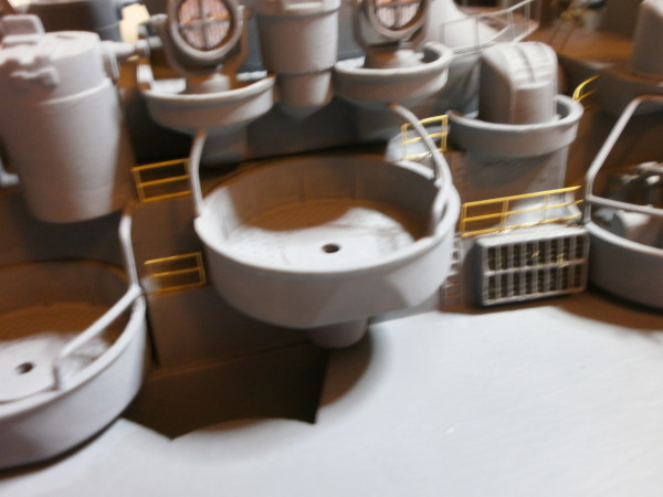

today I started adding the upper railings to the bridge island there are still more to add to the lower bridge and front face but these will be added as the guns ect are placed in the final positions. Sorry about the pic quality somedays they come out great others well not so good.As usual all comments /questions are welcome
