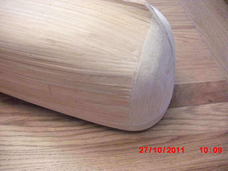

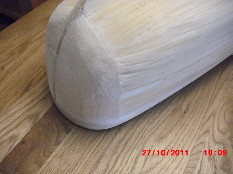

You can see cleariy now her bluff bow:-

Looking good mwg, noticed in the partworks model forum we will be getting the bow formers in parts 43 - 46 then the stern formers.
BigGrin
current builds
victory,endeavour,thermoplye,constitution
#323 Posted : 27 October 2011 12:57:15
Thanks for the info Alan, it is what I suspected.
Having done the enhancement I prefer it to the ply formers, it means all my hull has had the Balsa treatment and the next row of planking will have a better fixing.

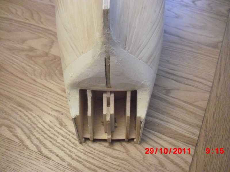

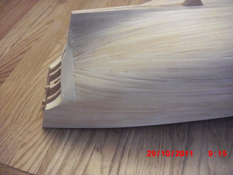

FORMING THE STERN.
Her rear is taking shape now, just a little more sanding to do with medium grade and finish with fine:-

#325 Posted : 29 October 2011 11:45:44
Joined: 17/03/2010
Posts: 301
Points: 941
Location: fife
looks good mwg, probably better than the official build aswell, wish i had the confidence to try myself.
current builds
#326 Posted : 29 October 2011 12:32:12
Thank you Alan, you can do this if you want to,I will help you, balsa wood is very easy to shape just follow my build, and ask as many questions as you like.ThumpUp

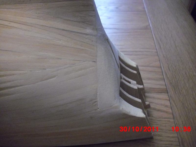

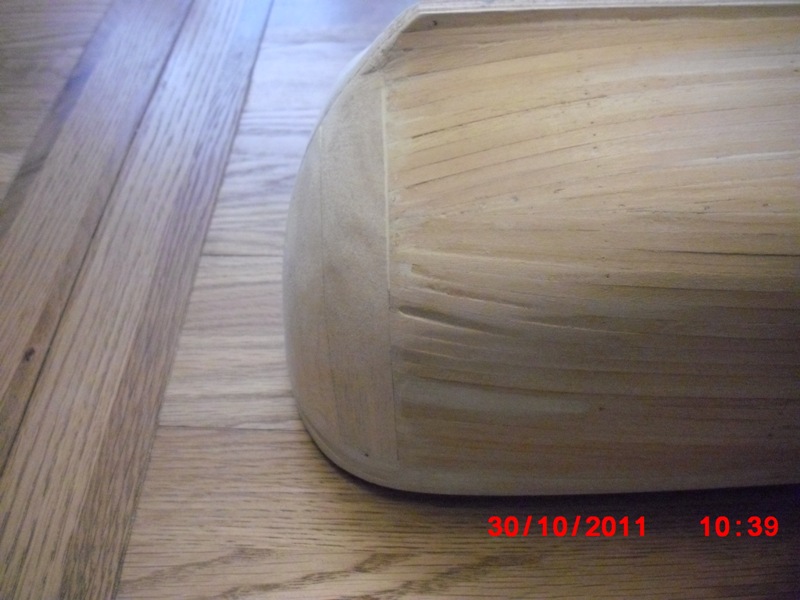

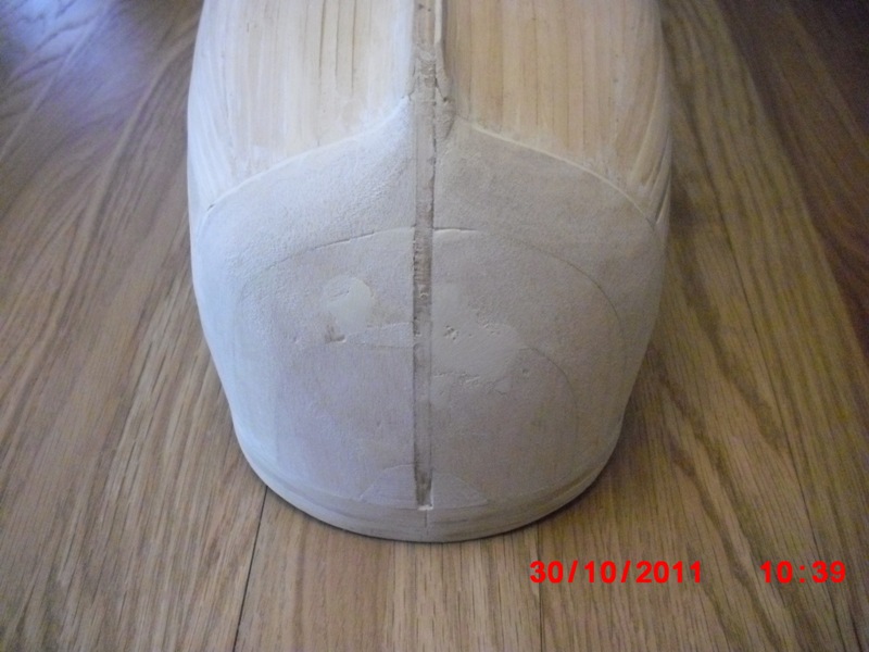

BOW AND STERN
Well the jobs finished.
All I have to do is sand the HullBigGrin Cool
#328 Posted : 30 October 2011 12:31:56
BigGrin Hi MWG
just wondering is it a double planked hull m8
#329 Posted : 30 October 2011 13:18:14
Yes it is Andy, The balsa has given me a good foundation for the 2nd plankingBigGrin Cool
#330 Posted : 30 October 2011 13:58:05
BigGrin LOL That explaines everthing as i was wondering how you was going flush fit the planks to those allready fixed in placeBigGrin LOL
#331 Posted : 30 October 2011 22:59:15
Hi MWG,
Good forward thinking MWG I feel with basla filling you can show your skills with planking and produce a better curve.
Regards tt64.
#332 Posted : 31 October 2011 09:16:12
You are Spot on tf64Cool BigGrin
