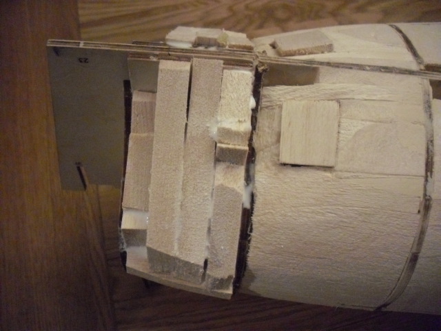

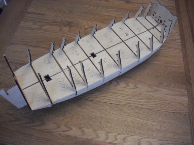

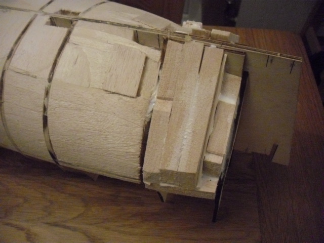

ISSUE 9 BUILD
Hi Team, continueing this section, you will see rib 26 has been fitted and the balsa has been filled between the ribs, please note not boxed as in the centre ribs but totally filled as in the Bow of the ship.
I start by cutting the wedges from 1/2inch thick balsa (the decks have already been fitted this time with the 1/2 thick balsa):-
#304 Posted : 02 November 2012 11:11:10
ISSUE 9 BUILD
Now a little trimming after the adhesive has hardened overnight:-
#305 Posted : 02 November 2012 11:14:37
ISSUE 9 BUILD

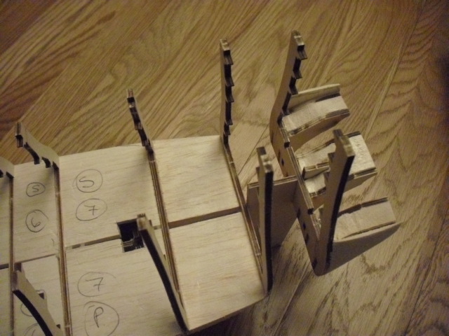

This is what she looks like at the moment, I only have to shape the stern, and the Hull will be finished:-

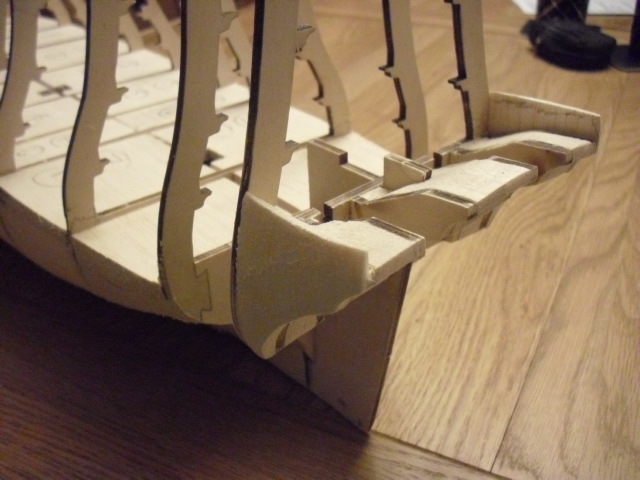

#306 Posted : 02 November 2012 11:18:40
ISSUE 9 BUILD
Thats it! for this session, all I have to do is assemble rib 27 with its relevant parts( leave you with the photos of that assembly)
Questions and comments welcomeBigGrin Thank you for looking in.
Kind regards Mike

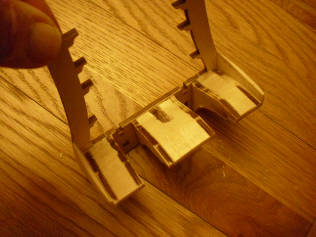

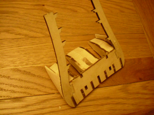

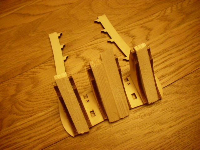

#316 Posted : 07 November 2012 18:20:45

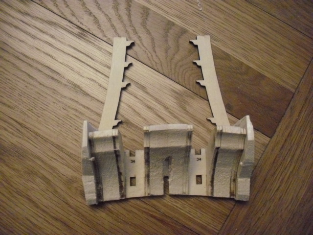

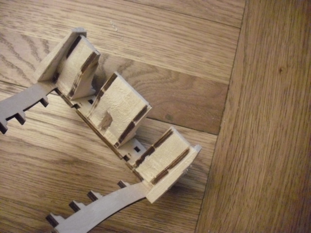

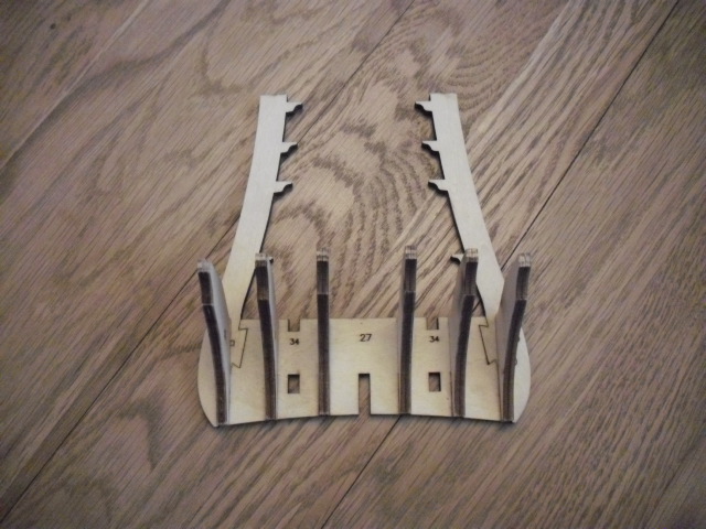

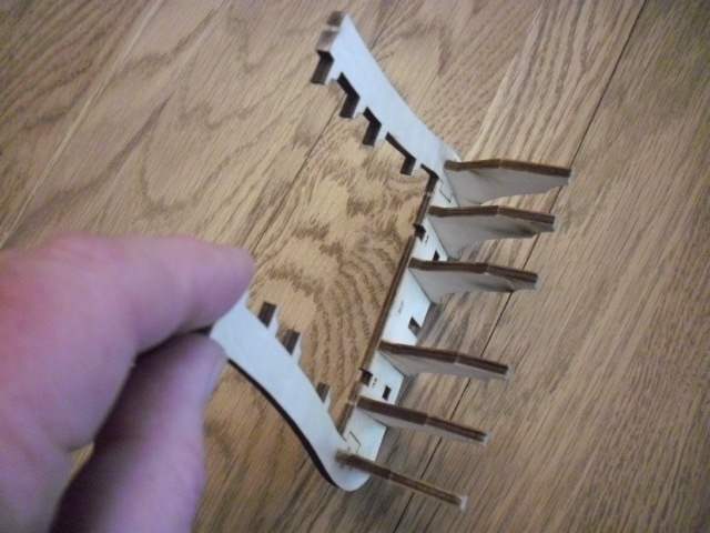

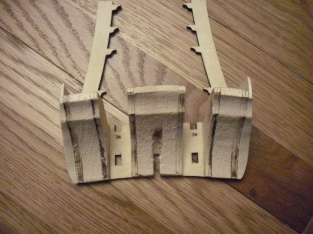

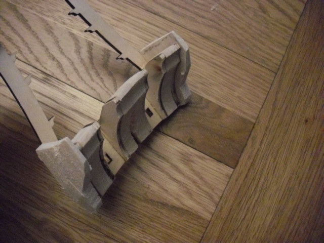

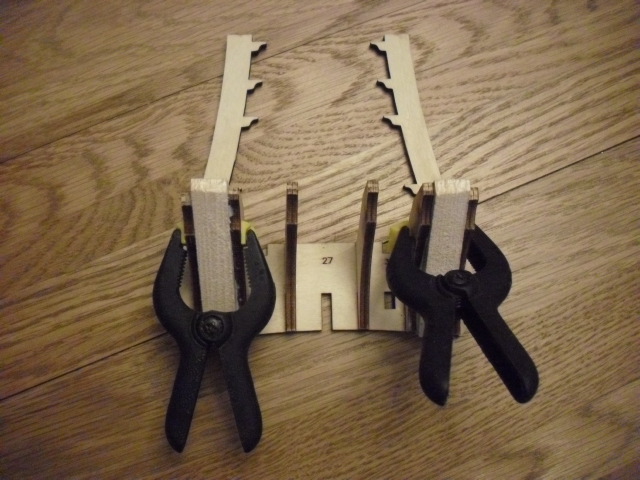

ISSUE 9 (BALSA INFILL RIB 27)
Hi Team I have now filled rib 27 with Balsa, I am really pleased with the result, I am going to show you lots of photos I am sure you will have no problem following the steps, I f you want more info pleases ask me. Here goes:-

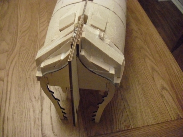

#317 Posted : 07 November 2012 18:33:17
Well that is all for now, questions and comments welcome, we have now finished ISSUE 9, so upward and onward to ISSUE 10.
I will leave you with how she looks now (please note the rib is not fixed with adhesive, just dry fitted)I have left the 2 slots with cutouts in them for I feel somthing is fitting in there (areas 34)if not I can fill them later.
Happy building Kind regards Mike
