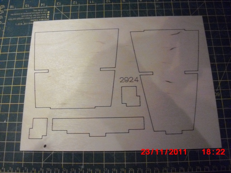

#303 Posted : 23 November 2011 19:48:57
ISSUE 13
This is what we received this week:-
#304 Posted : 23 November 2011 19:50:44

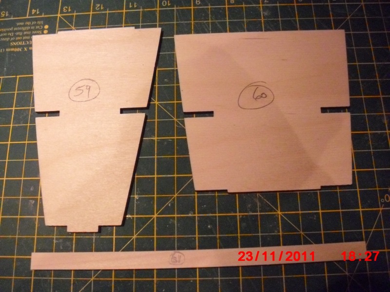

ISSUE 13

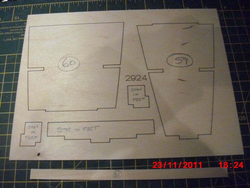

As usual I numbered the parts:-
#305 Posted : 23 November 2011 19:52:52
ISSUE 13
I then cut out the parts cutting from both sides of the fret,
and then sanded the parts:-

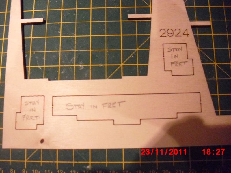

#306 Posted : 23 November 2011 19:54:45
ISSUE 13
Following the instruction I left some parts on the fret, to be used another time:-

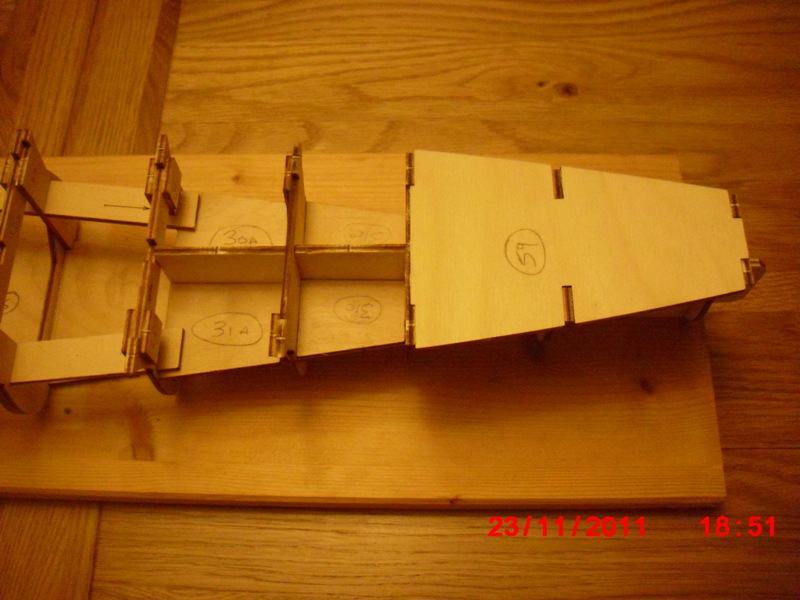

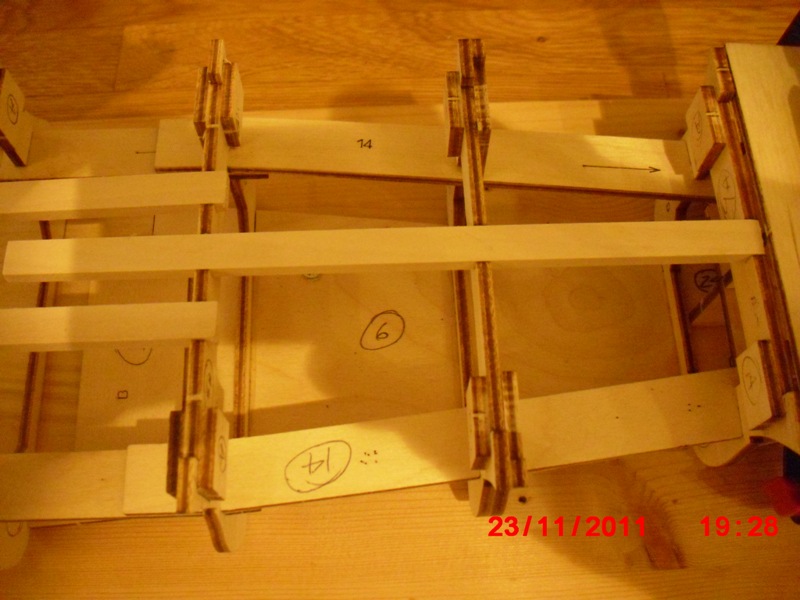

#307 Posted : 23 November 2011 19:56:47
ISSUE 13

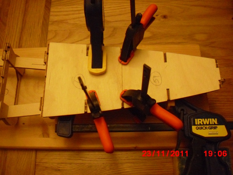

The again following the instructions I fitted the two parts 59 and 60 to the Bow:-

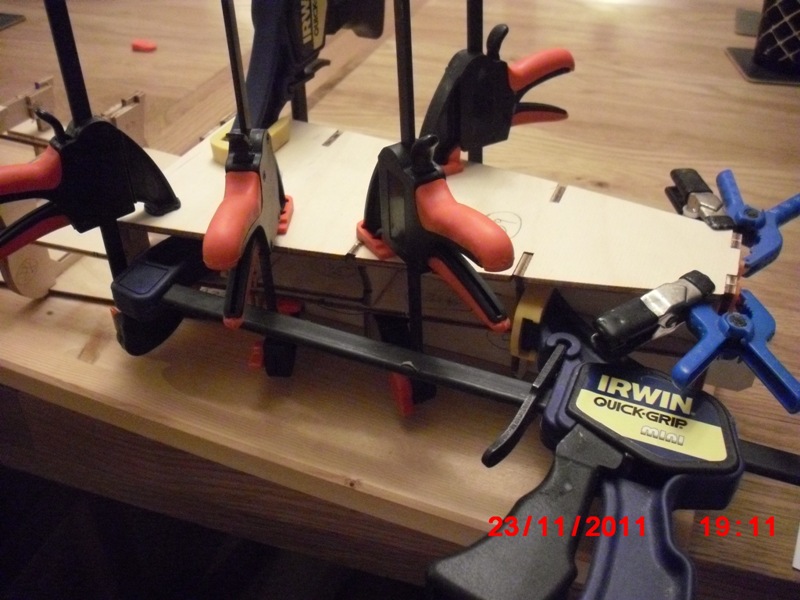

#308 Posted : 23 November 2011 20:04:10
ISSUE 13

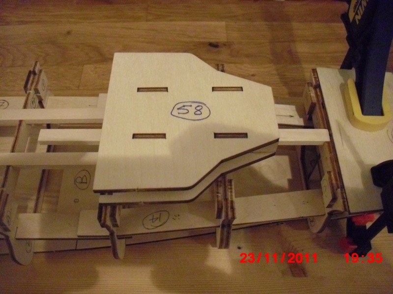

It is important to make sure the parts fit straight and true ,to this end I clamped the parts in place, Please make sure you use adhesive underneath the Bow parts you have fitted.
I then fitted part 61 making sure 5a 8a and 9a are free and not glued:-
#309 Posted : 23 November 2011 20:08:58
ISSUE 13

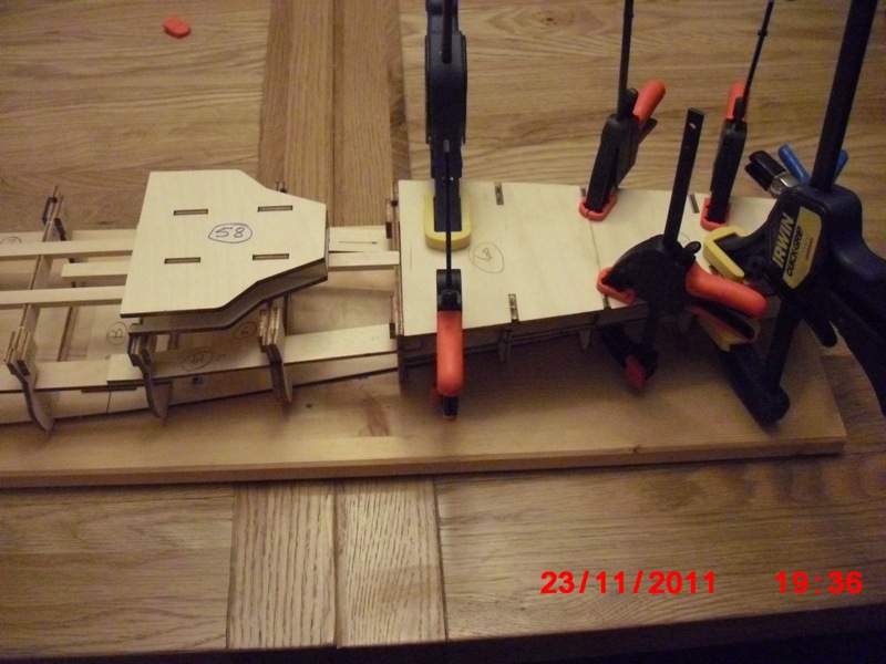

Next are photos of general appearance also showing where ISSUE 12 BUILD will fit (approx)
Questions and comments welcomeBigGrin Cool
A photo without the clamps will be shown tomorrow.
Thank you for lookingLove

#310 Posted : 23 November 2011 20:43:55
Joined: 20/04/2010
Posts: 545
Points: 1,536
Location: lossiemouth
Unsure is that new red clamps with reversing heads
#311 Posted : 23 November 2011 20:49:44
Hi Willie yes they areBigGrin Cool

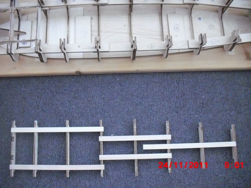

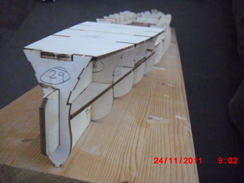

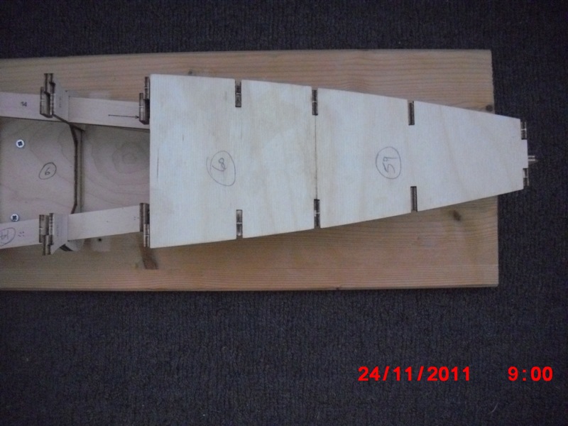

#315 Posted : 24 November 2011 09:13:41
ISSUE 13
As promised the photos of Issue 13 build finished:-

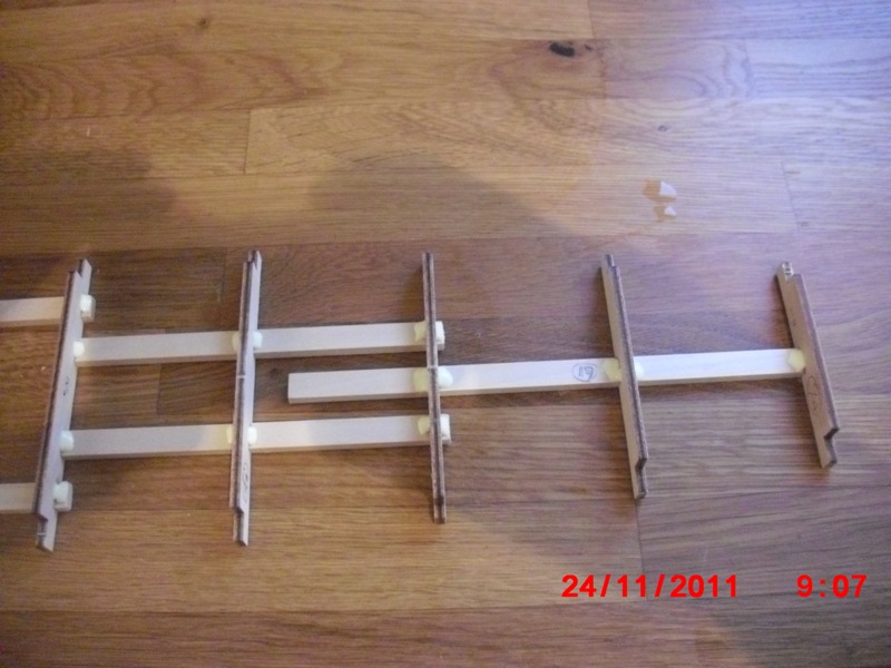

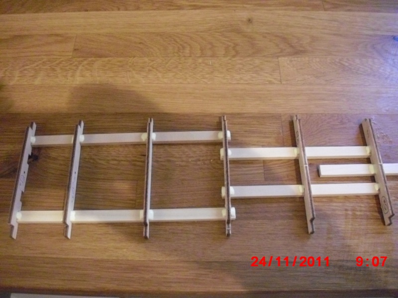

GENERAL WORK
I decided to take out the removable centre part. turn it over and add some adhesive to all the cross member joints, this was to add some strength untill we add the deck parts:-
#317 Posted : 24 November 2011 09:21:59

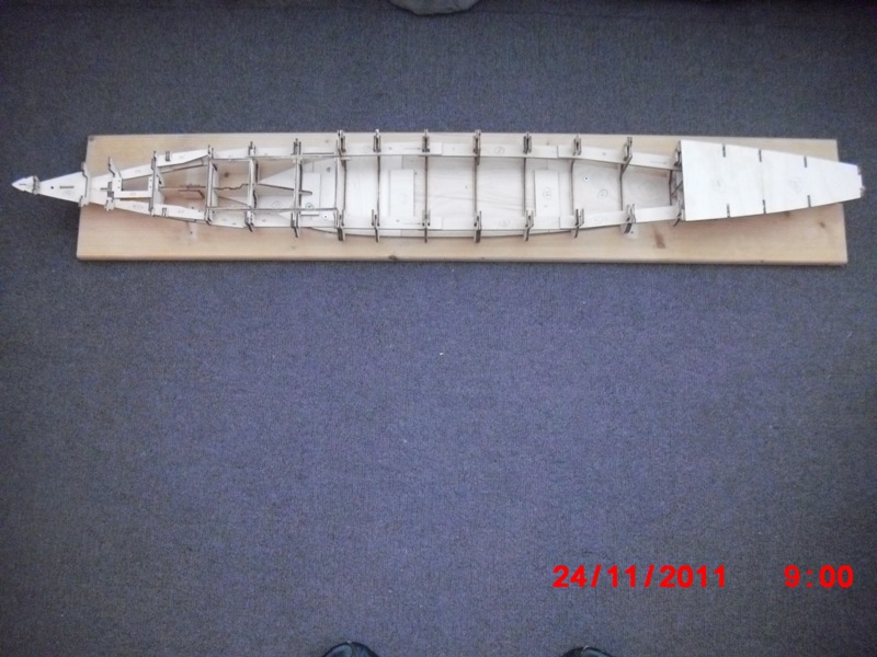

This is how she looks at the moment:-

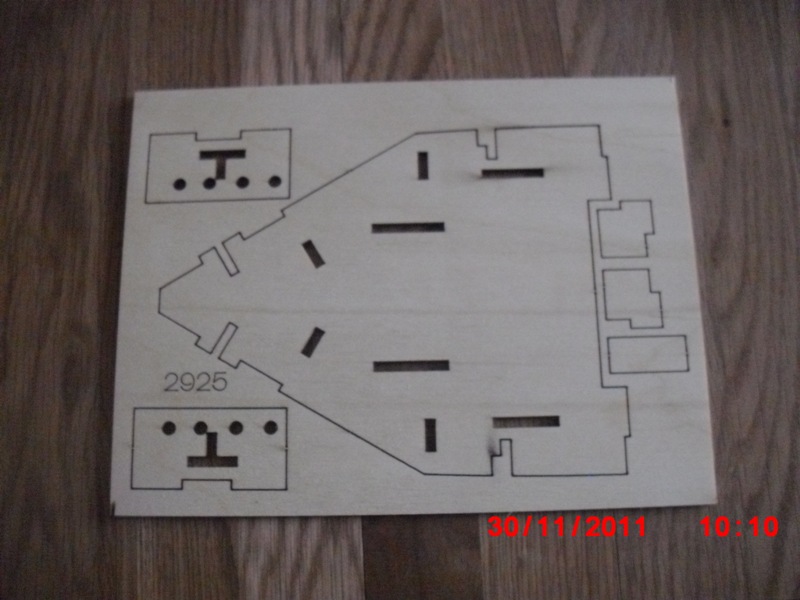

#320 Posted : 30 November 2011 14:33:18
ISSUE 14 STERN CABINS
This is what we received today:-
