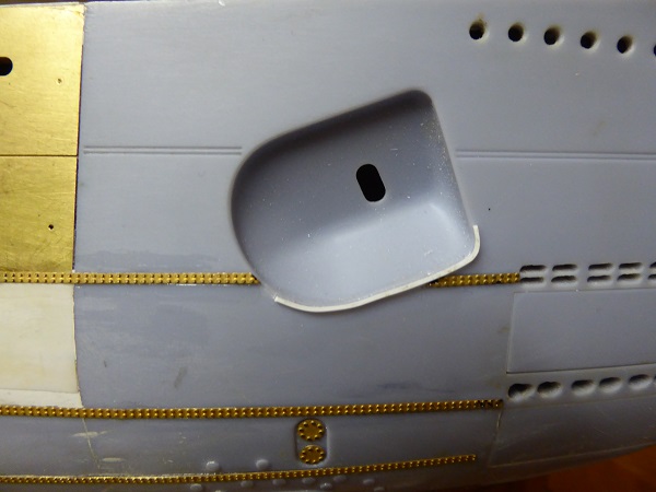

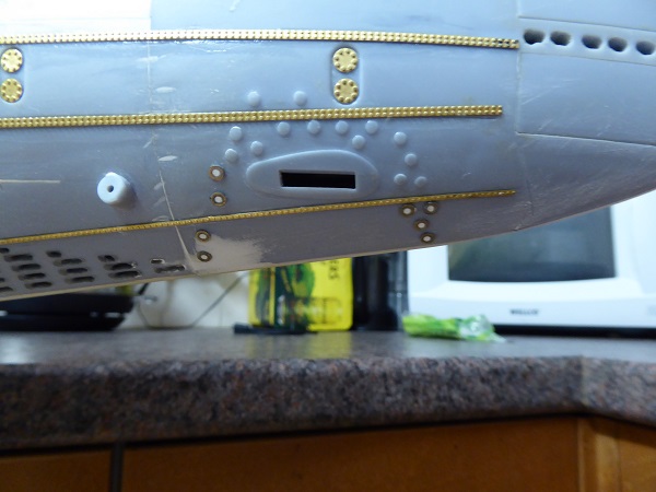

On this part of my build I will be looking at the part-works supplied photo-etched rivet strips that fit around the bow plus some modifications I added.
The attached image shows the anchor-well on the forward starboard side of the bow. I added a 0.5mm plastic strip around the bottom of the anchor-well to resemble the raised lip or edge on the real thing. This was to prevent the anchor from damaging the hull as it was lowered. The raised lip insured the anchor would initially project outwards.

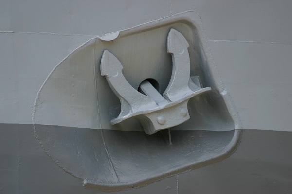

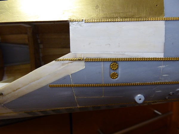

The attached image shows the same raised edge on U995's anchor well.

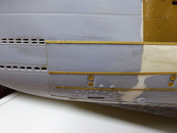

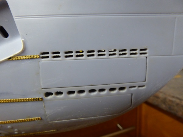

The next image shows how I drilled and filed out the free flood holes on the starboard forward bow. I also chose to represent the torpedo tube doors [bow flaps] in the shut position. This took a bit of work as I had to grind away a lot of the fittings behind them to allow a flush fit.
#309 Posted : 09 March 2017 09:12:12
This image shows a close up of the part-works supplied rivet detail. I found these strips to be very delicate, especially when trying to file smooth the rough edges left when it was parted from the fret board. I also had to rough the underside with 100 grit sandpaper it give it a better chance of bonding. My method was to apply a thin smear of PVA to the underside and hold it place using tape while the glue dried overnight. Once dry I ran a bead of superglue along all of it's edges to really bond it down firmly so no edges would accidentally lift away while handling.

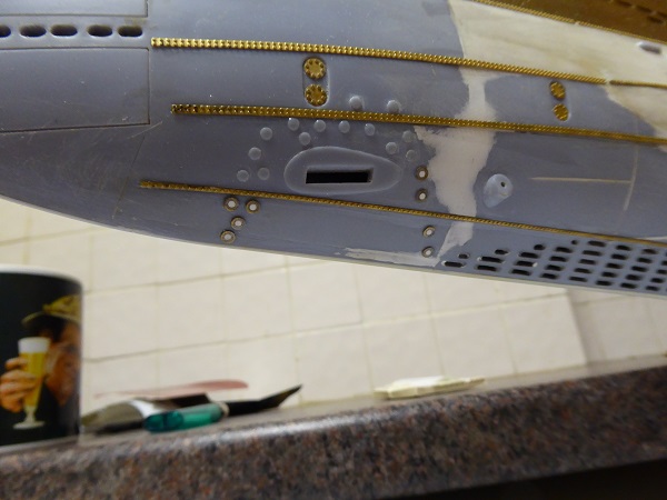

This image shows the port side of the bow, again with the free flood holes opened up and the bow flaps in the shut position.

Another image showing the port side bow rivet detail.

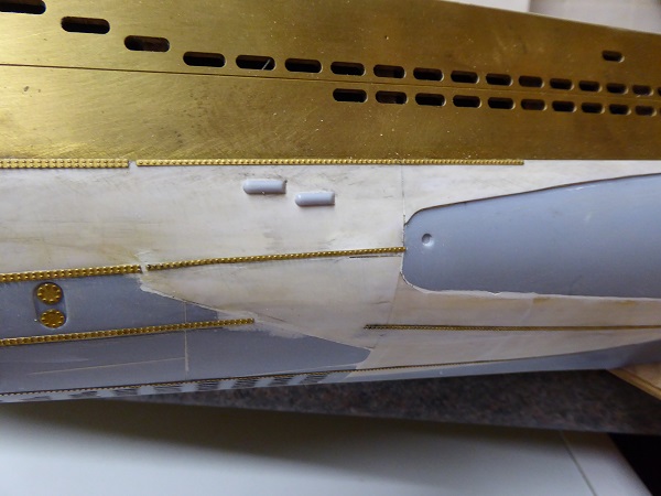

This image shows the hydrophones on the port underside.

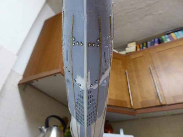

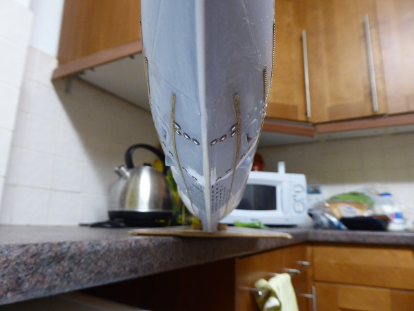

This image shows the bow from underneath. You can the see the rivet detail and the arrangement of the hydrophones.

Another underside shot.

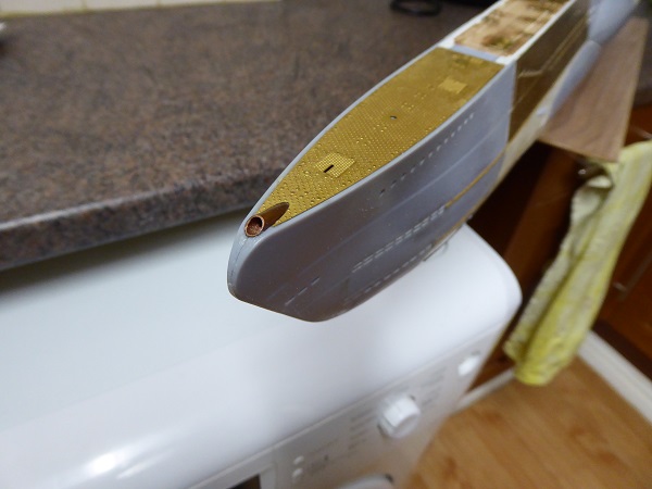

This final photograph shows the part-works supplied copper tube cut and fitted in place. This copper tube represents the forward mooring/ towing hitch.
