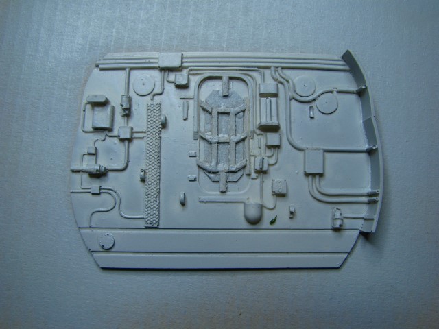

I was very impressed by his work on the bulkhead door to the torpedo room, and looking at my own resin part, it did leave something to be desired, so I decided to have a go at some sort of modification of my own.
I have to say right away that my attempt is nowhere near as impressive as the work Graeme did on his and I also used different materials.
I used a piece of card cut from a cereal box for the door inlay and offcuts of 1 x 1mm square wood cut down for the details.
Picture 1 shows the resin part as bought
Picture 2 shows the illustration from the cover of one of the magazine covers to show how it should look.
Picture 3 shows the modification before priming, and
Picture 4 shows the work after the primer coat.
As I said the mod doesn't come close to Graeme's superb workmanship and I may well strip it down and retry it using something other than card as the painting seems to have reacted to it.
That's it for now. Thanks for looking in and, as usual, comments welcome.

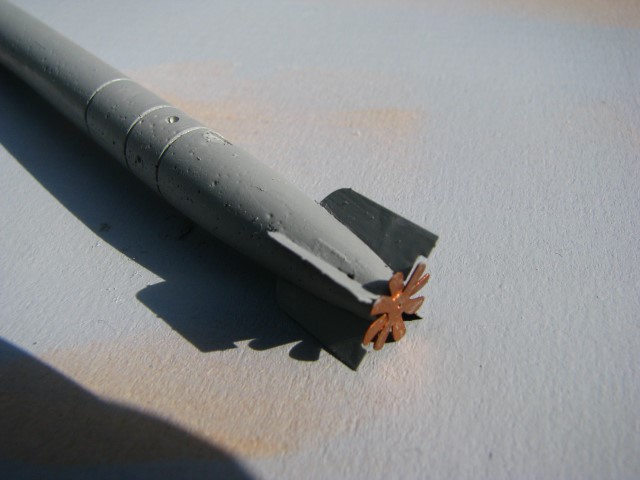

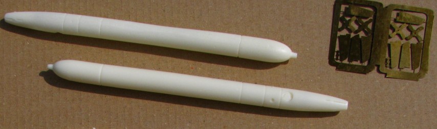

FIRST ATTEMPT AT TORPEDO
Hi again,
Thought you may like to see my 1st attempt at the resin torpedo kit.
I'm going to re-build it as I'm not happy with the pitting on main body of the torpedo, I guess it's something to do with the way the resin parts are made and I've never used this medium before.
It was quite a simple kit with just a 1-part body and a small set of P.E. for the propeller and hydrofoils.
It was painted with Revell #95 bronze and Humbrol matt grey.
Just a few pictures of the finished item.
Thanks for looking in, more next week.
Happy building
David

#305 Posted : 30 July 2015 20:34:38
BigGrin BigGrin Hi David
Looks great and nice work. With resin parts there is the chance that air bubbles can be trapped in the resin during the casting process this can show up as the pitting or little holes, also it may be the sign of someone using a worn mould to extract as many parts as possible. Mr Hobby do a dissolved putty and a resin surfacer that may help in getting a better finish, links below,
http://www.ebay.co.uk/itm/MR-HOBBY-GUNZE-SANGYO-RESIN-PRIMER-SURFACER-40ML-RP261-/180869012882?pt=LH_DefaultDomain_3&hash=item2a1ca21d92
And
http://www.ebay.co.uk/itm/MR-HOBBY-GUNZE-SANGYO-MR-DISSOLVED-PUTTY-WHITE-40ML-P119-/171059267975?pt=LH_DefaultDomain_3&hash=item27d3ed4987
Hope this helps

#306 Posted : 30 July 2015 22:07:37
Joined: 08/07/2010
Posts: 1,036
Points: 3,086
Thanks for those links Andy, I'll certainly order some of that and give it a try. Thanks again

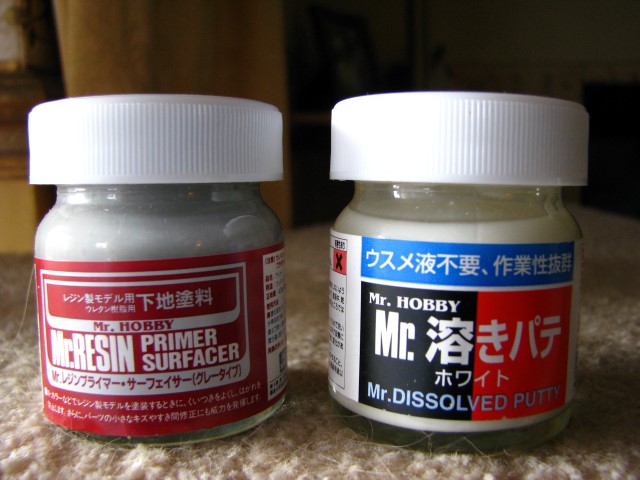

BUILD UPDATE
Hi, and welcome back to a quick update.
The resin torpedoes I bought had quite severe pitting along the length of the main bodies.
Andy (arpurchase) spotted the problem and recommended a couple of products called 'Mr. Dissolved putty' and 'Mr Resin Surface Primer' by 'Mr. Hobby'.
I took his advice and went ahead and ordered some, and they arrived in today's post. So I can now make good all those imperfections in the resin parts before moving on to paint them (busy with the first lot of second planking as I write, so another build update will here shortly).
Thank you Andy, and thanks to all for looking in and leaving comments, especially Michu for that great site he found with some amazing pictures of a Type VII u-boat. Thanks again Michu.
Happy building
David

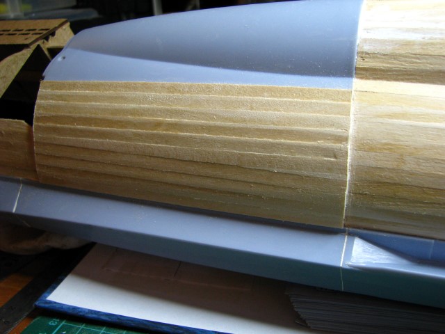

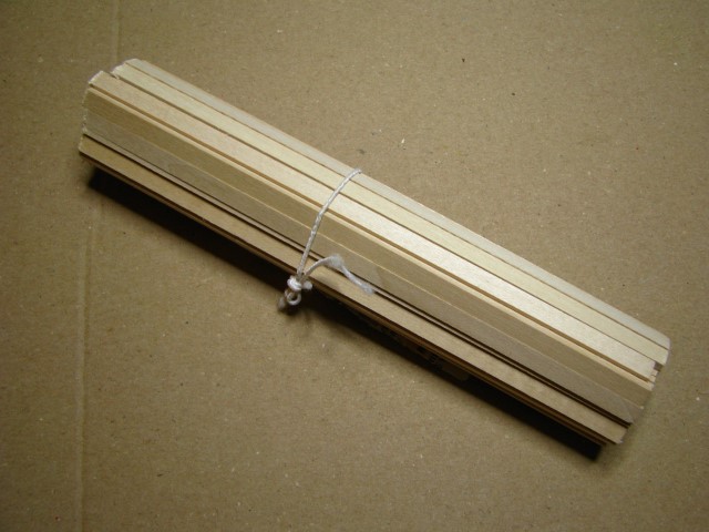

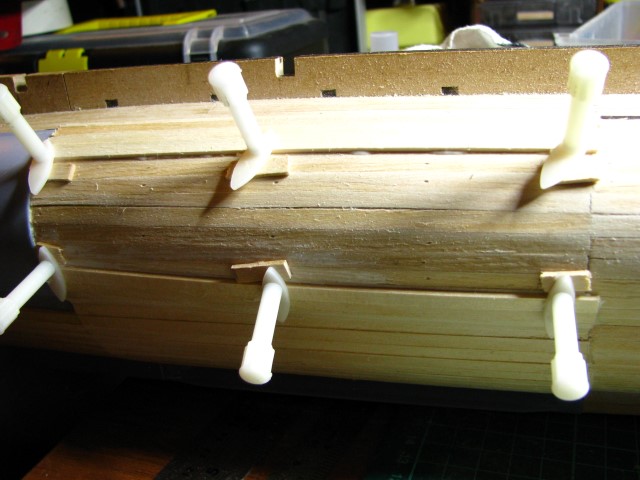

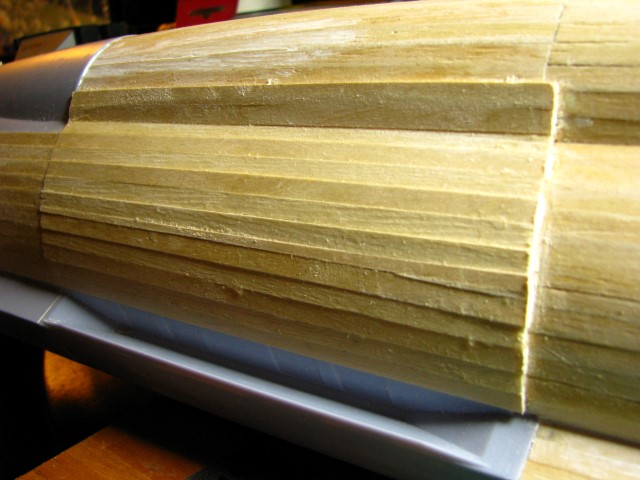

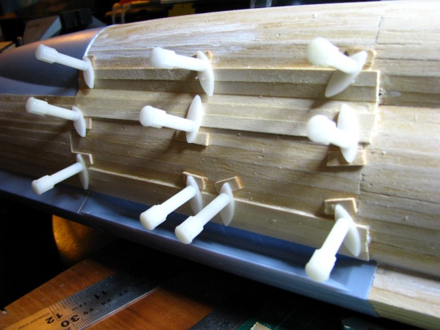

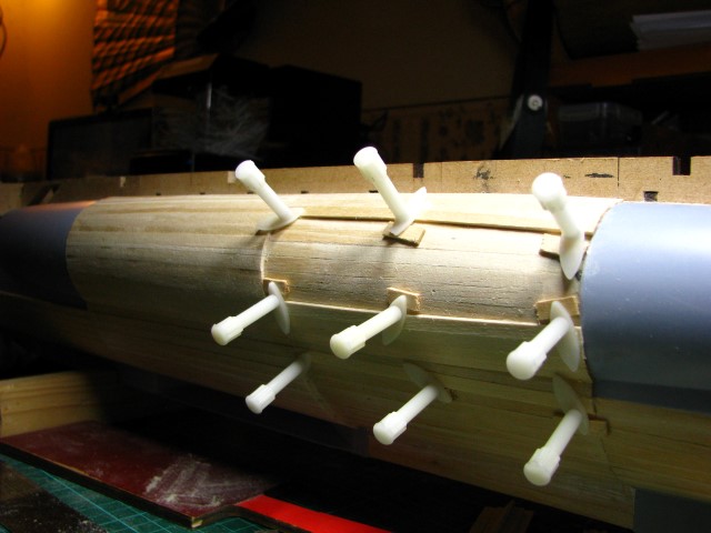

BUILD UPDATE #44
Welcome back to another build update of U-96.
This week sees the beginning of the second layer of planking on the hull.
Issue #44 came with a bundle of 1.5x5x160mm strips.
Work commenced on the left-hand side of the hull (the side without the cutaways)just aft of the bow section which is being left un-planked until the work on the torpedo room conversion is completed.
Over several days, I worked back from the bow covering the lower hull, upper hull (saddle tanks forward), lower hull, upper hull (saddle tanks rear), and finally the lower hull rear with the addition of planking the mid-section of the keel, using the 1.5x5x160mm strips throughout.
After completing the work, a light sanding was applied just to tidy things up a bit. The following images show the work-flow throughout the week.
That's it for now, thanks for looking in and comments welcome.
Happy building
David
