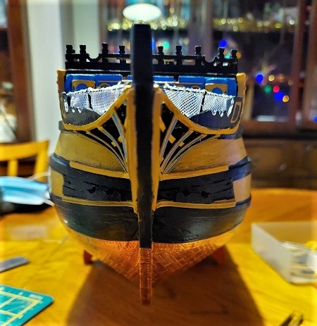

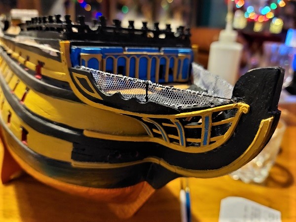

After painting the thread and stanchion black i made a template for the netting and then with a very sharp knife and a steel rule cut the netting, the top was sewn on first by doing a bit then a dab of superglue, doing a bit more and more superglue, the bottom of the netting proved to be a lot more difficult so i put a spot of superglue on a couple of places to keep it from moving around and them sewing it up, so about 4 hours later one side is done, now i need to rest my eyes.

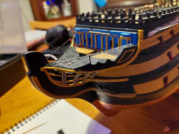

The netting is done on both sides and the squiggly bits are on( still don't know what they're called, anybody ? ), next up is the ekeing rails, i think i'm going to have to build these from scratch as the Heller ones are too short and they thin out at the ends, but they'll be a good pattern to work from.

Excellent work Paul, looking very nice.Love Drool Drool

I couldn't find any reference to the 'sqiggly bits' in my huge Alan McGowan Victory book, the DelPrado instructions weren't much help, only calling it 'decoration' but then I found it in the John McKay 'Anatomy of the Ship' book on Victory - it's called the 'False Rail'!BigGrin
Strange name but I suppose it rolls off the tongue a little easier than 'Untrustworthy Barrier'!LOL

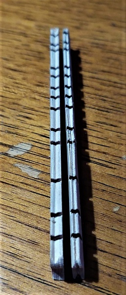

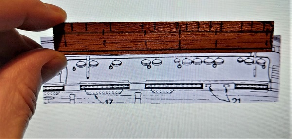

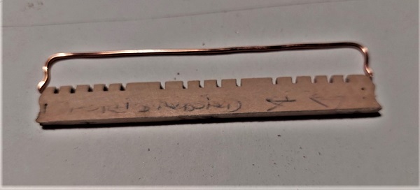

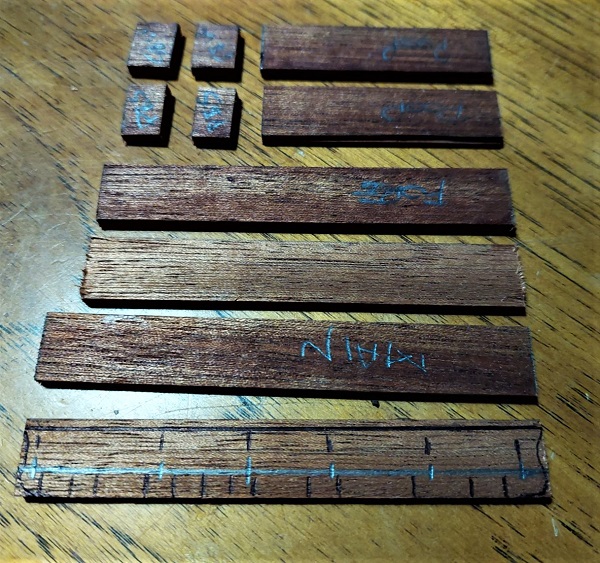

After going through my stash of off cuts and bits of wood i couldn't find any soft wood for bending that would do for the Ekeking Rail so decided to start work on the Channels, i had some 15mm X 2mm Tanganyka that i had bought for the 1/84 victory stuck them together to make it 15mm X 4mm then using the John Mckay book Anatomy Of The Ship i measured the pictures of the channels and multiplied them by 1/192 then divided by 1/100 to give me the correct sizes, i then took pictures of them and using MS publisher, changed the sizes on screen to give me where i needed to cut and drill for the deadeyes and bolts.

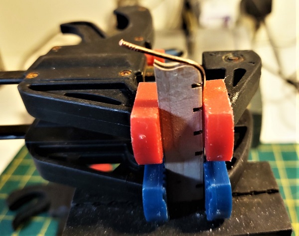

Thanks for that, my first effort didn't go to plan so have ordered some 3mm softer wood than the tanganika for the channels, they turned out to be too thick anyway, i tried cutting the slots with my Proxxon table saw but just couldn't get the depth to be uniform so my plan is now to put it in the vice to a certain level and find a thicker saw blade to do in one cut, so onto plan B.

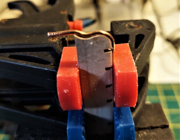

Coming on really well there Paul! I had to look back through my diary to remember how I did the slots on mine. Turns out I did them in a mini vice but with the pair of channels from port and starboard gripped together so they would both have mirror image slots as far as the spacing was concerned, and with the slots filed out with a flat diamond dust file.

Ah thanks Robin, i put a larger thicker blade in my Proxxon table saw and because of the etch i bought which is a bit thinner i think that'll do the trick, i've had a bit of a play and it seems to work OK but will probably need stronger glasses to get it bang on, In John Mckays Anatomy of the ship the outer edge of the channels are thinner, so if i take the 3mm i have ordered and take the outer edge and graduate it down to 2mm i'll have enough meat going into the hull with some pin supports and narrow enough to take the chain etch, ( well it's a plan ), i have a flat diamond file and i'll give both a go tomorrow night if my wood arrives.

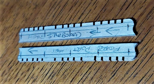

Well happy days my plan worked, i took the the measured blank and with some dividers set at 1.5mm scored down the middle a few times and then took a diamond file and made a groove for the 1.6mm electrical copper wire to sit in, then i shaped the ends with my Proxxon drill with a Proxxon cylindrical sander attached to create the curved shape at each end of the channel, i then cut the slots out for the chain whales to sit in and offered it up to the model and surprising with this model it lined up to the gun ports really well, ( based on past experience with DelPrado they got this bit pretty bang on, makes a change doesn't it Robin ) then i had to literally had dig out the groove at the end of each channel to continue the groove, when that was done i sanded down both sides of the cannel to bring it down to approx to 2.3mm, i clamped some 1.6mm copper wire to the edge of the channels put in a vice and with a hammer and a round edge of a file moulded the the copper around the curved edge of the channels, these are all sitting in their own bags ready to be blackened and painted but before that the channels were too high on the original setting so they will have to lowered which means cutting into the original moulding that i put on, yet more chopping up of the ship, it's not like we haven't done this before on the DelPrado, but hey, happy days.

Well i'm happy with the way things turned out on the channels, just a bit of tidying up to do on them, just a couple of shiny bits to dull down from gluing on the copper edging.

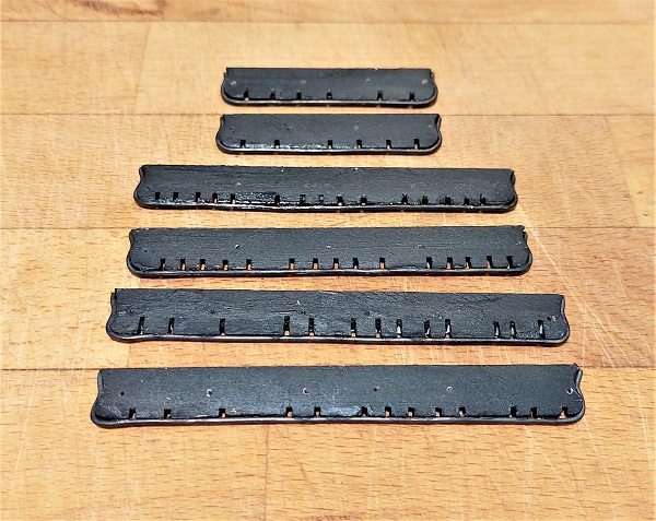

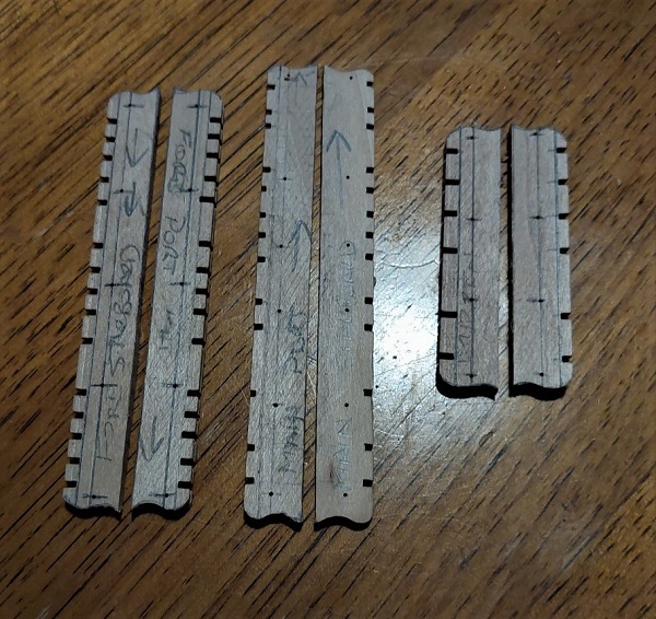

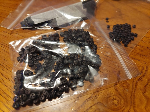

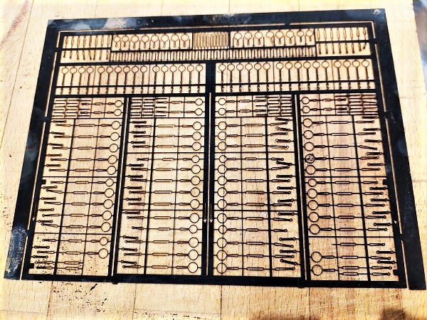

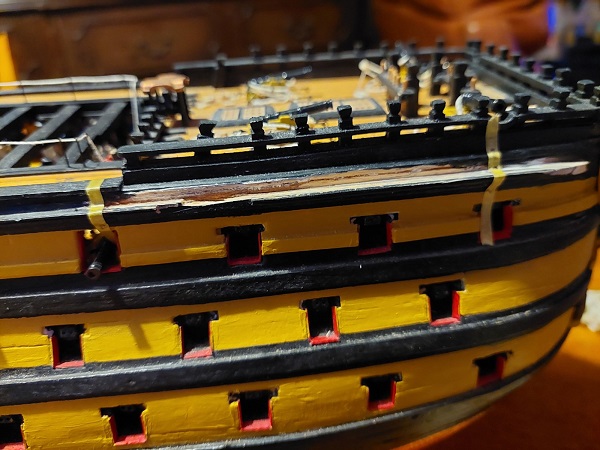

A little progress made over the new year period, the Channels were marked out on the hull to be able to cut out the moulding and lower them, the Chain plates have been blackened along with my fingers, i decided to blacken them while still on their sprues because they are very small and very delicate and i just know there will be one that will go missing and i can cut them off and attach them in sequence, the 5 & 3mm deadeyes were soaked in ebony stain for around an hour or so and were bagged up with the channels for when they're ready to go, i also purchased some 1.5mm belay pins for the bitts, i was going to paint them black but they're natural as they sit now in Portsmouth, so i'm going with that.
