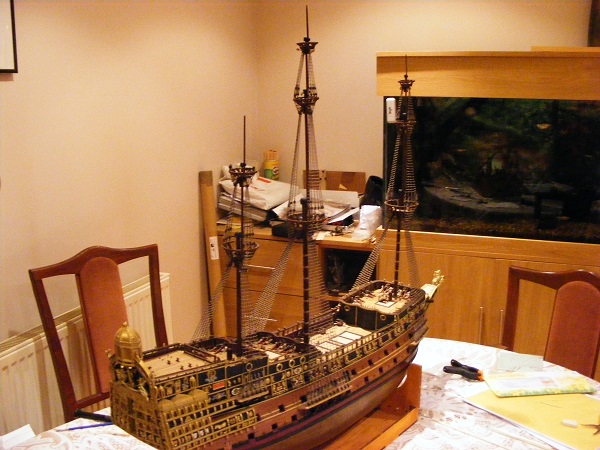

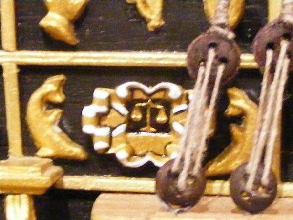

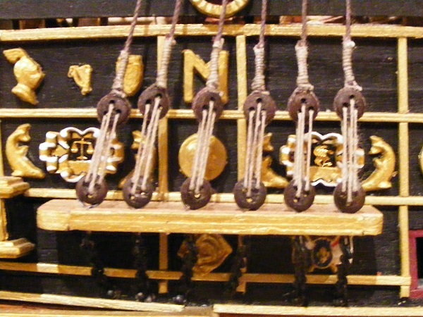

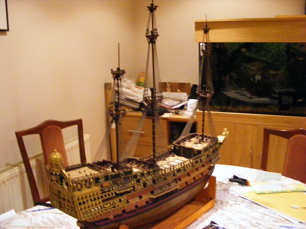

Finally finished issue 118 tonight and although it doesn't very different I can say a lot of time consuming work has been done...Cool Cool . Started once again by adding some brass etch onto some already fitted ornamentation, fiddly but made easy with the pick up took described earlier... Added brass etch onto the other side of the prow.

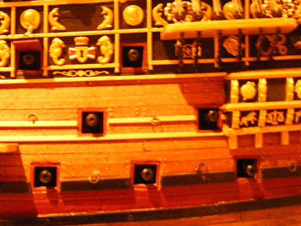

Next task was to take the 6 cannons, gently filed away imperfections from the casting, gave them a coat of primer followed by 2 coats of gun metal black and finished off with a coat of satin varnish... Fitted the cannons centrally in the gun ports...Cool Cool

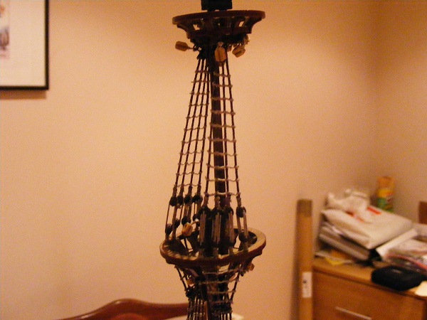

Last part of the build was the futtock shrouds on the upper sections of all the masts, shrouds on the upper main and foremasts before finally finished with another batch of knots on the ratlines....Cool Cool ..
Next up is working on the yards so till then, happy building all....Cool Cool

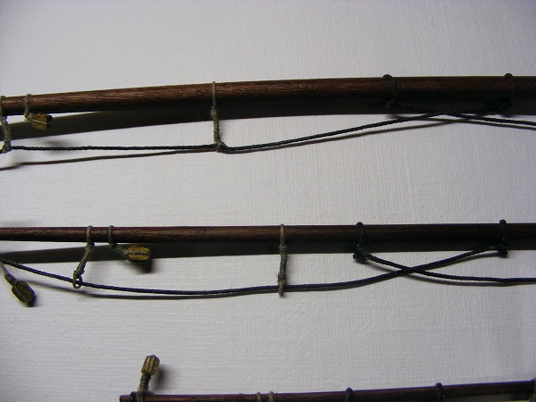

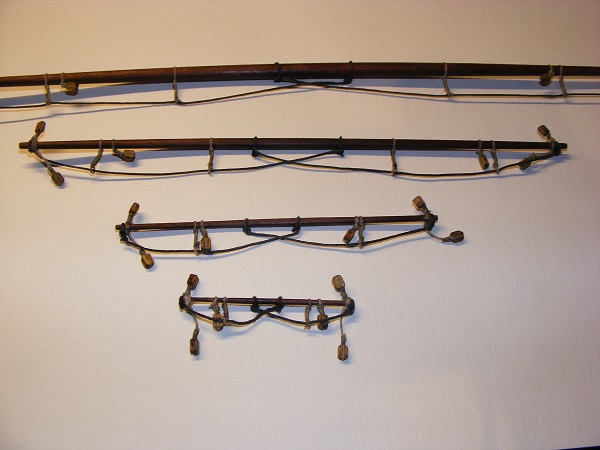

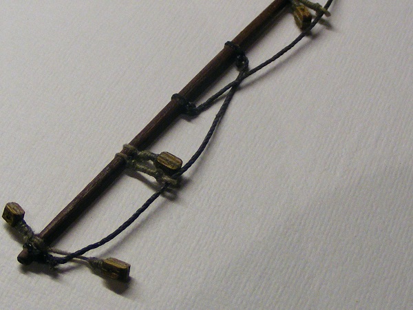

Thought I would give a small update on where I'm at and what I've been doing since my last update... Issue 119 started with painting and fitting of 6 cannons just as in the previous issue.. Then it was onto the main part of the issue, the making up of the yards. This also included the work that should have been done in issue 111, the cutting, tapering and staining of the yards. Didn't do this then as I had decided to replace the supplied dowel with walnut. Cut and tapered the walnut yards, gave them 2 coats of walnut stain finishing with a coat of clear matt varnish...Cool Cool
Moved onto fitting all the rigging blocks, these were all stained using medium oak stain as I wanted to get an old look rather than the clean pristine look as supplied. When done looked through the next issues and saw the yards didn't include any footropes so decided to make up my own...Cool Cool .. Tried different methods of making up the supports including blackened brass wire but didn't like the way it all looked. Experiments let to me settling with .25mm rigging thread creating a loop at the end by tying around a cocktail stick and each support was wrapped using .15mm thread. Brushed them down with watered down PVA to set everything in place... Finally secured the footropes through the loops. The footropes are now finished on the main mast and bowsprit, still have the main and mizzen to do before moving onto the next issue... A very long session with more to do but am sure I'll get there in the end..... Happy building all.....Cool Cool

Thanks Andy, appreciated as always....Cool Cool .. Thought the omission of footropes was quite a major feature for these ships, the spars to me looked naked without them.... Cool Cool .. Strong possibility I will be adding additional rigging to that instructed so will see how we get on.... Cool Cool .. Thanks again..
