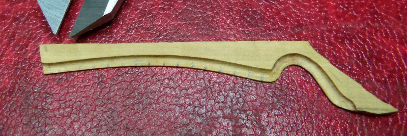

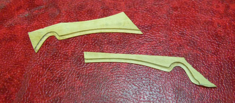

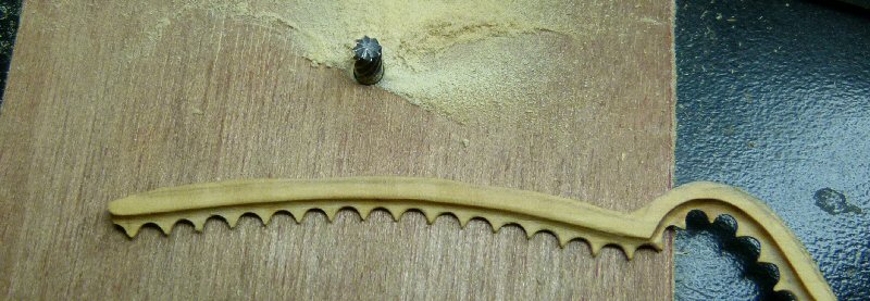

Ok when happy with that we draw round the profile to make the other side and go through the process again, when done we simply mark out for the points on the lower side and cut them out with the dremel

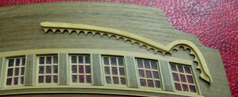

Now its just a matter of cutting it down to the final shape, cut it near with a coping saw and then again used a dremel in the spindle attachment, and lastly files. You can see the pic with it against the stern and how much over scale it is in girth, the reasoning in this is I can slowly file away till the scale is right, but if you initially cut it too small its bin time

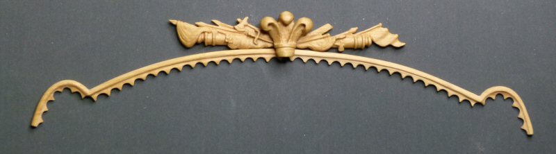

So after at first wondering how to make this piece it wasn't as bad as I thought, it does look as though it would hold many problems in the making, and although it is very time consuming and care is needed not to break it, its not really that difficult

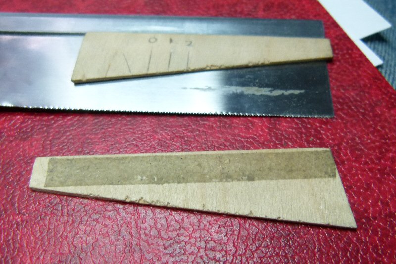

So decided to put into practice an idea I've had for a while, and for a change this one works, so heres the tutorial on how to make a depth gauge for a razor saw. The material I used was 1.5 mm plywood. First I cut a piece 75 mm by 30 mm then I cut through it diagonally long ways
willz
#296 Posted : 25 June 2013 18:05:33
Joined: 23/03/2010
Posts: 507
Points: 1,571
Then I stuck the top one to the top of the saw using double sided tape, I applied double sided tape to the bottom piece of ply and then dabbed most of the sticky away till its just tacky, we dont want the bottom one to stick to the saw blade, we just want to stop it moving.
willz
#297 Posted : 25 June 2013 18:07:37
Joined: 23/03/2010
Posts: 507
Points: 1,571
Next we mark up the depths on the ply, I simply did this by putting the bottom ply level with the teeth the equals zero, some 1 mm material on the gauge with the saw teeth level equals 1 e.t.c. As you can see I've only gone to 2 mm depth.

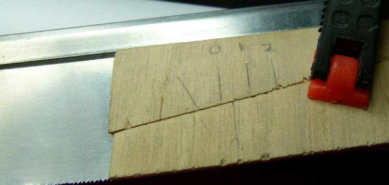

For a demo I set the saw gauge at 0.3 of a mm held it in place with a plastic clamp, and then cut slots into some 0.7mm boxwood. You can cut to depths of incredible accuracy
