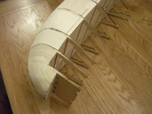

STAGE 3 BALSA INFILL SANDING
Hi Team this is it the next to last session.
Photo 1 will show you the tools I use for this part of the build (no complecated equipment although your arm may ache.
1) 3m SANDING BLOCK (Homebase)
2) BnQ SANDING BLOCK (any type will do)
3) COARSE SAND PAPER (whatever you prefer)
4) LONG FILE (round on one side, flat on the other)
5) RONSEAL NATURAL FILLER (or the one you prefer)
Please note sand against the grain or you will be at it for weeks.
The Long File I used on the rear 2 ribs space only.

#284 Posted : 29 October 2012 20:20:53

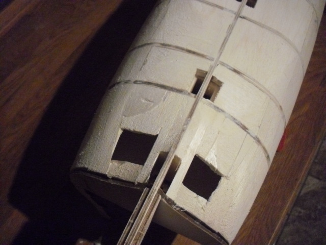

You may find (like I did) an area at the stern, where the balsa has gone thin through sanding and we have to do a repair job, no problem, cut out the thin pieces and replace with 1/2 inch thick Balsa, this will take care of what is left of the angle, when we continue sanding.
PLEASE NOTE we will not finish sanding the stern untill we have fitted the last 2 Ribs.
Here are the photos of the repair:-

The next photos show the sanding almost done (95% )time taken for the whole project to this stsge is approx 6 hours (not continuous) we will finish the sanding when the last 2 ribs are fitted:-
#286 Posted : 29 October 2012 20:43:19
Well team thats it for now, the ship is very strong now, she does not need to be in the dry dock but I am still putting her in there to protect the stern untill the 2 ribs are fitted.
Questions and comments are most welcome, can not wait for the 2 ribsBigGrin
I will leave you with 2 more photos of the SOTS and a surprise photo of her with The Cutty Sark which I gave the Balsa treatment to over 8 months ago, and she is still straight and true and does not live in a Dry Dock.
Happy building Best wishes Mike

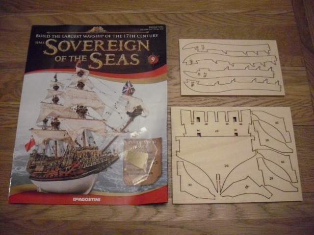

ISSUE 9 BUILD
Hi Team this week we received the last 2 ribs:-
#295 Posted : 31 October 2012 21:09:38
ISSUE 9 BUILD
Here are the parts:-

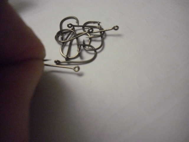

If I may enter the debate on the eyelet covering, it is not possible for me to use sulpher etc because my wife is ashmatic, but I use fish hooks, size 6 is good, and they come heavily forged to strengthen the product, and the colour is a great gun metal/ carbon.
I have included a photo of the hooks before I cut them, you will see them on my finished cannons, oh! and they are more to scale at 1mm
Regards Mike
