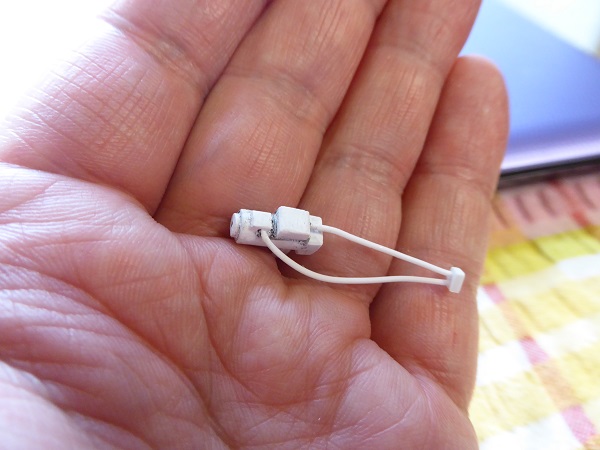

So i didn't upload a post last week, even though i had a made a little progress, as i awaited an order of paint and varnish to arrive!Blink
The attached photo shows a heater/motor blower, completed, painted and ready for fitting.

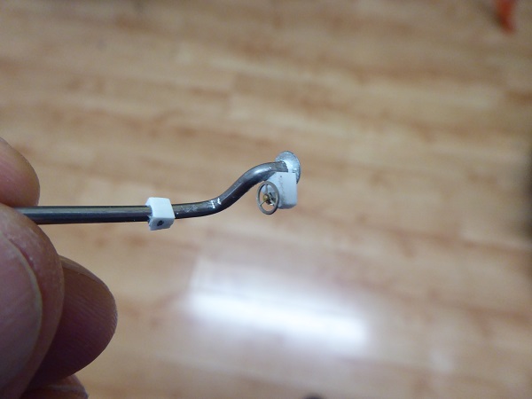

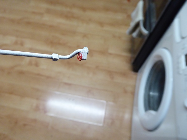

#285 Posted : 18 December 2020 11:15:11
The attached photo shows a length of pipework with a valve/handwheel assembly ready for painting. The pipework was made from 2.0mm diameter solder. I found solder to be the best medium for making pipes as it's easily bent to shape and takes paint well.
#286 Posted : 18 December 2020 11:16:03
Pipework and valve/handwheel assembly painted and ready for fitting.

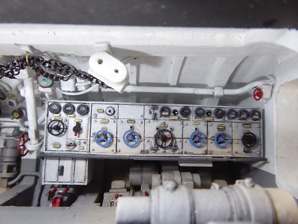

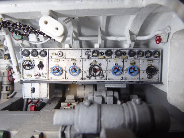

The attached photo shows both the heater/motor blower and pipework/valve/handwheel assemblies fitted. They are both above the switchboard with the heater/motor blower behind the block tackle on the left hand side.

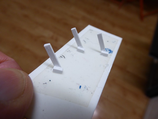

#288 Posted : 18 December 2020 11:20:00
The next job was to make the overhead supports for the switchboard; 3 in total. Fairly quick to make and the attached photo shows them temporarily stuck with double sided tape to a scrap piece of plastic while i painted them.
#289 Posted : 18 December 2020 11:21:24
Supports fitted on top of the switchboard and anchored to the hull.

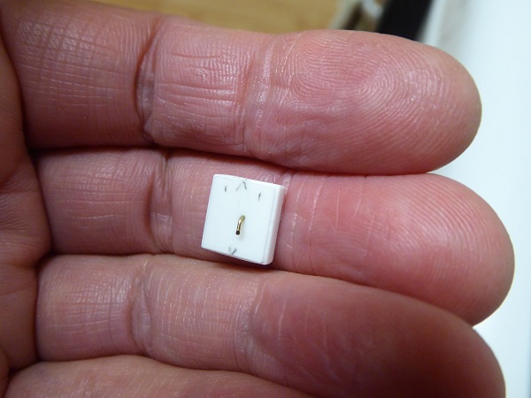

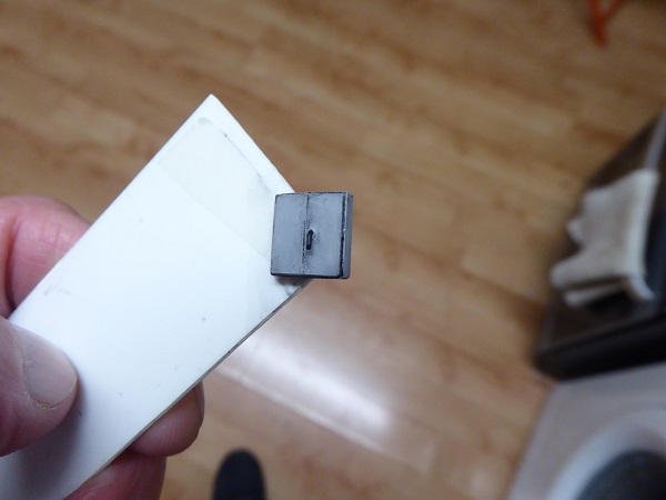

#290 Posted : 18 December 2020 11:23:48
The final piece of detail i made was an electrical locker. I used 1.0mm thick plastic sheet glued to another to make the thickness 2.0mm, cut and filed to shape and a piece of 0.5mm brass rod, bent and fitted to form a handle.
#291 Posted : 18 December 2020 11:24:23
Painted, varnished and pin washed.

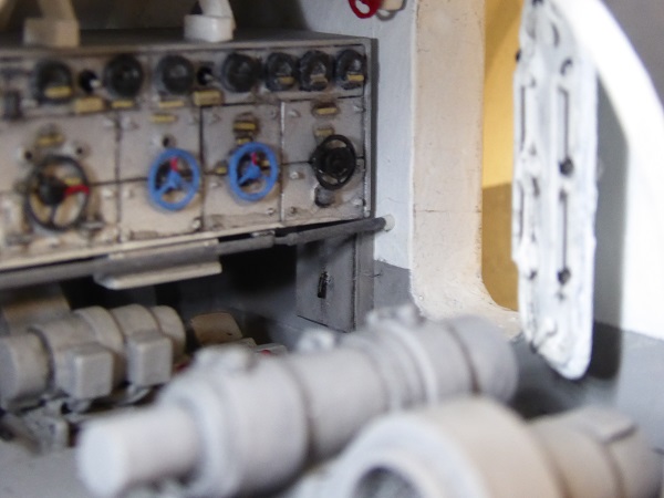

#292 Posted : 18 December 2020 11:25:27
Electrical locker fitted to the bulkhead, beneath the port main motor switchboard.
