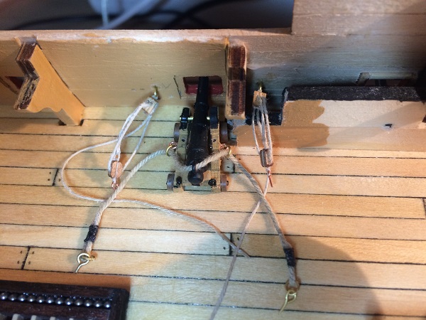

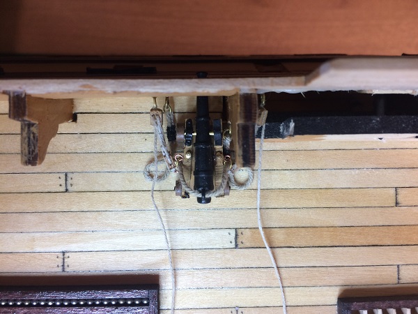

Thanks guys for your help!! Much appreciated!

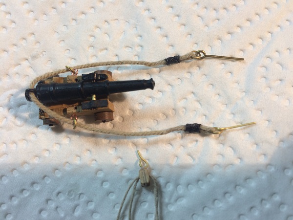

Made some decisions:
1. Stayed with the 3mm blocks as there are no 2mm double-blocks, which i want to use at the hull side of the tackles, as in the original.
2. Get rid of the additional hooks and brass rings to make the tackles shorter.
3. Use 1mm eyebolts at the gun and 2mm eyebolts at the hull.
4. Change the attaching location of both the tackles and breaching ropes at the hull - used the instructions of the Victory Cross-Section build as guidance.
5. Attached additional eyebolt and brass ring at the gun for a slightly different route of the breaching ropes.
Here are some pics:
alemo

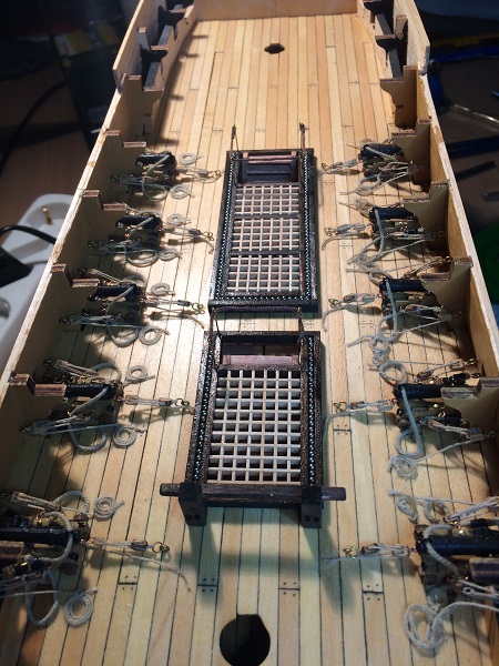

#289 Posted : 28 February 2017 10:06:33
A small update regarding the guns. Didn`t have much spare time the last months.
I finished the 5 guns of the starboard-side.
The ropes look a little bit messy on purpose - as i imagine in a combat-situation they were not curled up as tidy as seen on today`s pictures.
What do you think?

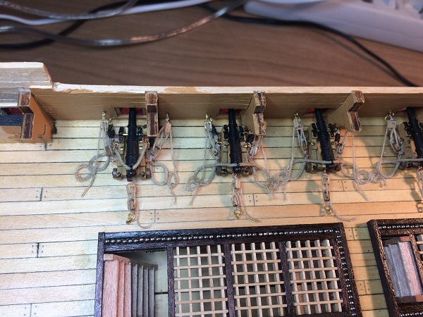

#293 Posted : 27 April 2017 12:42:20

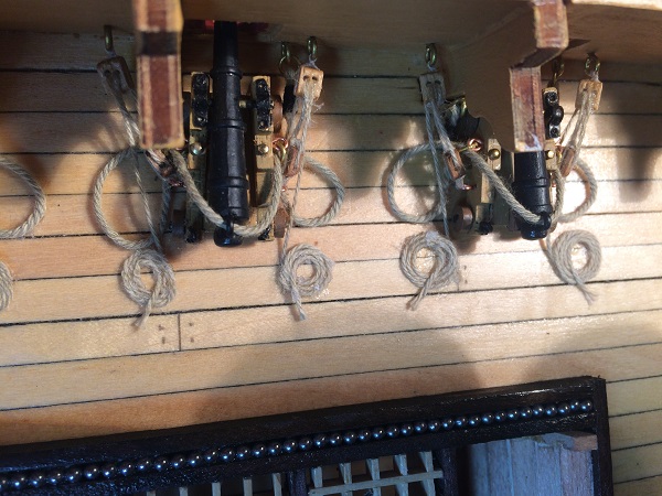

Hi guys,
i would like to show you what i did during the last 2 months.
First i completed the second line of guns on the upper deck.
This time i made more tidy rope-coils, made some other little adjustments.
All in all i like this side better than the first. It`s learning by doing after all!
I have plans to do a "gun-tackling"-tutorial in the how-to-sections, as it took me hours and hours of research, sorting out which additional parts to order and just try-and-error during the build to complete this task in a way i`m pleased with.
I hope you like it too :)
As always thanks for looking in!
Next time i will show you my solution for the quarter deck - as i built this again completely different than the instructions wanted me to :)

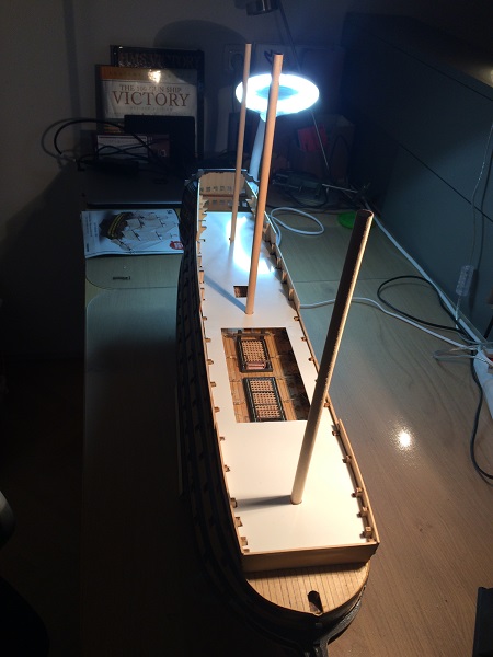

#298 Posted : 02 May 2017 13:39:52
Thanks guys!

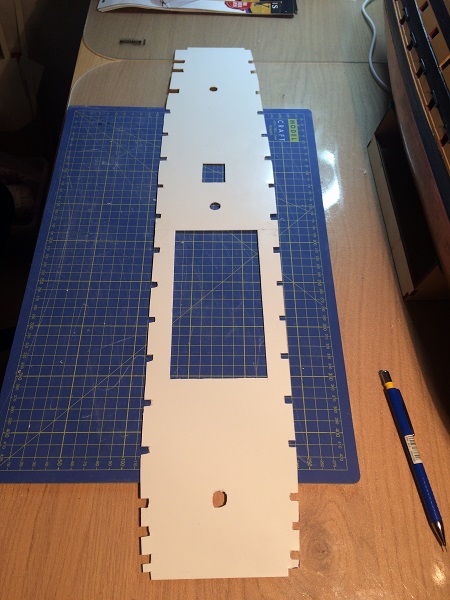

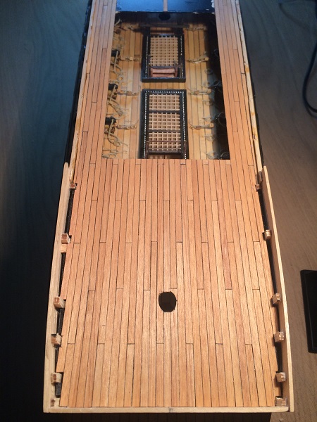

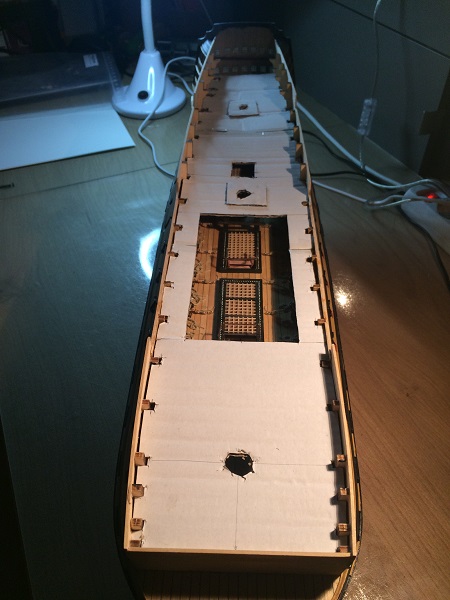

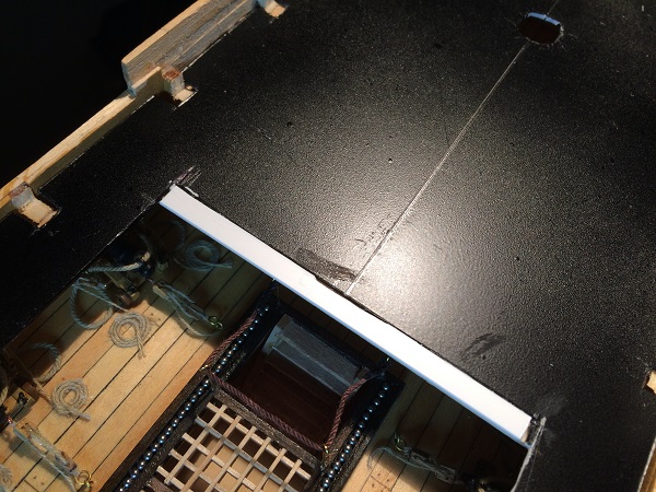

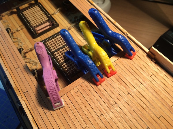

So next step was the quarter deck. I wanted to make the deck of 4x1mm planks of tanganyika-wood and lay them in a 3-way butting pattern.
To make that possible i first built a deck out of cardcoard with all the deck openings already cut in:
Then i copied that deck onto a 1mm plastic card, which i glued onto the deck beams (corrected in their height) after painting it black:
I always checked that the mast can be moved into the correct position!
To be continued soon!
#299 Posted : 04 May 2017 13:32:15

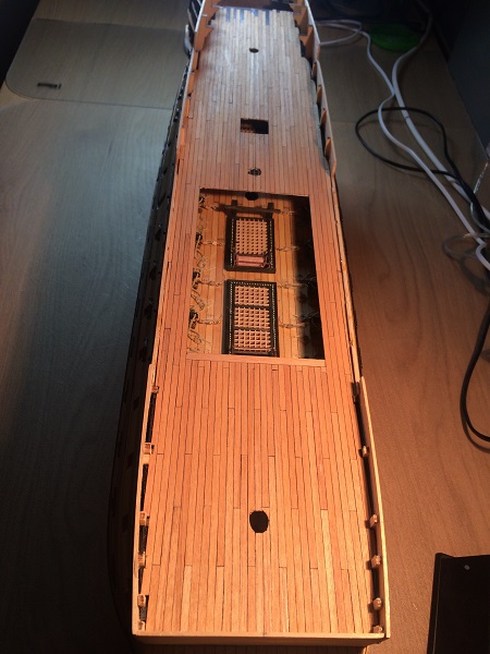

Unfortunately i didn`t think of looking in my books before glueing the deck in!
When checking with the original plans i noticed that the deck openings (especially the aft companionway) is completely in the wrong place, when following the instructions.
So i had to improvise:
Then finally i could start the planking -- which was pretty straight forward. I built a little jig to be able to fast-cut the Planks always in the same lenght (12cm - which would be 10m in real size)
I built in a transverse plank at the forward end of the big opening - as i saw this on a Picture of the real ship
Aaaaand done!
