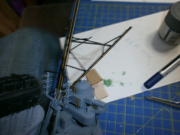

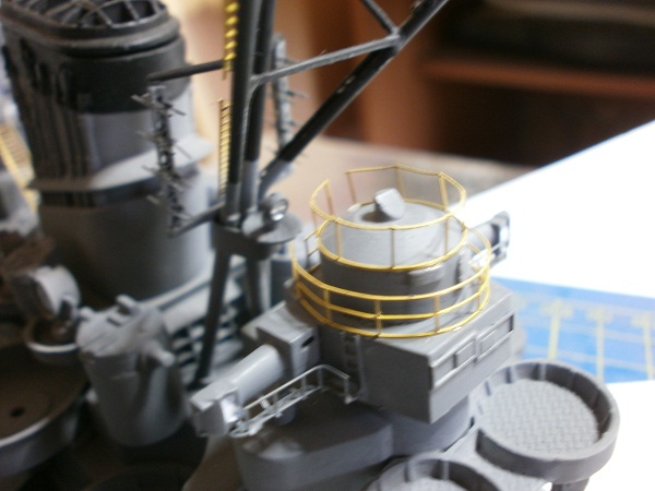

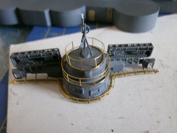

BigGrin Hi All

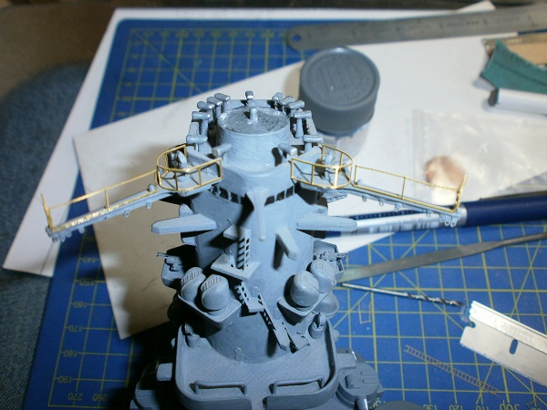

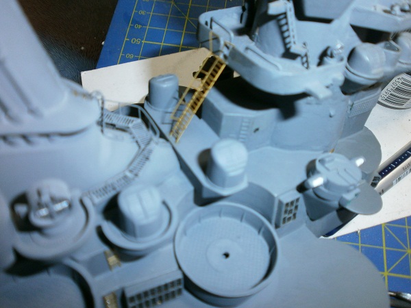

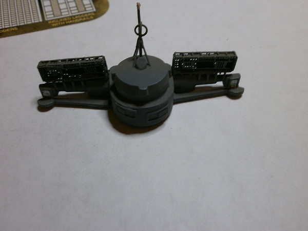

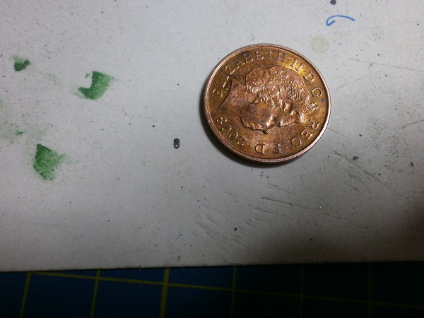

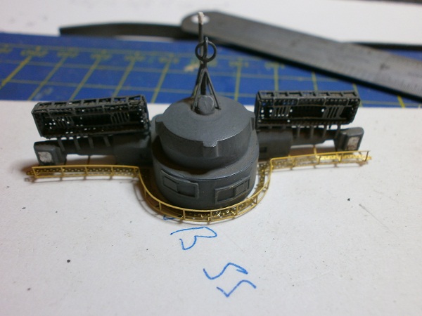

I decided to add the main walkway to the forward range finder provided in the etch set i have,there is still some railings to add here but they will be added at a later date.The 1st picture shows the range finder with the kit parts and the other three with the etch.I was suprised at how much the look of the range finder was improvedDrool just by the addition of this piece of etch and am very happy with the results.As ussual all comments and questions are welcome

Hi Andy!

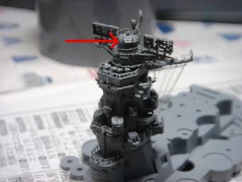

Your jobs look great! I remember that etch parts of this corporation were so soft and weak that they were easy to be broken. I guess you had troublesome works.
By the way are there hand rail parts in your kit? (red arrow in my attached pic) I'm looking foreword to see your completed head of bridge.

BigGrin Hi Yaturo
Thanks for the continued support on my build,so far all the Gold Medal etch i have used has been of the highest quality and i have had no trouble with it breaking apart.As for handrails there are several diffrent sorts to compleat the kit but these will be added when the construction of the bridge island is compleated,i also have to fabricate the gun stop rails too on here

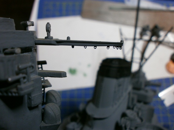

#287 Posted : 04 October 2012 21:15:23

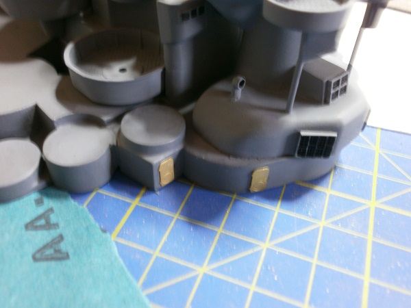

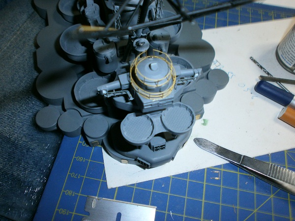

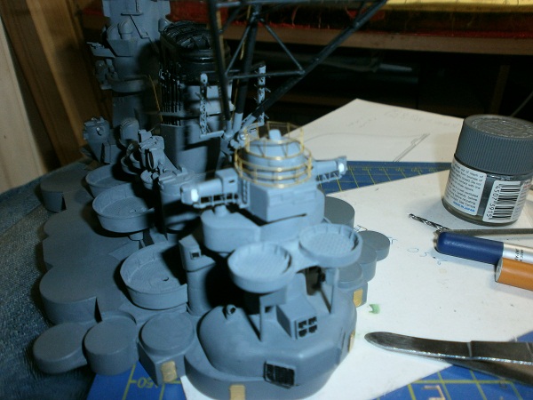

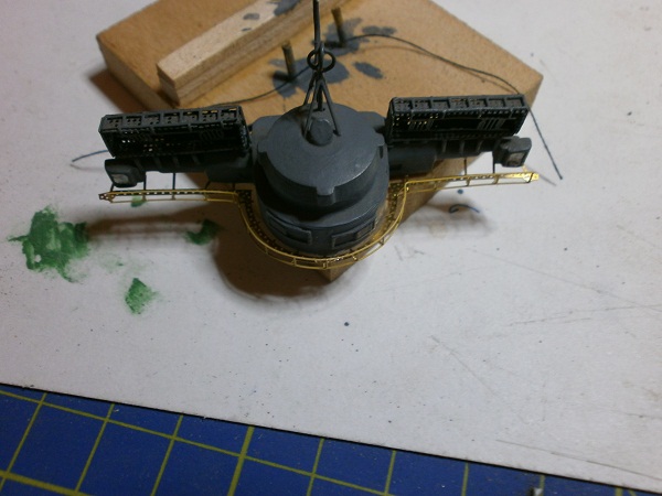

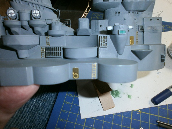

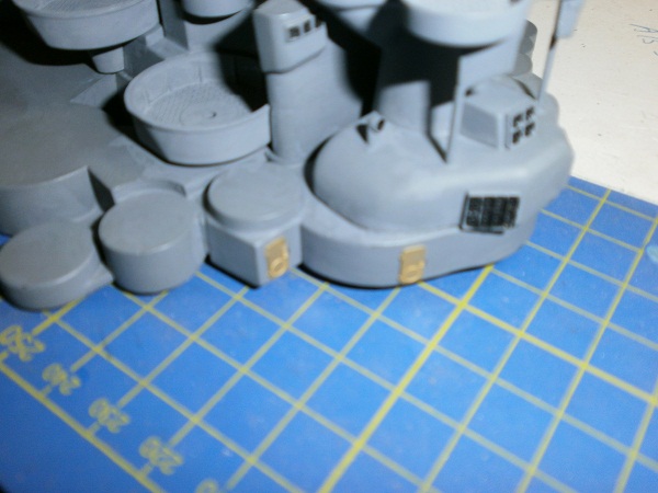

BigGrin Hi All

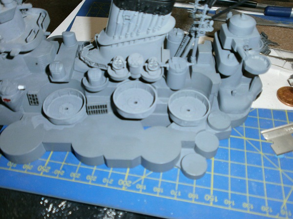

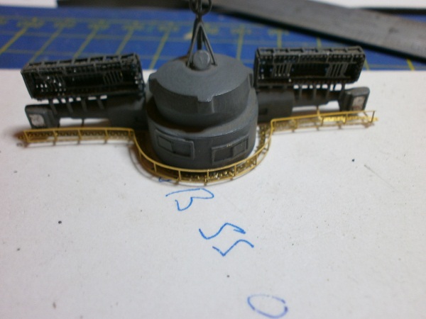

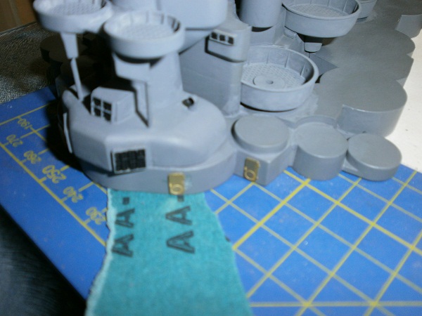

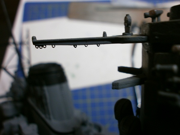

Some more things added to the bridge island,firstly some etch eyes were added to the yard arms to facilitate the correct hanging of the signal ropes,the 1st pic shows how small these are and the last two in place.I have also added the upper anti aircraft barbettes,here i will also be adding/making up the gun stop railings to these gunnery positions.As ussual all comments and questions are welcome

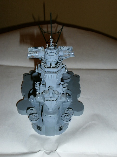

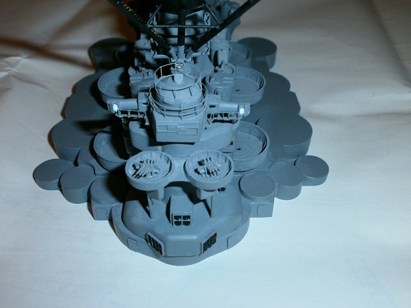

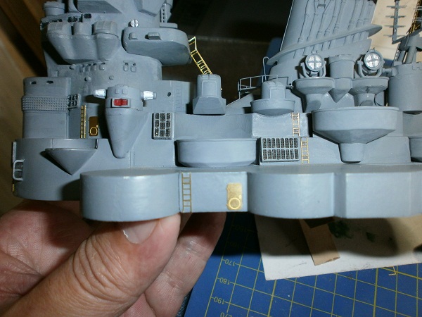

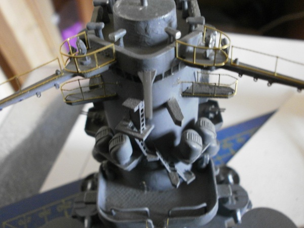

BigGrin Hi All

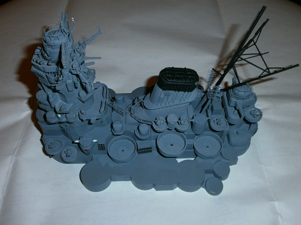

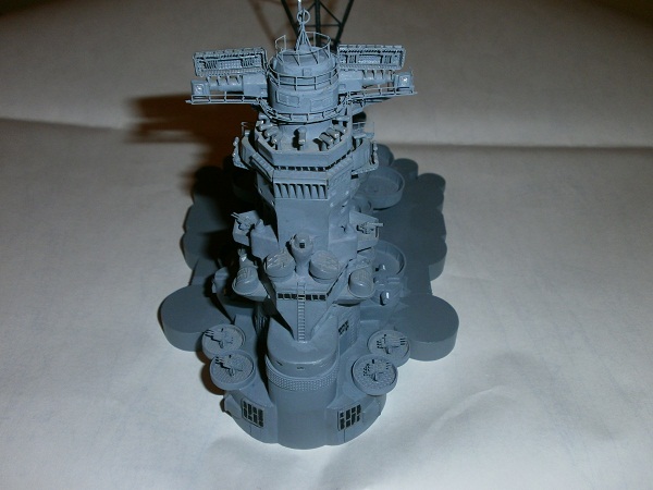

I have strted to add some more bling to the upper and central command island,some of the pics are a bit blurry [sorry] but do show whats been added here.As ussual all comments/questions are welcome

I am very surprised at your ultimate Yamato! The flag ropes that I used on my Yamato were extended runners of the plastic model. Do you have any other material for the ropes, Andy?Cool

thanks for your kind words,as for your question on the rigging/ropes i will be using monofilament fishing line.Hope this is of help

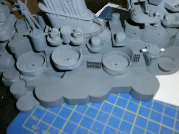

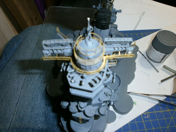

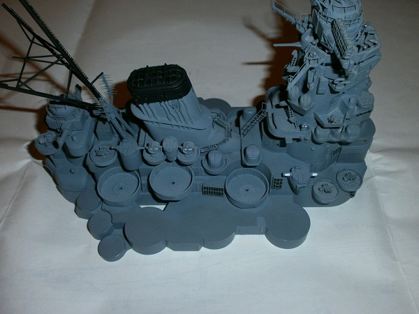

BigGrin Hi All

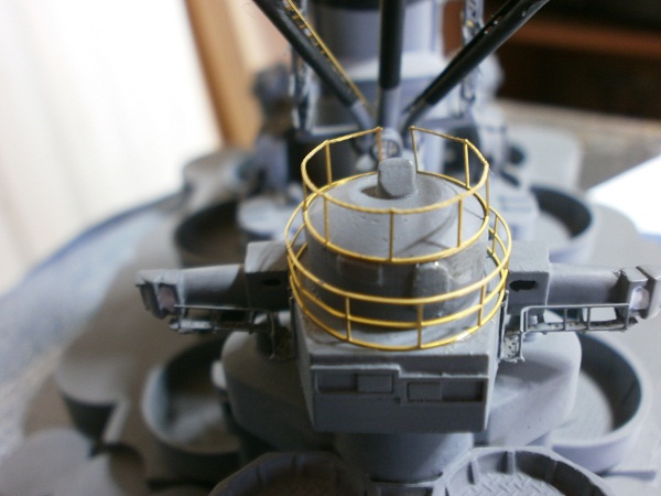

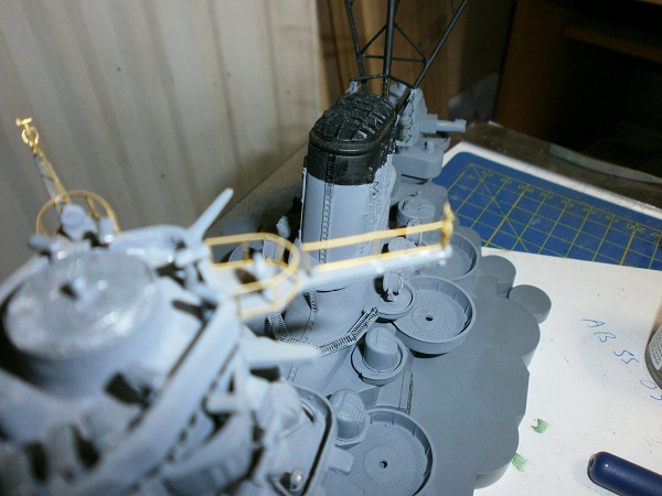

just a few more pics with some paint on the etch,she,s starting to look the part now and as ussual all comments/questions are welcome
