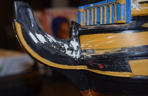

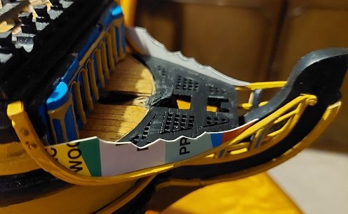

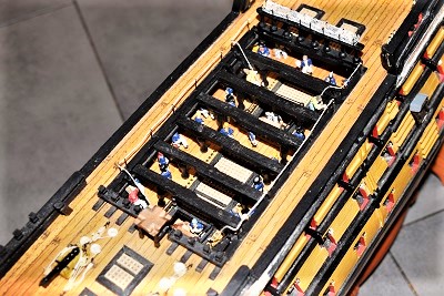

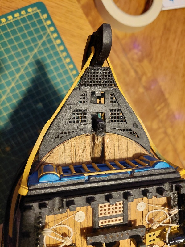

Just a quick update, the skid beams have been very lightly glued in place in case one of the crew falls over with scurvy or some such ailment and he can be treated urgently, i think the next step is the bow i've been putting it off way too long now.
Gibbo attached the following image(s):

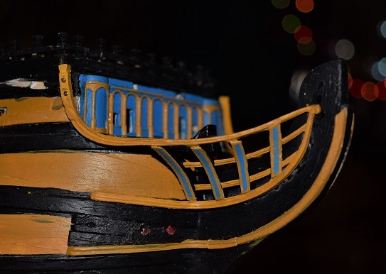

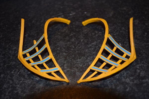

Well after thinking long and hard about the bow area ( and i do mean long, it's been a few years now ), i have decided to raid the Heller kit and use the plastic ones, i've tried various things with mocking up and so on but what i had originally made for it just didn't sit right, and the original kit didn't supply them, somebody had already painted the Heller parts without any prep so they will be cleaned up and re-painted, on the verticals i intend to glue on pre-painted sapele strips for hopefully a nice clean finish, i have taken off the top supplied metal strips and preped the hull for painting and will have to make good some of the elements around it, it's not going to be perfect as per the ship itself and there's going to be a bit of jiggery pokkery, but hopefully i can get to a point where i'm happy with it.

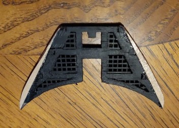

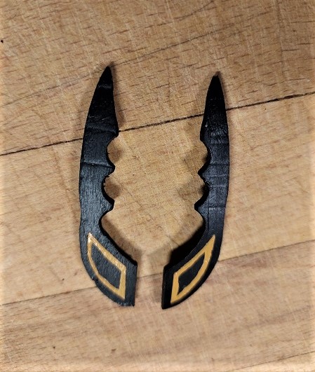

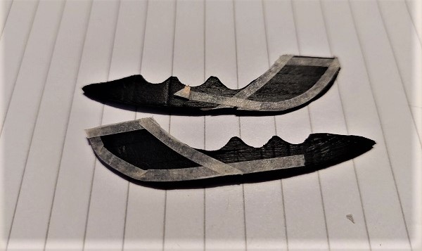

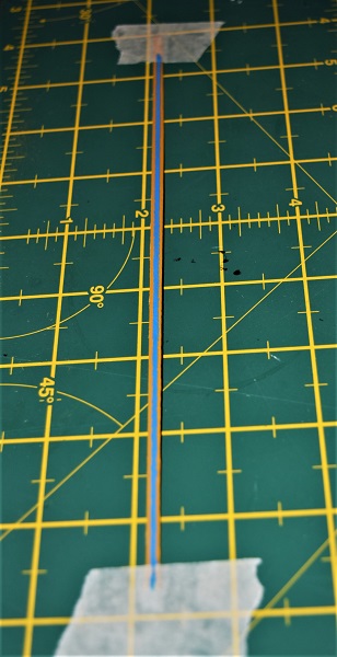

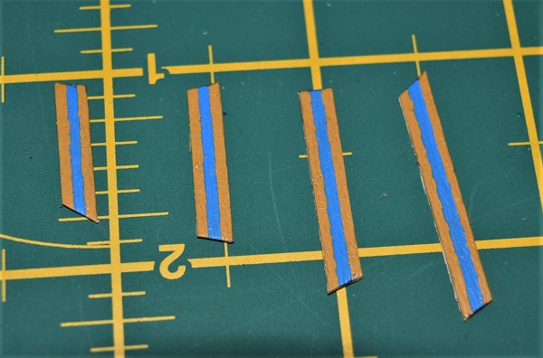

A strip of 5mm X 0.5mm Sapele was cut down lengthways to 3.2mm and painted yellow ochre, it was then taped down and the edges were taped off lengthways and the centre painted blue ( not the proper french blue i might add ) but to match the not proper blue on the heads, it was then cut down to match the verticals and superglued onto the bow sections.

Hiya as always it looks great.
Good idea about the way of doing it and it certainly makes a difference :)
Happy build ;)

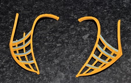

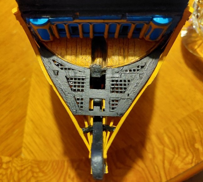

The plastic Heller Bow has now been superglued in, the piece that goes up to the forecastle was left until the lower half had set fully, this was sitting slighty high and forward so then had to be pulled down a bit and superglued and pinned with some planking pins, the scroll at the front is sitting further forward than i had hoped and will probably interfere with the figurehead, but that's for another day, i need to touch up some paintwork and we'll take the rest from there.

It certainly looks good. Nobody who tried dealing with this fiddly parts will understand how tricky it is to get results this good.
Great job and we wait for more...

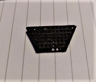

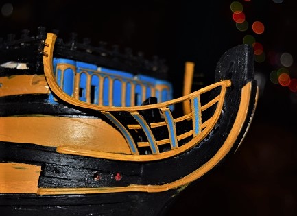

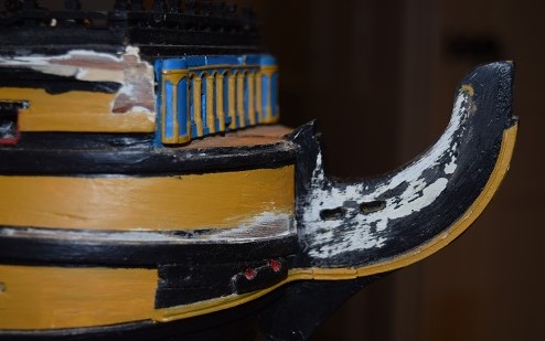

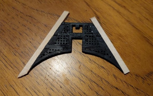

After fitting the Heller bow section there was a gap between that and the marines walk, didn't want my guys coming out of the head on a force 9 and sliding off the front of the ship so i glued some planking material to the sides and shaped them to the new bow section, i also made some templates for the squiggly bits ( don't know what they're called ) that go on top of that, don't know what material i'll end up with for these but have glued some planks together as a first attempt and we'll see how that pans out.

Thank you Chris, the glued planks worked a treat, i made some adjustments to them after looking at some pictures, they're not as fat as that as it runs forward, in fact they're nearly level with the deck and i didn't want to go there, and the part closest to the head is a bit wider, it was good because it gave me a bit more room to paint the teeny tiny stripes, i had to bend them ever so slightly to coincide with the curve by soaking the ends and using a soldering iron with a plank bending attachment bit by bit so the glue didn't melt and make them fall apart, i also extended the marines walk with some grating i had lying around.

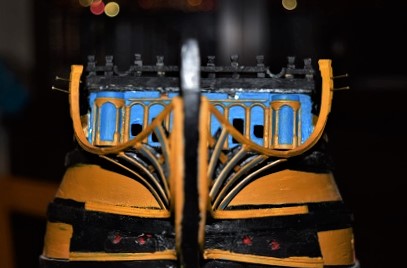

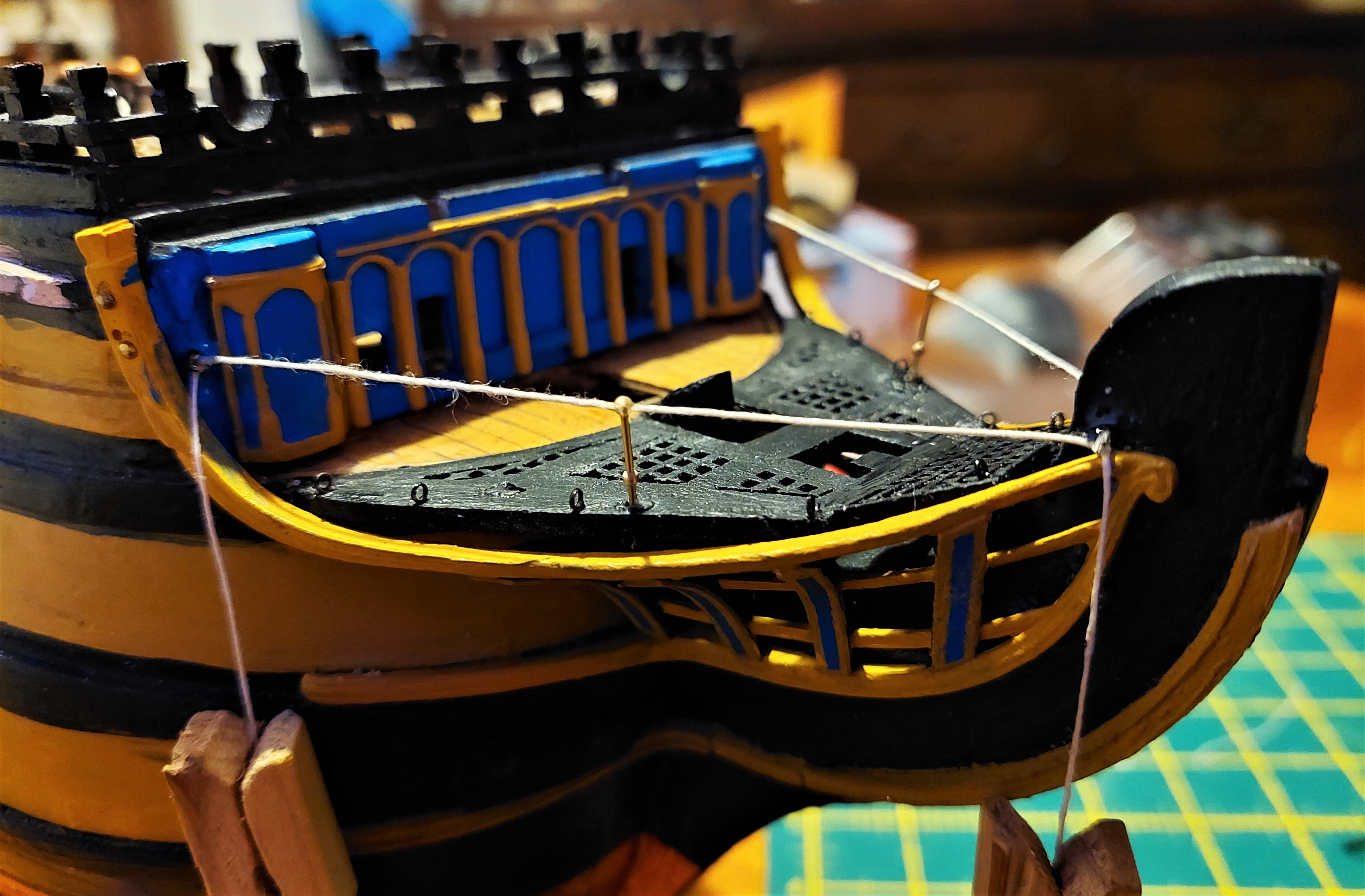

Before i attach what i call "the squiggly bits" i attached some 2mm eyebolts to the bow post and the side of the heads and a Caldercraft stanchion in between, then i attached some eyebolts on the deck which i shall run through some thread and then make a template to sew on the netting.
20211206_234245 (2).jpg (2,042kb) downloaded 18 time(s).

#300 Posted : 07 December 2021 01:21:36
Joined: 26/05/2014
Posts: 912
Points: 2,773
Location: East Sussex UK
Oops, forgot to resize.
