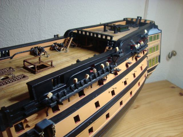

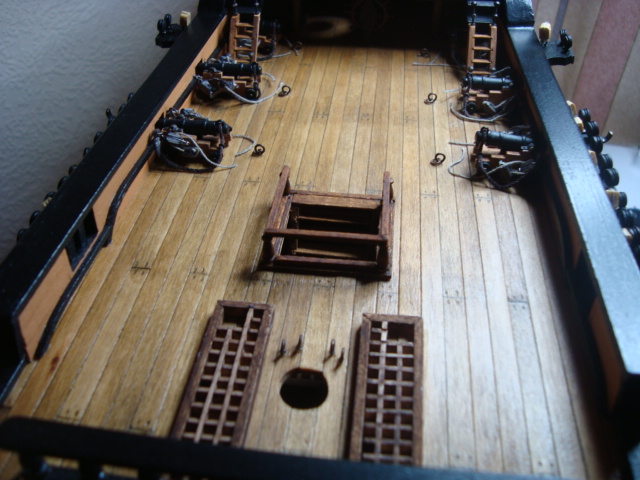

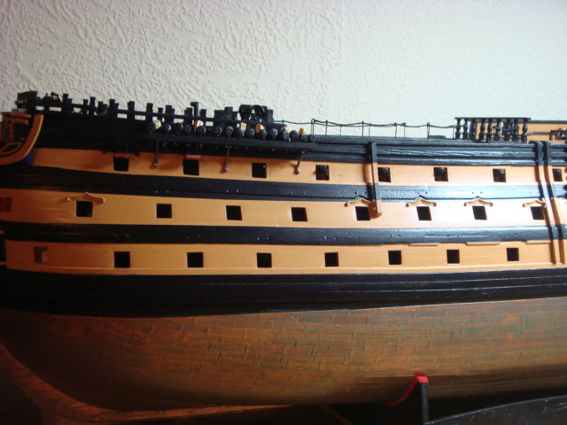

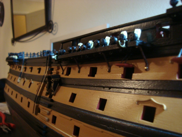

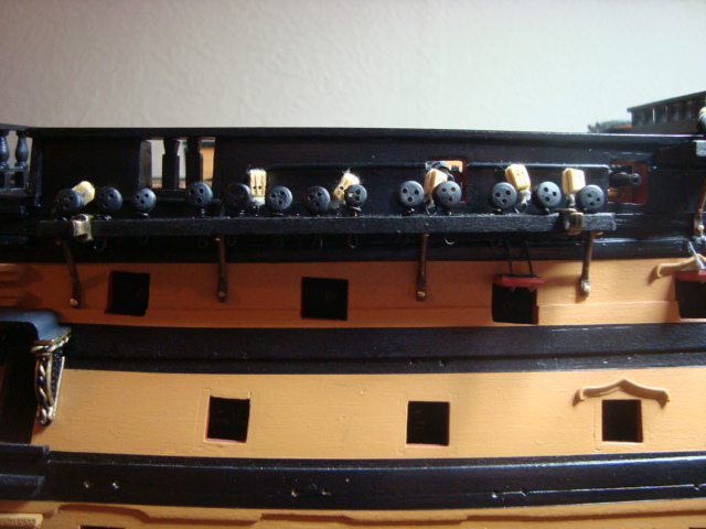

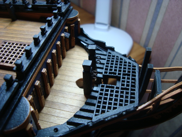

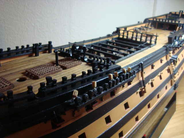

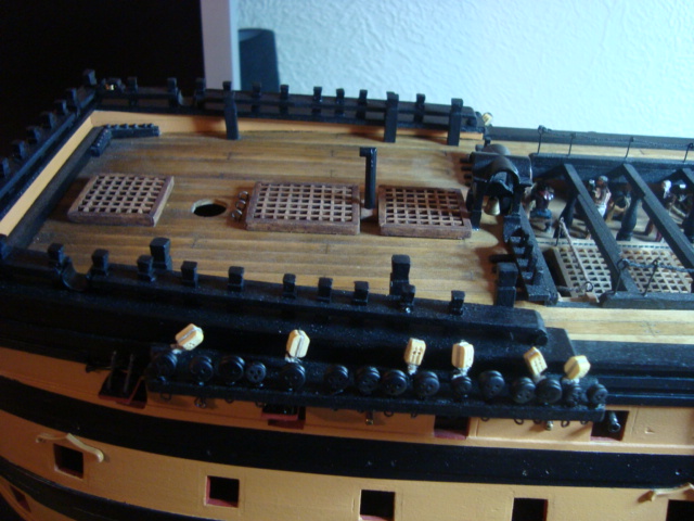

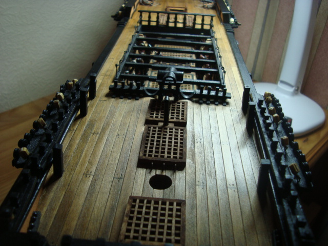

A bit more progress - painted the beakhead grating black, looks better i thinkBigGrin

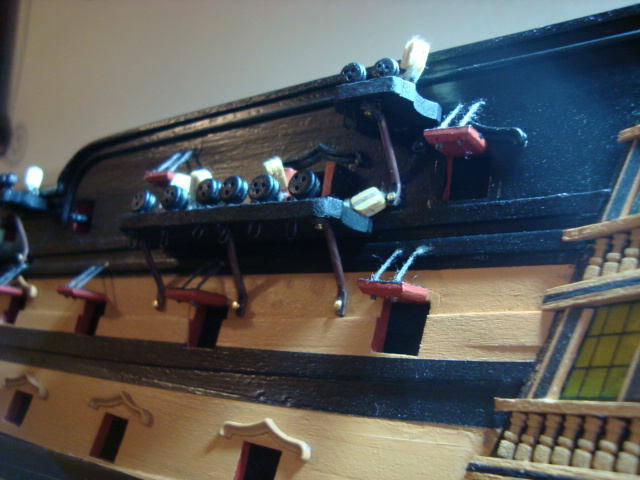

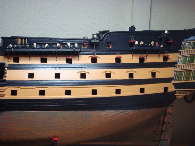

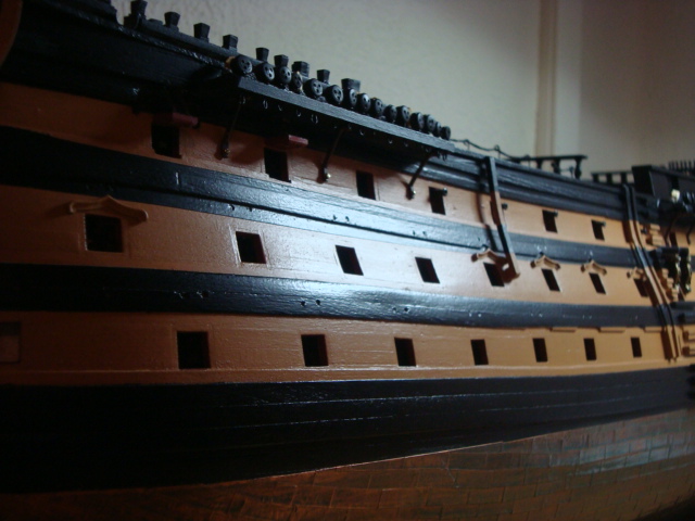

There are a few more changes, the 5 deck gratings are now all fitted, various eyelets glued in and all chainwales are on at last!
Chainwales were pretty much standard apart from the fact that I pinned them in place for extra strength and painted the deadeyes black as per the real Vic. One important thing to do also which is also mentioned in the mag is to drill out all holes in the blocks, this is best done now to save much hassle later. The pics below show the changes in no particular order. Scratch built binnacle is up nextBigGrin

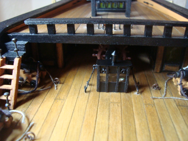

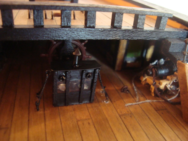

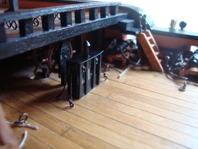

Thanks for all the comments since my last postBigGrin
I have just made a binnacle from scratch to replace the not so good kit one. I used clear acetate folded all sides to the size and shape of the binnacle, the sides, front and roof are made from tin sheet and the glass dividers are very thin wood strips, prob .75mm wide. The inside has some detail to represent the compasses, dont ask me what they are cos I really dont know - just found some odd bits in my wifes crafting stuffBigGrin - since found out they are brass split pins for holding paper together.
After the pics were taken I noticed the thing on the binnacle roof was a bit wonky, no where near that bad in reality but the pics showed it up so this has since been fixed. Decided on black in the end also as I prefer the look of the present day one.

Any chance of a "how to"
Keep it coming, loving your progress.Love Love

The "thing" on the binnacle roof is a chimney BTW BigGrin
