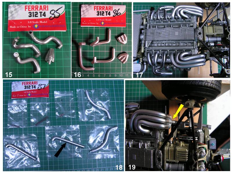

The two sub sections of the right hand exhausts come, as you might expect, in the next two packs, Packs 85 and 86 as illustrated in Photos 15 and 16. After the same flash removal both pairs of pipes were test fitted onto the engine as seen in Photo 17. The final parts for both the exhausts come together in the next pack, Pack 87. This consists of a set of four end pipes, two poly bags, each containing a pair of sprung steel springs, and a bag of three Type J screws (one being a spare as usual), shown in Photo 18.
The ‘J’ shaped tube indicated by the arrow is the left hand rear exhaust, this is secured to the ‘empty’ triple joint half with the Type J screw and the two halves of the joint are then push fitted together indicated by the arrow in the following Photo 19. The join on the two halves is pretty good and didn’t require any filling. NOTE however that the two exhaust pipes for the rear sets are not identical or interchangeable!Blink They are not actually straight – each one has a very subtle curve inwards towards the centre of the engine – it’s not very pronounced but it is there to lead the end of the pipe onto the previously fitted pipe support bracket. I can’t remember if the screw end had a tab to prevent going on the wrong side, but if it didn’t (and you did) it won’t line up with the bracket!Blushing That bracket is shown in close up in Photo 20, as mentioned earlier, once the pipe is resting against that piece, the tube ends in the engine block are kept tightly in place.
The ‘S’ shaped tubes belong on the front set of pipes, they are fitted on to the triple joint by a simple push fit and I’m pretty sure there was a tab on each one to ensure they went on the correct side. All the pipes are on in Photo 21, you can probably make out that curve on the rearmost pipe, the front pipes curve up from the front joint to lie alongside the rear one (except that in real life they don’t – well not exactly, more on them next time).

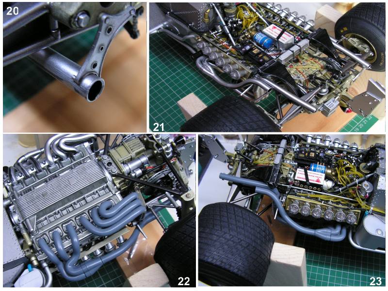

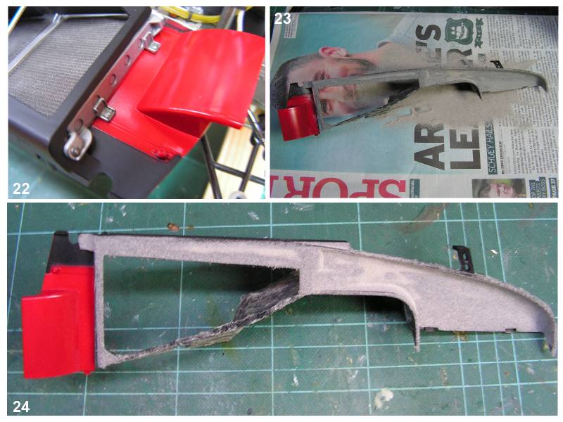

With the pipes all connected up it was time to finally paint them. I had the perfect medium all ready to go – my last few tins of Pound Shop Pro Driver Grey Primer Car aerosols.
Funny story with this actually, after reading through Ken’s masterclass on achieving the heat discolouration effect on the stainless steel exhaust pipes I sent off for some bottles of Vallejo transparent colours to try the same. As soon as I’d ebay’ed off the order I discovered the damned T4 had switched to ceramic coated exhausts which were a plain grey colour and didn’t discolour under intense heat!Cursing
Anyway, the result of the spray canning was as shown in Photos 22 and 23. Which I have to admit, came as a total surprise to me! The last time I mentioned these paints was years ago when I was singing the praise of how they were the best spray cans for a dead flat light grey primer I had ever found. I don’t know if these things alter with age, they must be seven or eight years old by now but instead of a lovely light ‘battleship grey’ and dead flat I got this semi gloss slate grey with a decided blue tinge. I have to admit though, whilst they looked horrible in my hands, when I tried dry fitting them on the engine as shown here they didn’t actually look too bad! In fact they matched quite closely with some of the reference shots of the exhausts as you can see in Photo 24. My own preference however was the lighter, matt finish similar to Ruda’s model as seen in another reference shot of the real thing in Photo 25.
The bestist matt grey finish I currently had was the Vallejo Grey Surface Primer so I decided to airbrush the slate grey pipes with that using my new No.2 airbrush – exactly the same as the No.1 except I bought one with a 0.5mm needle instead of the other’s 0.3mm (this saves all the changing around from one to the other, and besides, the airbrush rest on the compressor had two parking stations!BigGrin ) I thought the larger 0.5mm needle would cope better with the slightly thicker primer paint – which it did seem to do. The theory was, if it looked even worse I could simply re-apply the car primer again and go with that finish. The result of that second coat is shown in Photos 26 and 27 – a finish, which I thought did look much nicer. The only addition was a very muted application of the new MiG Blue-Black Enamel Wash along the joints, around the weld lines and into the crevices. I’ll show you a close up in the next instalment.
And also in the coming instalment, the most fiddly, curse raising piece of scratch building so far to finish off those exhausts!Cursing Blink

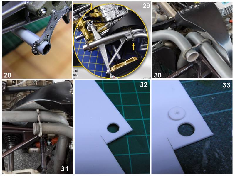

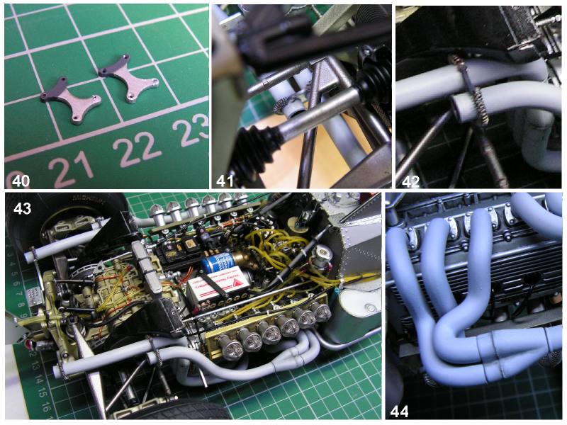

In the official instructions, the final job to complete the exhaust system is to add the two sets of springs, which secure the pipes to the bracket (and each other). As I mentioned earlier, even without these springs, the pipes are in fact quite firmly fixed in place already! There are two sizes of springs which came in Pack 87 – the shorter ones are used to wrap around the end of the pipes fixing them onto the brackets as shown in Photo 28. There are two little pegs on the reverse of the bracket, which the hook on each end of the spring locates over. This is a very fiddly exercise and the instructions actually state that you can remove the bracket, add the spring and then fit the bracket back on, pushing the spring over the end of the pipe if it proves too difficult. Unfortunately, a) my pipes are re-painted in matt grey which won’t take very kindly to having a steel spring rubbed along them and b) I’d already super glued the ruddy brackets on as they were a little on the loose side!Blink So I just had to persevere until the springs ‘sprung’ into place.BigGrin
Photo 29 illustrates the next part in the instructions – adding on the longer spring shown by the arrow (theirs, not mine this time!) The instructions have you simply wrapping the spring around the longer pipe, linking the two hooks and then sliding the spring back over the shorter pipe as well, ensuring that the join is on the inside, out of view. Again, the issue with scratching the paintwork would apply, if, I was just doing that. As you can see from Photos 30 and 31 however, those pipes do not in fact touch each other at all on the real vehicle. Instead of just the one big spring going around both pipes there are actually two smaller springs attached to an ‘x’ shaped spacer which keeps the pipes slightly apart. I know it’s only a little detail but what the heck, I’ve gone this far…!Blushing
The spacers were made from 1mm thick plasticard as seen in Photo 32. The next couple of photos are in the wrong order as I didn’t realise composing the photo pages that I had in fact taken a picture of the defective attempt but bare with me! The first attempt to create the hole seen here was made with a leather hole punch of the same diameter as the exhaust pipe (whatever that was!) Unfortunately although the punches work fine with thin plasticard, it cracked the plastic on the thicker 1mm sheet so the hole seen here was actually drilled out instead. The hole punch did however furnish me with a very useful item as seen in Photo 33 – the disc I’d punched out! This was used (with a centre drilled hole) to mark exactly where I needed to drill the second hole which is right where the disc is placed in this shot. That first attempt is finally shown in Photo 34 along with that disc and the second ‘x’ spacer is shown under way in Photo 35.
The first one was drawn freehand, the second was drawn around the first as a template. Using a safety razor blade cutter, the four straight cuts in orange shown in Photo 36 released the spacer from the rest of the plasticard and a further two vertical cuts (not shown) trimmed the excess off from the curved section which was then filed to shape with a diamond dust curved file. The two arms on each side were then drilled out to accept the spring hooks. Photos 37 and 38 show the test fitting on the pipes – as you can see, this was all done before the pipes were re-painted! Photo 39 shows a little jig I made up to try and make the fitting of the springs a little easier. By luck, one of the styrene tubes in the multi-sized set I bought earlier exactly matched the exhausts so I liquid poly glued two short lengths onto a plasticard base with the spacer resting between them to give the correct distance apart.
The two spacers were then painted as shown in Photo 40Vallejo Chrome all over with Mig Polished Metal for the darker section on the top. Note, there’s a couple of holes to be countersunk after this was taken!Blushing My initial plan was to cut down the longer kit spring to provide the two shorter ones. This I did for the outer springs, but that spring steel is an absolute pig to try and cut with snips and even harder to get the newly created end coil to bend up into a new hook! I managed to get the springs shortened for the outer half of the unit and to get the spacers fitted in between the pipes but the inner springs were a job from Hell!Cursing Cursing Cursing Although I could eventually get the springs reduced to fit on the plastic jig, trying to get the things to go around the inside of the pipes where there is no room to move about or get long nosed pliers or tweezers in to grip the ends was a nightmare! In the end I was forced to give up that idea and instead made new inner springs from the single strand electrical wire. Getting even those to fit wasn’t easy but at least the ‘springs’ weren’t actually springy so I could just get hold of the ends with the tweezers and pull them up to the tiny holes in the spacer arms and carefully thread them through. Photos 41 and 42 show the double springs in place from below and above and the final effect is shown with both sets of pipes fitted and ‘spaced’ in Photo 43. The final picture in Photo 44 shows that close up of the triple joints I promised with the (very) subdued Mig Blue-Black Enamel Wash applied around the weld lines and the crevices.
In the next instalment I can finish off that oil tank expansion set up by adding in the tubing back to the ‘can’ sitting on the rear chassis, for which I need the side pod bodywork panel which comes next in the instructions (for reasons which will be clear next time!)Cool

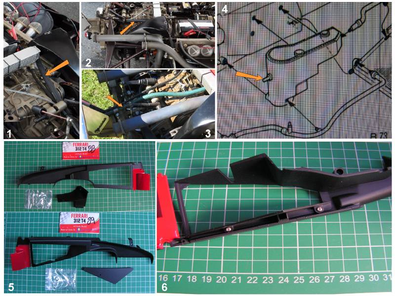

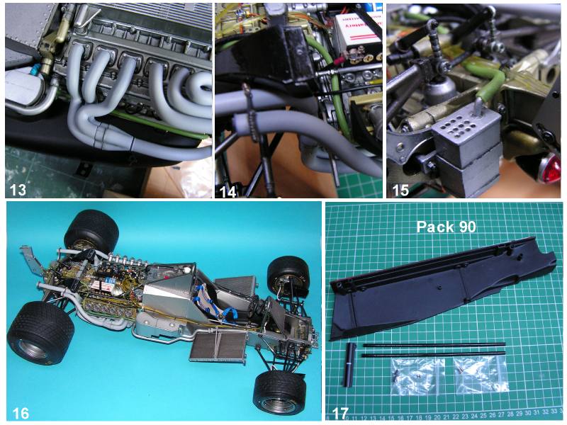

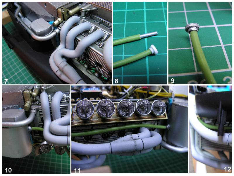

The quite hefty looking tubing which comes from the oil tank back to the rear mounted ‘can’ is shown in Photos 1 to 3. This apparently comes in a few colours – 1 and 2, which are the same car, show it in black, in Photo 2 you can actually see it going on to that can. I’ve also got some other shots of it in a turquoise-blue and, as shown in Photo 3 in a lightish green. This is the one I’m going for because I found a suitable green silicone, soft rubber tubing on ebay!BigGrin (£2.25 a metre)Cool
I’ve held off actually fitting the tube on until now because the construction of the side body panels are slightly different in this kit compared to the smaller Tamiya version (which is where I got the location for the tubing from) and I wasn’t sure if the tube would fit on the same. Photo 4 shows the part of the Tamiya instruction sheet for the T4 and as you can see, the oil tank comes complete with a moulded on peg right on the centre line of the rear face.
The first two parts of those side panels come in Packs 88 and 89 as seen in Photo 5. These are the top sections of the panels (with the very first splash of Ferrari Red on the whole kit) and each one consists of the main unit and a smaller sub-section, which is secured with a pair of Type J screws. The part I was waiting for comes second in Pack 89 and is shown in Photo 6 after screwing on that triangular panel which forms the outside of the radiator (cleverly concealing all that extra detail I added to it!)Crying The panel was test fitted to the chassis as shown in Photo 7 and as you can probably make out, if I had placed the tube onto the oil tank as per the Tamiya example, that panel wouldn’t have fitted on!
There were two options here, either cut out a semi-circular space on the edge of the panel and fit the tube where it should go, or just move the connector inboard a touch to avoid the panel, without having to adapt it. Move it, it was then!BigGrin
Photo 8 illustrates the two ‘connectors’ of the green tube. At the top is the intended version, a short length of aluminium tubing which would have fitted into a drilled out hole in the tank, probably with a plasticard ‘washer’ so it didn’t just ‘stick out’ with no obvious attachment. Of course, once the entire exhaust system was in place, I couldn’t get at the tank to drill it out so that one was out. At the bottom is the new and improved version. This consisted of a very short length of styrene tube which luckily was just the right size for the silicone tube to press fit through, together with a slightly larger plasticard disk onto which the tube was liquid poly glued. The new connector was then painted with Vallejo Chrome and Blue-Black Enamel Washed as seen in Photo 9. As shown in Photo 10, the flat-bottomed connector was simply super glued into position slightly inboard of centre, the green tube was also thin super glued into the connector as well. The tube then runs below the air intake shelf, shown without the side panel in Photo 11 before curving up around the end of the panel as seen in Photo 12. This is shown again from below in Photo 13. Then comes the needle work part! Like weaving on a loom and following the various ref photos, the tube passes under the gearbox cable running back from the right hand cockpit, under the gearbox control rod, under the external battery connector positive cable and then over the starting motor cable going back to the ECU. It then swings around the brake scoop, passing under the big black tube coming from under the gearbox radiator and also under the smaller oil lines on their way back to the rear wing support before finally plugging on to the intake tube on the can itself (Photos 14 and 15.) This is apparently a simple friction fit, there doesn’t appear to be any jubilee clip or other screw up fastener in any of the reference pictures. This is the last part of the basic chassis to be added in and the whole model then appears as in Photo 16. I’ve taken a whole series of ‘finished’ photos on this background as from now on, the rest of the model is effectively covering up what’s already there (to a greater or lesser extent) and I thought it would be nicer for the finished model gallery photos to have her both ‘naked’ and clothed for her photo shoot!Blink BigGrin

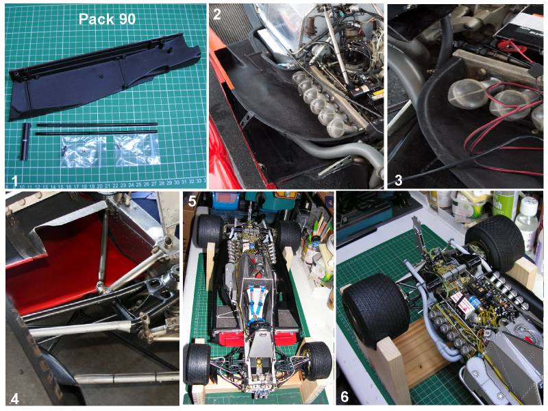

The final Photo 17 shows the next piece to come in Pack 90, which is the lower section of the right hand side panel. I had a lot of thinking about the next stage and a possible up-grading – was it really necessary, would it matter, etc, etc. In the end I went for it (of course) and what I’ve done next, in my own mind, turned out to be the most effective improvement of them all! It really makes a great difference to the whole look of the model. For those of you wondering what that might be, what do you get if you mix polyurethane varnish and cotton wool balls together (apart from one hell of a mess!)Blink

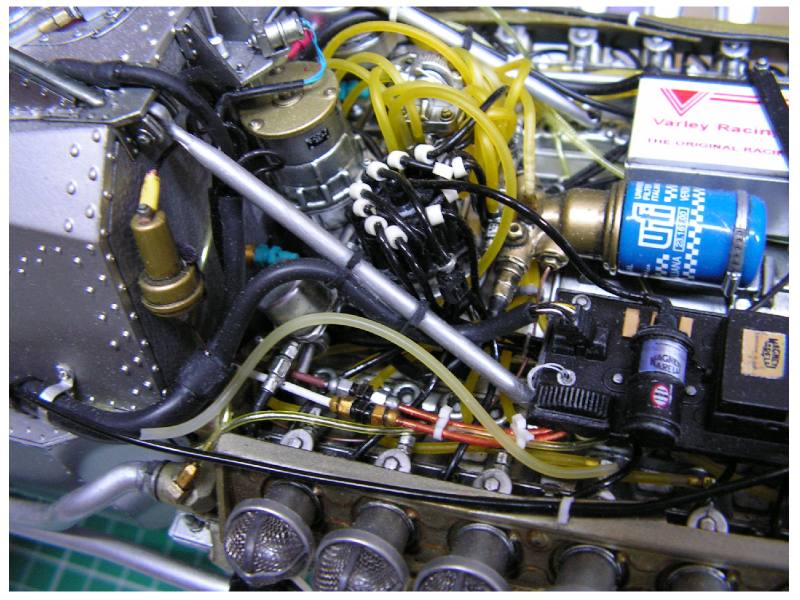

Until then, here's something I've been meaning to pass on to all you motor builders - although its too late for me on this one I finally found the perfect media for creating ultra realistic fuel lines (at least in 1/8th scale).
Its a product called Silicone Pole Float Rubber and is available on ebay, I found it whilst trawling around looking for various tubing and came across this in the angling supplies section.Blink
If you compare the trial tubing at the bottom of this photo compared to the kit tubing I used, it is brilliant! I stained the translucent white tubing with a thinned down solution of Vallejo Transparent Yellow and then washed out the brush in clean water and went along it again, removing almost all the paint and leaving this very faint yellowing effect. This silicone tubing is also softer and much more flexible than the kit tubing, as I said, its too late for this model, not only are the fuel lines buried under everything else that came after, but I also super glued some of them where they were a little loose!Blushing
That said, I would recommend this tubing to any still to build this beauty (or any other 1/8th scale vehicle) as a superior replacement to the kit supplied type. This is the 0.4mm size (internal bore), it also comes in 0.6, 0.8 and 1mm sizes and costs £1.50 for 1 metre (plus £1 postage)

Going back to that photo of Pack 90, I didn’t describe the contents so we’ll start with that one again as Photo 1! What we get is the right hand bottom section of the side pod along with two solid metal rods, each of which is drilled and tapped in the ends to take the Type H flanged screws in the little polybags. These will literally go right through the entire car from one side pod, through the chassis and out through the opposite side pod securing the whole thing together. On the bottom left is a separate half-cylinder which is fixed to the floor of the pod at the front for the metal rod to pass through. The rear rod simply runs along the floor of the pod without any such enclosure.

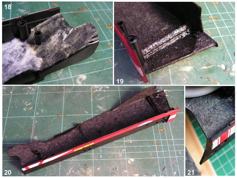

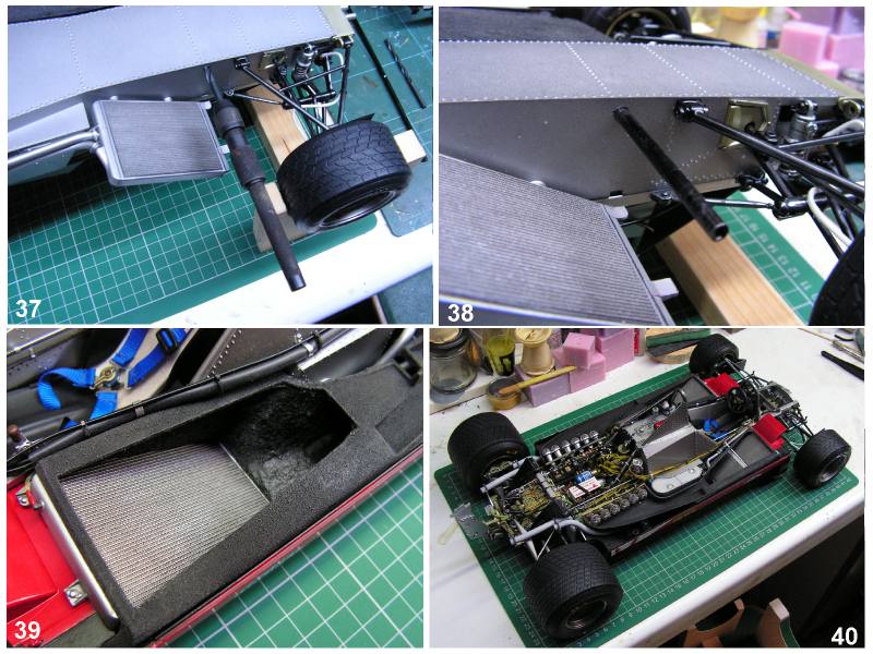

So carrying on from last time, in Photo 14 the application of the cotton wool onto the now tacky varnish begins. There was a time when you could go into your local Boots chemists (now called ‘pharmacies of course) and get a good old fashioned roll of medical cotton wool as used in first aid. Now all I can find is silly little cotton wool balls used for makeup removal! As you can see down the bottom of the photo, these ‘balls’ are actually little bales or rolls of cotton wool which, with a little patience, can be unrolled to give small sections of flat cotton wool ‘pads’. If you can get the bigger medical rolls get them! It’ll be a lot less bother!
Anyway, the cotton wool is applied over the sticky areas and pressed firmly down onto the plastic. It is then left to dry – overnight if possible. Once dry, the next job is to try and remove as much of that cotton wool as you can as seen in Photos 15 and 16. This was the first go at this process and I learnt as I went that the more you can get off, the better and easier the end result will be. By the end it was a case of ‘if you can see the black plastic through the white cotton that’s about right (in other words, a lot less than you can see here!)BigGrin
Photo 17 shows the right hand lower side completely covered in the cotton wool. Temporarily fitted onto the chassis via the two steel rods. The arrow is pointing to where the rear rod passes through – note there is no cotton wool applied in the moulded channel! Also note what I meant about having to widen the rear wheel wooden supports to accommodate the body work!
The next stage is even messier. As shown in Photo 18, the cotton wool now gets a second application of gloss clear varnish. This is brushed on quite thickly, working it into the cotton wool and flattening the fibres down to the plastic in the process. This is basically copying the actual glass fibre construction process but instead of glass fibres being immersed in an epoxy resin, we are immersing the cotton fibres in polyurethane varnish. As I said, later on I was leaving far less cotton wool on the parts than shown here and when the cotton turned transparent under the varnish that was enough!
Photo 19 shows the front of the side pod. This was after the red livery sections had been masked off and the newly dried fibre glass texture was sprayed with the matt black car primer. I’d added a little extra cotton wool over the glued on half cylinder to camouflage the join and had just painted over the front part with Mig Satin Black which is why it’s a little glossier in this pic, (I wasn’t going to mask everything up again just for that little spot!) The whole of the inside face is covered and sprayed in Photo 20 which just left a careful dry brushing with Mig Sandgrau to bring out the texture as shown in the close up in Photo 21, as before, the camera tends to over emphasize the lightness here, its actually quite a bit darker to the eye.

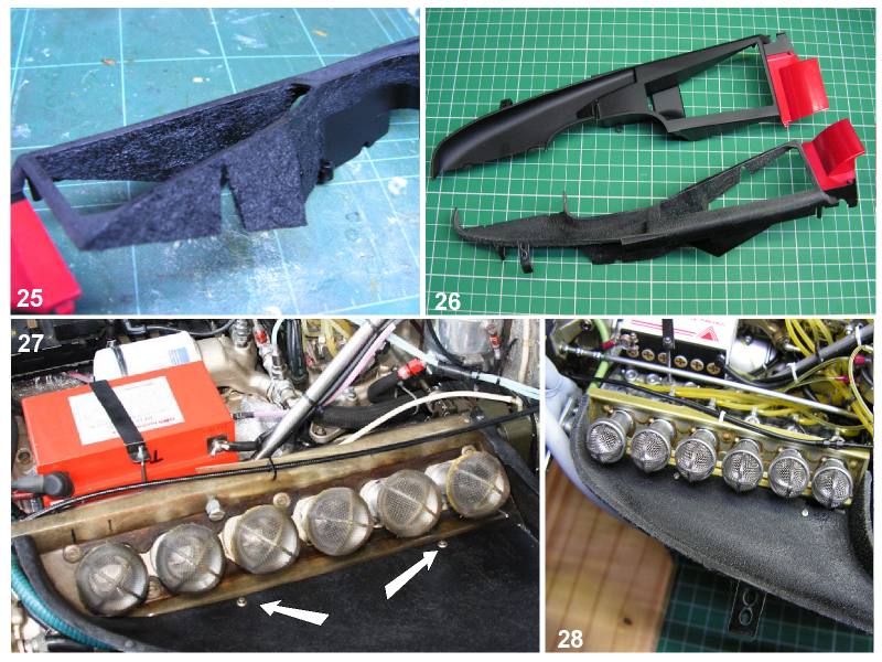

With the bottom section looking good, it was time to switch to the top half. This was going to be a ‘two tone’ effect with the cotton wool texture on the sides and underneath and the nobbly Fillite powder on the top surfaces. First though a quick look at how the top section cleverly fits around the side mounted radiator. This is shown in Photo 22. The front of the radiator is moulded with three brackets protruding from the edges, two on the front and one on the side edge. The top panel has to be carefully flexed into position with the open slot on the front clipping into place both over and under the lip of the radiator, which, as seen here, produces the effect or illusion of the brackets being fixed to the panel! That flat smooth area of black to the right of the red painted flap was left as it is, some of the reference photos do show this as pretty smooth but the rest of the panel apart from the vertical edge along the outer side and the pierced bracket sticking out towards the rear was coated (in sections at a time) with the polyurethane varnish. Photo 23 illustrates the top surface being sprinkled with the Fillite powder, this was the last section, the underside and vertical surfaces had already been cotton wooled by then. Photo 24 shows the complete right panel coated and ready for masking off and car black primer spraying. The vertical top edge wasn't textured as that part actually fits down inside the lower panel when they go together.
After the matt black and sandgrau drybrushing the finished effect was as shown in Photo 25. Notice on the bottom right of the panel that there is no texture applied, only a thin strip at the top. This section fits around the oil tank pretty tightly and only the top few millimetres are visible on the inner face so better safe than sorry! Also note the little cylinder sticking out at the bottom – this is for inserting a screw into the top to secure the top and bottom panels together – more on that one later!Blink
Before the final addition to the top panel, Photo 26 illustrates the difference between the textured right hand panel on the bottom and the stock finish left hand one above it. One interesting thing I noticed was that the right hand panel is engineered to fit precisely to the contours of the chassis and oil tank etc. The left hand one however seems to be a left over moulding from an earlier 312T series, that curved cut out behind the side radiator fits around the radiator pipework but not tightly at all. I suspect there was a curved tank fitted to the chassis at one point and this panel was designed to fit up against it just like the right one does around the oil tank. The design changed but the original panel didn’t interfere with anything so they just kept it as it was. Even Enzio would save money when he could!BigGrin
The final addition is shown on the real car in Photo 27, There are two steel bolts going through the top panel under the air intakes I have no idea if they are actually securing the panel to the intake shelf or even fixing a couple of pipe brackets for that green oil tank pipe going to the can on the rear. Anyway, they were nice and easy to manufacture, simple holes drilled down through the panel and a pair of the smallest of the steel screw bolts from my spectacle repair nuts and bolts set pushed through and super glued! They can be seen in the dry run test fit of the panel in the final Photo 28.
In the following instalment, bringing the left hand panels up to the same standard and then fitting them into place (not as easy as I thought!)

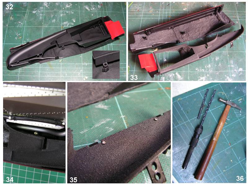

#280 Posted : 14 May 2023 16:18:11
Posts: 2,083
Points: 6,244

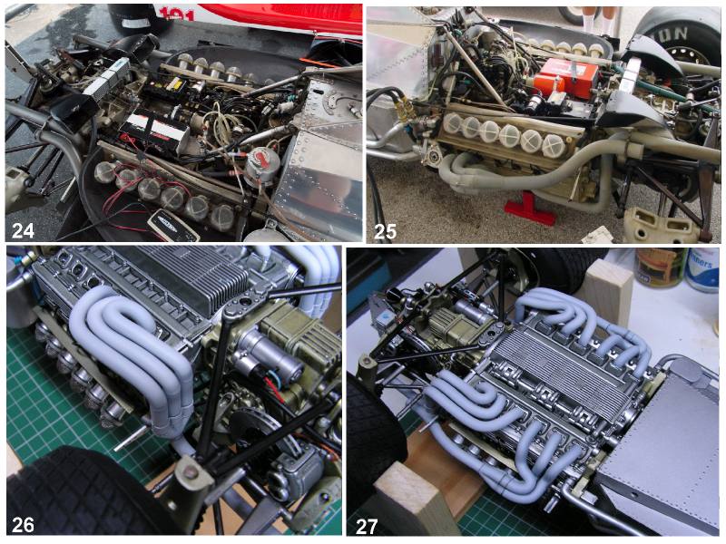

When you first begin this section, there is a warning in the official instructions stating: “We strongly recommend you do not try to fit them together before assembling them on the model itself, since trying to separate them again could damage them.” There are four fixing points on each side panel – a recessed press joint on the front corner, a peg and hollow cylinder joint towards the rear together with a flat bracket on the top section which push fits into a slot on the bottom and a single screw fixing towards the centre with a hollow cylinder on the floor and a smaller hollow cylinder above it into which the Type J screw is inserted. As with many of the push fit joints on this model they are ‘single use’ joints which are nearly impossible to take apart again. This is why I had to do all the fibreglass texturing before assembly! The act of fitting the upper and lower sections together effectively encloses the entire exhaust pipe assembly, so you can’t fit the panels together first and then fit them to the car!Blink Photo 29 illustrates the rear joints after pushing them fully home. The arrows indicate the peg joint under the air intake shelf and the bracket on the side This leads to the problem with the instructions. After fitting the two panels together and sliding the two steel rods through the chassis, the instructions then say to insert and tighten the Type J screw. The problem is – HOW?Confused Once the two halves are joined and the rods are inserted there is no space between the side panel and the oil tank which is where the screw cylinder is situated! Photo 30 shows this area, what looks like a gap between them is actually just the part of the oil tank sticking up above the side panel, the actual gap here is not as wide as the head of the screw let alone a screwdriver to screw it down with! In the end I simply left the screw out altogether – the rear push fits, the front recess and later on the two flanged screws into the sides of the panels was more than enough to secure the panels (plus the Type J on the left side was perfectly easy to get at so there was no such problem over there!)Cool
Also in Photo 30, notice that asbestos joining ‘blanket’ around the oil tank to radiator pipe in between the side panel and the chassis – that was an addition to the kit that now unfortunately got in the way of the panel! I needed to shave off some of the thickness of the blanket just below the visible part, including part of the jubilee clip to allow the panel to fit close to the chassis. Fortunately, with a touch up of the paint it is not noticeable at all after the panels are on.Cool With the right hand panels finally fitted on, the chassis of the 312 is suddenly a lot wider as seen in Photo 31. You can see here how the exhaust pipes emerge from the fibreglass body work in this shot.
Photo 32 shows the two sections of the left hand side panel before the fibre-glassing, they are simply placed one on top of the other here and the enlarged insert shows the position for the Type J screw that fixes the two halves together. This is exactly the same location as the right hand side, which, as I mentioned is completely blocked by the oil tank! Both sections are seen after the texturing in Photo 33. Note that the inside face of the side isn’t textured – there’s no point really as this area is completely hidden when the panels are in place and also, the top panel fits inside the bottom one at the top!
Photo 34 is a view looking down into the oversized curve around the radiator pipes which shows that fixing screw down tight. After the panels were on I painted the screw head with a gun metal acrylic just to dull it down a touch. Before the top panel was attached it also received a couple of tiny metal screws as shown in Photo 35. As I mentioned last time, fitting the completed side panels onto the chassis was not quite as straight forward as I’d anticipated. There were probably two reasons for that – firstly, was the extra layer of texturing I’d applied over the panels, that might have affected the way the steel rods were passing through from one side to the other but I suspect that the plastic mouldings for the panels might have had a very slight warp in them too! The reason for that being even once I’d cleaned out the holes through the panels and got the rods passing through (pretty tightly I’d have to admit), they still wouldn’t just slide through the chassis which without the panels in place, they both did without too much trouble. Photo 36 shows my assembled side panel fitting kit – a small (ish) jeweller’s hammer and my pin vice drill with a pair of drill bits the same diameter as those steel rods. I had to send off on Ebay for the longer bit, the smaller one is what comes as standard in drill bit sets but it wasn’t long enough to go right through the width of the chassis so I got an ‘extra long’ one of the same size. Photo 37 shows that extra long bit going through the chassis and Photo 38 is the front rod sticking out the left hand side after passing through the right hand panel seen at the top left of the picture. Even after the drilling through I still had to hammer the thing through which led me to think the panel alignment was possibly off due to a warp in the plastic. The left side panel was then attached, the top section first followed by the bottom being very carefully pushed on tight over the protruding rods until it was firmly in place. Then the rear peg and bracket were pushed in followed by the front red flap flexed over the radiator edge and the push fit on the corner, and finally the screw down inside the centre (magnetized screwdrivers are a must here!BigGrin ) Everything clicked into place nicely and appeared as seen in Photo 39.
There was one more extra addition to put on which will be coming next time, but to finish off this instalment, Photo 40 shows the final appearance with both side panels fixed in position with the T4 sitting on her own four wheels at last!
Until next time, Happy Modelling to you All!
Robin.
