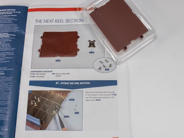

The next 4 issues have arrived but there was one small problem......no actual part in Issue 71 Laugh
Simple fix, called Hachette Customer Services for 'Battleship Bismark' (sounds strange but they actually have a different number for each part-work Confused ).
Replacement issue now in hand, off we go Smile
#268 Posted : 06 August 2020 20:33:40

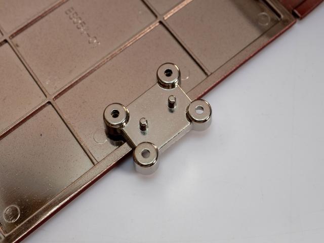

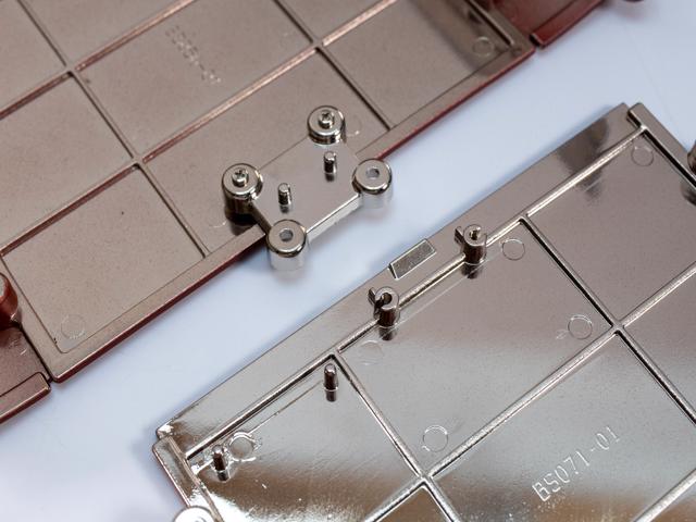

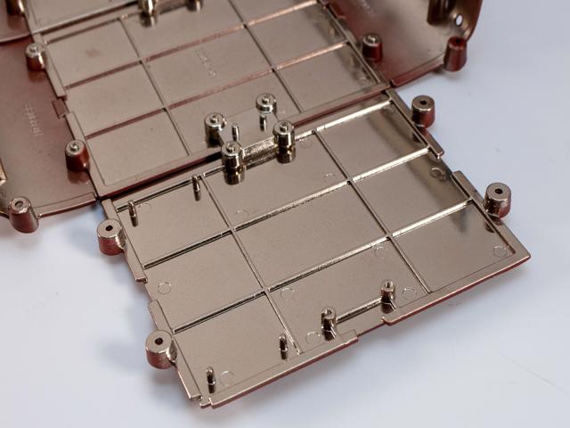

Replacement Issue 71 in hand, it contains another keel section.
The connector piece is fitted loosely to the keel first. I find that if you fit the screws loosely, these sections go together easier. The keel section has a lip on one edge. This lip sits under the connector, and the other two screws are fitted. Once all screws are tightened down, this completes Issue 71.
Store away safely. At this rate, i'm going to need a bigger cupboard Scared

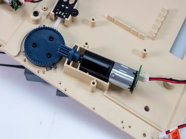

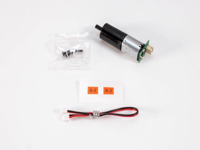

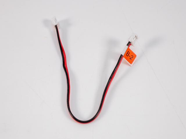

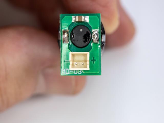

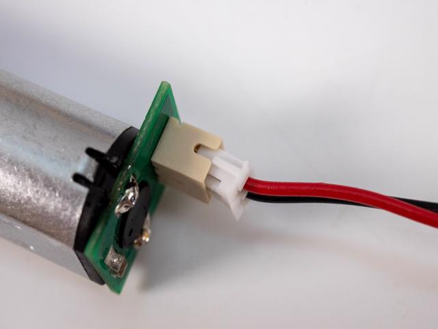

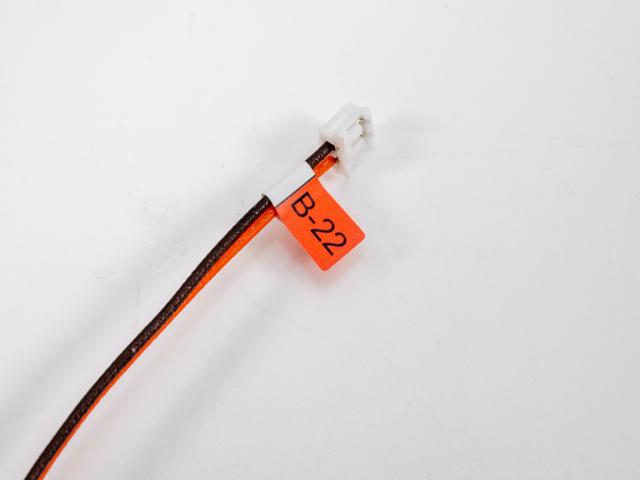

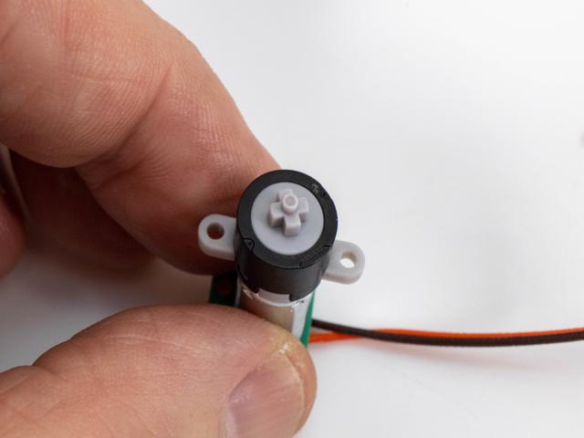

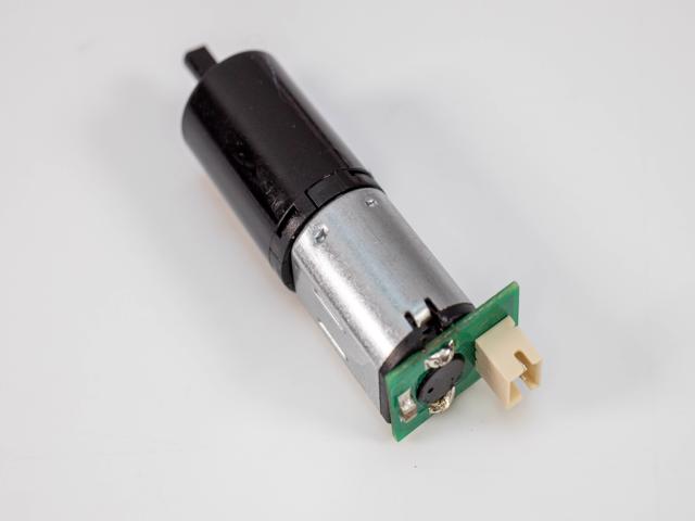

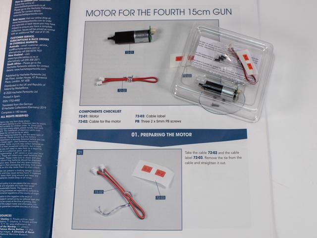

In issue 72, we build the motor for the fourth 15cm gun.
This basically comprises of attaching the label to one end of the motor cable ( doesn't matter which end as both are identical).
The opposite end is then pushed into the socket on the motor. Again, you can't get this the wrong way round, as there is a slot in the circuit board connector which will only allow it to be fitted one way.
That's all for Issue 72.

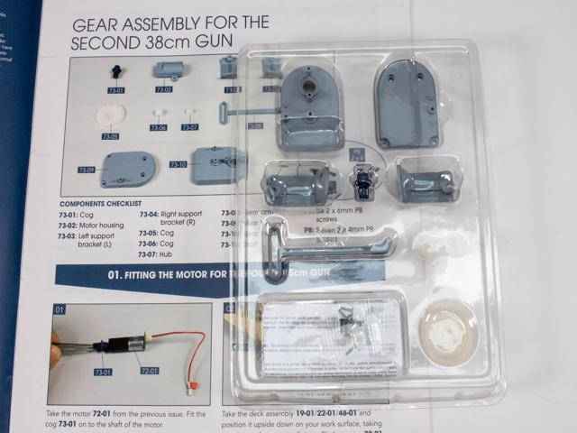

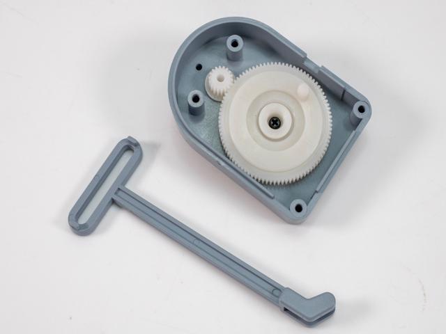

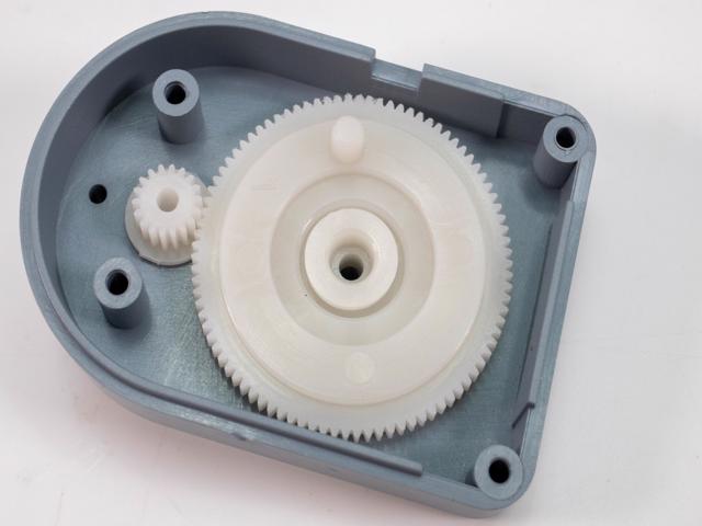

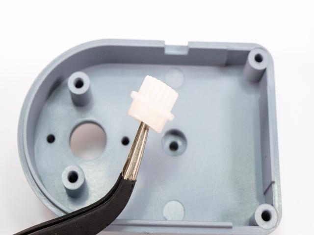

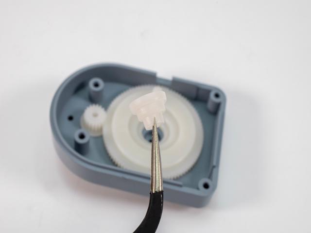

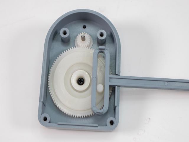

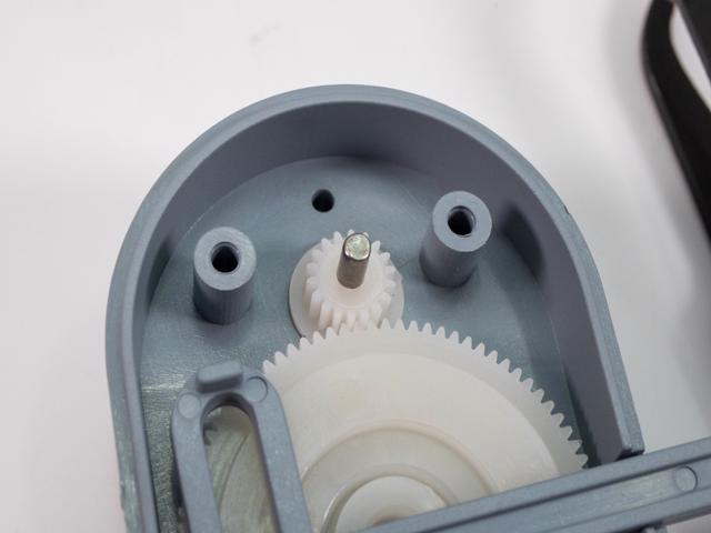

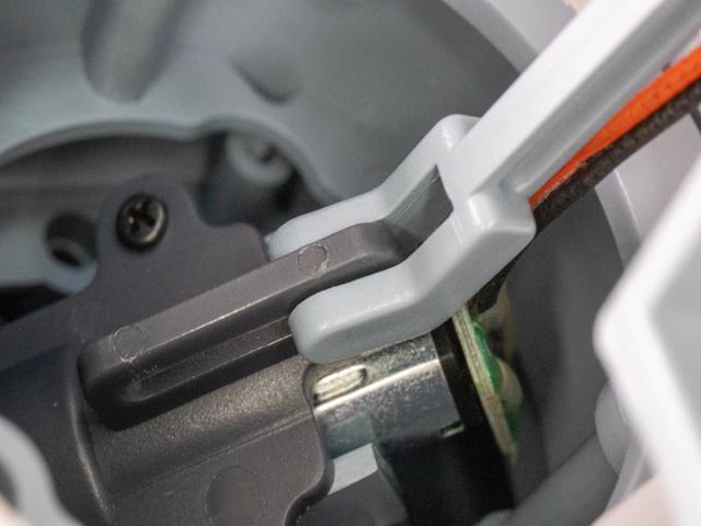

BigGrin After the last two easy issues, we get a bit more to do in issue 73, where we make the gear assembly for the second 38cm gun.
Retrieving the motor assembly from Issue 72, we fit the cog onto the end of the shaft. The shaft has a flat spot to align the cog correctly.
This is then fitted to the deck assembly. Care needs to be taken here not to damage any fittings. The motor is fitted so that the teeth on the small cog fully engage with the teeth on the large cog. Once happy you can fit the motor housing cover.

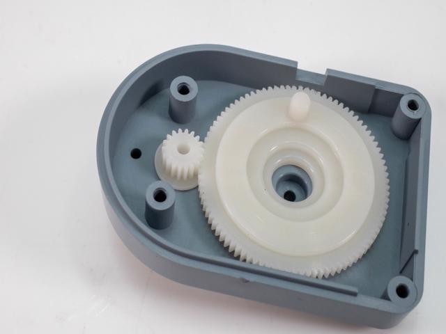

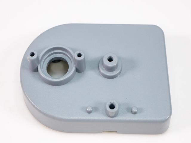

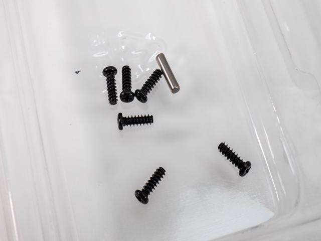

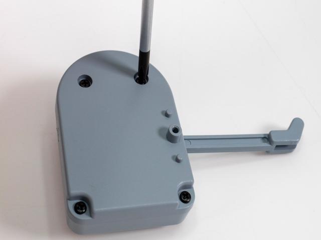

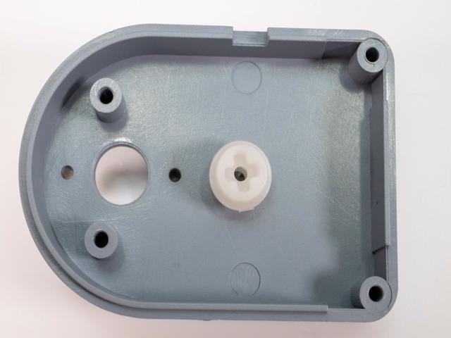

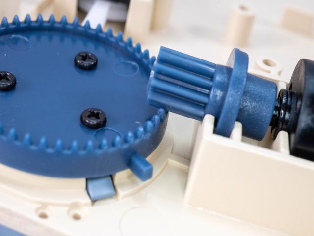

Now we build up the second 38cm gun. The cog is fitted to the gear housing with the teeth uppermost. Meshing the teeth again, the large cog sits centrally over the small hole, and the hub is fitted to keep everything lined up. Screw in place.
NOTE 1 If your unsure which screws are which (coz, you've guessed it, they aren't marked on the packets), the screws you want are in the bag with the small shaft.

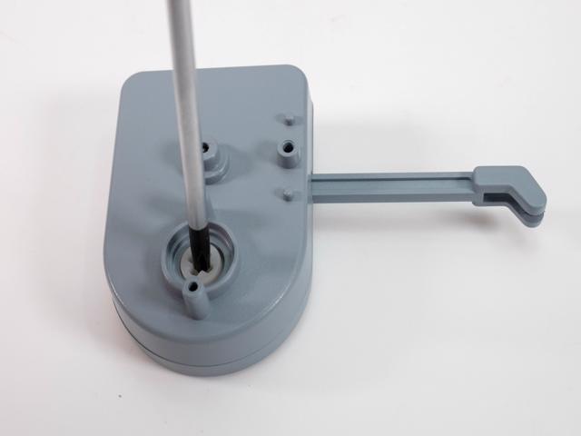

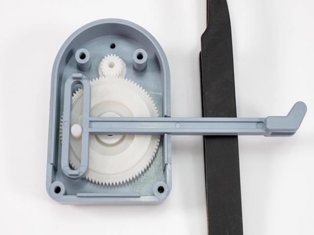

NOTE 2 In the instructions, they tell you to next position the peg on the left when the small cog is at the top. DO NOT DO THIS because it will stick when activated (i know because i built it as instructed, and then tried to turn it-stuck half way around!). Fit the shaft over the peg with the peg on the right hand side. Insert the small shaft into the centre of the small cog. Fit the other housing cover and screw in place.
This would be a good time to try it to see if it works ok. Put a cross-headed screwdriver into the visible cog and turn at least 360 degrees to make sure it works smoothly and doesn't stick. I built this a couple of times before i realised the correct way to assemble it so it turned. You might get lucky, but this method worked for me BigGrin.

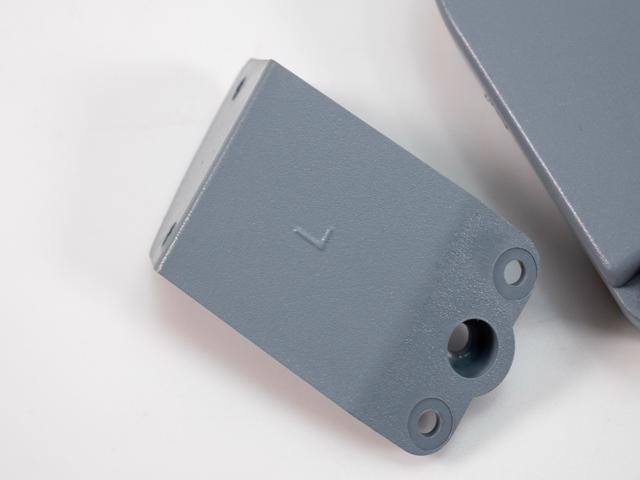

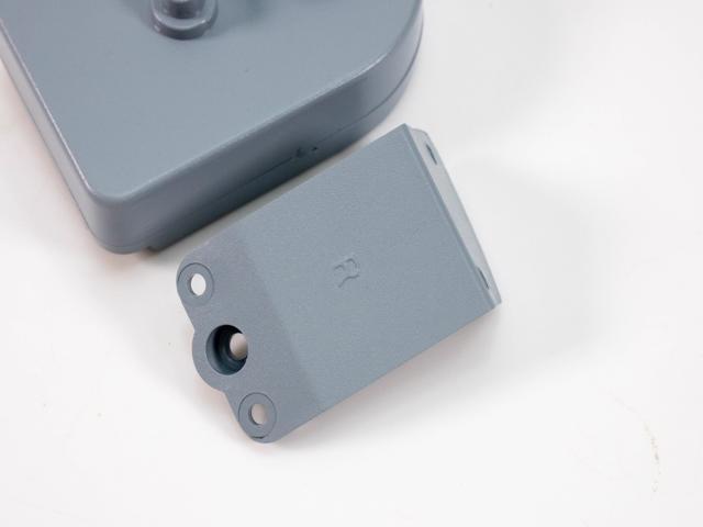

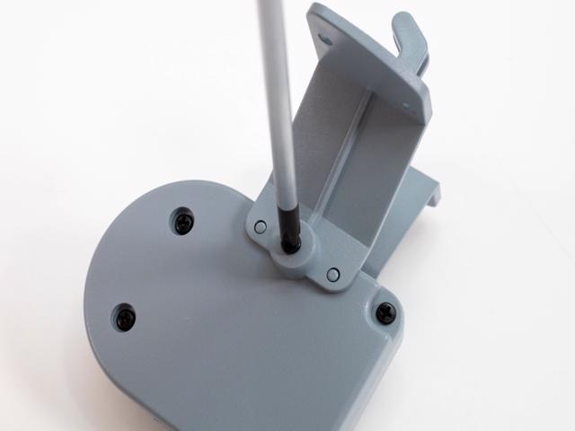

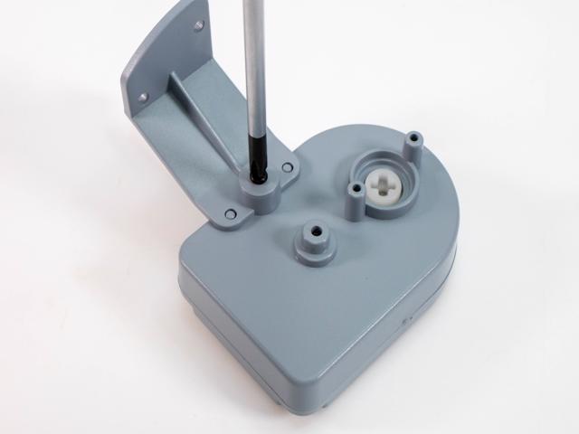

Once happy with the above, fit the two support brackets, which are labelled 'L' and 'R'. They slot over the two pins and are screwed in place.

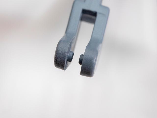

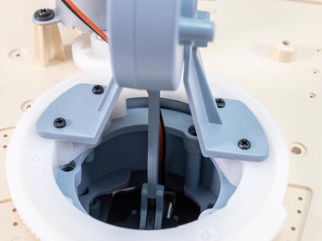

The next part is VERY tricky. I found the easiest way was to lift the gun barrels so the motor mounting is at it's highest point and the gear arm is at it's longest. There are two pins on the end of the gear arm and these snap into place around the motor mounting. Once firmly in place, the support bracket is screwed to the cog.
This completes Issue 73, but keep everything handy for the last issue this month Smile

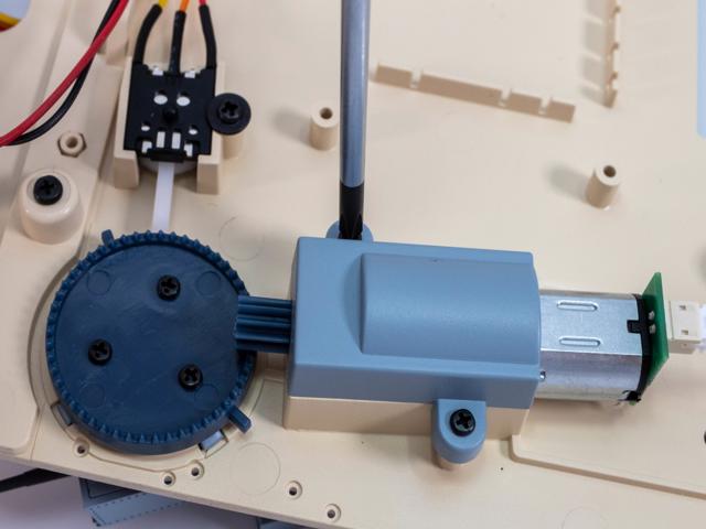

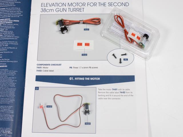

#271 Posted : 06 August 2020 21:23:19

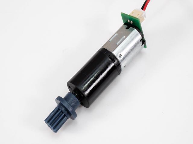

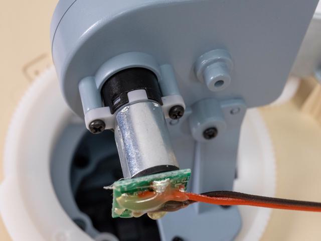

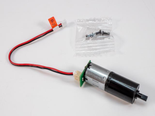

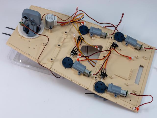

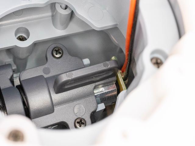

Finally, for this update, we assemble and install the motor for the second 38cm gun turret.
Taking the motor with it's cable, we attach the label to the socket end. The motor is then attached into the cog on the motor housing. Supporting the deck, it's screwed into place, aligning the cogs.
And that's it for now. Store everything safely.
