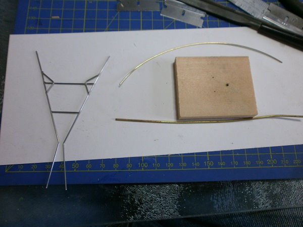

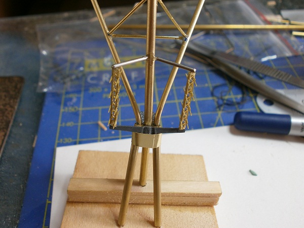

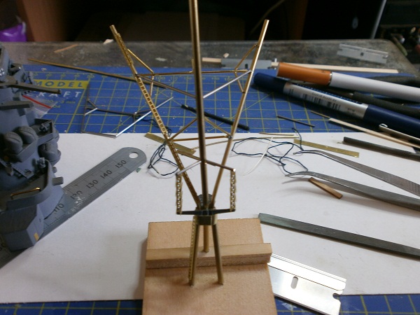

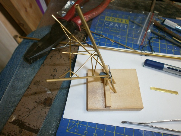

BigGrin Hi All

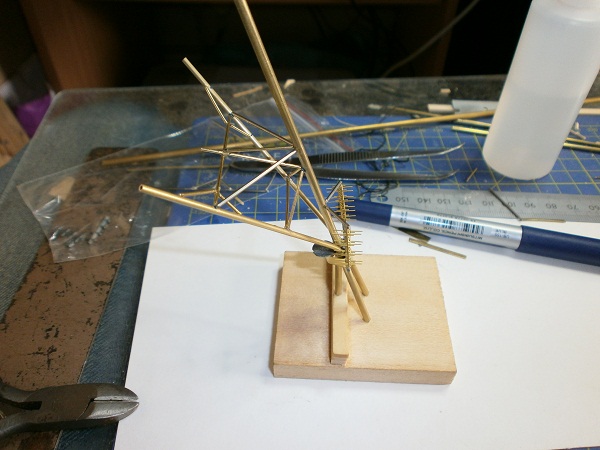

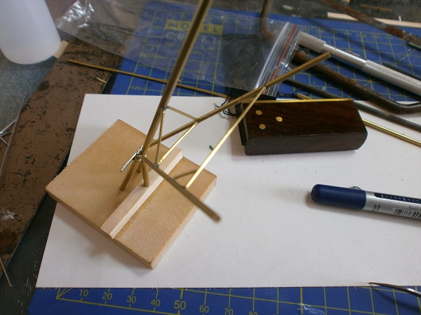

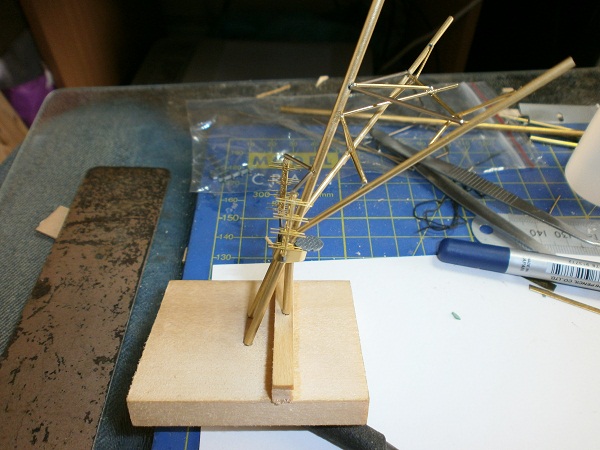

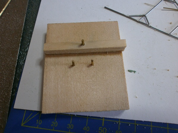

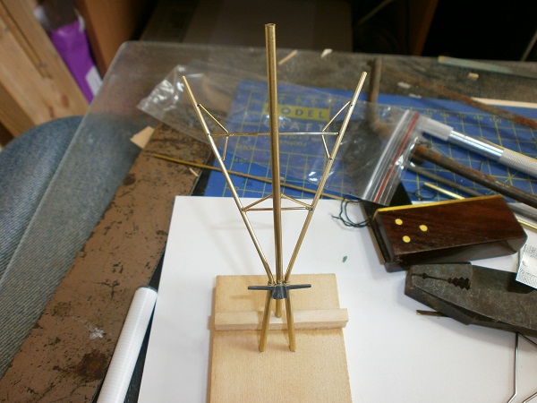

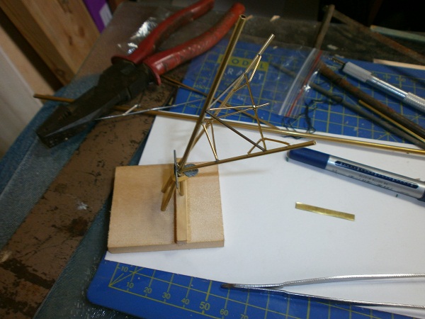

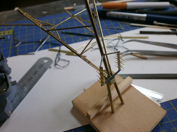

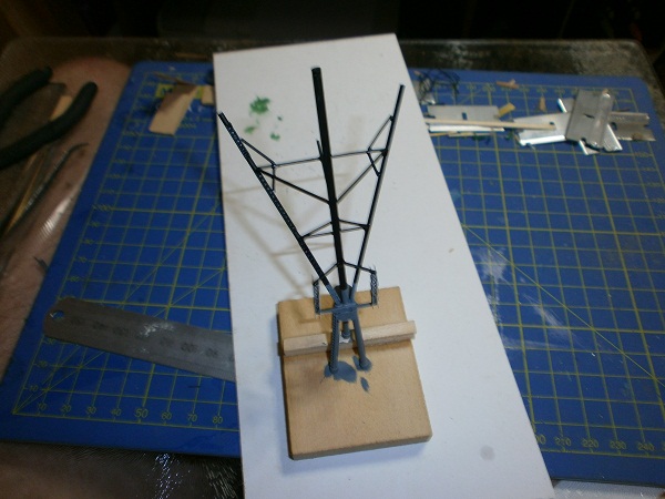

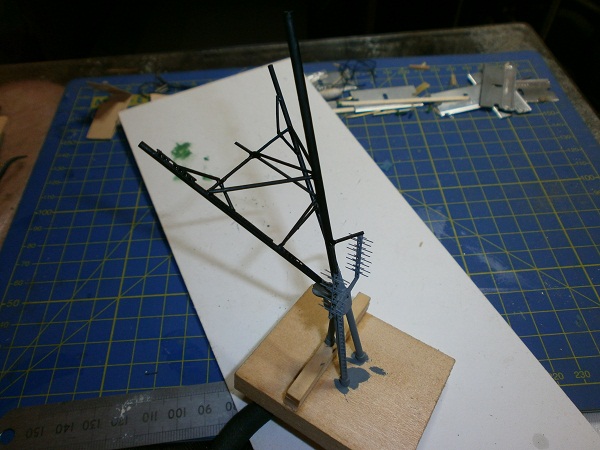

Here we go with another update,firstly though some background to this update.

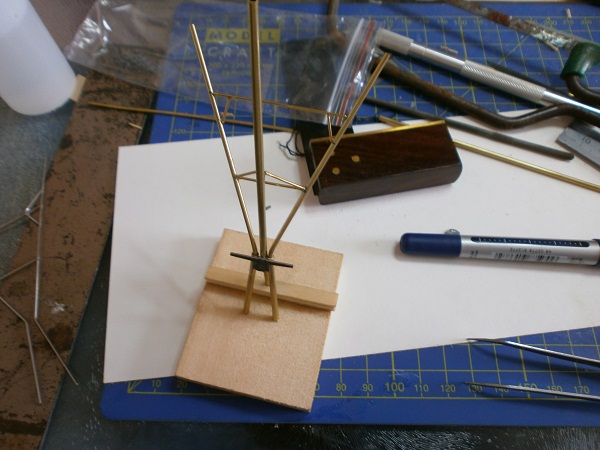

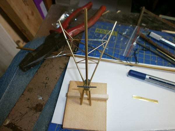

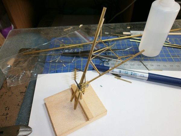

I noticed from when i obtained the Yamato book by Skulski and it was confirmed by our japanese friend Yaturo the mast as suplied in the kit [see 1st pic] is totaly wrong,the suplied mast has 2 rear legs and 1 front leg in reality it should be a single rear leg and 2 front legs and on top of this the rear leg is shorter as it sits on a higher part of the superstructure.Whilst many modelers would probably build the mast as suplied i decided that a scratch build was in order as i had etch to add aswell,The mast i have constructed is not an exact copy of the Yamato,s but its as close as i could get and in my eyes looks more in scale than the suplied one.
Firstly i constructed the step on the wood block and added pins to hold the legs in place,then using the suplied parts i took measurements and used brass tube to make up the legs,after bending the masts to there corect angles, i used the suplied radar part to form the searchlight platform but its back a little and not in the masts as per the instructions,finally here i added some brass sheet to tidy it up then it was a simple case on triming and adding the various struts, whilst hopefully keeping it all square.Finaly the etch parts were made up and added.
Its not perfect and still needs some tidying up and a bit of filler here and there but overall im quite happy with the results,as ussual all comments and questions are welcome

Blushing Thank you Saintsman
i had been planing this upgrade for a while,so basicly had all the parts ready[well the basic brass tube and sheet + etch] just needed the measurments to do it.Theres still some tidying up to do bit of filler to blend in the joints at the searchlight level.To be honest we all think of upgrades as modelers and etch is a fine example but to scratch build as i did this was i knew from the start would either be succesfull or a pigs ear.There are still a couple of small additions to add such as the port and starboard symbol lanyards, one looks like a egg timer the other a quaqdrated ball,but i got hold of the Mikasa etch which has a plethora of the mounting etch i need to finish of the masts.I apologise if iv gone on a bit but the Yamayo,s my baby right now and i just want to make a great build into a memorable result,your comments as always are most welcome and i just wish others would comment as i know this isnt one of the more popular builds,for instance i wonder what Jink,s reaction to my build would be but ho hum guess il never know

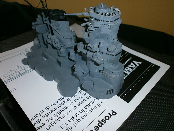

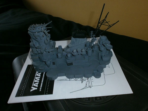

BigGrin Hi All

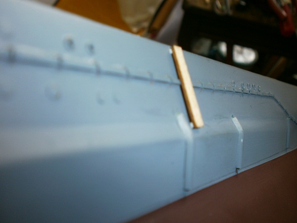

just some update pic,s i have added some ladders to the masts and put some water tight doors to the command tower bridge[sorry its not a brill pic].I have also added the final port side scupper but followed Skulski,s drawings from the book where its set proud of the hull not attached to it.As ussual all questions,comments are welcome

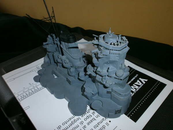

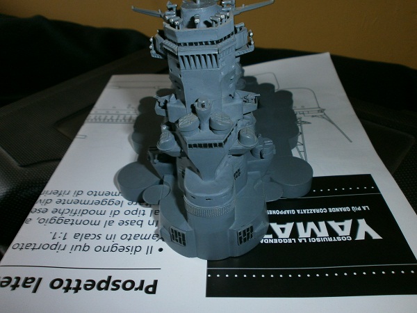

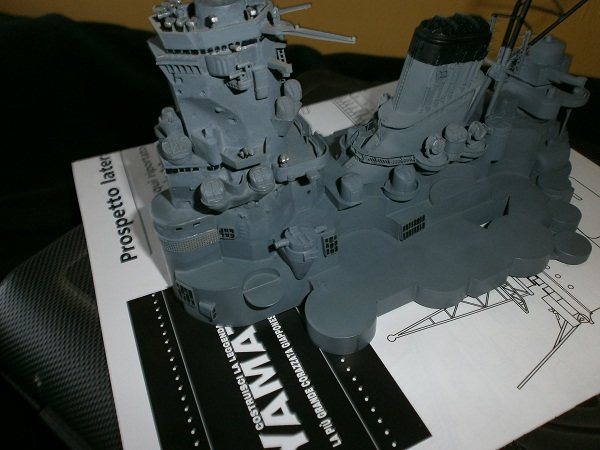

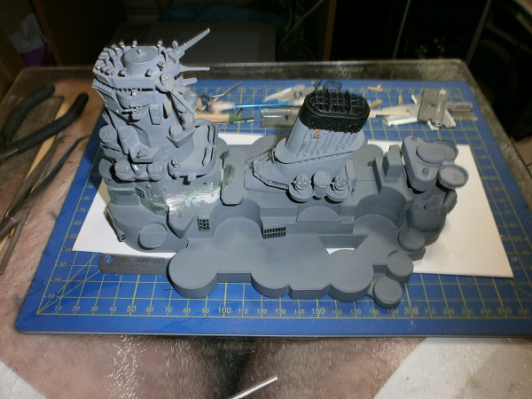

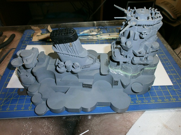

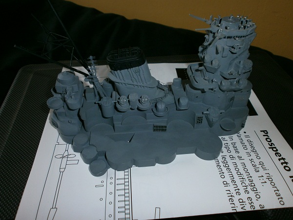

BigGrin Hi All
Just a quick up date on progress,iv started to add the major elements to the superstructure just a small amount of filler used to tidy up the bridge joint and il be adding an armour belt here that is omited from the build.The mast has had its 1st coats and just some touching up before permament fixing.As always all comments/questions are welcome
#279 Posted : 13 September 2012 19:46:53

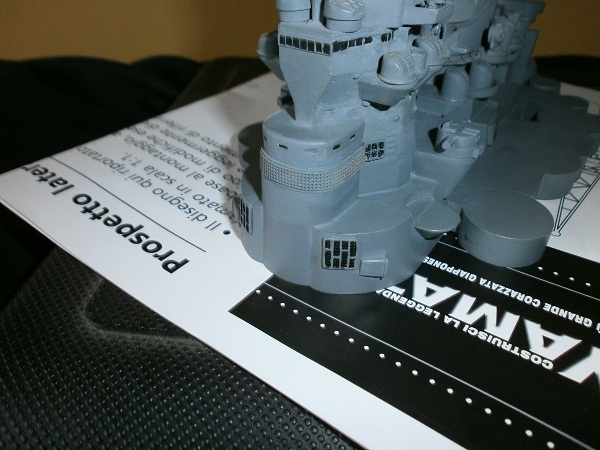

BigGrin Hi All

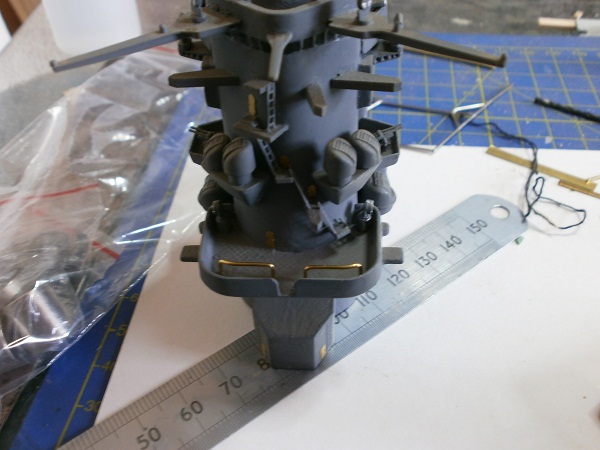

a few more pics on the attaching of the upper bridge components,the mast and the upper control stations have been added and the front bridge armour belt enhancment has been fabricated and placed in position.its had a coat of grey so far more painting to do as in more grey and the small coloured bits to fill in thid more or less concludes this months issue and as ussual all questions/comments are welcome
