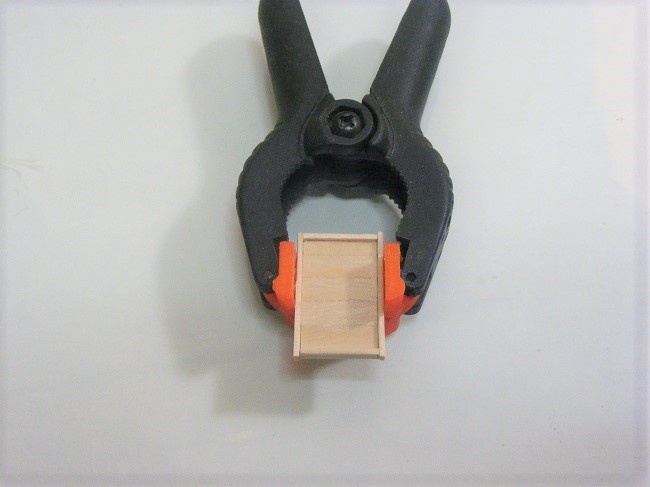

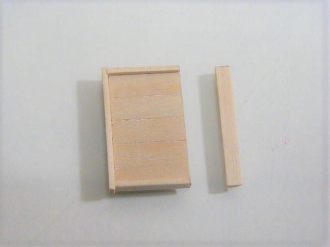

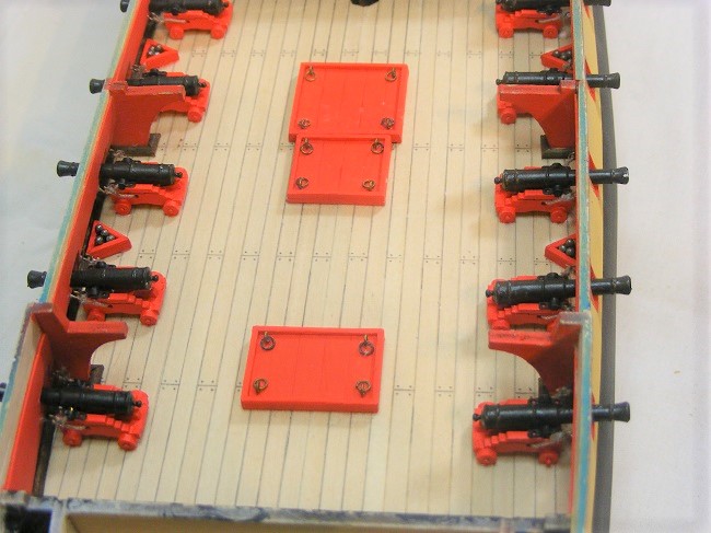

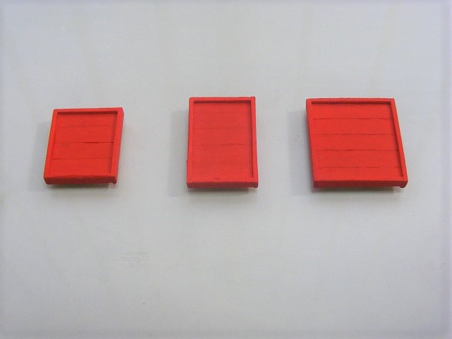

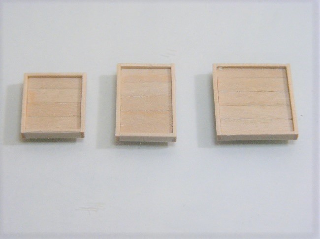

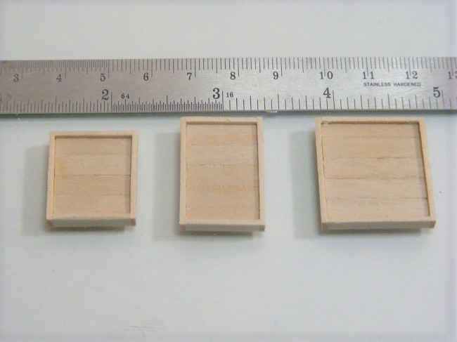

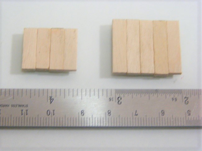

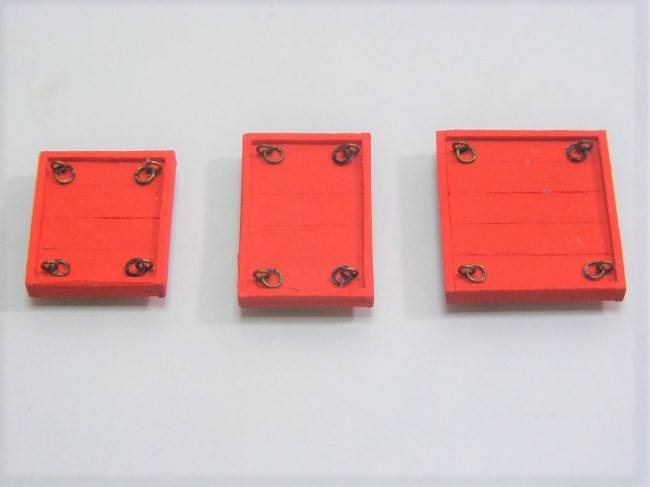

Progressed to making up the 3 hatch covers, the process is the same for all.. Using a 2 x 5mm strip and cut the required amount of lengths for each hatch cover. Cleaned up the edges and glued together number of lengths to give the correct size for each hatch cover. Left to dry and sanded the surface of each to give a smooth finish.
Used a 1 x 3mm strip and cut lengths to fit around the perimeter of each hatch, sanded smooth and glued into position, left to dry. Gave each hatch cover a coat of primer before applying coats of our lovely bright red....BigGrin BigGrin

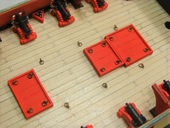

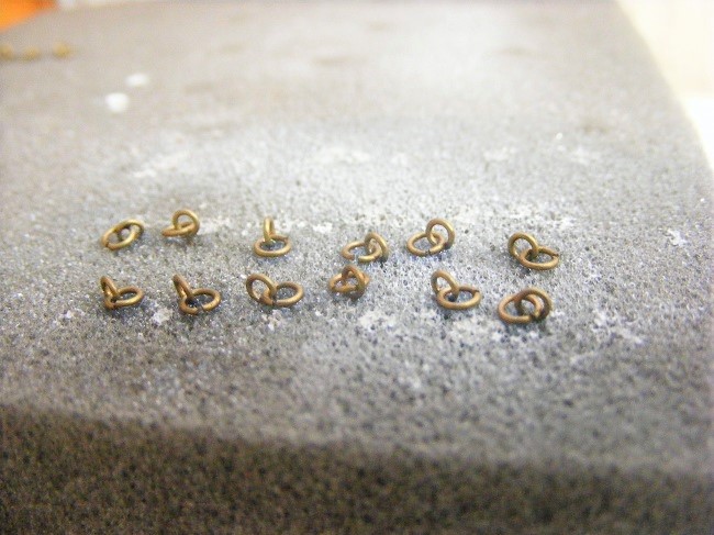

Took 12 brass eyelets and attached a brass ring to each before applying a blackening solution. Once the effect was achieved, washed the eyelets to remove remaining blackening agent, then cut the stem of the eyelets down to a length of 2mm. Drilled a 1mm hole 2 mm from each corner of the hatches and glued an eyelet into each hole, left to dry.
Glued the hatches into position on the deck, left to dry. This brought to an end stage 21. Until next time, happy modelling all.....Cool Cool

Well stage 22 has to be the smallest stage done to date, here it is for what its worth.....BigGrin BigGrin

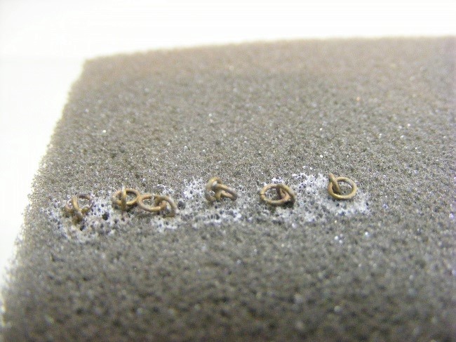

Took 6 brass eyelets, attached a ring to each and coated them with blackening flued. After they were washed I then fitted them to the deck in the positions outlined in the instructions.....Cool Cool .. This brought an end to stage 22 but in the next stage we start the process of fitting the next deck, so until then, happy modelling.....Cool Cool

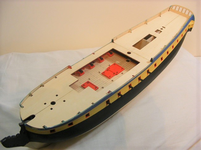

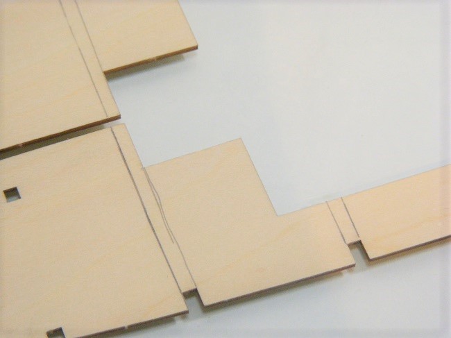

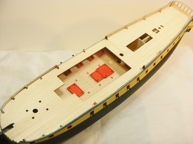

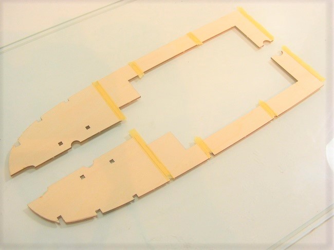

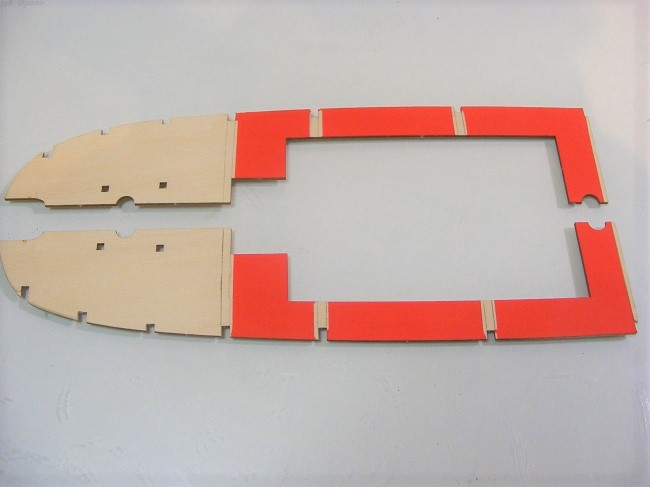

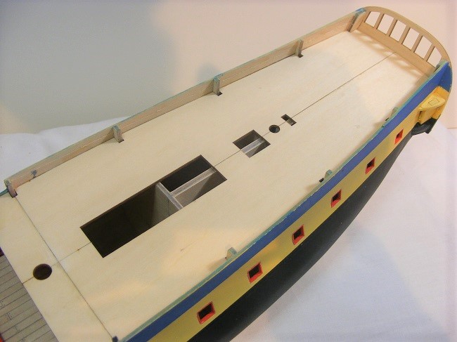

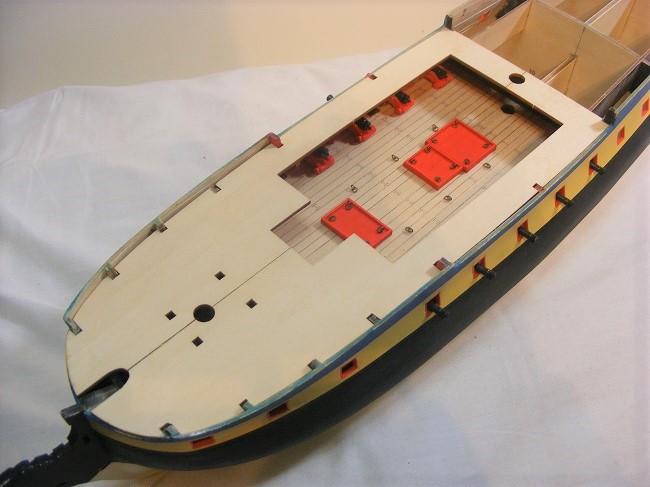

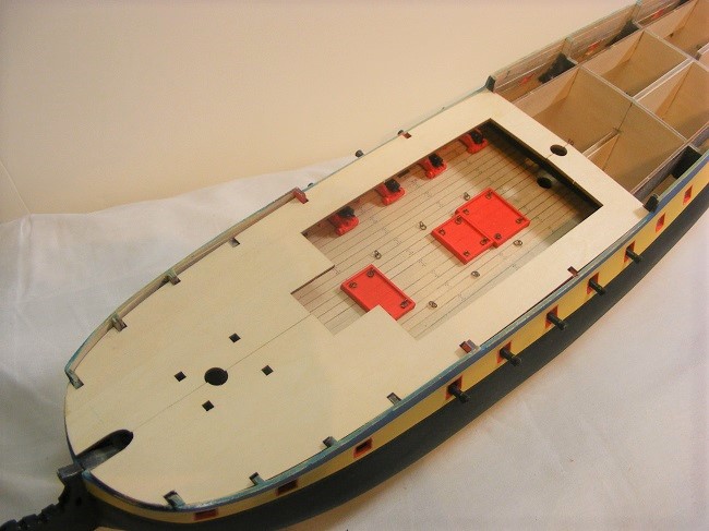

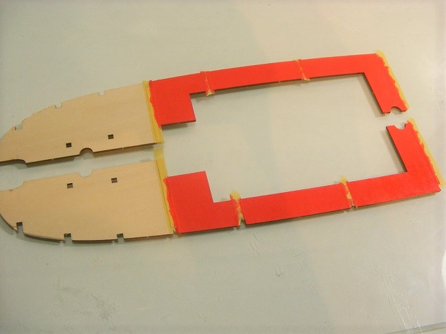

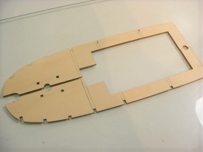

This stage of the build has us fitting the next deck. This started by test fitting the two forward deck sections and happy to say that only very minor adjustments were necessary to get a good fit. Once happy, removed the sections and turned them upside down. Marked off and masked the areas outlined in the instructions, this where the deck is supported and the masking is to ensure the areas are clear of paint giving a good gluing surface.
Out came our trusty red paint again and painted the underside of the deck, left to dry before gluing the deck in place. Then test fitted the two rear sections, again only minor adjustments were necessary for a good fit. Once happy, glued the rear section into position. This brought an end to stage 23, the next stage has us planking the deck just fitted so until then, happy modelling all....Cool Cool
Gibbo

Hi Alan
The ship is looking great mate, can you tell me why the underside of the decks are painted ?
#270 Posted : 12 January 2018 10:05:46
Gibbo wrote:
Hi Alan
Hi Gibbo,
Thanks for looking in, appreciated... I'm constructing this build as per the instructions and asked myself the very same question, it is what the instructions tell us to do so it was done. What I did notice afterwards though and its not very clear in the pics, is that there is a distinct red hue now to the lower deck area, a hue that wasn't there during the test fitting of the decks....Cool Cool

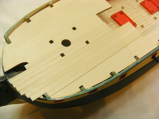

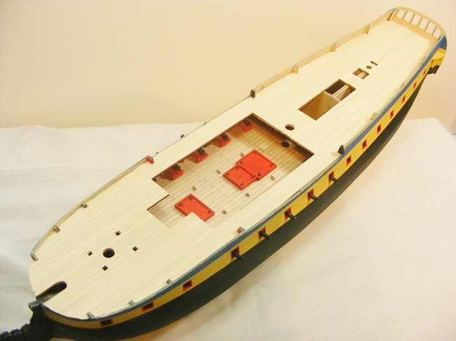

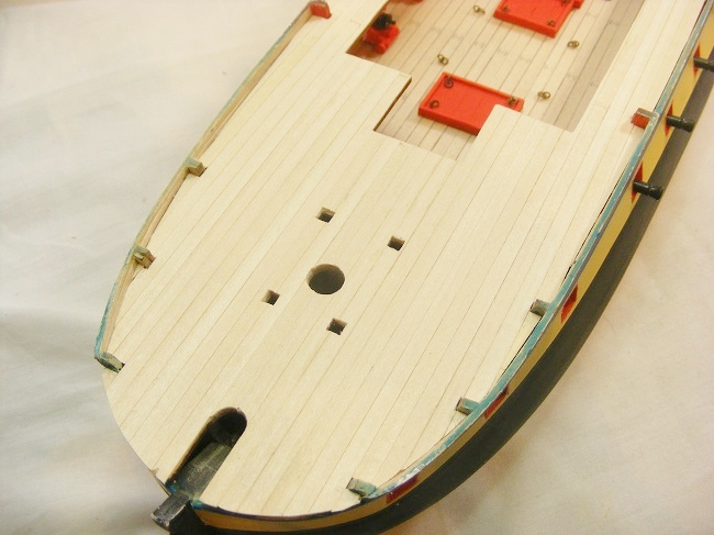

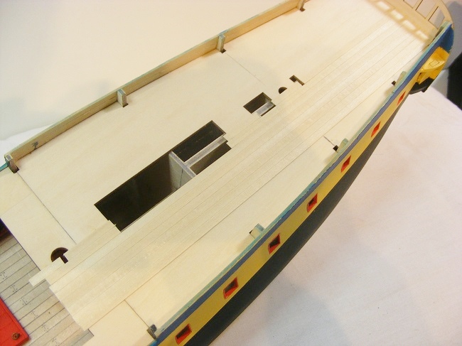

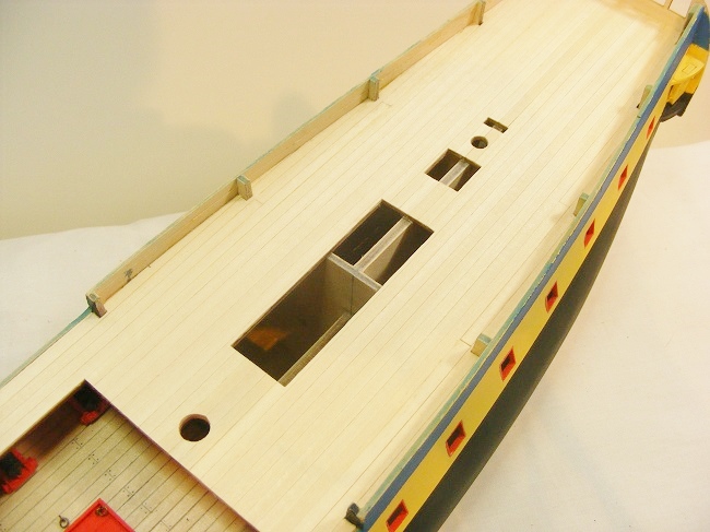

In this session we move onto planking the second deck. This was done using 0.5 x 4mm veneer strips, giving the edges of each strip a very find sand to ensure they marry against each other nicely. Starting from the centre join line of the deck sections, laid planks to cover the centre section of the bow area moving onto to covering the centre section of the stern area. Made sure I marked any necessary cutouts for the masts etc.
With the central deck area completed then moved on to complete the decking on the port and starboard sides, trimming and filling gaps where necessary up to the bulwarks. On the longer lengths the strips were staggered at frames 6 and 11.
This ended stage 24 and by the looks of things stage 25 will be another short one.

I can see that red hue now, lovely job on the planking Alan.
