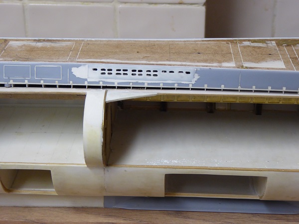

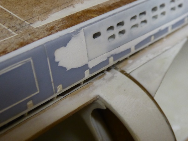

With this job done I could place the template over the hole and have none of the original vents showing through. The problem with this was that the very thin 0.25mm sheet that the templates were made of had no support from behind, thus leaving them very weak, vulnerable with a very short shelf life.
I imagined pushing my finger through at some point in the future.
So I made and glued in place a rough lattice work of 0.5mm thick plastic sheet to offer support for the patterned templates.
The attached photo shows the lattice work 80% complete on the starboard side.

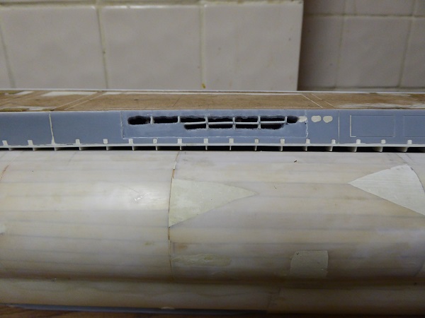

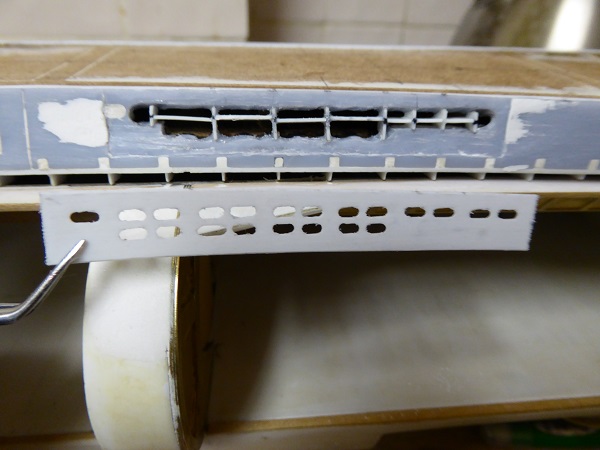

#262 Posted : 22 February 2017 21:09:51
The attached photo shows the template being held up against the lattice work prior to fitting.

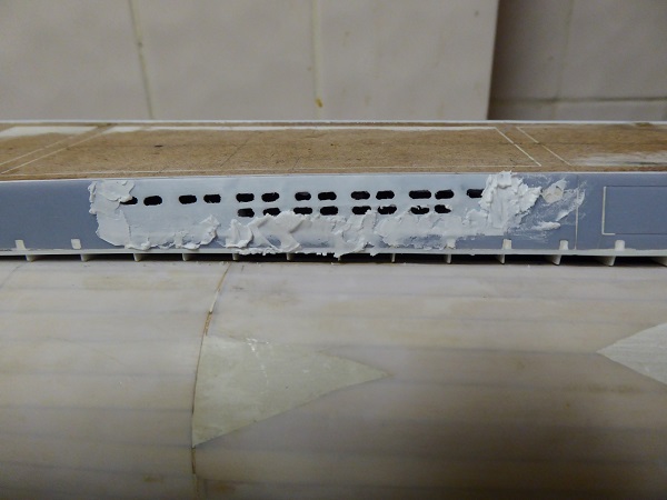

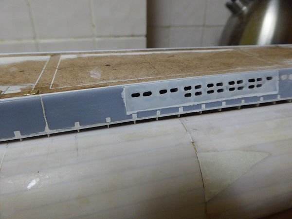

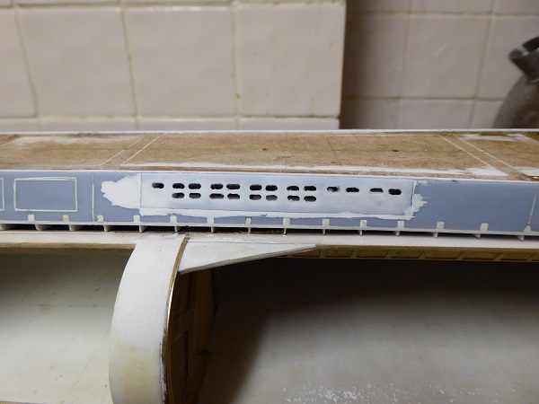

#263 Posted : 22 February 2017 21:12:14
I then glued the template in place, applied filler to the edges, allowed an overnight dry before sanding smooth.
With all the mishaps that had occurred i'm very happy with the end result.
See attached photo.

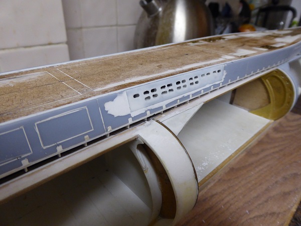

#264 Posted : 22 February 2017 21:13:44
An angled photo looking aft.

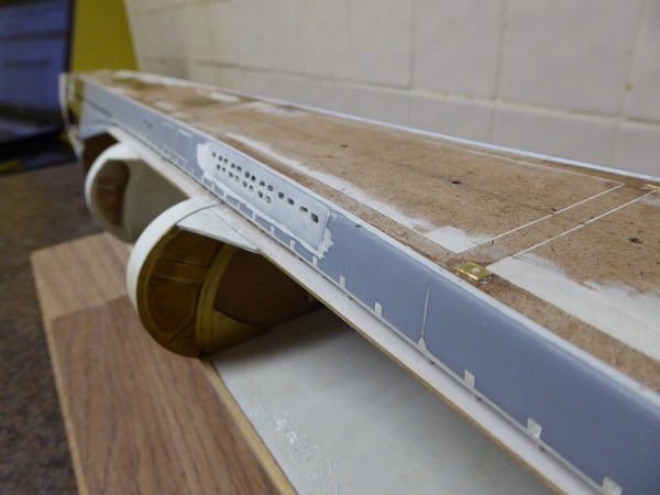

#265 Posted : 22 February 2017 21:15:26
Another angled shot.

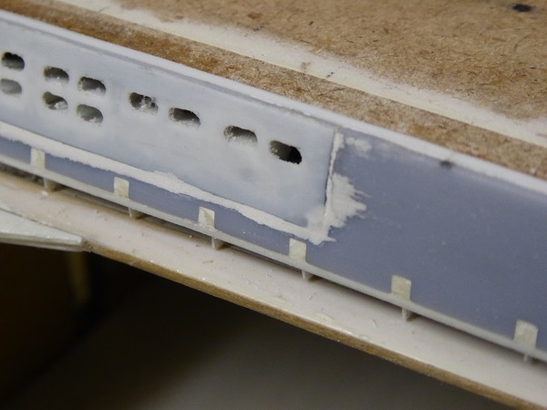

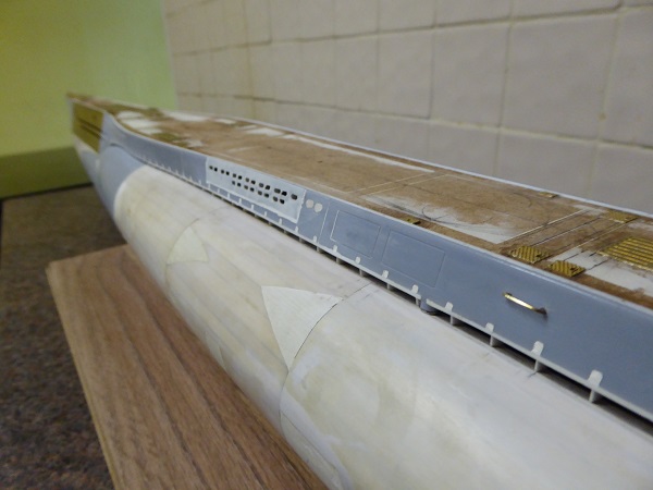

#266 Posted : 22 February 2017 21:16:31
An angled close-up looking forward showing how the template blends with the hull due to the recess.
#267 Posted : 22 February 2017 21:29:00
A close up showing the flush fit; looking aft.

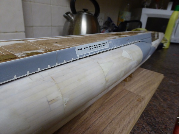

#268 Posted : 22 February 2017 21:32:02
#269 Posted : 22 February 2017 21:33:05
Side view.
#270 Posted : 22 February 2017 21:36:10

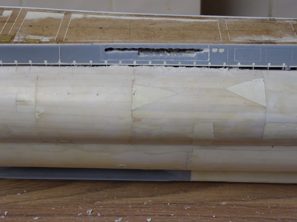

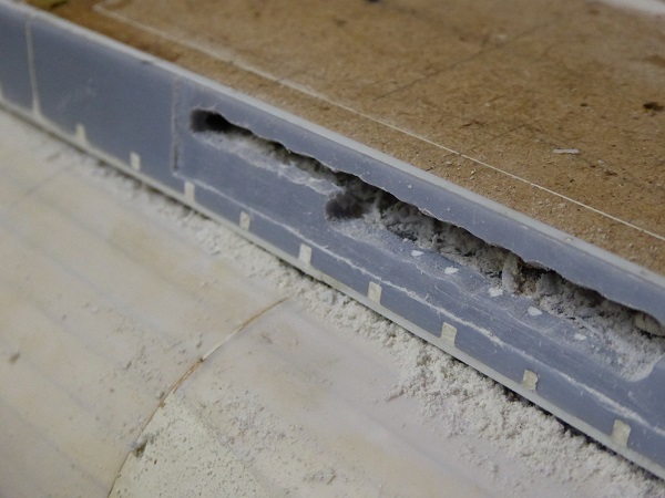

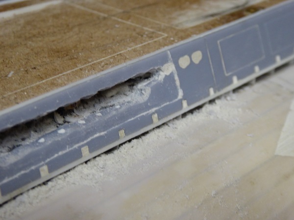

Now for the Port side. The template was already made as mentioned before but this time I created the recess without the dremel, just a craft knife and a needle to shape it.
The attached pic shows all the original vents ground out.

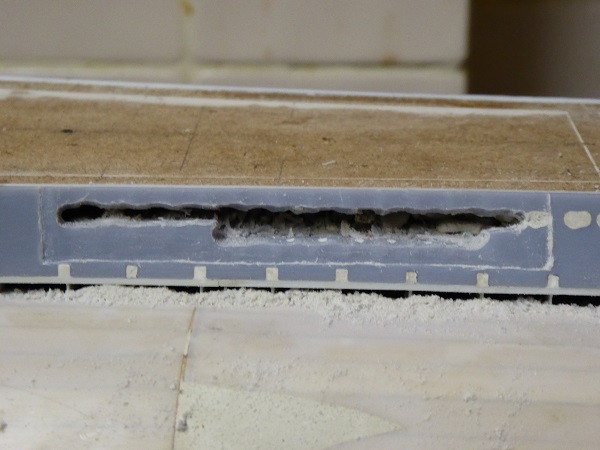

#271 Posted : 22 February 2017 21:37:37
Mess, mess, glorious mess!LOL

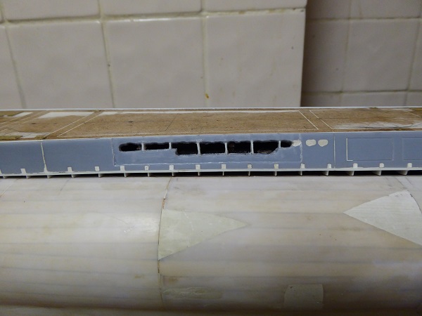

#272 Posted : 22 February 2017 21:42:48
Another photo showing the port side with the original vents ground out.
#273 Posted : 22 February 2017 21:44:27
Another picture showing a distant shot of the port side.

Port template glued in place; filler added.
#277 Posted : 22 February 2017 21:49:58
Filler filed smooth and flush to hull. Looking good I must say!BigGrin
