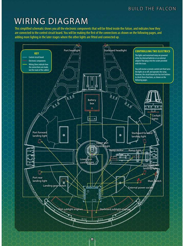

This seems to definitively show there will be landing lights ...

That's great! I'm glad to see that the landing lights are on the Falcon. Did this diagram come in the current issue?
