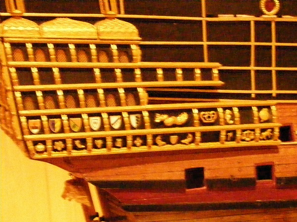

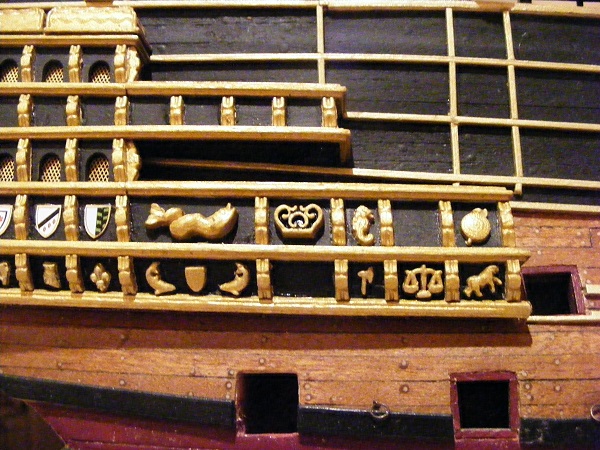

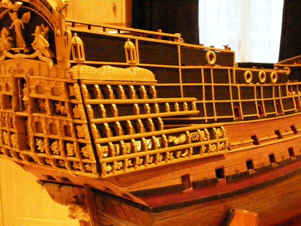

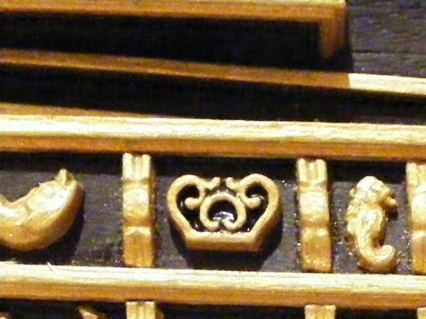

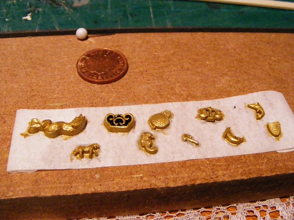

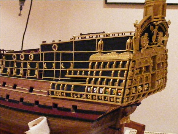

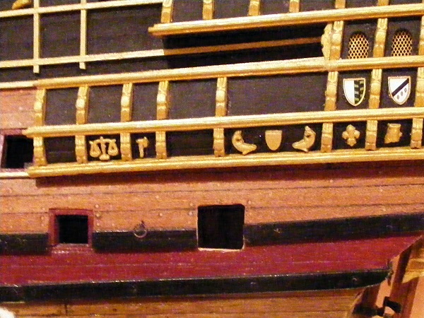

Tonight brought to a conclusion the work on issue 93 with the exception of a cannon..... Cool Cool .. This issue was simply the painting and fitting of 10 more ornamental pieces, 5 for either side gallery. Painting was as before, remove any burrs, coat of grey primer and two coats of metallic gold... A little piece of fiddly painting on one piece and that I think turned out quite well.... All pieces fitted in place and when dry received a coat of klear Kote gloss....Cool Cool .. Next week looks as if we get back to some building work in the preparation and fitting of the chainwales....It will be nice to get back to working with wood again....BigGrin BigGrin .. Leaves me with a few nights where I can do some work on the 2nd plank layer on the Titanic..... Happy building all....

Hi Alan. BigGrin
Looking fantastic as I expected on looking in. Cool Cool
Would you mind if I ask you a question?
What glue are you using to stick on the ornaments?
I presume something like superglue gel? A tip here for the future will be handy. BigGrin
George

Thanks for the kind comments George, appreciated. Cool Cool .. For the smaller pieces I am using superglue gel but for the larger heavier pieces I turned to using epoxy. Epoxy with a 30 min setting time is my preference as it allows for some wiggle room to ensure pieces are set in the correct position.... Cool Cool
Hope this helps.
