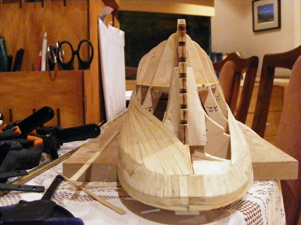

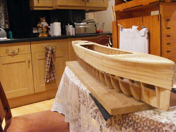

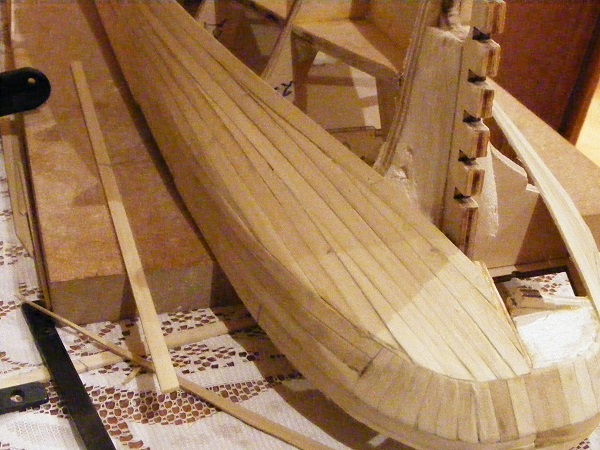

#249 Posted : 08 April 2014 23:27:50
Short update, slow process but the planking continues as does the shaping of the stern... Think the basic shaping is there for the first layer of planking but still have work to do as more material needs to be removed from the final rib in order to narrow the width and get rid of any curvature... difficult to explain so hopefully all will become clearer as the process moves forward.... The sanding process will bring out the final shape of the profile ready for the second plank layer... So far, am pleased with how it is progressing....Cool Cool .. Happy building all....
#250 Posted : 09 April 2014 13:36:07
Hi Alan.
Planking is looking Good. Your Stern shape is looking good.Just sand gentley and try the planks spot on mate.Cool BigGrin Ian
#251 Posted : 09 April 2014 14:27:46
looks like a good start Alan.
your stern shape looks good so far but your going to have to put quite a bit effort into spacing your strakes at the stern.
If it was me I would be mapping this out on paper before going much further so you have a plan in your mind.
Enjoying your build though
J

#253 Posted : 09 April 2014 22:35:24
ian smith wrote:
Hi Alan.
Thanks Ian, can assure you everything is being done gently at the moment, the stern is proving to be quite a challenge but do feel I am getting there....Cool Cool
#254 Posted : 09 April 2014 22:41:49
J
Thanks Jase for those positive comments..... appreciated.... Agree with you regarding the spacing of the strakes to take the sharp profile of the stern.... Have made slight marks on the ribs where the strakes want to lie and it looks as if every second strake will have to be tapered.... It's coming together and it is a challenge to get it to look the part. To be honest, I am kind of running on instinct, the study of many photos and a lot of crossed body parts but feel sure it will work out...... BigGrin BigGrin .. Thanks again for looking in....Cool Cool

#258 Posted : 10 April 2014 23:33:09

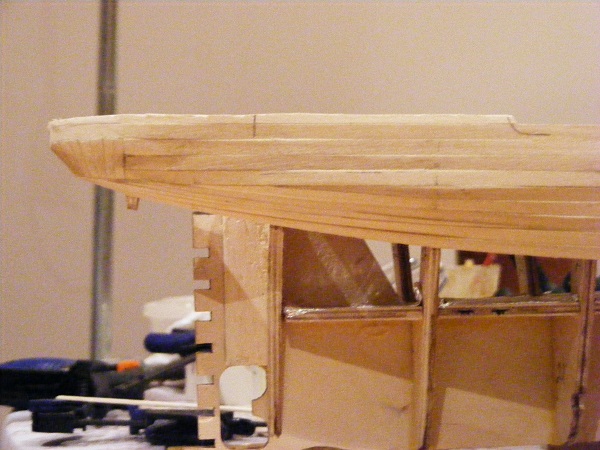

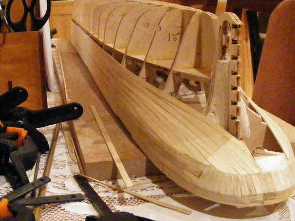

More work on the stern shaping so thought I would give a couple of underside views to show how its progressing... If you look at the difference between the left and right sides you will get an idea of how much material I have had to remove from rib 23.... Trick now is to get the right side to match the left..Blink Blink . Now starting to really think it is getting there..... more soon....Cool Cool
