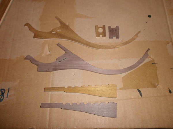

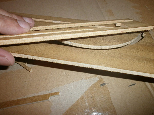

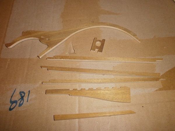

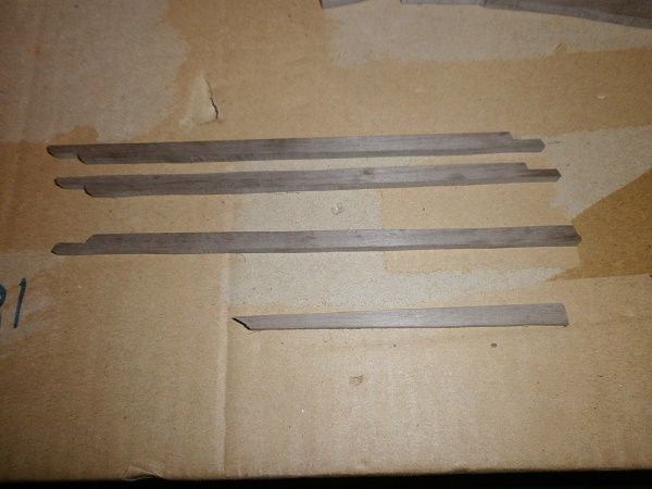

This month's parts include the keel sections which are made of thin hardwood outer surface with a lightply core and the instructions reccomend painting these parts.
As i am doing a minimum paint build i decided to replace these parts with 5 mm Walnut sheet , using the parts as templates they were cut out on my electric fret saw.
The fret saw if your lucky enough to have one will save you a lot of time but its still possible to cut these parts out the old fashioned way.
More soon
#243 Posted : 12 July 2014 22:51:57
Hi Andy, walnut sheeting looks far better than simply painted hardwood/ply parts.... great job in reproducing the replica parts.....
Looking good...

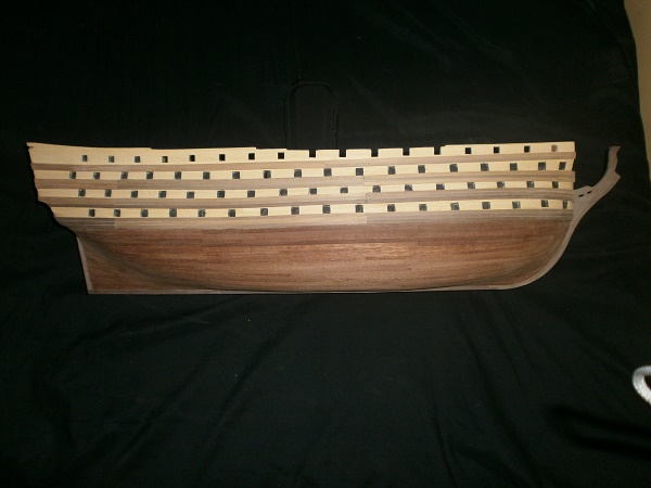

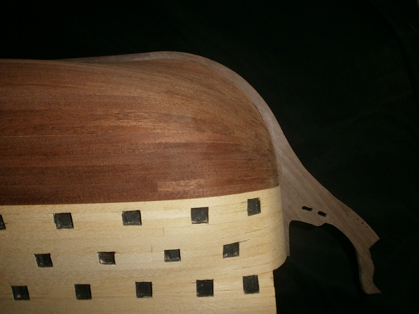

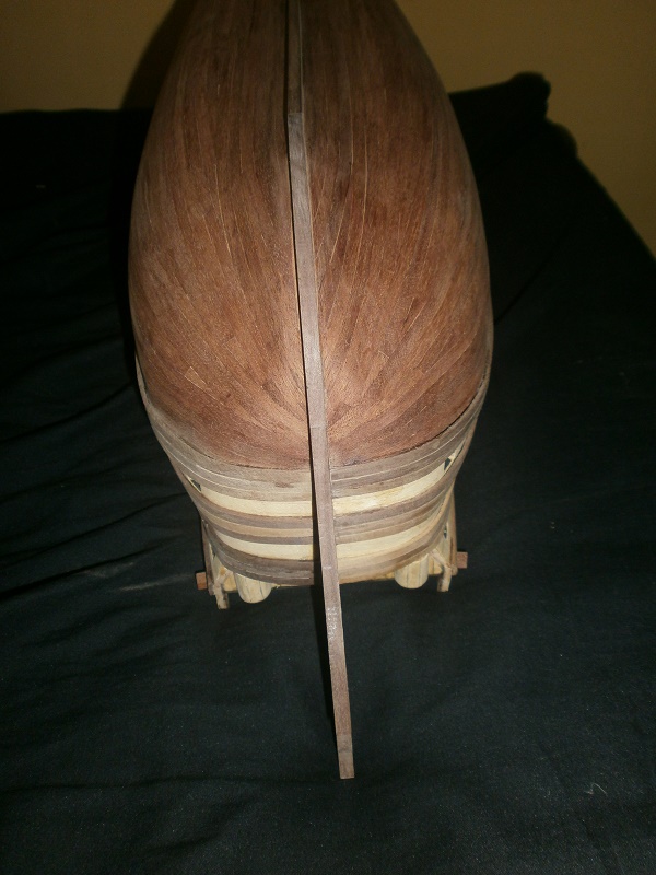

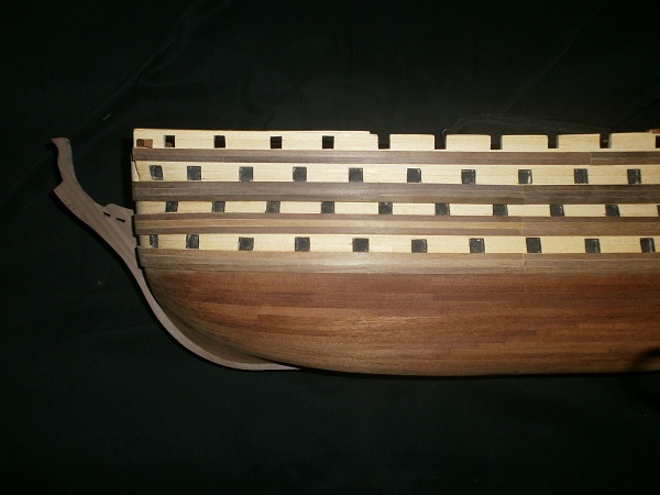

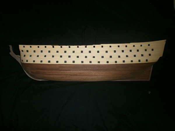

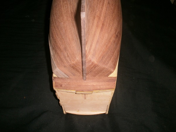

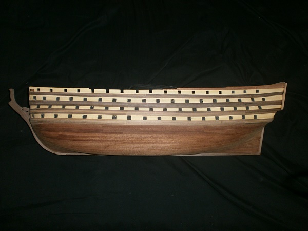

#249 Posted : 13 July 2014 21:18:26

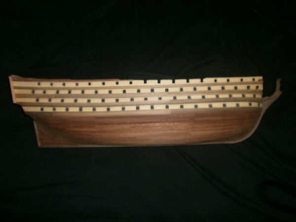

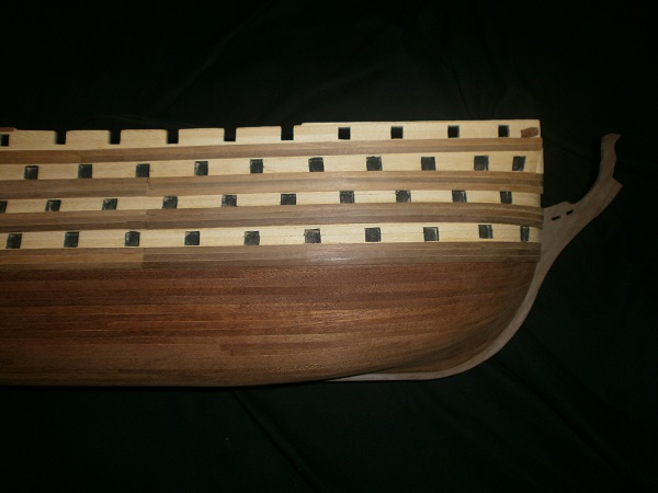

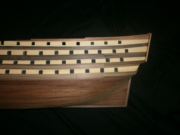

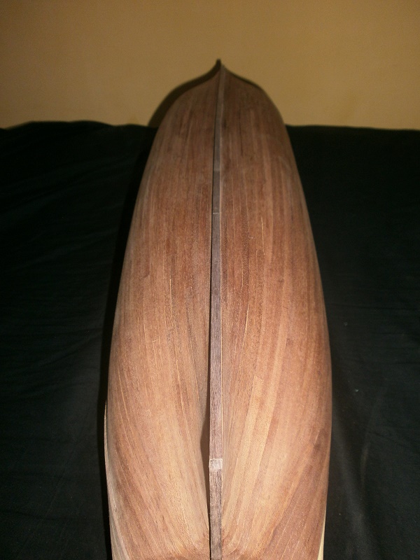

BigGrin Hi All
A little more done but still loads to do as yet.
Today i fitted the Walnut keel parts and then proceeded to fit the rubbing strakes between the decks , no real problems encountered here just make sure the strakes at the front and lower stern are well soaked before using your plank bender to get round the curves. The lower three stern stakes must be bent and twisted so be careful here.
More soon
#250 Posted : 13 July 2014 22:32:53
Looking good Andy, think it will look fab when varnished.....
#251 Posted : 13 July 2014 23:24:23
BigGrin Hi Alan
Thanks for looking in and your comments, there will be two different types of varnish/seal used on the hull hopefully the contrast between the two will look good.

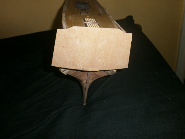

#260 Posted : 20 July 2014 19:57:27

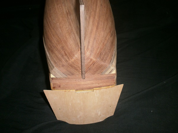

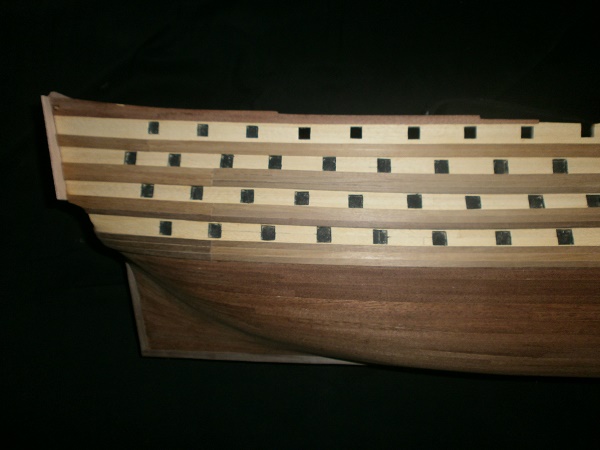

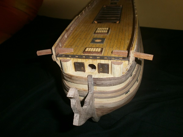

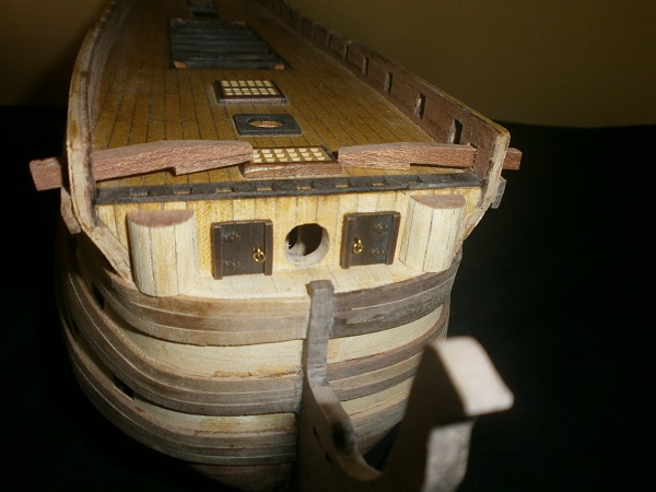

BigGrin Hi All
More progress on the triny, all the rubbing strips are now compleat on both sides of the hull some tidying up and sanding still needed here also the upper stern hardwood strip has been added above the cannon ports.
Still in the stern area the transom former has been glued in place and more hard wood strip used to fill in the stern bulwark.
At the bow the two latrines have been added after lining with bass strip wood and roofed with hard wood strip along with the two doors and handles.
Finally the holes for the catheads have been made and the catheads made up ready for glueing in position as they are just free floating for now.
More soon.
