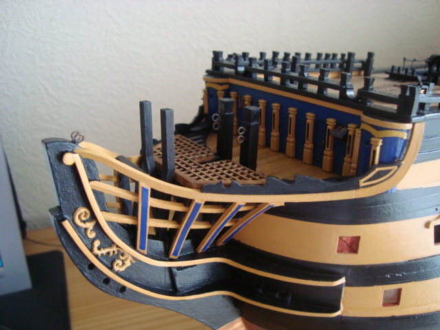

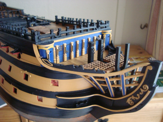

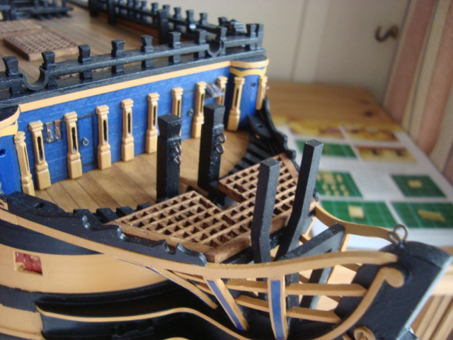

Not trying to bore you all with beakhead pics - I promise these are the last ones for a whileBigGrin The rest of the work is later in the build when the figurehead / rigging is done. The replacements for the missing decoration over the pillars on the beakhead wall still hasn't arrived yet so will have to wait for those.
Just some small addons - the decorations are now on and the grating is also done. I also noticed while looking at the real Vic pics that the blue vertical stripes dont go all the way to the ends of the supports so I have "edited" these as well and tidied up all the joints with filler and paint touch-ups. Issue 87 next. Cheers

Thankyou Jase - One question, as you can see I have stained the beakhead grating as per the official build but looking at your detail pics just now I see that it's painted black. Do you think this could a recent thing or that it is supposed to be black?
I can not be 100% but all the other greetings where wood so i am guessing the bow ones where black. if you think about it this part of the ship got a pounding from the elements so the extra protection of paint would have made sense.

Just one observation Mellow I notice that you have only fitted 2 eyebolts to the front of the knights head posts, I assume you are following the D'Ag instructions, but from studying the actual ship rigging, there should be three on each post (check post #98 on my build log for details) Perhaps D'Ag are doing something a different way or omitting something. Just wouldn't like you to get too far in and find you need to fit more when it will be harder to get to.
