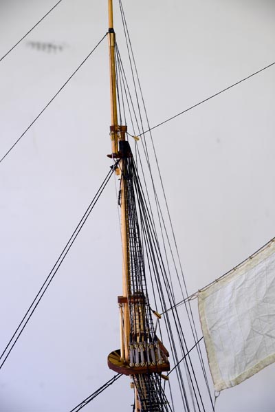

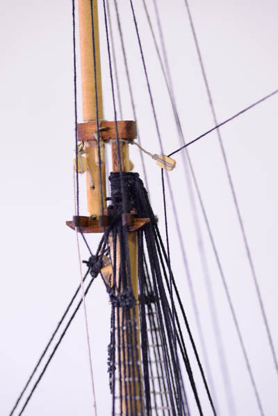

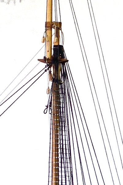

#252 Posted : 20 July 2016 12:13:15

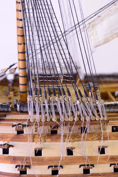

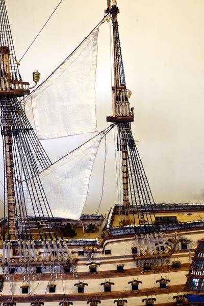

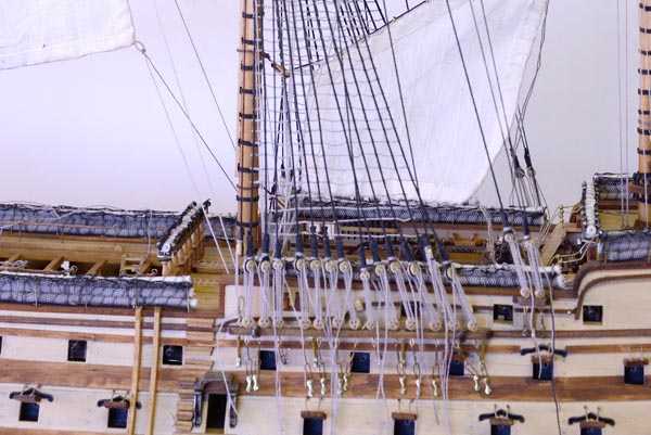

Hi All,
Finished the Foremast Stays this weekend. It is not that easy to photograph the progress as some of the other items.
I have added some pix of the completed foremast. I must say that on closer inspection, the dead-eyes could do with a re-alignment. Hope these close-ups will help those not up to this stage.
One thing I noticed after watching the videos; the thread used seems to be much stiffer than what I received. Mine is quite elastic (which isn’t a bad thing as it doesn’t sag) and it is very furry – just wondering if I’ve missed something?
A big thanks to all involved with the videos - they're really helpful.
Glad things are moving at an even pace again.
Kind regards

Hi Garth, looking fab and you patience is paying off....
The thread used on the Official builds is the same thread provided with the kit. To stiffen the thread and get rid of the furry look you could run the thread over a bees wax block.
Gibbo

Hi All,
Thanks to everybody for looking in and for all the inspiring comments.
Thanks Alan for your tip on the thread. I’ve had a look on the net and found some YouTube vids on the subject. They recommend running the thread threw a block of bees wax, as you suggested. It really looks like a good idea and I am sorry that I didn’t do that from the start. Too late now, but I will definitely do it on my next build – the rigging looks so much better this way.
My only concern is, is that once waxed, will the diluted White glue still hold the thread?

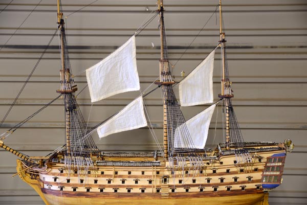

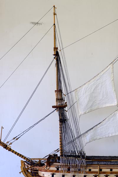

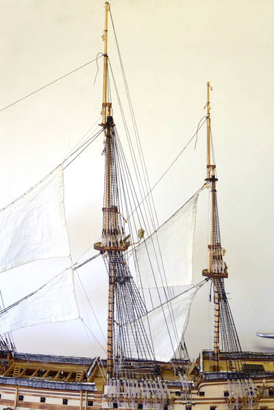

#258 Posted : 25 August 2016 12:40:07
Hi All,
Mainmast Stays done!
For those following my build, please note that the 2 short Chainwales are not in the correct position. They should be about 5mm lower.
Sorry to all the Purists out there – but I’m going to live with it.
Other than that, the assembly went without a hitch.
Kind regards
