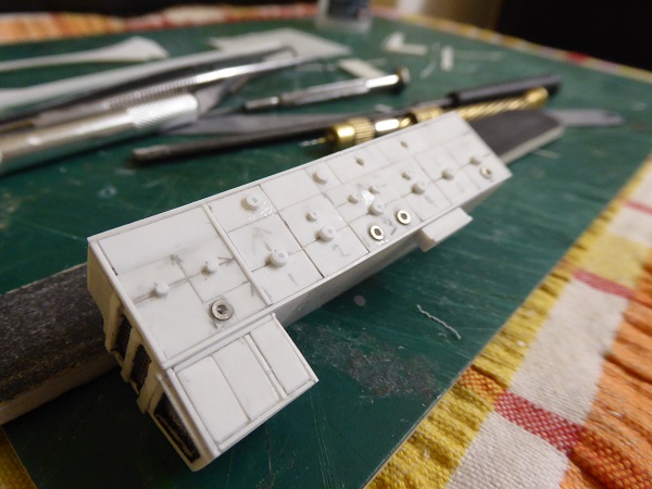

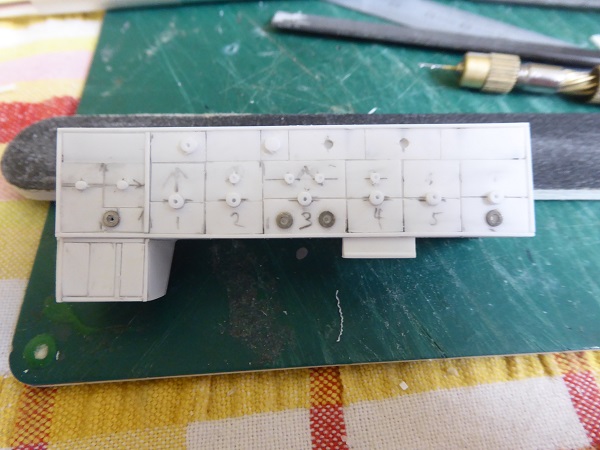

More progress this week adding details to the port main motor switchboard.
The attached photo shows the current stage of the switchboard. A little more work next week should see this done. I'll be adding handwheels after it's painted and these locate on all of the raised rods you can see. The smaller rods represent push buttons.

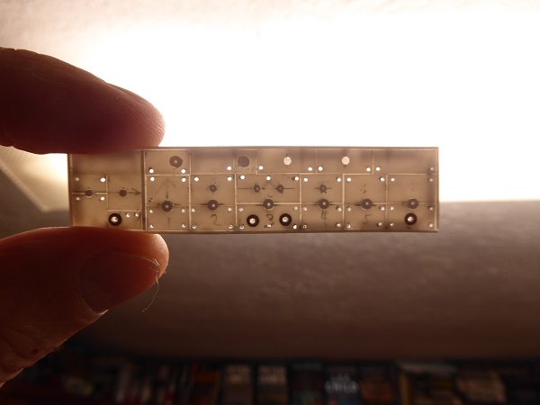

#243 Posted : 19 November 2020 23:15:40
Looking from another angle.

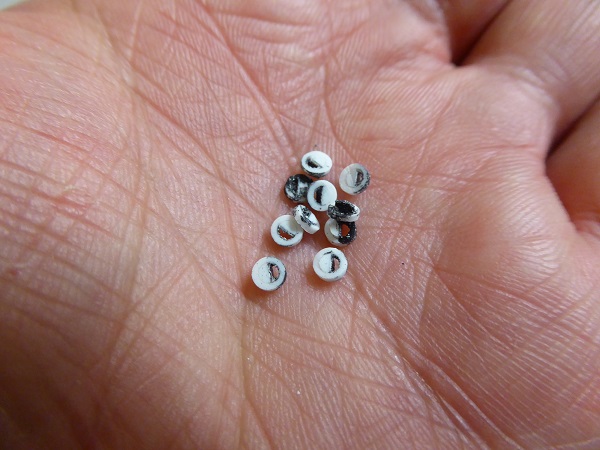

I also spent a bit of time making 10 x voltmeter/ammeter dials. I drilled a 2.0mm hole length ways through a 3.0mm diameter styrene rod. Sliced this into small sections and then filed a 2.0mm diameter rod to a half moon shape, sliced this into small sections and fitted these into the holes to give the dial profile.
I also spent a bit of time preparing a photo to make into decals which i will fix behind clear sheet to give that depth and detail when placed behind the dial face.
The attached photo shows the half moon shapes fitted.

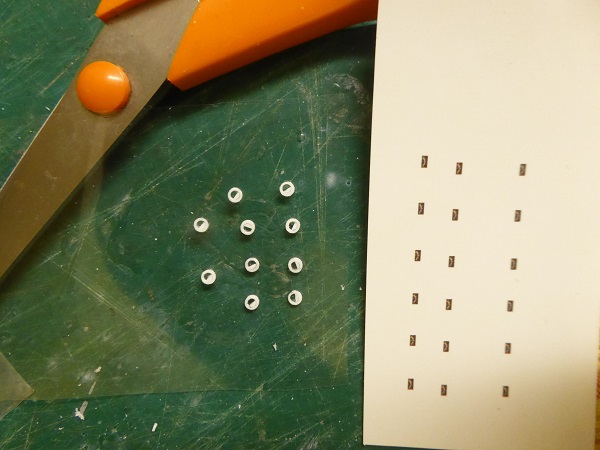

More progress made on the port main motor switchboard. First job this week was to finish off the voltmeter and ammeter dials.
The attached photo shows clear plastic sheet glued to the back of the dial faces. The clear plastic sheet came from the packaging off a cake box.LOL I also printed out the instrument dials onto water slide decal paper.

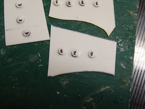

#255 Posted : 26 November 2020 23:04:32
I then fixed the decals onto 0.5mm thick plastic sheet and glued the dial faces on top of them. At some point over the weekend i will separate them all and file the edges smooth and round before painting.

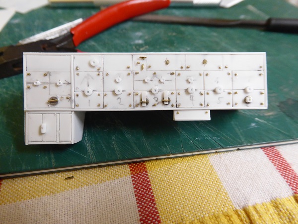

The attached photo shows the switchboard completed. I still have a bracket and a hand rail to make, but the rest is done!BigGrin
The voltmeter and ammeter dials will be added, along with the hand wheels, once it has been painted and several dozen brass plates added!

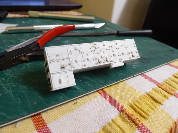

#258 Posted : 26 November 2020 23:10:41
From another angle.
