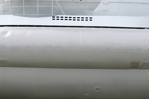

On this part of the build I will be focusing on the midships free flood holes.
See attached photo of these on U995.
As can be seen, these vents /holes are arranged with equal spacing on the U995. This was not the case on all Type VIIC U-boats. The model i'm building, U230, had it's vents arranged in pairs with a singular vent hole at the aft end of the pattern.

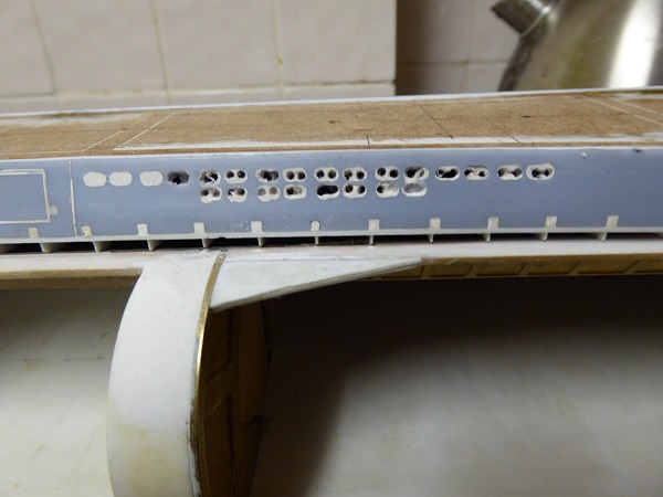

My initial plan was to blank off the last 3 vents on the supplied plastic part and drill through the rest to open them out, similar to what I've done before, to give that feeling of depth.
My drilling didn't go to well if i'm honest. The drill veered off many times resulting in a very uneven and 'scruffy' look. Some vents looked larger than others, while some appeared shorter or longer and in one case I had two that were nearly joined to make a very large vent. Not what I was after at all!
So it remained in this 'state' for many months while I continued with the rest of the superstructure, but it was always an eye sore whenever I stood back to admire the other work I had completed.

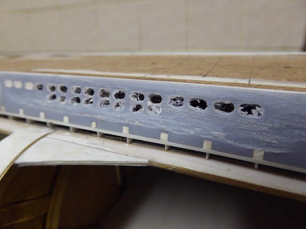

As the build progressed I found myself back at these vents with decisions to make! My idea was to fill all the vents with clay. Which is what I did and let it harden overnight. With this in mind I then proceeded to re-drill out all of the vents. This didn't go to well either as the clay wasn't as robust as the plastic and so the drill kept veering off into the clay when I came to widen a couple of the vents. Then the clay broke off in clumps. Confused

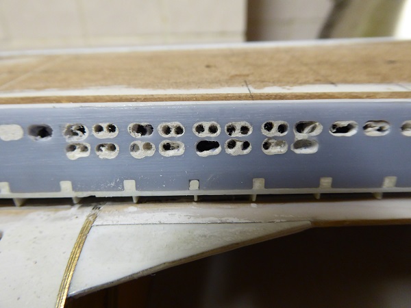

#251 Posted : 22 February 2017 19:49:20
This photo shows the vents drilled out, or tried to, after I had applied the clay.
#252 Posted : 22 February 2017 19:50:29
Another shot of this disaster.
As a side note, we're looking at the starboard side, bow to the right of the photo.

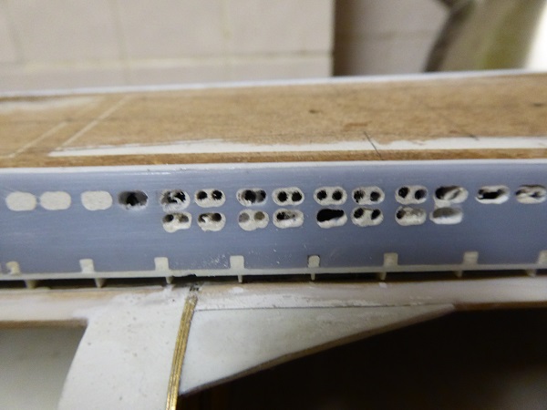

#253 Posted : 22 February 2017 19:52:15
Another attached photo showing the mess I was left with leaving me mentally scrabbling around to figure out how I could resolve this.
#254 Posted : 22 February 2017 19:54:28
One more photo of what I was left with following 'claygate'. LOL

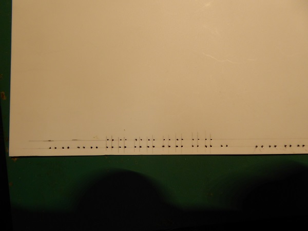

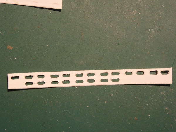

The plan I envisaged was to make templates from 0.25mm thick plastic sheet with the correct pattern, fix to the hull over the originals and file smooth the edges.
Sounds easy right? Yeah right!LOL It took me 5 attempts at marking out the sheet until I had a satisfactory result. This was down to a variety of factors slowing the process which resulted in an uneven pattern and misaligned markings. These factors included; pencil thickness, craft knife veering slightly off, incorrect marking out [I won't bore you with the maths], the drill moving off centre and generally just not looking the part.
Finally, after two evenings I ended up with two 0.25mm plastic templates with the correct pattern.
The attached photo shows the pattern marked out on the sheet and centre dotted with a sharp scribe prior to drilling out.

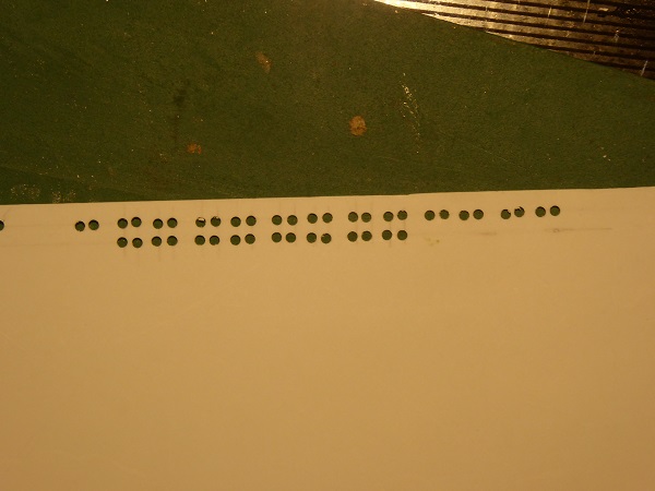

#256 Posted : 22 February 2017 20:05:45
The attached photo shows the pattern drilled out.

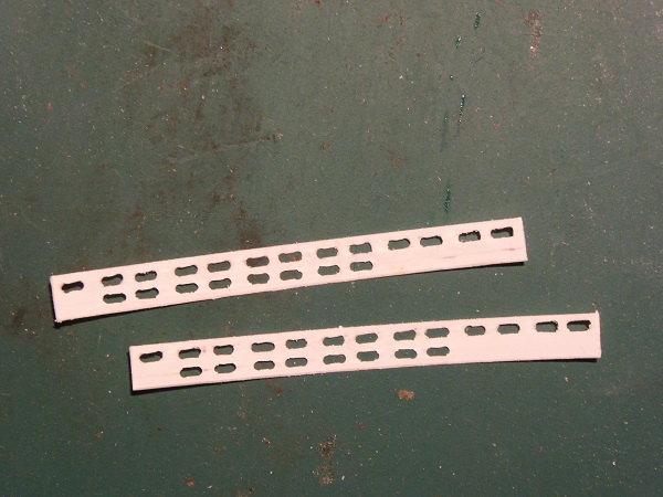

#257 Posted : 22 February 2017 20:07:49
This photo shows one of my earlier attempts; the spacing was wrong. For some reason I didn't photograph the final pattern that I used.
#258 Posted : 22 February 2017 20:09:04
Another photo showing my earlier attempts.

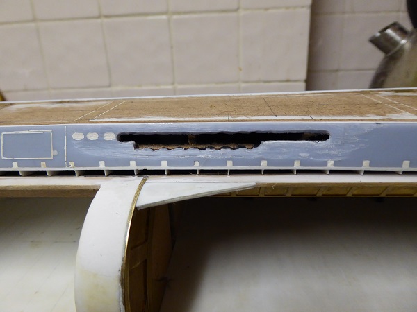

Suffice to say that after I had completed this time consuming and maddening 'little' job that my thoughts came back to attaching these templates. As I mentioned before, my initial plan was to just glue them to the top of the hull over the existing 'claygate' and viola! I then realised that this would not give the correct appearance as no matter how much I smoothed over the edges, the templates would still sit proud; by 0.25mm to be exact!
It then dawned on me that if I recessed the area where I was going to glue these templates by the aforementioned 0.25mm then they would sit flush! Hahaha I hear you cry!
So that is what I did. With a dremel. Which was a bit hardcore and took off a little more than I initially anticipated leaving me with the feeling that I had bitten off more than I could chew.
See attached photo of this continuing drama. LOL
#260 Posted : 22 February 2017 20:26:25
I'm thankful I have plenty of patience and sometimes modelling definitely tests this 'virtue' as i'm sure anyone would agree reading this.
With a sigh and a deep breath I took to it with a needle file and painstakingly clawed back my errors and produced something reasonably satisfactory.
Now for the next part of the 'drama' LOL, I noticed that to fit my templates correctly I would have to open out my 'claygate' a little wider so that it 'hid' behind my new version. In doing so I realised that for this to work properly I would be better off grinding out all of the original vents to make one massive hole.
See attached photo.
