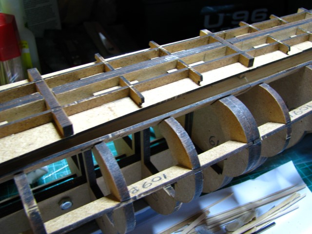

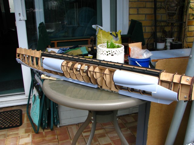

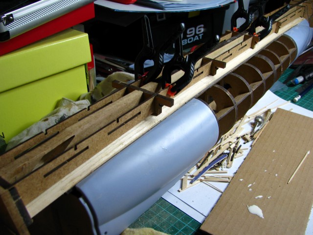

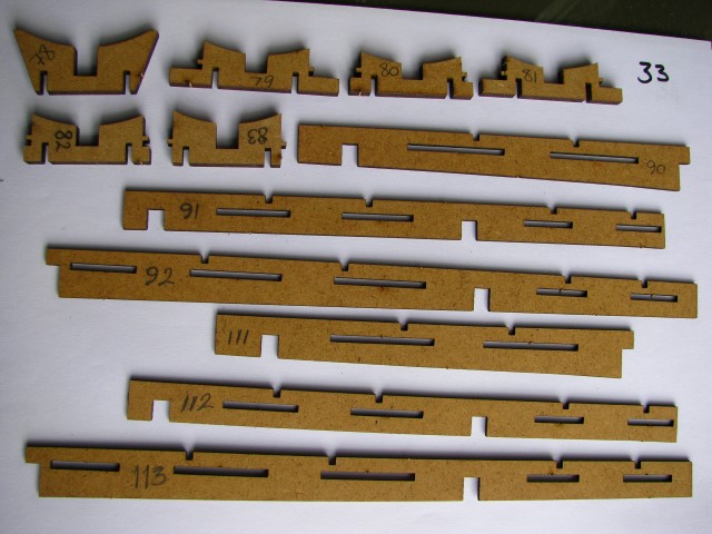

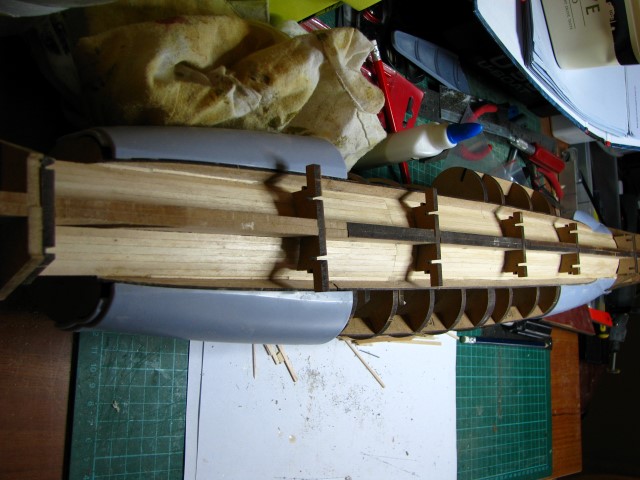

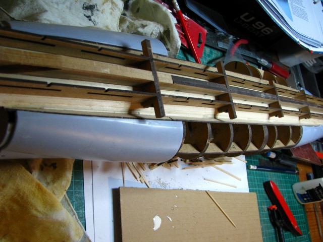

BUILD UPDATE #33
Hello friends,
This time we're making a start on the framework for the deck.
To begin, we'll use the parts I've already received which are:
Issue #14, parts #78 & #79
Issue #15, parts #80 & #81
Issue #16, parts #82 & #83
These being the transverse ribs which fit along the hull in the appropriate slots and sit on the previously planked section of the upper hull. They are not glued in place.
A little filing out of the slots was needed to get them to sit correctly so that they lift in and out with ease.
The parts supplied in issue #33 are the longitudinal vertical frames which run under the deck area to the left and right-hand sides of the main keel.
After removing them from the sheet and giving them a light sanding to remove any rough edges, they were glued into the slots on parts #78 throu #83 using a cocktail stick to apply the glue in the slots, and left to dry in situ.
Well, that's all for now. Thanks for all the comments and help - much appreciated, and thanks for looking in.
Happy building
David

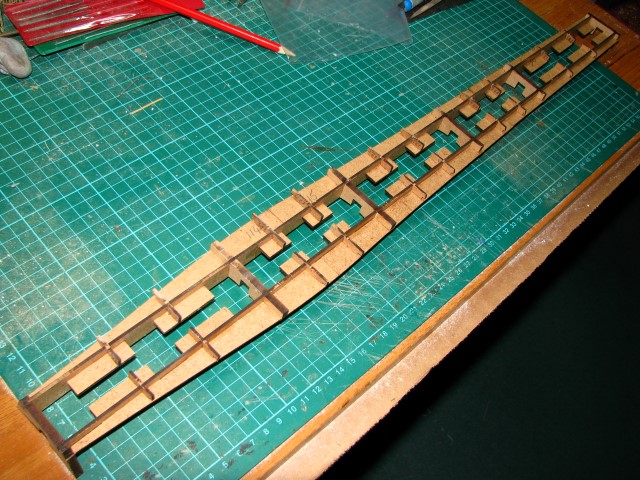

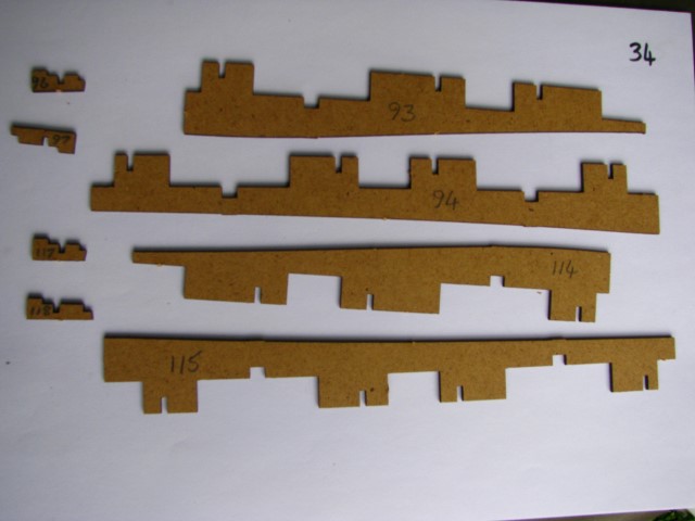

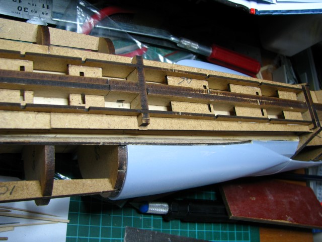

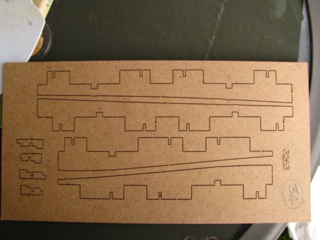

BUILD UPDATE #34
Hello again,
This week it's the turn of the longitudinal horizontal framework which forms part of the removable section of the deck.
Issue #34 contained a sheet with 4 of these frames and 4 small reinforcing parts.
After removing from the sheet and cleaning up any rough edges, they were placed end to end and checked for correct alignment, then test fitted in to the slots on the previously assembled vertical framework.
With everything lining up OK, and using a cocktail stick to apply the adhesive to the parts, they were fitted into place and left to dry.
Next, the small reinforcing parts were test fitted in their appropriate slots, and with all fitting with no additional sanding, they were glued into place, again using a cocktail stick to get into the small slots.
So that's 2/3 of the deck framework completed, last last 1/3 to be fitted in the next update.
Thanks for looking in and for all the positive comments.
Happy building
David

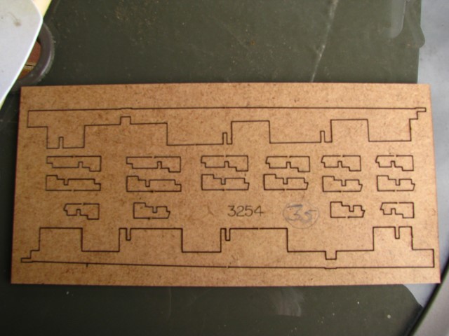

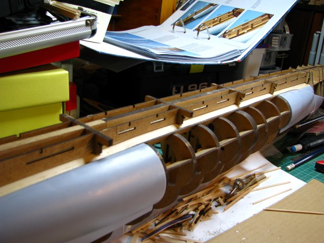

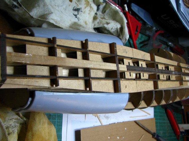

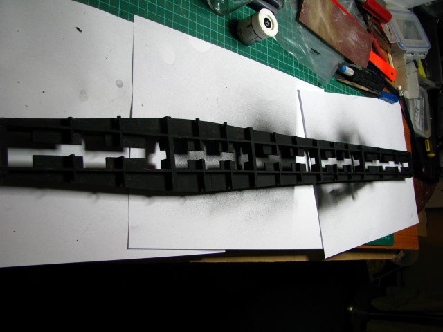

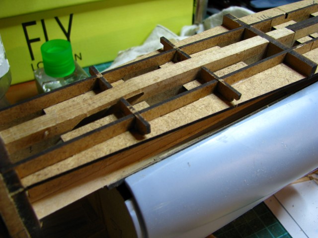

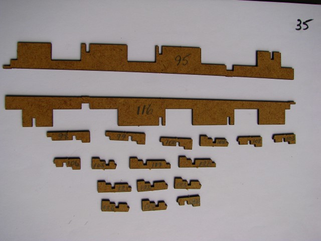

BUILD UPDATE #35
Hi guys,
This time, the removable deck framework is finished off and painted.
Issue #35 came with 1 sheet containing the last 2 horizontal longitudinal beams and 16 small reinforcing parts to finish the last 1/3 of the framework.
As with the last update, after the parts were removed from the sheet and cleaned up, the large horizontal beams were dry fitted and with no adjustment necessary, they were glued into position using a cocktail stick to apply the adhesive to the slots. Some glue was also added to each end to marry up securely with the previous beam and the end of the framework.
After leaving in situ to dry, the 16 small reinforcing parts were added after carefully noting their relevant positions as each part was a slightly different shape to allow for the contours of the plastic hull cladding which will be fitted at a later stage. Again, I used a cocktail stick to apply the adhesive to the parts.
After the work was completely dry, the section was removed from the main part of the build and given a coat of Humbrol #33 acrylic matt black. Unfortunately, my airbrush decided to stop working on me half way through, so I had to finish the work off with a good old fashioned paint brush.
Like Graeme (aka Pemberg), I am considering running in some FOC's to light up the interior of the cutaway sections, but this job will have to done before I get into cladding the build with the wooden strips which we'll receive over the next 7 or 8 weeks.
That's it for this one. Thanks for the positive comments and for looking in. See you next time.
Happy building
David
