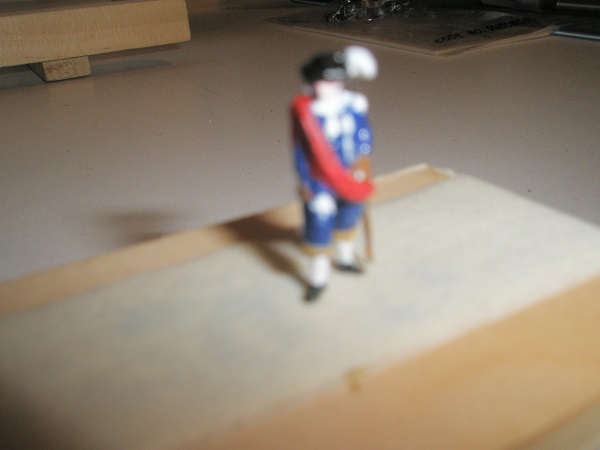

* Made the figurehead platform and started to paint "The Skipper"...BigGrin Got the basic colours done ok but having trouble with the fine detail, especially the white outlining of the jacket...Blink I am using a size 1 and 0 brush with pointed shape but it tends to spread the bristles...Blink
Can anyone suggest an alternative method of application?

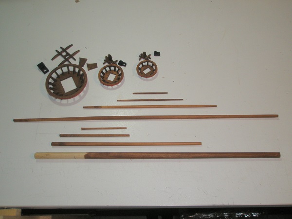

* Started work on the main mast and yards... Made up a "Clayton's" lathe but the longer dowels tended to oscillate at the loose end so I had to be real careful...BigGrin Blink The yards of course I could only do one end in this way, The other end was done by hand and took forever...Blink Blink All the parts still need a bit of fine tuning and staining and will not have assembly completed until I see how the masts/yards go together...Cool Cool

BigGrin Hi John very nicely done Cool A little tip for tapering the yards is to wrap some masking tape around one end so the drill chuck doesn't mark the wood and then sand down the other end when happy with the taper take the tape off the other end and wrap the tape around the end you have just done and repeat Cool hope this helps rgd Martyn

Looking great John, really nice work being shown....Drool Drool .. As for paint brushes, they come in even smaller sizes than size 0 so you may consider adding these to your tool list.... Hope this link helps.

Looking good with all that bling, I had trouble with those brackets too, in fact still not happy with one of them Cursing.As for painting the figures I like to use sable brushes,they tend to hold their point longer as long as you look after them (clean them properly, don't dip them in the paint pot, thin the paint ect).

Thank you for the compliment and hey - that's a great tip and I'll try that on the next set of masts and yards...Cool Cool

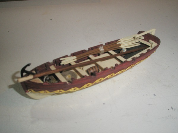

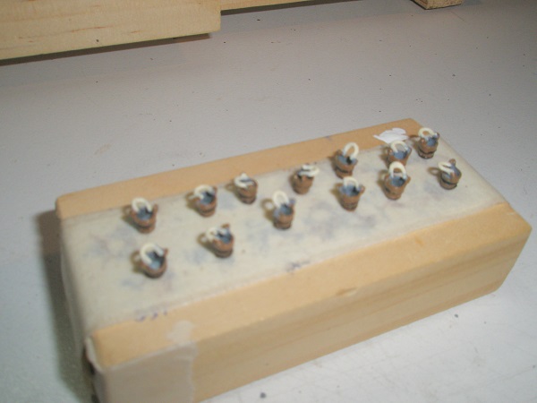

* Finally got round to putting some buckets together and painting them, but have yet to put black powder in them - awkward little critters...Laugh

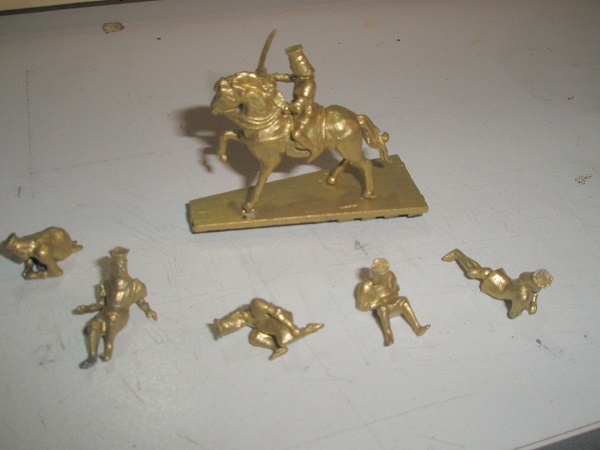

* Assembled and painted mounted figurehead and the five (recumbent?) knights...BigGrin

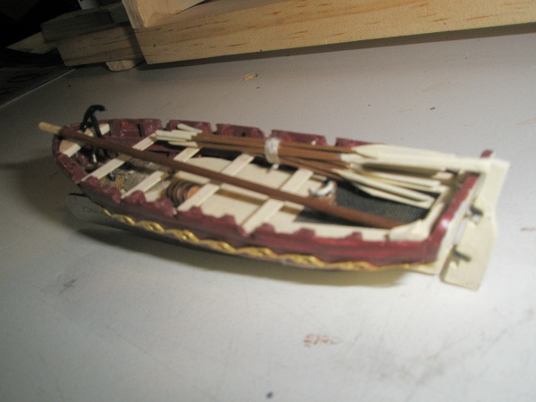

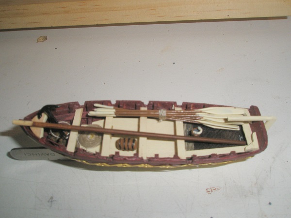

* Finished detailing ship's boat...Cool

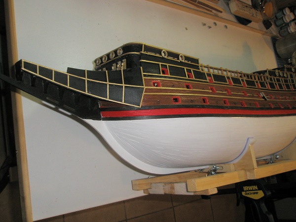

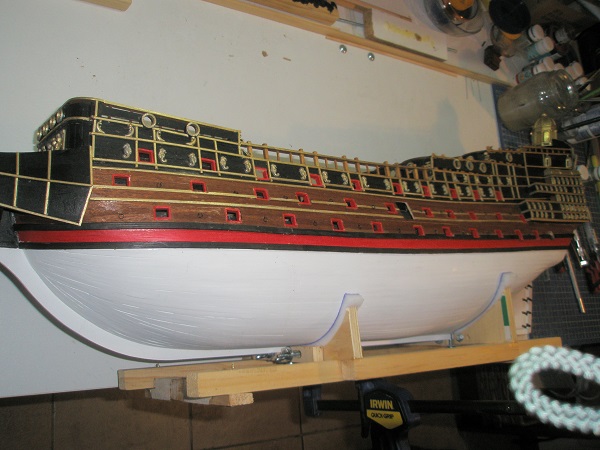

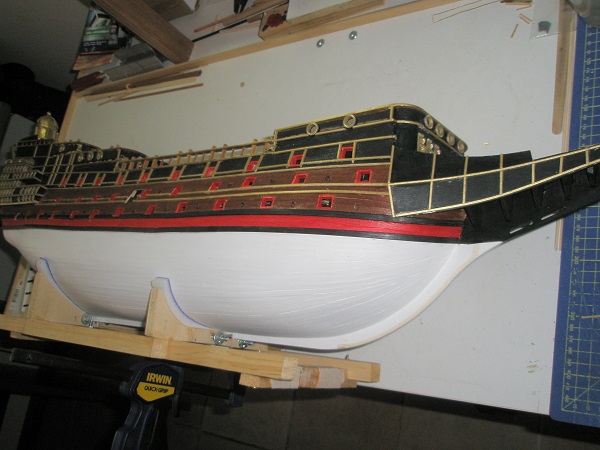

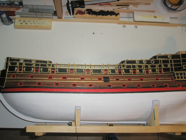

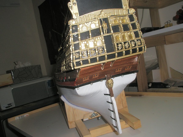

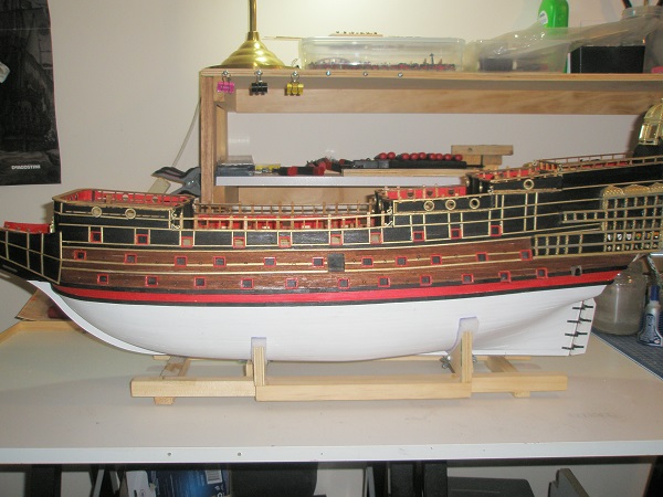

#257 Posted : 31 May 2016 03:00:56
Joined: 25/04/2014
Posts: 374
Points: 1,134
Hi Everyone

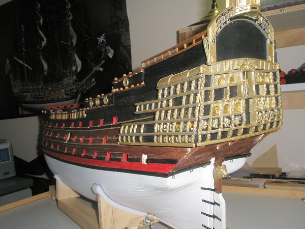

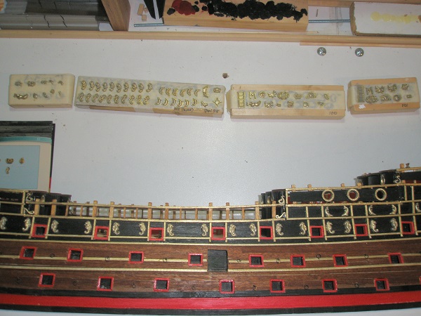

Progress occurring April-May herewith...
Working through issues 85 to 96 excluding canons

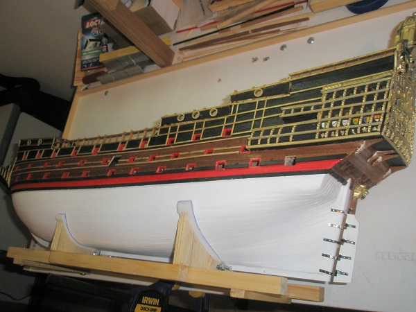

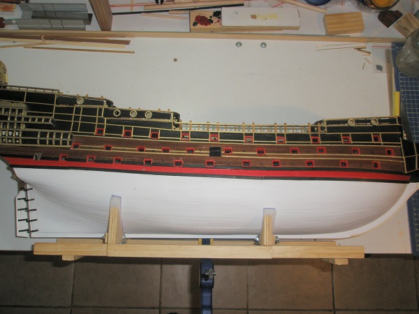

* Fitted cornice frames Port side.
* Added Stern decorations.
* Fitted Quarterdeck grill and handrail.
* Installed Deck fixtures and fittings - Bittes, belay pins, buckets, eyebolts etc.

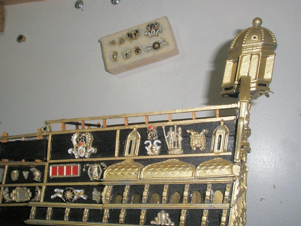

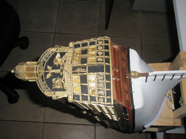

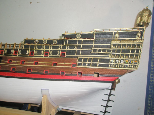

* Fitted side lanterns at Stern gallery. A spot of bother here as there was insufficient space between the cornice strips - so had to cut a little recess in the top one to allow the lantern to sit flat.
* Fitted Hull side and Stern decorations from all issues up to issue 109. ( So they all got to be prepared and painted at the same time ).
The same problem occurred when it came to fitting the larger decorations alongside the lanterns. I used the same solution by cutting a little rebate in the top cornice, however I would have needed to cut out the top cornice completely to accommodate piece number PD36 from issue 102. So I decided to dispense with that part altogether and it doesn't look too bad. Anyway, there's enough bling on this thing to sink a battleship already!!!!!
About this time my trusty old camera gave up the ghost and became completely U/S. So I do not have pictures of later operations for this period in the project.
* Fitted Chain wales, chains and dead eyes both sides of the hull. There are only 60 deadeyes in the kit and I managed to squash a few initially when fitting the wire around them before I got the hang of it. I've had to source some extra deadeyes to make up the shortfall.
That's it for now, I may get another post done in June, then I'm off to UK in July for a couple of months so I don't expect there to be any more progress until at least October.
Happy building to All
JohnP
