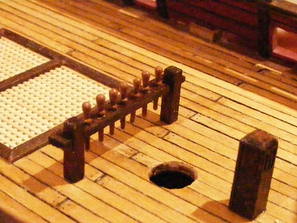

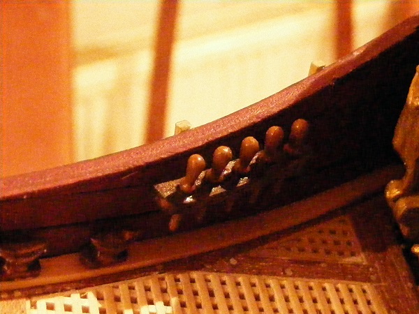

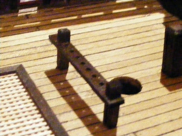

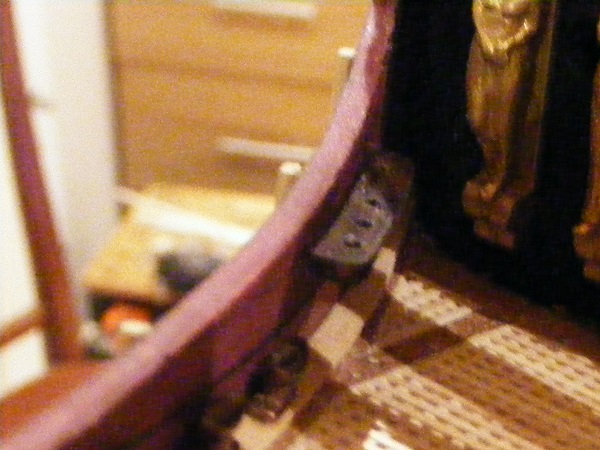

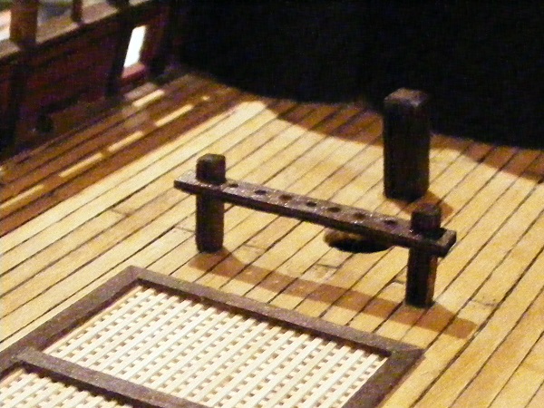

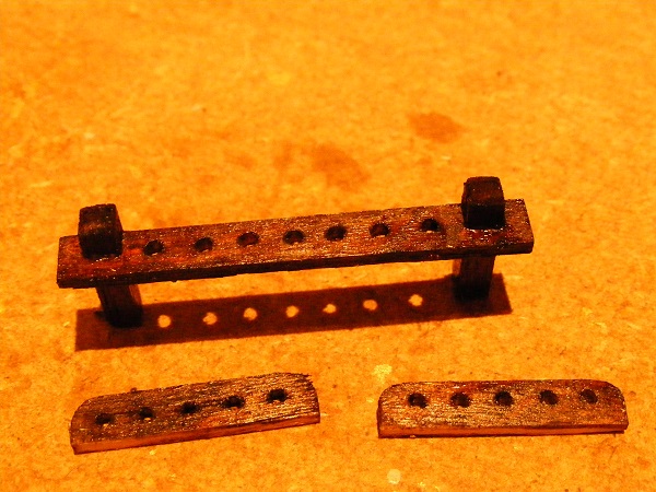

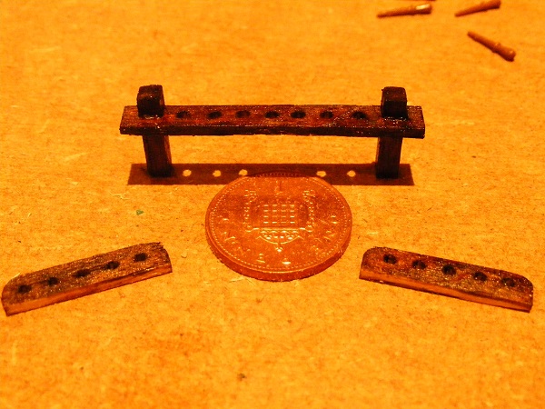

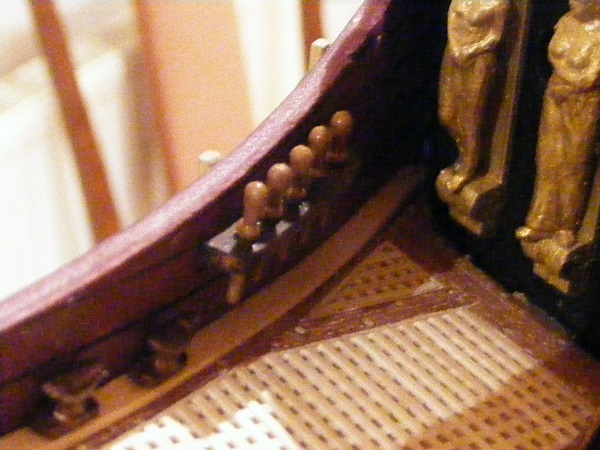

Hi all, tonight I finished issue 88.. This had me making up 3 belay racks, one for the main deck and the other two for the bow... Marking up the racks was straight forward enough and it was after this I ended up with the first small problem, instructions say to use a 1mm drill enlarging where necessary to take the belay pins. I ended up having to go to a 1.7mm drill before the belay pins would sit all the way home.... Cool Cool .. Another problem I found with the first rack was although I tried to be gentle and drill by hand the rack ended up splitting lengthways ....Cursing Cursing .. solution was to hold the piece lengthways in a vice and use the dremel to drill the holes, the vice grip prevented the strip from splitting... only one strip was a failure so can't really complain.....Cool Cool .. Made up the main deck rack, cutting the two end notched by gently using a 2mm square diamond file, then stained them all with 2 coats of walnut followed by a satin clear varnish... Moved onto fitting them and for the two at the bow I bevelled the inner edge to take the curve of the bullwark more securely..... all glued in place using superglue gel.... Cool Cool .. Belay pins were primed and painted a light wood colour before finally being glued in place.... Cool Cool .. Now trying to decide whether to make a start on making up cannons and blocks or to continue with the Titanic.... decisions, decisions eh!!!.... Happy building all.....

Looking good Alan, I know those pin rails can be trickyBigGrin
I notice you say you have now glued your belay pins in place, I of course did the same with my Vic but wish I hadnt, I wont be doing it on my Trinny build. From now on I will leave the pins out until I do the rigging and then use them one at a time for each rigging line.
I will then use an idea from Robin where you use the pin to lock the line in place then use a pre-made loop to glue over the pin. Finally fitting all unused pins at the end.

Thanks Stevie, appreciate your comments.. I must admit I had seen Robin's post and thought it was an excellent idea... Gave it a lot of thought and ended up with one big concern.... The strip was only 5mm wide and I had already gone up to almost 2mm drilled holes. To have the rigging line going down the belay hole would have meant these holes would have to be even bigger leaving me with the thought the rack may end up being rather weak so decided to glue them into position..... I may regret the decision later but we will soon find out....Cool Cool .. May end up having fun with the rigging anyways having never rigged a ship before.....Blushing Blushing
