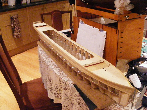

#229 Posted : 18 March 2014 23:02:04

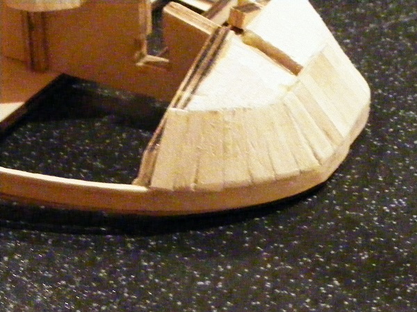

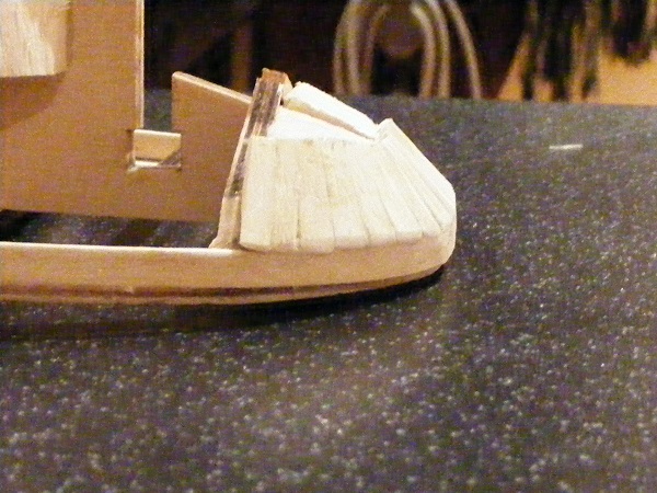

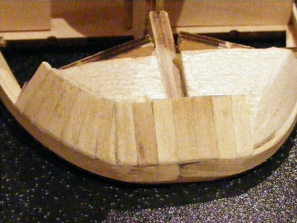

Hi all, so made a start now at sorting out the profile of the stern... New balsa blocks were applied and roughly shaped as a starting point.... Hopefully now everything I was saying on earlier posts relating to the stern profile will be a lot clearer.... The first photo shows how the instructions produce a rounded stern both from port to starboard and deck to keel....Cool Cool .. Next photo's shows how the first two facets should look. To get this look meant applying individual shaped planks running up and down rather than the standard way of bow to stern... Everything is still just rough at the moment, sanding, filling and the application of the second plank layer will I think give me the correct profile I'm after.... Tomorrow hopefully will continue the short planking round the other side..... Long way to go yet before I'll be happy with it.....

#232 Posted : 19 March 2014 02:09:24
Hi Alan.
Definetly looks more the shape that it should be. Hope it works out OK. Will be watching your progress with great interest Ian.
#233 Posted : 19 March 2014 08:29:33

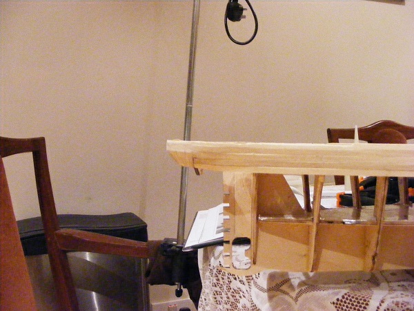

Hi Alan, Profile does look improved at this point. Your solution now is built higher than the ribs I notice, I hope that isn't going to cause you a problem further down the line when plating the hull. watching with much interest.
#234 Posted : 19 March 2014 23:02:09
ian smith wrote:
Hi Alan.
Thanks Ian, appreciate your comments..... I'm sure it will work out in the end, will just persevere until it does.... Cool Cool .. Back on the SOTS right now but hopefully back on this build this weekend.... Cool Cool
Thanks again
#235 Posted : 19 March 2014 23:08:23
Thanks Jase, am pleased you think it's an improved profile and yes,it is built higher than the ribs just now, has to be to achieve what I'm looking for.... Cool Cool .. I am also aware it is likely to create some problems further down the line when plating and will just have to find solutions for that too... Basically I had two choices, build as instructed and end up wishing I had done something about it every time I looked at the model or, grasp the nettle with both hands and have a go at trying to put it right.....Cool Cool .. Will just keep at it and I'm sure I'll get there in the end.....Cool Cool It's a journey after all....
Thanks again

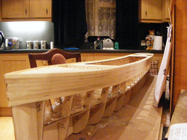

#236 Posted : 30 March 2014 22:26:12

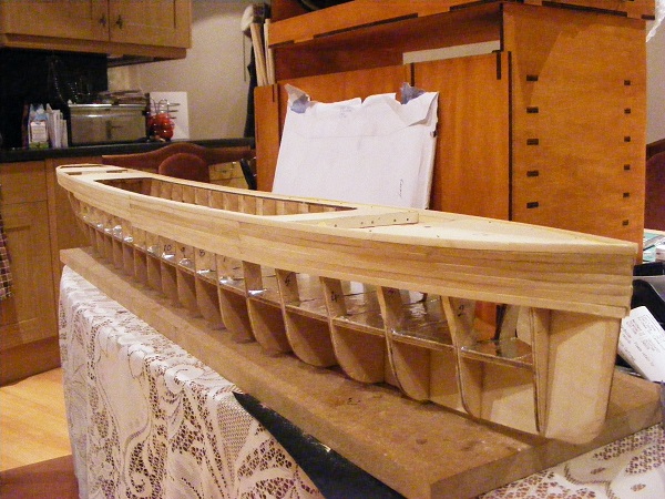

Small update, planking has now started in earnest, have also added the top plank but first applied masking tape to the deck edge to ensure I didn't accidentally glue the planks and deck edges together...Blink Blink ... More soon.....
#237 Posted : 30 March 2014 22:32:26
