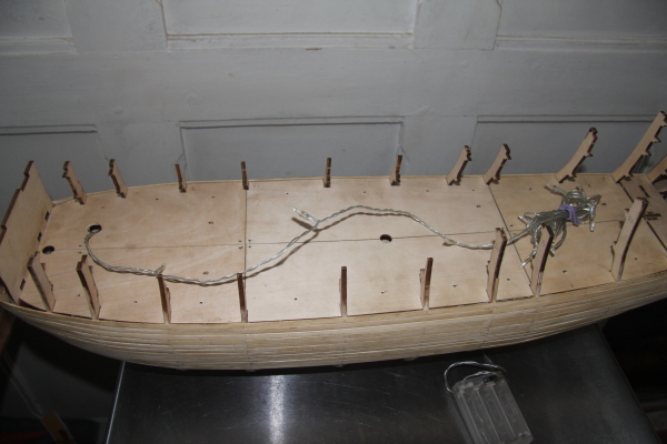

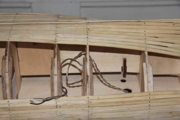

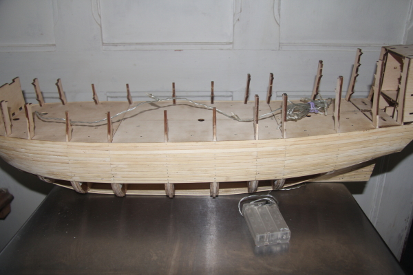

Lights!!!
I have found the Xmas lights that I had hidden away.
They come as a string of 20 LEDs, with a battery box for 3 AAs.
Pulled them through the hull with the cord I had fitted earlier.
Seven LEDs left in the lower gun-deck, leaving seven for the next deck and six for the stern cabins and lantern.
I cut away the battery box, so I can feed the cable through a hole that I will drill next to the keel mounting position. The cable will then go inside the brass tube that I intend to mount the ship on.
Well, it might work.Laugh

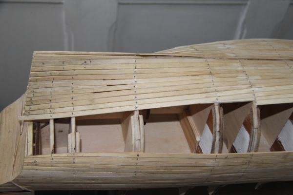

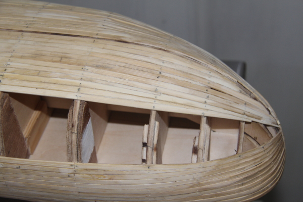

Distractions have slowed me down!
Just a bit more hull planking done this month.
I am doing this freestyle, as I can't see how I will get another 12 planks to terminate at the bow. Starting to use drop planks at the front.
I also had difficulty with the stern, so decided I will let the planks go where they want (to some extent) so there is not too much forcing.
Hopefully I will find more time soon.
Captain David attached the following image(s):
#231 Posted : 31 October 2013 13:45:44
Your absolutly correct to not force the planks, let them fall naturally and that will give you a view of what droppers and wedges you need.
looking ok so far just take your time
J
Foz

Hi David, the planking is looking very good and Im sure the lighting will look great.
You need to check if the battery lighting you are about to use is wired in serial or parallel - if its serial wired and you have a bulb blow then this will shut down all the other bulbs too and your not going to be able to replace it either.
