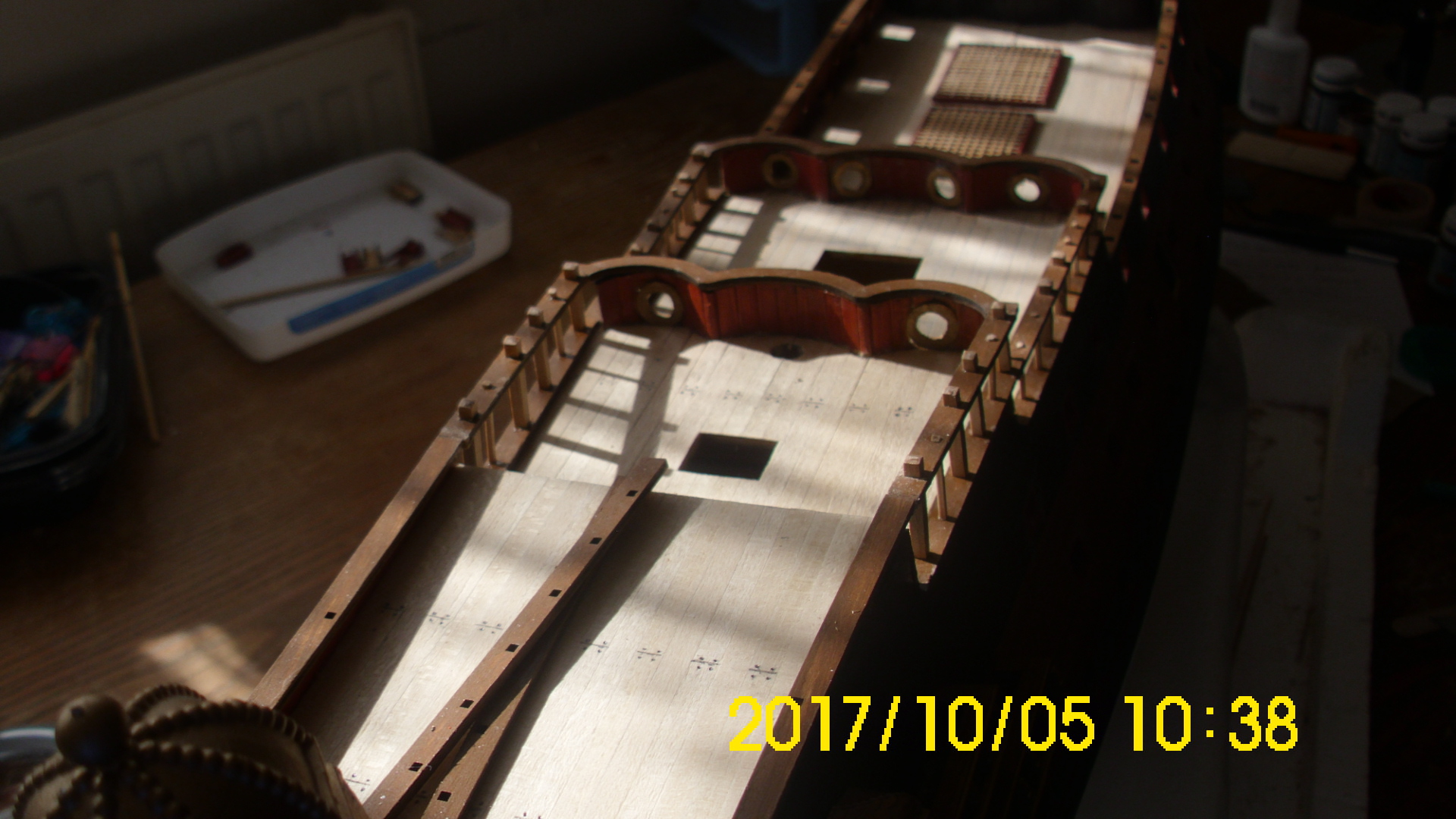

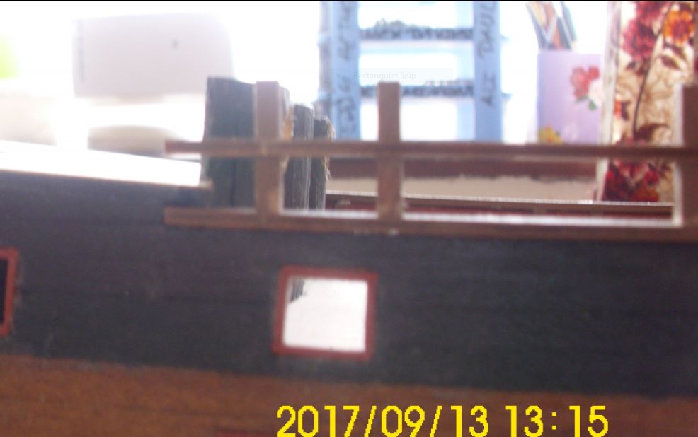

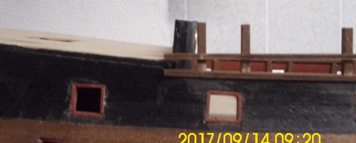

I seem to have ran into a problem in issue 64 regarding the handrails. I have follewed the instruction correctly cut everything to the correct length and when I fitted the top rail on the starboard side, the distance from forecastle deck ond the lower rail is only around 4mm. At the other end at the aft bulhead the rail gradient is not so steep as in the instructions?? Distance between the front bottom part of the upper handrail 97 and the base 98 is about 3mm whereas in the picture in the mag it looks more like 10mm?? Has something gone awry with my measurements somewhere...
Blink Confused
jonny7england attached the following image(s):

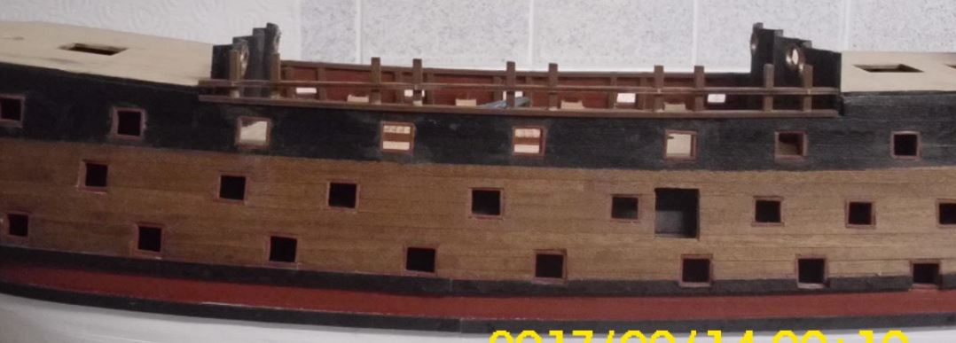

#224 Posted : 13 September 2017 22:39:44
Hi Jonny, I'm having a look at this to see if I can spot what may be wrong and will come back to you... Any chance of a couple more photos, side on but a little further back....Cool Cool

Hi there Alan..Thanks for your reply...Hope you are keeping well mate? I have been puzzled over this problem and so I took some more pictures as you requested and here they are:
Confused

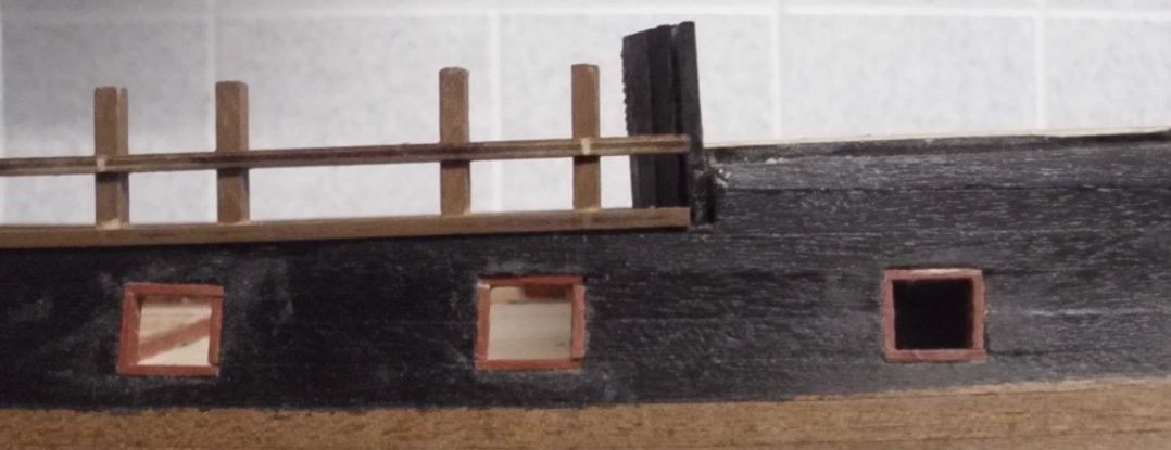

On the SOTS Can anybody furnish me with the measurements between the top of the gun port lining and the bottom of the well deck hand rail base (as shown in above pictures) please...I need to find out where I have mislaid 5 mm... lol. Thanks...

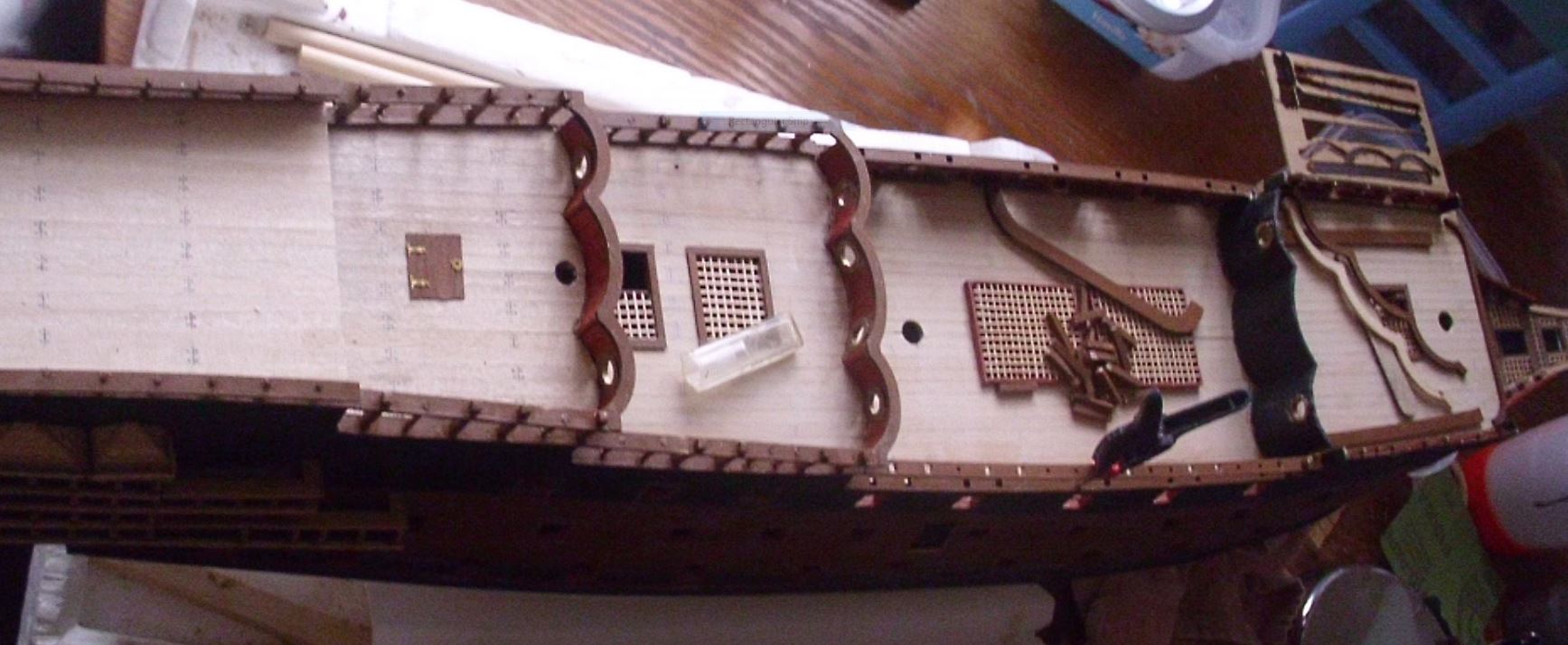

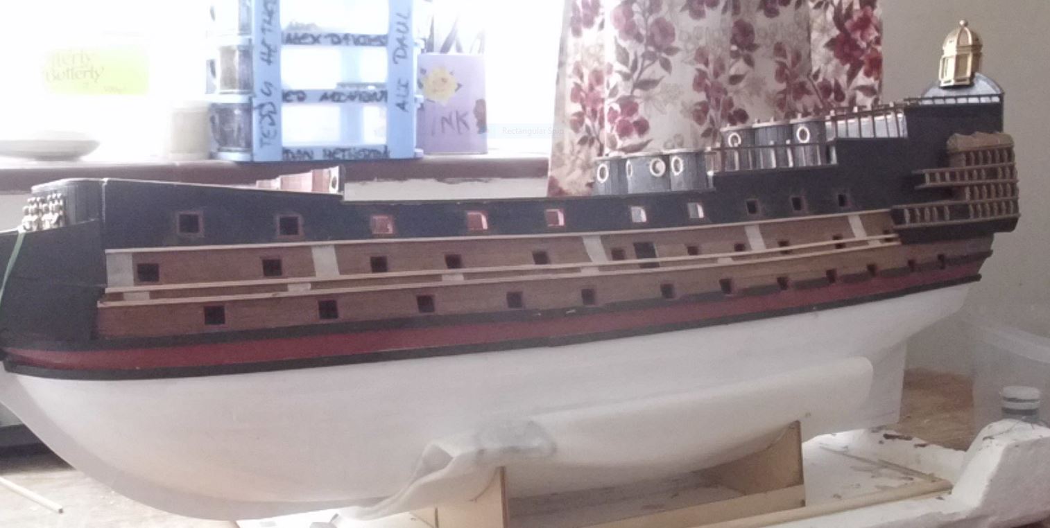

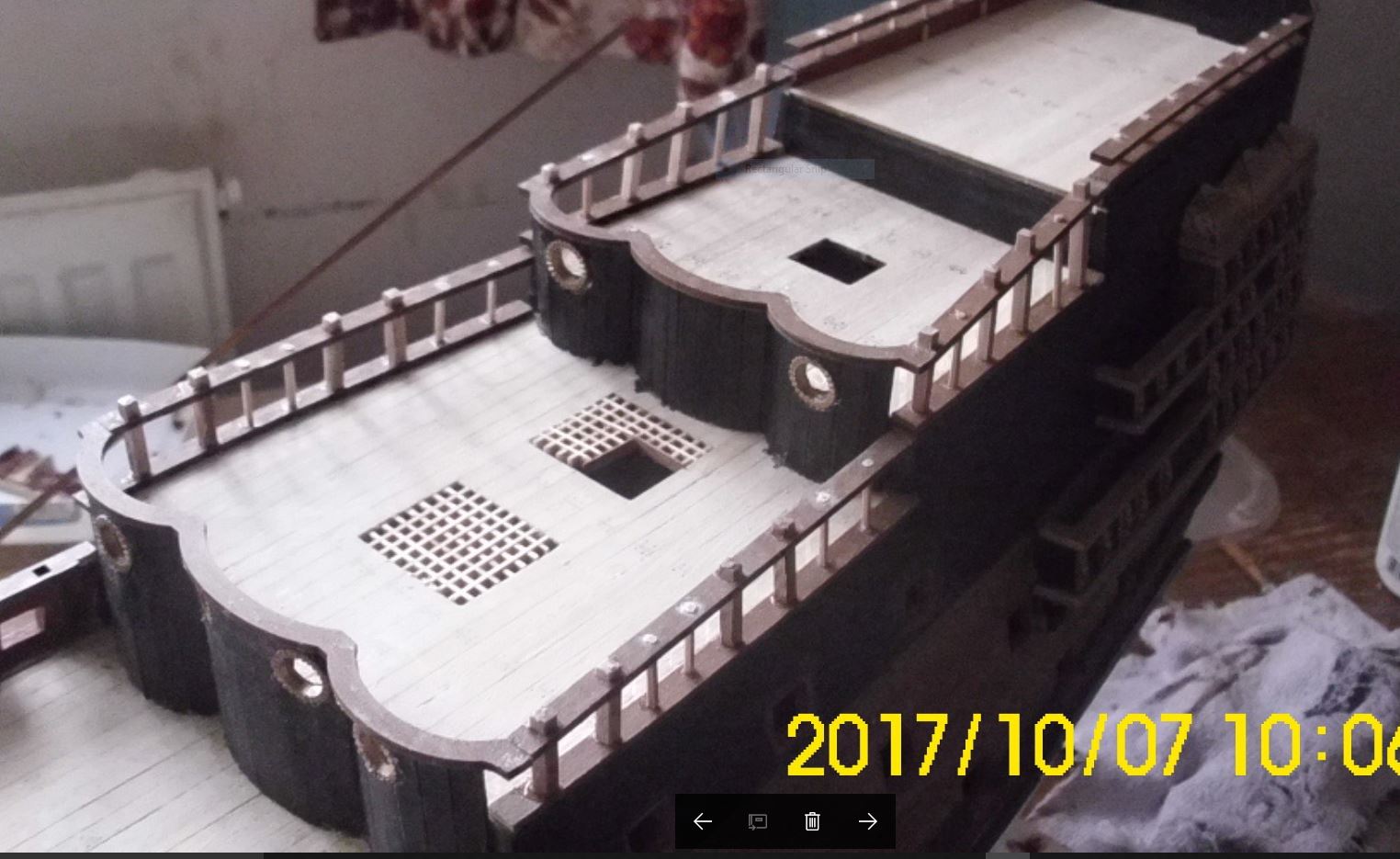

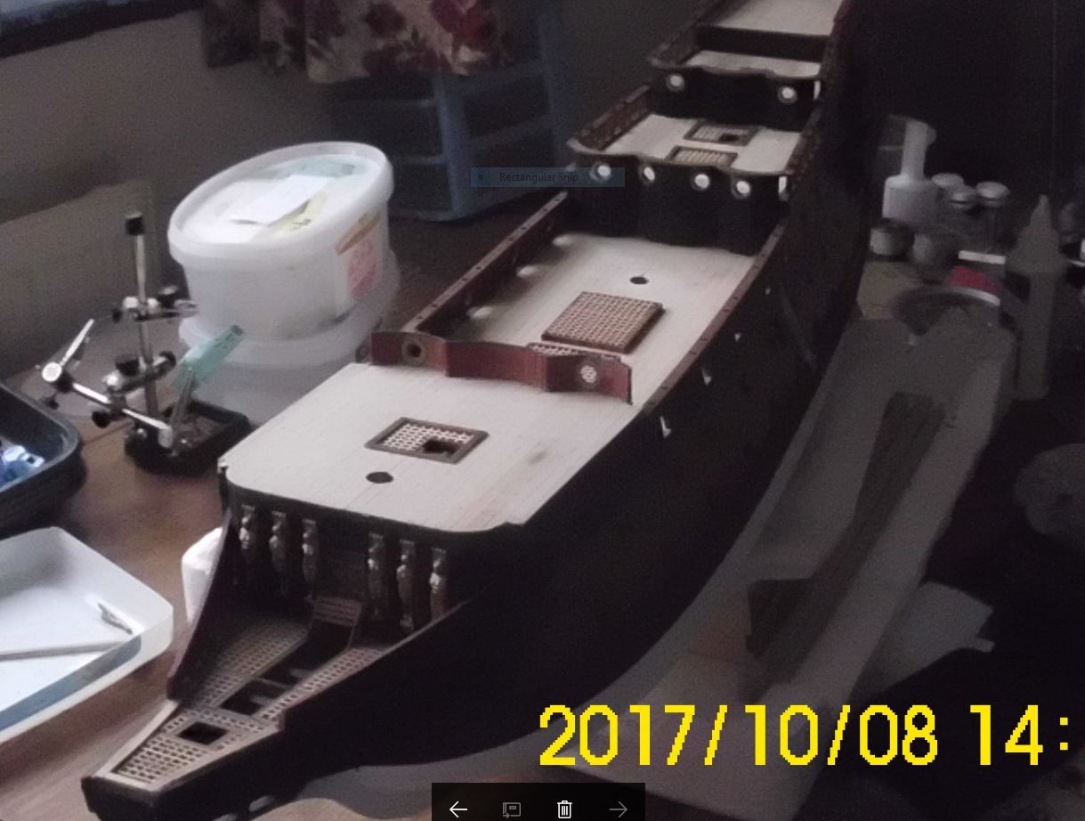

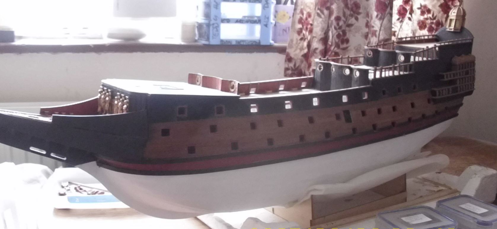

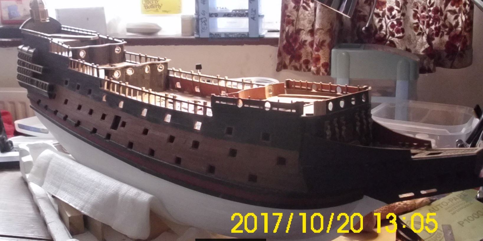

Some weeks back I hit a snag which I am yet to resolve, though, with some much appreciated advice recieved today, I can see two possible ways around the problem. And while contemplating my actions, I continued on with my build, working around the snag and so here are a couple of pictures to show my progress to date.
BigGrin

#228 Posted : 10 October 2017 22:25:46
And very nice progress you're making too John, great to see.....Cool Cool
#229 Posted : 11 October 2017 16:56:21
Very nice update. Those are some very small parts on the hatch but you have fixed them down very well and they look very good.

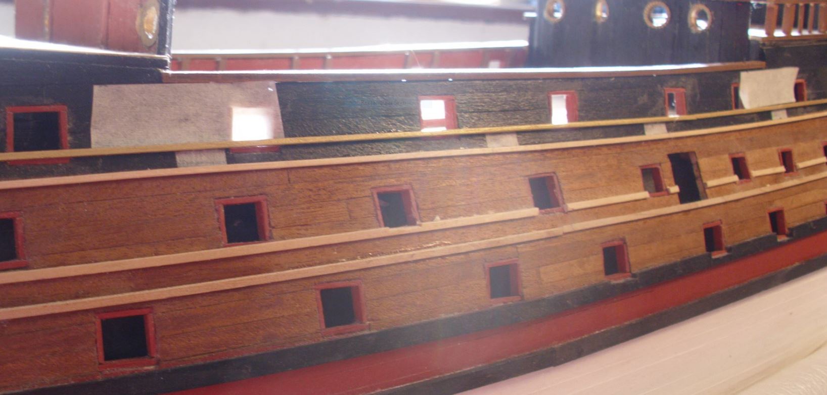

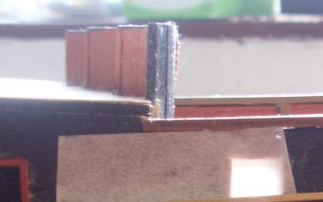

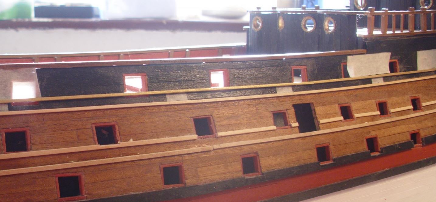

Thanks for your very welcome comments gents, much appreciated. I have been busy these past couple of days measuring out and adding the 1.5 mm and 1.2mm strips to the side. As I had mensioned before, I am a between 5 or 9mm adrift somewhere and thought that adding the strips to the side and working upwards, I would get an idea as to where I had gone wrong?? But....I put the strips on thinking that I could have my little problem sussed and found out that my measurements so far were more or less bang on!!

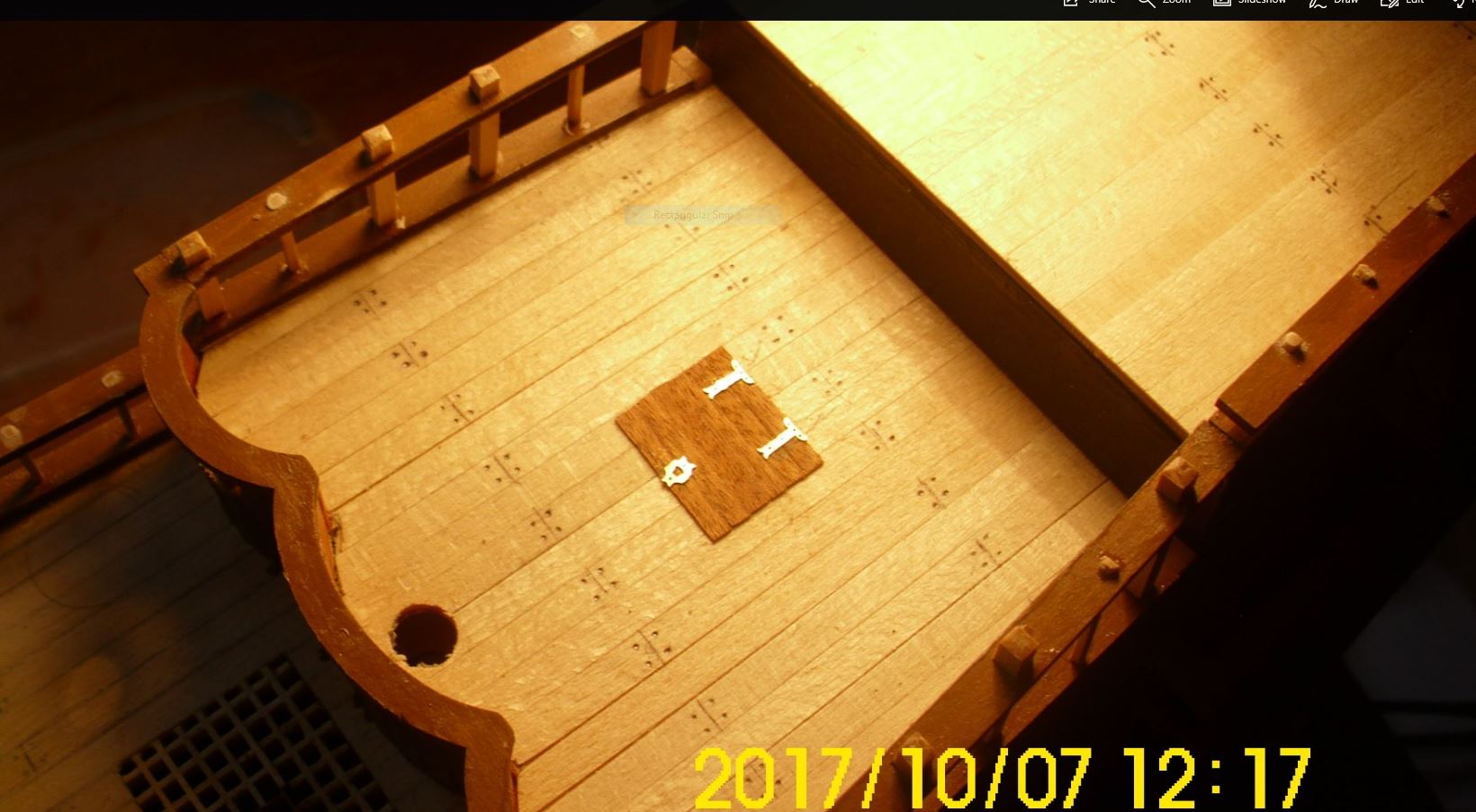

And having previously had a chat with one of our fellow forum members. It was a possibility that the problem I was having with the height of the well deck hand rails (forecastle end) was with the forecastle itself!! If this is so, then my next task will be to raise the foecastle deck a few millimetres in order to gain a bit of height so that I can get the well deck hanrails fitted as near as damn it!! What you see here is around 3 to 4mm clearance between the top of the handrail base and the deck of the forecastle which should be around 9mm?? So, that is where my next task lies???...Fun and games shipmates...Fun and games!! Happy building everyone..
#234 Posted : 14 October 2017 13:53:30
Glad you have managed to identify a fix.
Hope it sorts itself out well so you can press on.

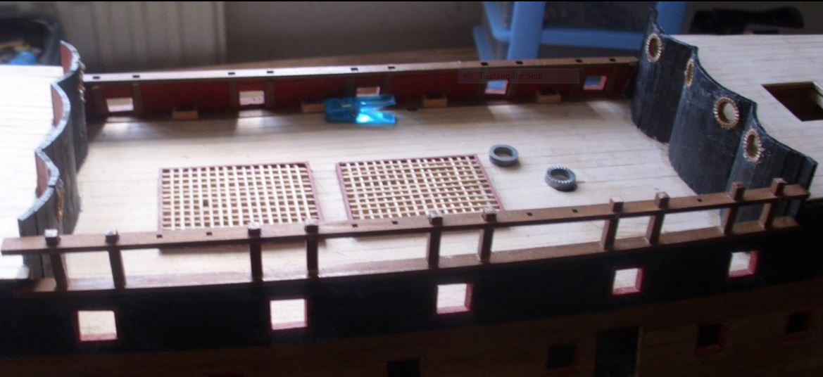

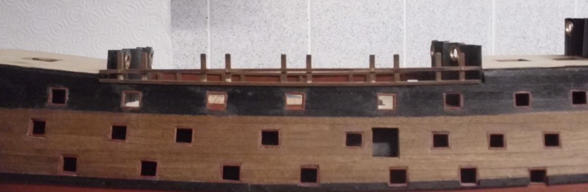

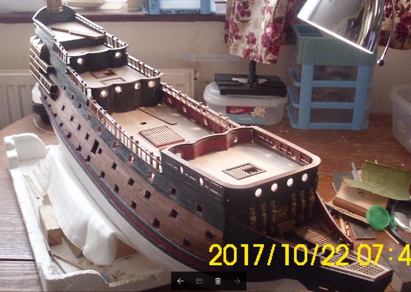

Good afternoon shipmates...For those who had been following my build will know that I have had a problem with my SOTS which had been bugging me for weeks!! I eventually found that the angle of the forecastle deck was far too steep and throwing all my measurements out the window. Problem identified, I have spent the past week making a few alterations so that I could progress with my build and here are a few pictures showing my progress. Now, I think that I can progress with my build further now all the agro is behind me. So, onwards and upwards shipmates, happy building and keep safe eh??

#239 Posted : 22 October 2017 17:59:38
Glad you have managed to sort out the issues.
Will be good to see you move this on a stage further now as its looking very nice.
#240 Posted : 22 October 2017 23:27:00
Very nicely done John, you've done a really good job with your fix and you can now move forward with your build... The only thing you'll need to check now is that the cannons you fit on that deck will fit nicely in relation to the gun port openings.....Cool Cool .... Look forward to seeing your next update.....
