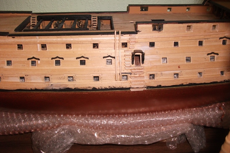

hi, this is part of the learning process,mistakes are made by us all. as the model is being painted I'd have no qualms in removing the offending step,after all you know they are wrong, I would go the steve-o way, but try the hot water method,using a small paint brush, brush on the hot water to the steps and use a stanley knife to get under the steps,it should come away without too much fuss,then if need be you can fill any grooves,then paint. it is really worth while having a go at correcting it. as I said earlier,you will have had valuable experience in repairs as well. you were very brave in showing your mistake, so well done for that. good luck and if you need any help just pm me. k.

Nice to see you back on this, I would never have spotted it if it was not mentioned. If you did want to correct it though you can use superglue release, I have used it a few times and its very good, a few drops into the joint and leave 5 mins then remove the part. The remains of the glue will then wipe off.

No probs, I keep it handy in case the kids ever get glued together, saves a trip to casualtyBigGrin I used it on the pinrail of the mizzen mast when I glued it to the wrong side!
In your situation I would put a drop or two into the join, its very thin so will penetrate, leave for 5mins then Id use some flat nose pliers with no grip inside and wiggle it a bit and it will come off easily. The stuff turns the glue to a sort of jelly that can be wiped off with a cloth with some de-bonder on it.

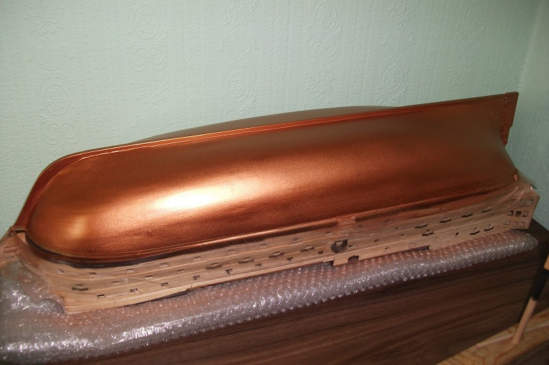

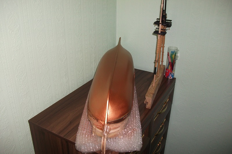

Just an update,finally got the steps on the right sideBlushing ,little bit of filling,just a bit of trimming etc. Finish off the hull.
I tried to paint the hull by hand and it looked awful so I air-sprayed it come out quite nice(pics)BigGrin. If I had the time I would have copper tiled it.Cool
Cheers for all your input.

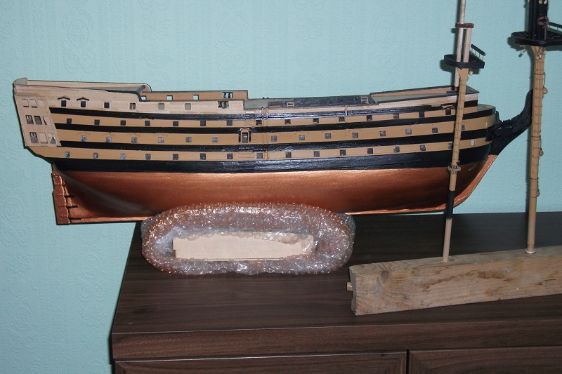

#237 Posted : 11 April 2014 10:37:16
Joined: 20/12/2011
Posts: 236
Points: 686
Location: shetland

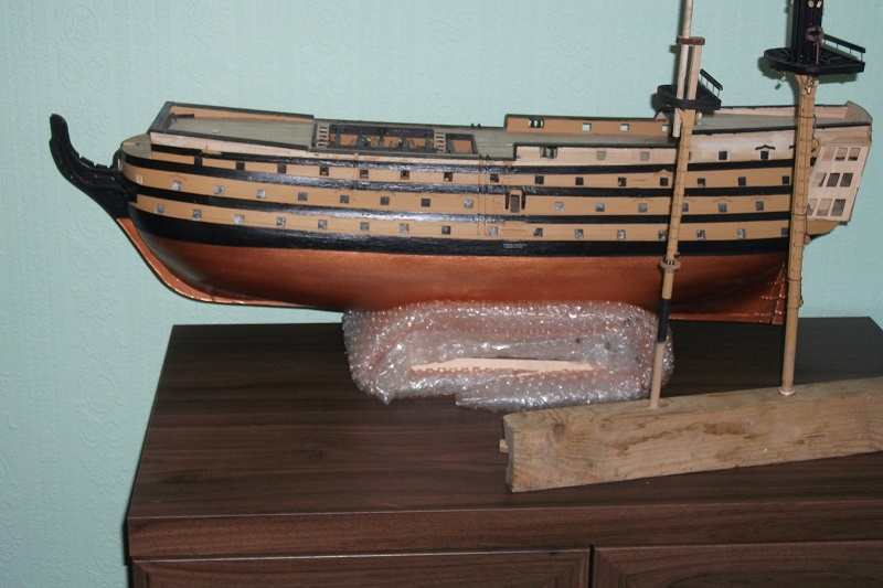

HI folks Just an update,
Not sure if this looks right,the black banding looks a bit narrow. It was not easy I have to admit, That bleeding through the tape was a bit awkward as wellMad.
Any advice as usual would be great.
thanks
sandnesspeats attached the following image(s):
#238 Posted : 11 April 2014 14:13:53
Hi,
I think I agree the black bands are a touch narrow. Also on one side the upper band does not seem in line with the one below. But its only minor issues you can correct.
As for the painting and masking process This is always more tricky when brush painting. A couple of tips from me are
1. Don’t overload you brush. If you are trying to spread lots of paint about your more likely to get seepage under the masking tape.
2. Use an appropriate brush a good wide flat brush for this job.
3. Use good quality masking tape. Cheaper tape is much more likely to let paint leach in.
4. Once you have applied the masking tape apply pressure along the masked edge to ensure there are no air bubbles that will allow the paint in. I use a soft pencil eraser for this.
5. Paint away from the masked edge. I start on the tape and paint towards the middle. If you paint towards the tape edge you are driving paint to collect at the tape edge which will increase the chances of seepage.
GluedFingers
#239 Posted : 11 April 2014 14:39:29
Joined: 23/03/2014
Posts: 185
Points: 545
Location: Essex
I agree, Jase, but I think you forgot one point.
Don't dilute the paint too much.
I for one am keen to have that little bit extra dilute in there to give a nice and smooth brush coat but when you are painting along a masking edge you want the paint to be as thick as you can get away with.
Adrie.
#240 Posted : 11 April 2014 18:06:56
Hi
I think the upper 2 bands may be a touch narrow but it really isn't that noticeable.
The black are supposed to be narrower than the yellow. I did mine by first painting all yellow, then masking for the black, then paint another coat of yellow (where the black is going to be) then when fully dry paint the black. The yellow layer will seal the masking tape so that no black can leak and will give a perfect line.
