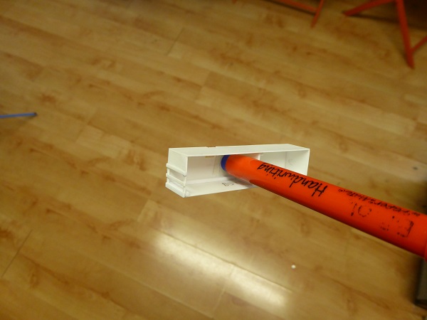

This took longer than i thought with a few mistakes having to be remedied.
#222 Posted : 29 October 2020 18:51:33
I also had to figure out a way of temporarily positioning it, so i could check the height, length and width and ponder how to support it once fitted. So, by fixing a piece of double-sided tape to the inside, i could stick the end of a pen to it and then i could move the box section into place, take a few measurements and remove it again.LOL
#223 Posted : 29 October 2020 18:53:05
That concludes this weeks update, more to follow next week.

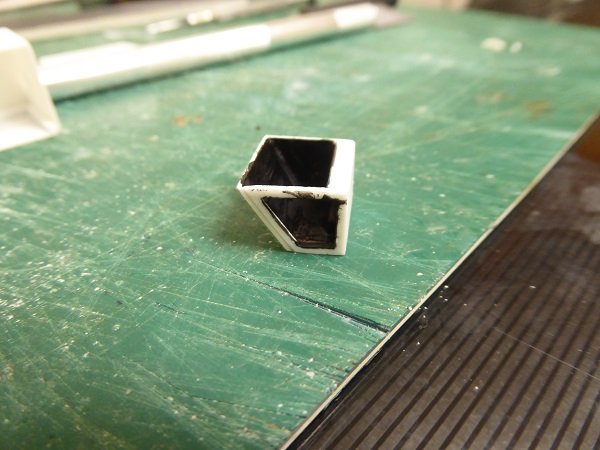

#224 Posted : 05 November 2020 20:40:18

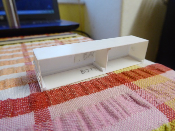

Been a case of two steps back, one forward this week.
The attached photo shows the end of the switchboard shell painted black on the inside as this will be ever so slightly visible when fitted.

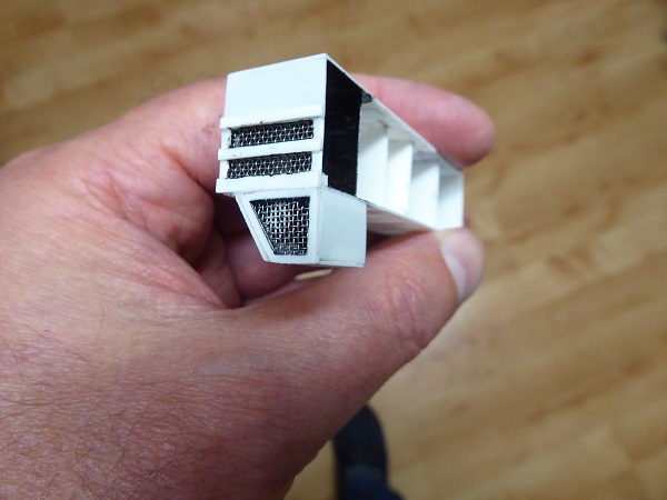

#226 Posted : 05 November 2020 20:43:06
Mesh was fitted to both the switchboard and additional unit and both were then fixed together.
#227 Posted : 05 November 2020 20:49:00

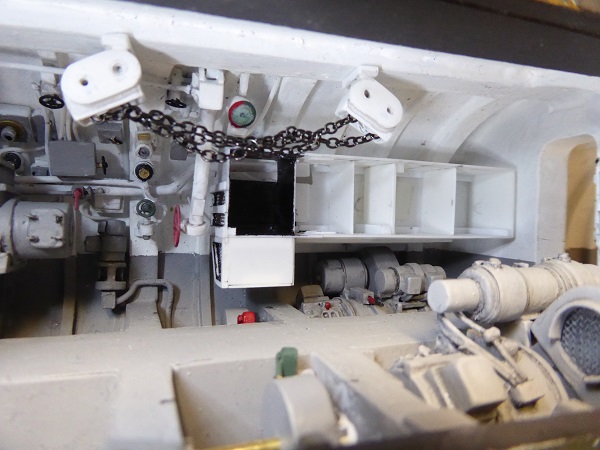

When i came to test fit the switchboard with the additional unit attached, it became clear that the couplers i made a couple of weeks ago were slightly too large.Blink Confused
So, out comes the switchboard followed by the removal of the couplers. I trimmed and filed the couplers before repainting and refitting. The attached photo shows the resized couplers fitted and the switchboard in it's correct location; horizontal, perpendicular and following the centre line of the u-boat and not the taper of the hull.BigGrin

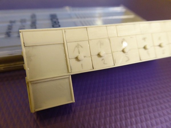

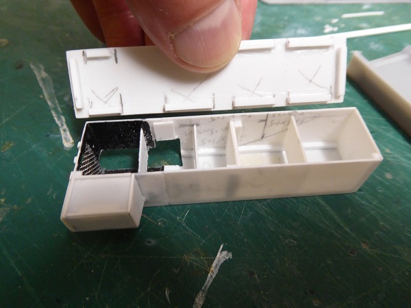

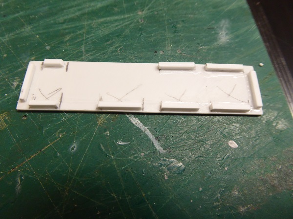

So this week i have been doing more work on the port main motor switchboard and made a start on the front fascia. I cut a piece of 0.5mm thick acetal sheet to size and added guides to what will be the inside. See attached photo.
#235 Posted : 13 November 2020 16:28:38
This photo shows the front fascia lined up against the switchboard body.
#236 Posted : 13 November 2020 16:30:32
The guides ensure i can remove the front fascia to work on it independently and refit or remove it as necessary, knowing that it will align correctly every time.
The attached photo shows edging strips added.
#237 Posted : 13 November 2020 16:33:10

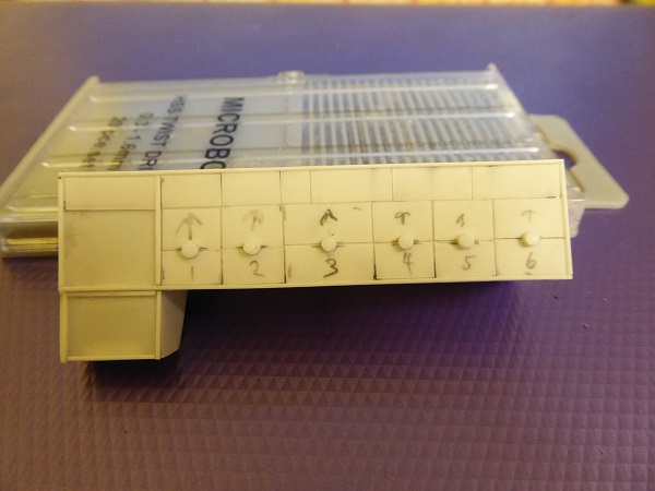

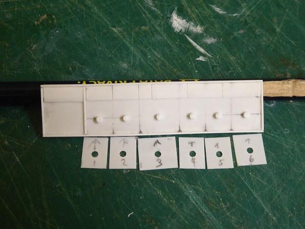

Lots of measuring and marking out followed to determine the position of the control handles. Once marked, i drilled through each mark with differing sizes of drill until the final holes were 2.0mm diameter. 2.0mm rod was then inserted, glued and trimmed to length.
#238 Posted : 13 November 2020 16:35:16

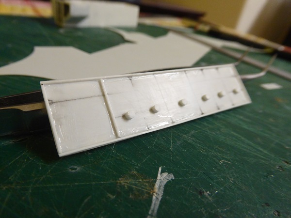

The next job was to make all of the individual panels for the front fascia. Made from 0.25mm thick acetal sheet, cut to size, the attached photo shows the top panels fitted and the lower panels prepared.
#239 Posted : 13 November 2020 16:37:31
The lower panels were then cut horizontally, ending up with 12 panels. All of these were then fitted individually.

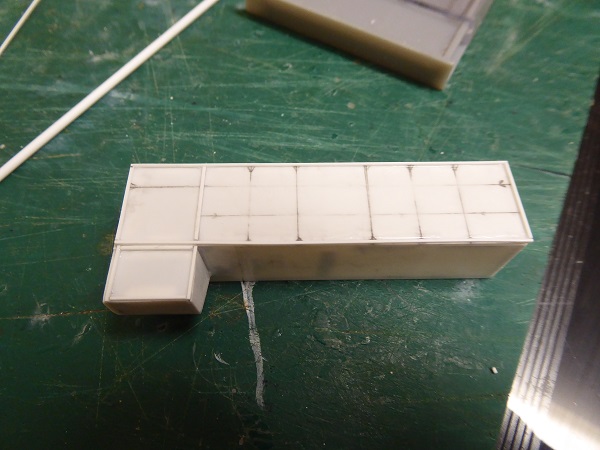

#240 Posted : 13 November 2020 16:38:20
Looking from another angle.
