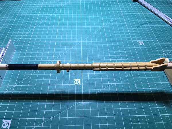

Issue 78:
- 3 mm extension added to the bottom of the mast to bring the deck line on the mast to level of the poop deck (see my previous post)
- lower mizzen mast painted.
Happy building!
Laszlo

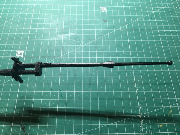

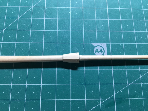

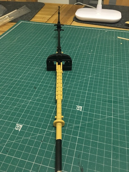

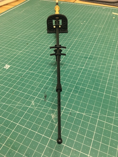

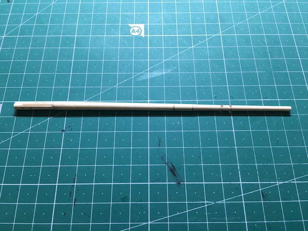

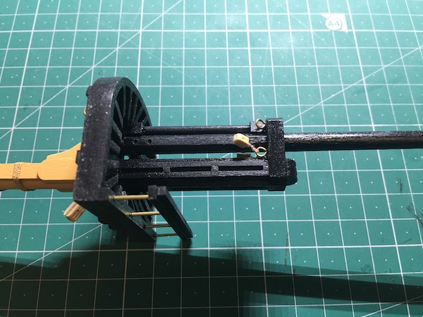

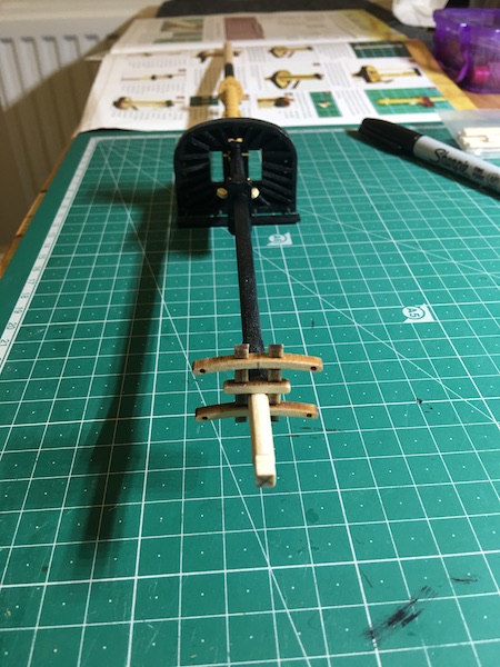

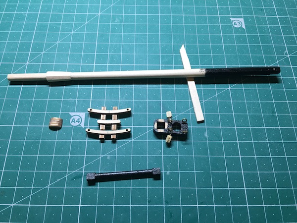

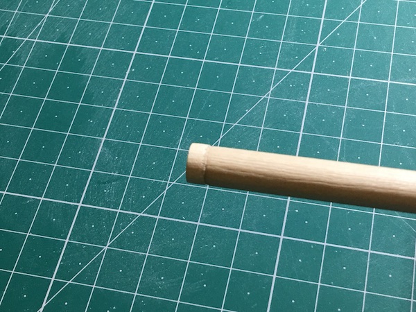

Today work on the mizzen mast:
- mast cap dressed with eyelets and rigging blocks
- cross trees assembled
- hand mast assembled and painted
- rope guide made
- mizzen topmast carved, tapered, octagonal section added, bottom part painted black, ready to assemble tomorrow.
Happy building!
Laszlo
#238 Posted : 20 January 2018 23:56:30
Progressing nicely, well done....Cool Cool
gingerale75
#239 Posted : 21 January 2018 23:34:06
Joined: 30/11/2017
Posts: 493
Points: 1,482
Location: South Norfolk

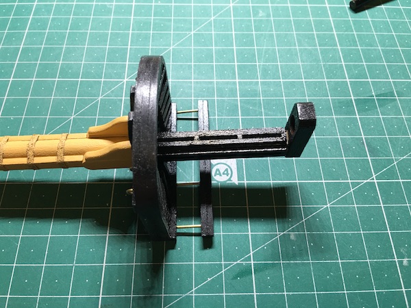

Quite productive day today working on mizzen mast:
- mast cap, top mast, hand mast and rope guide assembled to the mast top
- cross trees fitted to top mast
- topgallant mast carved, tapered
- octagonal section added
- topgallant mast and mast cap fitted to the mase assembly and all painted black.
With this the mizzen mast now fully assembled, only the dressing with rigging blocks left for tomorrow.
Happy building!
Laszlo
