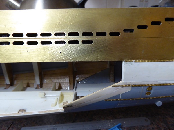

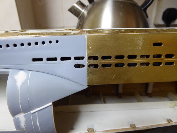

#223 Posted : 16 February 2017 20:24:48
Evening Everyone.
Another post from the dry dock [my kitchen]LOL

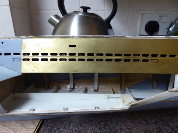

On this part of the build i'm focusing on the free flood holes above the Torpedo Compartment and the free flood holes just behind them. All will become apparent when you see the pictures.
After thoroughly digesting Dougie Martindales article regarding the patterns of the free flood holes, it appears there was no pattern to fit all. Many U-Boats had different numbers of holes compared to others and port and starboard sides varied too.
Just to make it clear, the free flood holes allowed the sea water to literally flood in under the casing [top deck]. The reason for this was to ensure the sea pressure was equal inside and out to prevent the casing from being crushed when the boat was dived.
After studying the only two pictures I could find of U230 coupled with the article by Dougie Martindale it transpires that the amount of free flood holes above the Torpedo compartment supplied by the part-works was the correct configuration and number on the port side.
The starboard side however required two extra holes added, one forward of the original pattern and an extra one aft of the pattern.

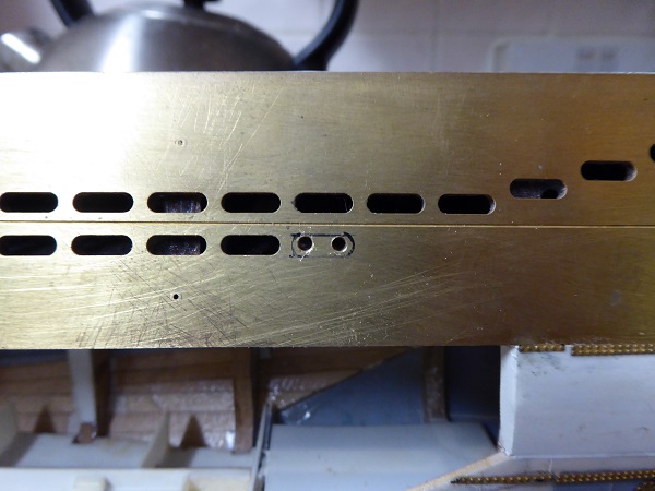

The attached photo shows the starboard side, bow to the right with the two holes marked out ready for drilling, grinding and filing.

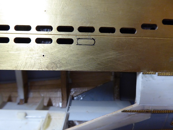

#224 Posted : 16 February 2017 20:27:16
This photo shows a close up of the forward hole marked out.

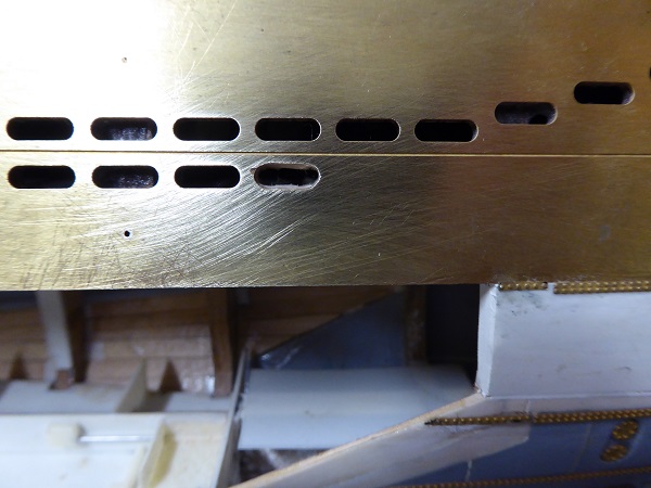

#225 Posted : 16 February 2017 20:27:59
This photo shows the aft hole marked out.

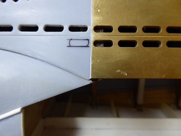

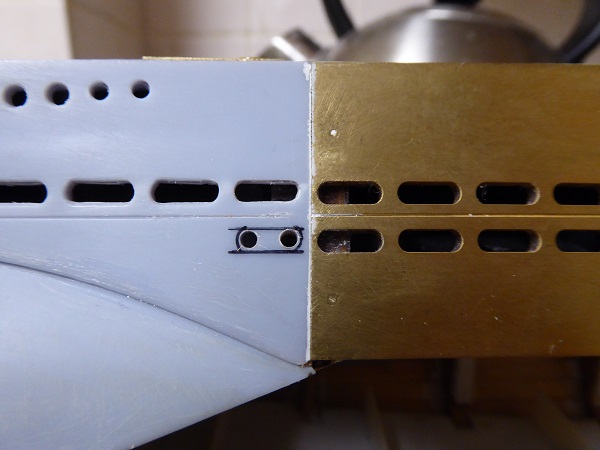

#226 Posted : 16 February 2017 20:29:36
This image shows two pilot holes drilled through to act as a guide on the forward free flood hole.
#227 Posted : 16 February 2017 20:30:56
Similarly, this photo shows the pilot holes drilled through on the after one.

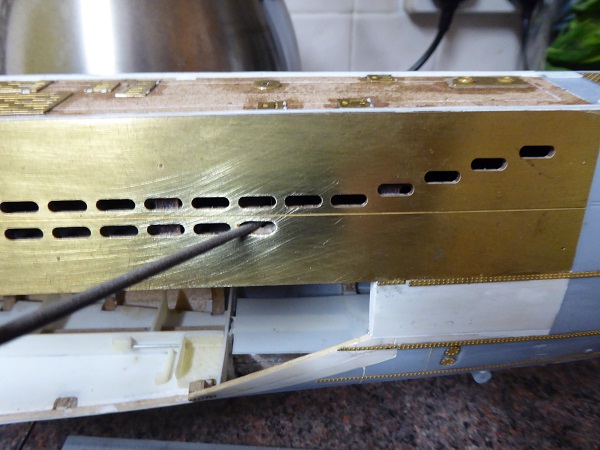

#228 Posted : 16 February 2017 20:38:35
I then tentatively ground out the space between the two pilot holes front rear using a small cutting disc on the dremel. The brass free flood hole required a more hefty approach but not so much that I veered out of my markings and the rear one, being plastic, required a more gentle approach as the cutting disc wasted no time in grinding through this.
Once satisfied I began to dress and file out the holes using a needle file, constantly checking their profiles.
The attached photo shows the needle file dressing the forward free flood hole.

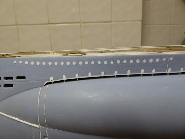

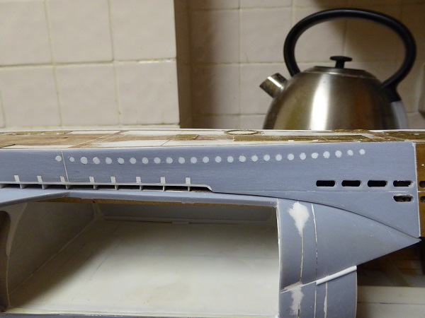

From the previous picture you can see the long row of smaller holes that run along the top.
These are the ones I will be focusing on next.
Studying actual U230 photos and again referring back to Dougie's article it transpires that the Kriegsmarine decided to modify this arrangement sometime during the early part of 1942. By modifying, what I mean is the removal of. After trials the Admiralty concluded that the inclusion of them originally didn't actually speed up and aid emergency dives. Also, these extra holes would vent air whilst the boat was diving creating more bubbles that could be spotted from the air; hence their omission on later boat builds.
U230 was never fitted with them when built, so I had to block these off to make the model more historically accurate.
Using 2mm and 2.5mm plastic rod I could plug these holes without too much difficulty. Cutting, then filing smooth after to match the contour of the hull.

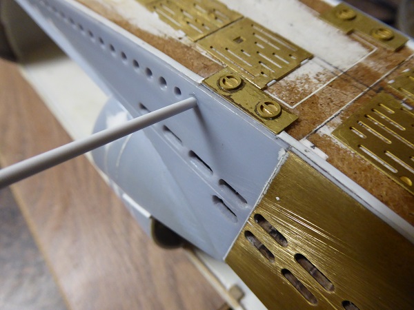

The first photo shows the 2mm plastic rod glued in place prior to cutting. I figured it was more prudent to glue the rod in place and use it's length as a temporary handle while the glue set rather than fiddle about with small dowel like sections.

The next image shows the rod cut. At this stage the rod was still sitting proud of the hull and requires dressing and sanding.

I then proceeded to use the same method for all of the holes, either using the 2mm or 2.5mm as necessary; two smaller ones each end and the larger 2.5mm holes making up the rest.
Once completed for both Port and Starboard sides I sanded them all smooth and flush to match the hull.

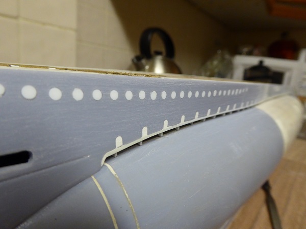

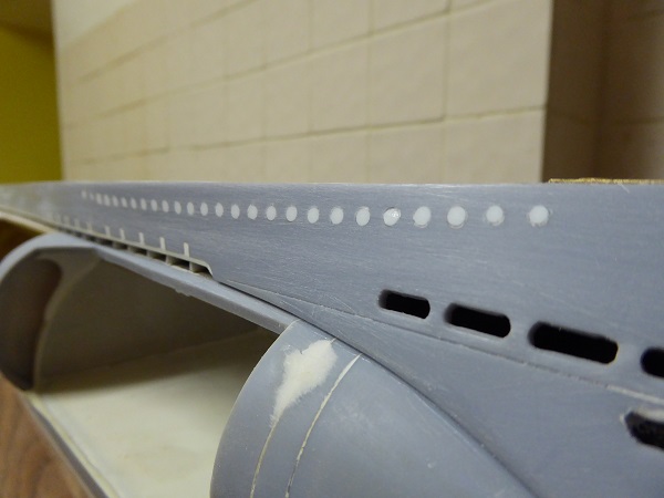

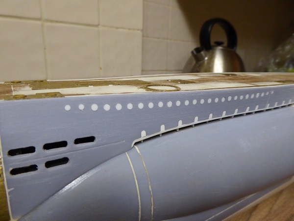

This photo shows a side on view of the completed Port side.
#237 Posted : 16 February 2017 21:08:28
Another angled view of the Port side hull.
#238 Posted : 16 February 2017 21:09:27
A closer view of the Port side hull.
#239 Posted : 16 February 2017 21:10:32
This is the Starboard side of the hull.
#240 Posted : 16 February 2017 21:11:51
Finally, an angled shot of the Starboard side showing all of the plastic plugs filed smooth and true.
