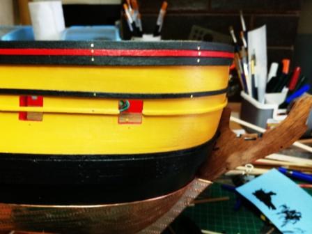

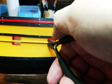

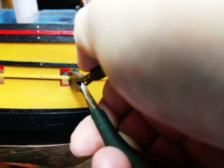

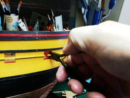

Here's a couple of pics showing how I did the center rubbing strake over the gun ports..hope someone finds it helpful..
I ran the center strake all the way from bow to stern and after the glue had dried cut in the the center of the gun port...
Barry

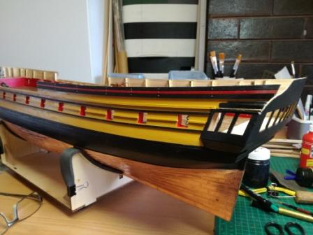

Just got finished with section 11, spent most of the day trying to paint that silly little gold stripe...this will have to do for now maybe re visit it sometime...Angry

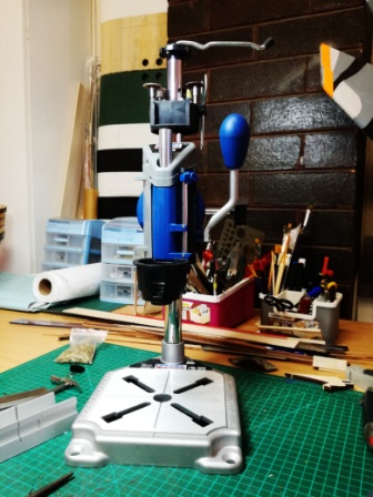

Santa Arrived early this year just in time for me to start building the cannons....BigGrin

#225 Posted : 20 December 2016 08:59:29
That looks neat Barry. Cool
You`ll have to give us the low down on how well it works.
Is it Dremel?

Yes it's a Dremel...beautifully engineered and built and I think as long as it's used correctly it should last me forever...BigGrin

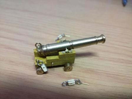

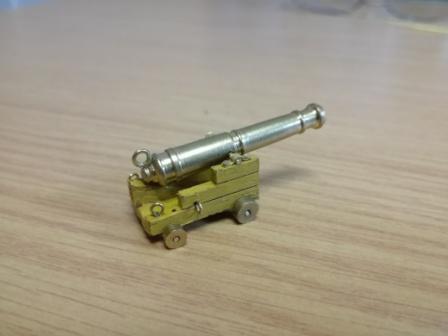

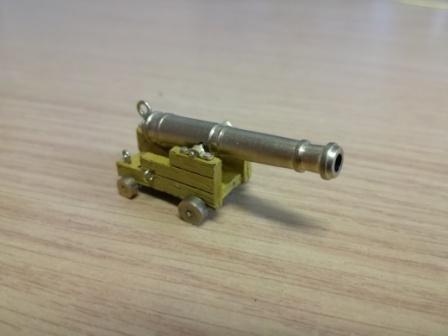

Been looking forward to building the canons..23 parts without the rigging each Huh, Here's a couple of pics of the first one..can't get the blackening stuff here and I didn't want to paint them in case it peeled or flaked so I left them in their natural state...only 41 more to go..BigGrin
BarryM attached the following image(s):
There's no time like the present.....

Thank's gent's, forgot to mention, the Dremel drill press works a treat..each canon side needs 4 x .6mm & 1 x .8mm hole...easy with the Dremel just difficult to change bits whilst in the press also not sure why they don't make a vice to compliment it???? Confused

I have the same dremel jig, it's great, I fixed a timber base on top of the metal one, then I could pin temporary fences etc to get work done more accurately.

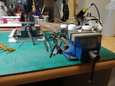

Neat idea Mo...BigGrin I'm just using a couple of small machine vices I bought..let's see...nope can't remember when....last Millennium some time..
Barry

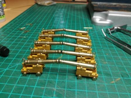

Managed to get 10 of the canons finished...couple of things...I glued in the eye bolts at the rear of the canons luckily I managed to remove them as it would be really difficult to fit the tackle blocks with them in place. Secondly, need to take more care in cutting those small triangular lifting blocks at the base of the canon to make it easier to line them up at the same angle....
Barry

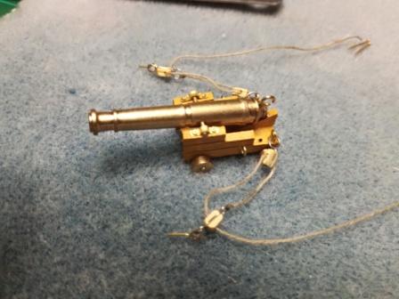

Laugh Laugh Laugh Yep I do get carried away at times...practiced making up the blocks for the canons, started with the wire supplied (can't solder it ????), then tried the rope sheeeeze...lastly tried some 0.4mm silver coated copper wire my wife uses for beading cutlery..BigGrin BigGrin That will work, easy to shape, strong enough and solder-able.
But if things get any smaller than this I'm going to have to get more Magnification..Blink
Here's a pic of the first bits...

Caution! This is a double sheave block.

This is the way the rigging for the canons are shown in the pics on the Model Space site..Confused
