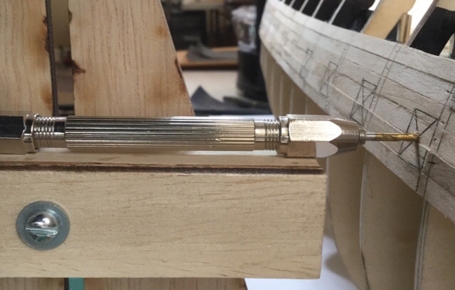

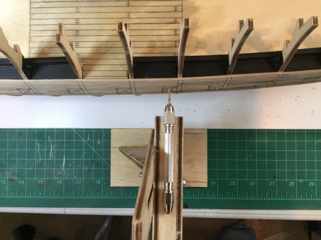

Alan, thanks.
Well, I drilled all of the holes in the centers of the gun ports. First I used an awl (instead of a centering bit) to pre-start the drill holes and then used a pin vise with a 2mm drill bit to drill through the planking. To make sure the cannons were perfectly perpendicular to both the false keel and the water I used a waterline marker I bought off of eBay. Now I know the the drill entered the cannon support beam in the right place and the right direction.

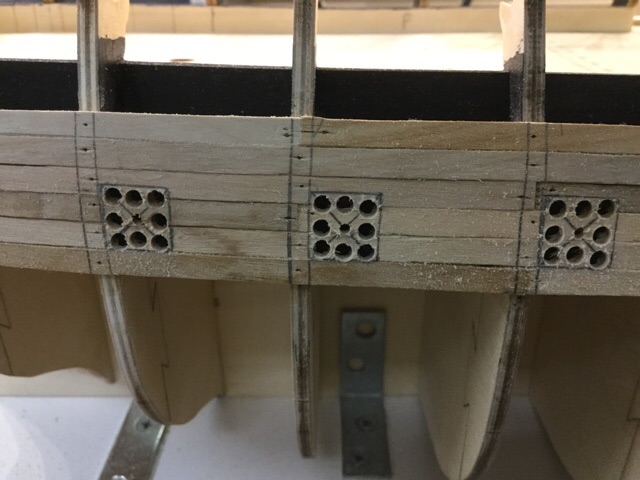

Well, the first set of cannon ports is complete on both sides. on the first one (aft port side) I tried using the Dremel with cutting bit and working around the inside of the line. It was sketchy and probably had a high potential for slipping so I quickly changed over to drilling holes around the inside of each cannon port, first the 4 corners and then in between each set of corner holes.

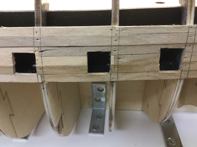

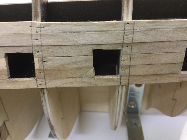

Then I used my hobby knife to carefully shave or cut away wood up to the line. I found that a sawing motion worked best and didn't require as much pushing force (which was safer as well) I had two instances where there were screw ups.
One was at the bow on the port side, second cannon port back, the one between the two frames but not up against either. I must have lost my line on one side and cut all the way to the frame. So, I glued three pieces of planking together, edge to edge, to match the planking, trimmed it for height and glued it in place. Looks pretty good and will disappear after sanding and paint I think.
The other was where a plank must have been weak and a small chunk came out. I cut a triangular piece of plank, glued it in place, and then trimmed it when it was dry. You'll never know after sanding.
It looks much better after trimming.

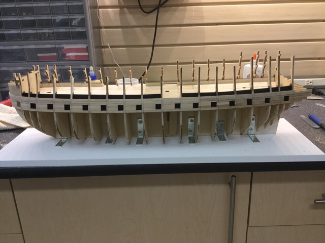

And here she is in profile. Like I said, not too bad for a first timer. I got better as I went along so I think the next row will be improved.
Now, onto the next steps and I may finish the 4 cannon and anchor from month 3 before doing more planking since it's going to be another scorcher today.
