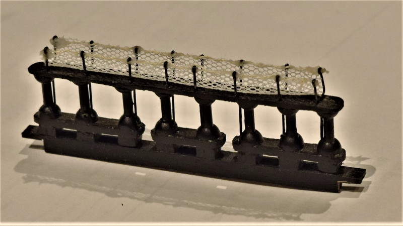

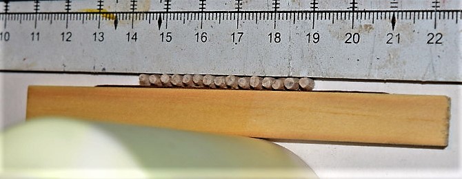

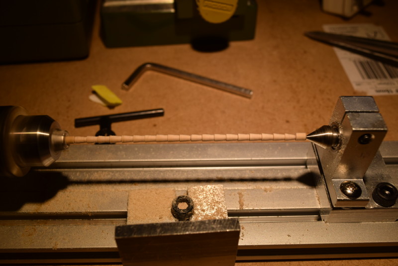

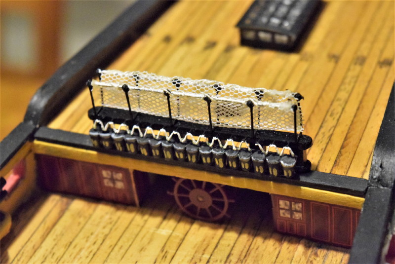

I started making the buckets by using using a divider caliper set to 5mm and putting a groove in the dowel on the lathe and then cut them off individually, after a bit cleaning up they were then placed upside down and glued together and onto a 2mm wide strip of veneer, once all was dry they were then painted and glued onto the poop deck rail after the netting was added.

Thanks for that Alan, i'm quite pleased they came out the way they did, i was able to glue them onto the bottom rail as well so they shouldn't go too far in a hurry, tonight i've been working on the hammock netting on the waist rail, i made a template out of paper the same size as the netting i needed and then transfered those sizes onto the netting, this time i held it in place with an off cut of wood just under that size, this stopped it moving around which made it easier to sew.

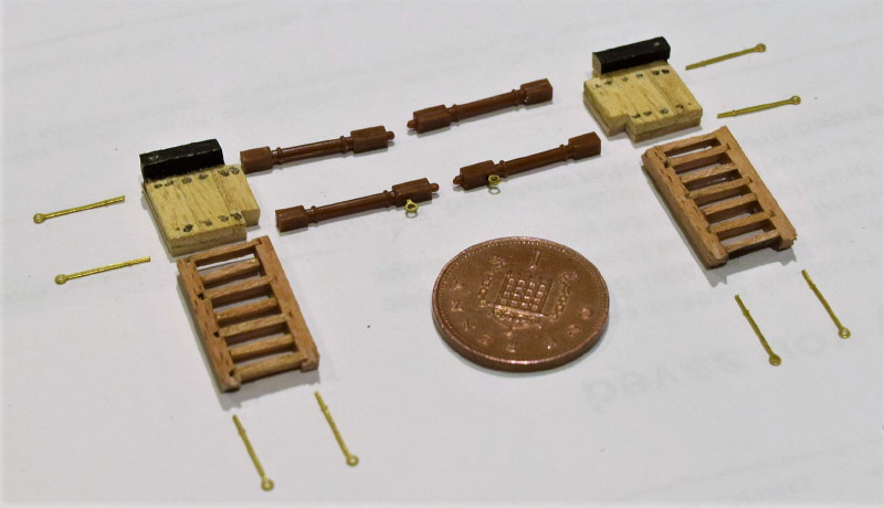

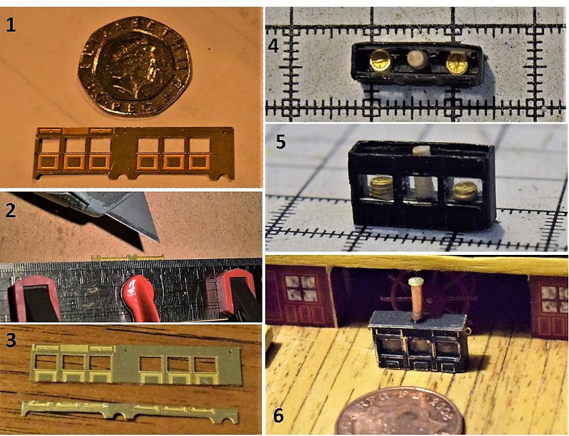

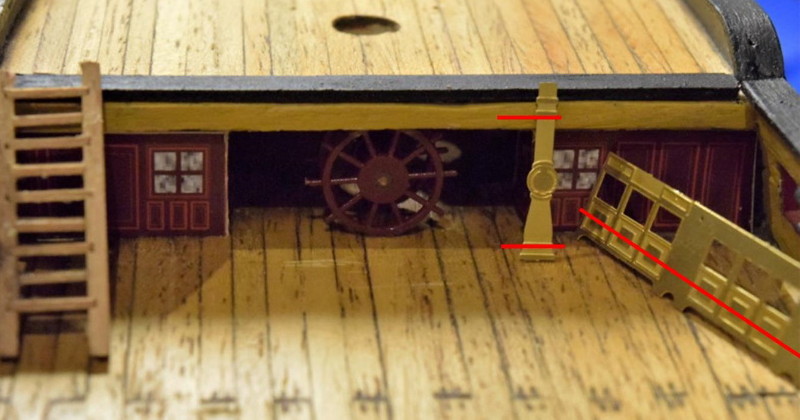

This one is for Jase.
Gibbo attached the following image(s):
#226 Posted : 10 February 2018 07:59:16
Hi Paul,
Understand the issue now. This is how I would tackle it.
use a piece of masking tape to mark your cutting line. Then use a pair of nail scissors to cut along the line. (they do exactly the same job as etch sheers but about £20 cheaperBigGrin )that should give you a nice strait edge.
with the binnacle I would then trim the the bottom piece you have just cut of and glue it back on the bottom so you don't lose the detail, you could also do this with the two strips that got cut off the topBigGrin
on the cabin doors I would consider trimming the top first then cut off the bottom strip and glue it back on as suggested with the binnacle.
Hope that helps mate

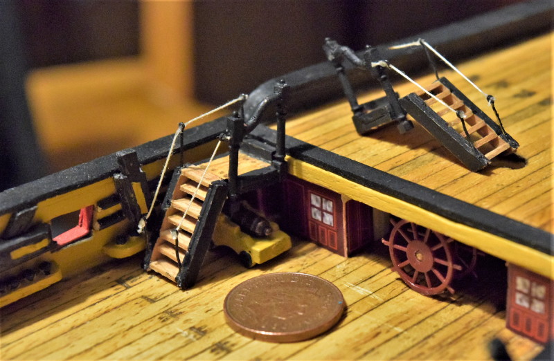

I built the poop steps as separate units so they can be put away to be put on at a later date.

This weekend i've been working on the Binnacle, pic 1 shows the PE binnacle, this binnacle as it stood was too tall for the space i have, the top of the binnacle on the Victory is as tall as the middle of the ships wheel so this had to be cut down and after taking advice i tried the method with some nail scissors on some scrap PE sprue, the thin strip i cut off went into a spiral and couldn't be straightened out to my satisfaction so i thought i would try running it through Proxxon table saw, that was working quite well but the blade catch every now and then, i clamped a piece under a steel rule and went about scoring it with a Stanley blade, i originally wanted to take a piece out of the middle of the Binnacle and glue the top and bottom back together to keep the detail but it just wasn't happening, i only had one shot at this and decided to just take off the bottom and leave it at that, i finished by going over very lightly with a file to bring out some of the detail.

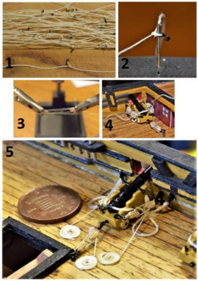

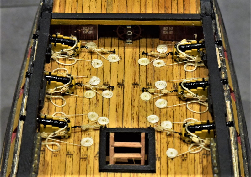

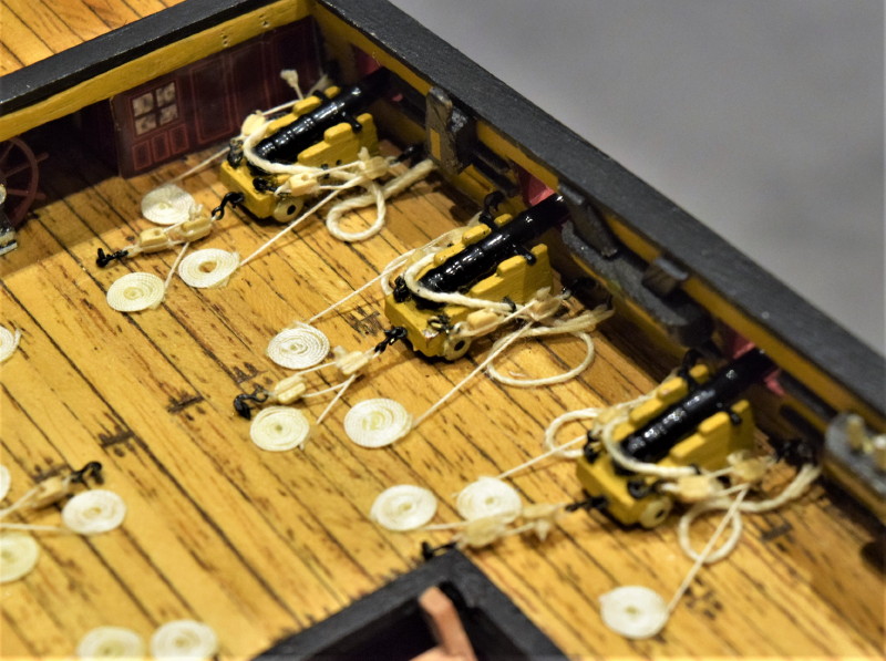

The last couple of weeks have been spent working on the guns on the quarterdeck, this has been a lot of trial and error, after ordering some 3.5mm double blocks and 2.5mm single blocks from Caldercraft i set about rigging the guns and at 1/100 scale this is not easy, after drilling the holes on the guns for the etch ring bolts (went through half a dozen drill bits for this) and drilling the holes in the deck and the walls the ring bolts and hooks were primed and sprayed ready for attachment, first up were attaching the hooks ready to wrap around the blocks (pic 2)and then rigging the blocks ready for attaching to the ring bolts on the gunwhale walls and the rear of the guns (pic 3), this was extremely fiddly getting the hooks into the ringbolts near the gunwhales but it worked really well, after tightening up the double blocks they looked too close together and really chunky (pic 4), so it was onto the single blocks, the first attempt didn't go too well until i took the thread back through the hole in the block nearest the gunwhale, i think this much nearer scale and i'm much happier with end result (pic 5) 1 down 5 to go.

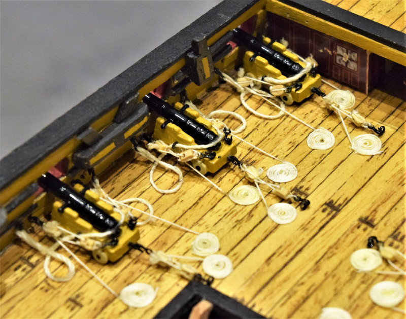

Well this has been long 'ol job, 6 carriages, 6 guns, 60 eyebolts, 48 hooks, 36 blocks and 18 coils later the quarterdeck guns are finally rigged, the coils could have been closer to the guns so it’s created a bit of a health and safety nightmare, maybe if Horatio tripped over one just before the shot was fired his jacket with the bullet hole in it wouldn't be hanging in The National Maritime Museum in Greenwich and he would have lived to a grand old age.
