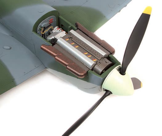

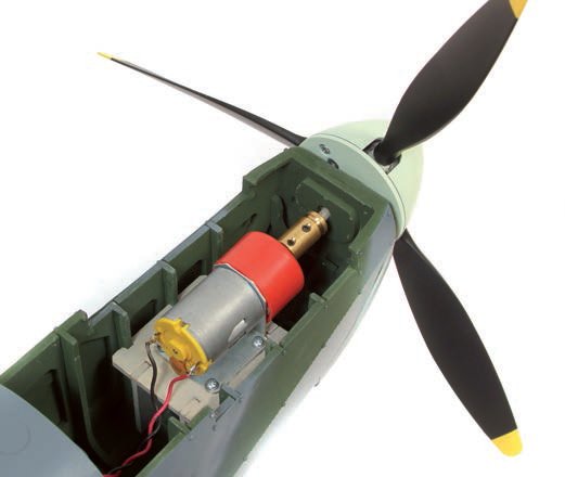

Be careful where you mount any additional reinforcements is the engine bay area, they may cause fit problems when it comes to mounting the motor mount and engine head.
#209 Posted : 19 October 2014 13:35:42
Hi Tom,
Thanks for looking, a very valid point with nose reinforcements I can see clearly from your pictures.
Kind Regards
Trev.
